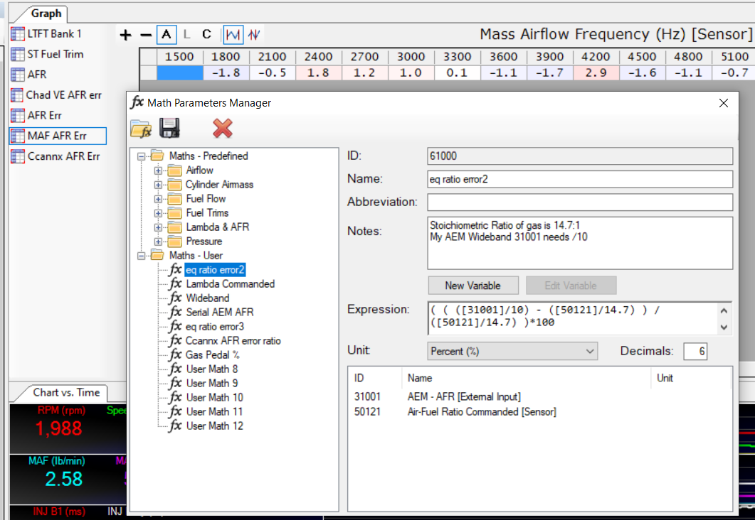

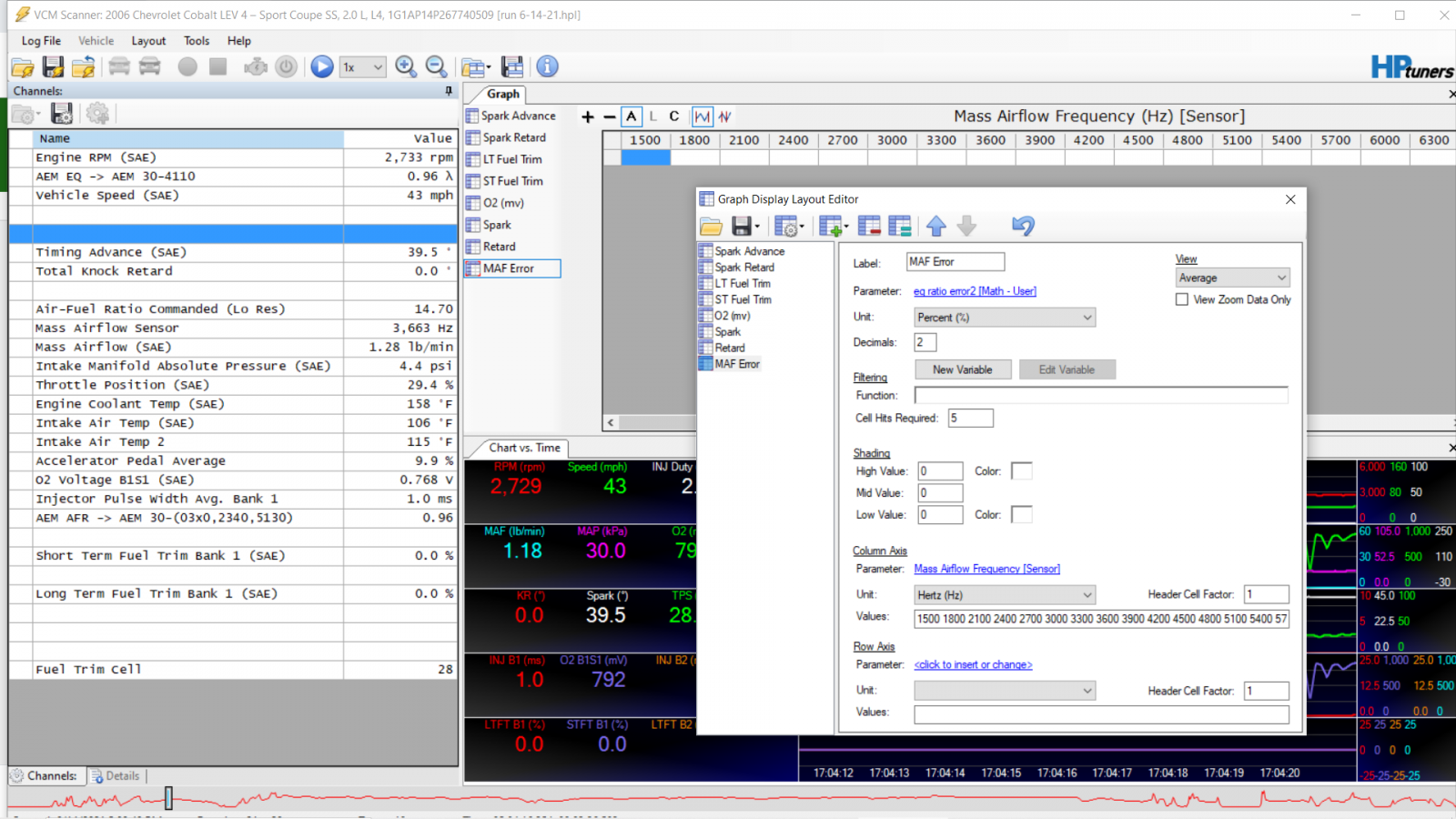

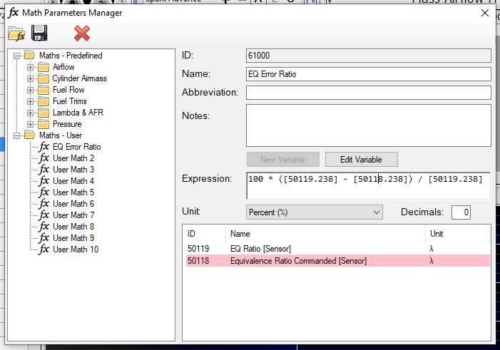

I've been watching Goat Rope Garages videos on tuning, started with the first video and got to where he goes through talking about tuning the MAF. I've watched this video more times than I can count. What I'm trying to log is the EQ error ratio like detailed in his video. Link to where he starts talking about the math needed to find the EQ error
Im using Chads templates to set the values to tune the MAF. I have a AEM Wideband hooked up through a serial to usb connector and it seems to be working. Just cant get anything to graph with the MAF Error graph.
Am I going about it the wrong way? Has anyone else done this?
DCMoney
Think I figured out why I can get that graph to log anything. Doesn't look like we have the equivalence ratio commanded sensor. Is there another sensor I can use?

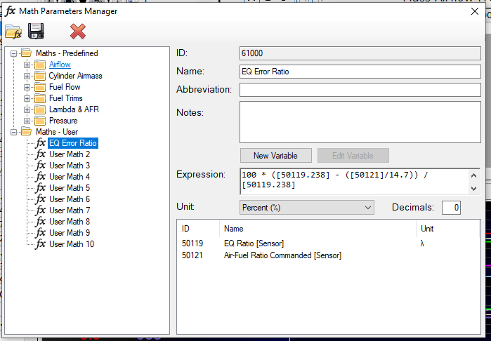

Got it to work, used the following to take the Commanded AFR divided by 14.7 and got data. Not sure if this is the right way to do it but it worked.
24419
24418
Looks like you got it all figured out.
I calculated the error percentage from the perspective of the commanded AFR. That is why my divisor is the commanded.
You calculated it from the sensor AFR perspective. Probably both will work fine.
Good work!

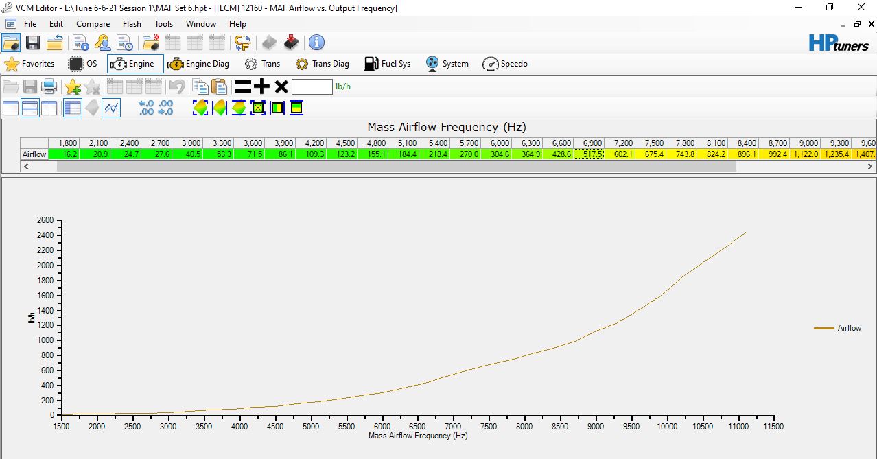

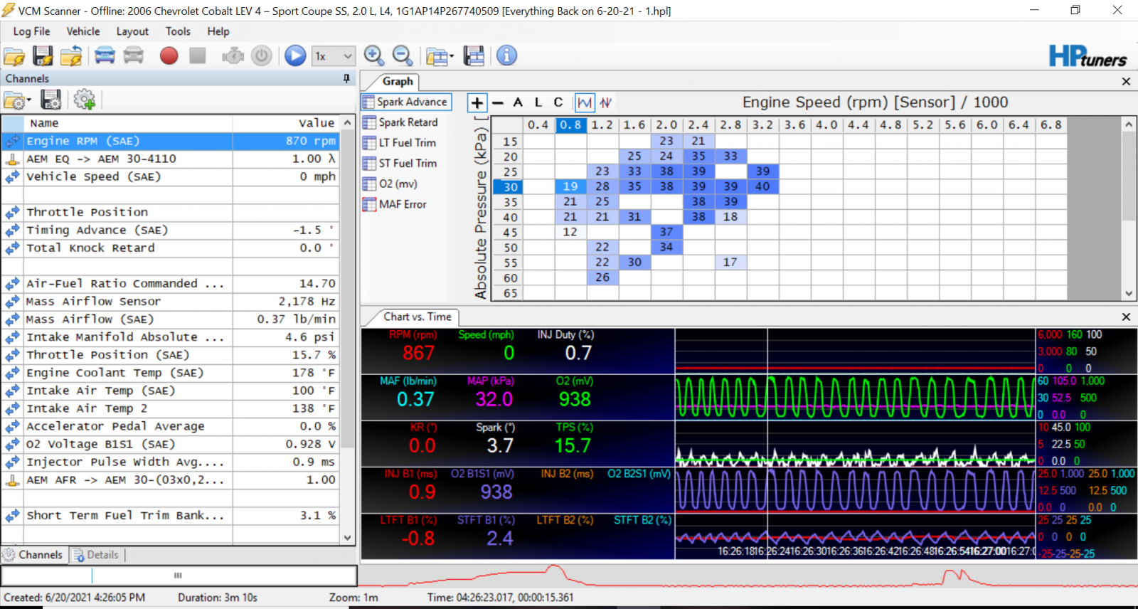

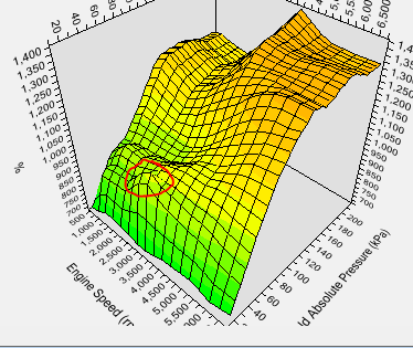

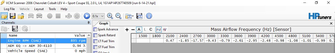

Noticed while tuning my MAF there are a few points where adjusting the values do very little to change their actual value. Any ideas on why its only at these two points 2700 Hz and 3000Hz? Also noticed in my other logs the values below 3000Hz seem to be all over the place, where above 3000Hz I've gotten them to stay closer to +- 1.5%

Can you save your scanner layout and upload it? Hopefully we can attach XML files. My layout and math is completely different than yours and the values I get seem to fall in line.

When doing the MAF, the throttle should be very smooth and slow. I see in the scan there is a lot of jitter and fairly abrupt movements in the throttle.
I haven't started the VE turning yet. I rewatched a few of the Goat Road Garage videos and he mentioned smooth throttle application, yeah... I've been getting data driving to work not exactly being easy on the throttle. Next time I go out I'll do a run specifically for collecting smooth throttle applications.

Something still a bit off, usually as you get closer to the commanded ARF, the O2 oscillates a lot between rich and lean, that's how you know you are riding the fence. But in your case, it's still running rich most of the time other than the dips around the area that you are questioning (2400-3000hz).

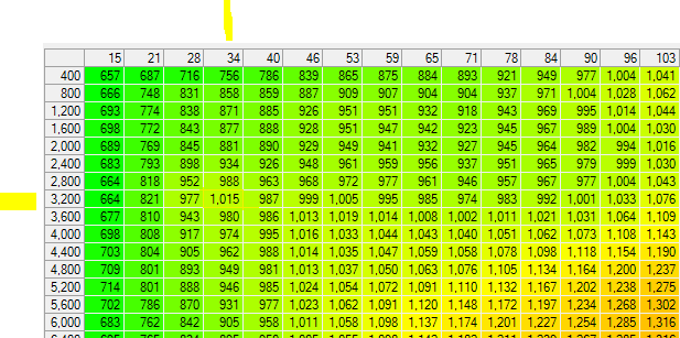

I personally did the VE first. I know there is conflicting information out there about which is better to do first. Your VE tables show a peak that I would smooth out. But you could spend all day tweaking the table.

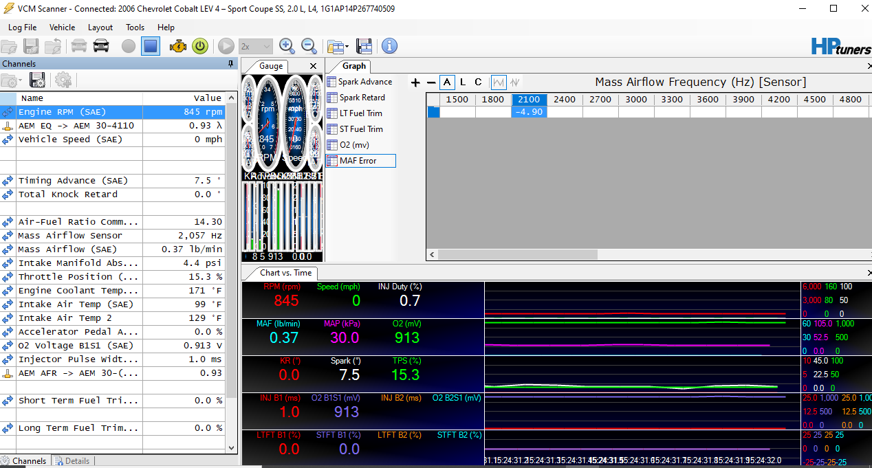

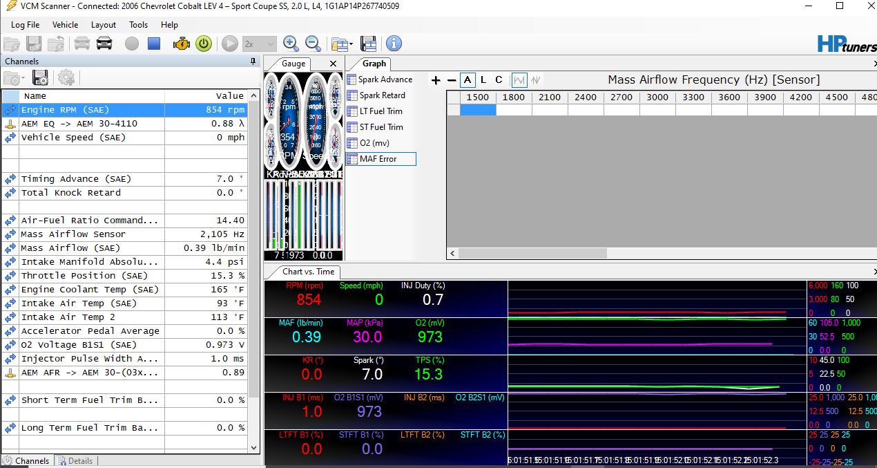

I turned off all the MAF only tuning the O2 chart logged like this at idle.

Do you have your evap plug plugged in when you're taking these scans? If so, unplug to lock the LTFT's while you're dialing in STFT's
Are these scans long? I see one is 3mins. Usually I go for a quick spin before I start logging to get everything (not just coolant temps) up to operating temps and then go for a long scan as you can have outliers like this show up.

I get the red dots in the corner of the MAF Error table - which indicates a missing parameter, or an error getting the data.
That 3 min run was just running in the garage to see what the car would do after turning everything that was off to MAF tune back on. I thought I did away with the evap during the build? Believe the template file Chad shared disabled LTFTs.
