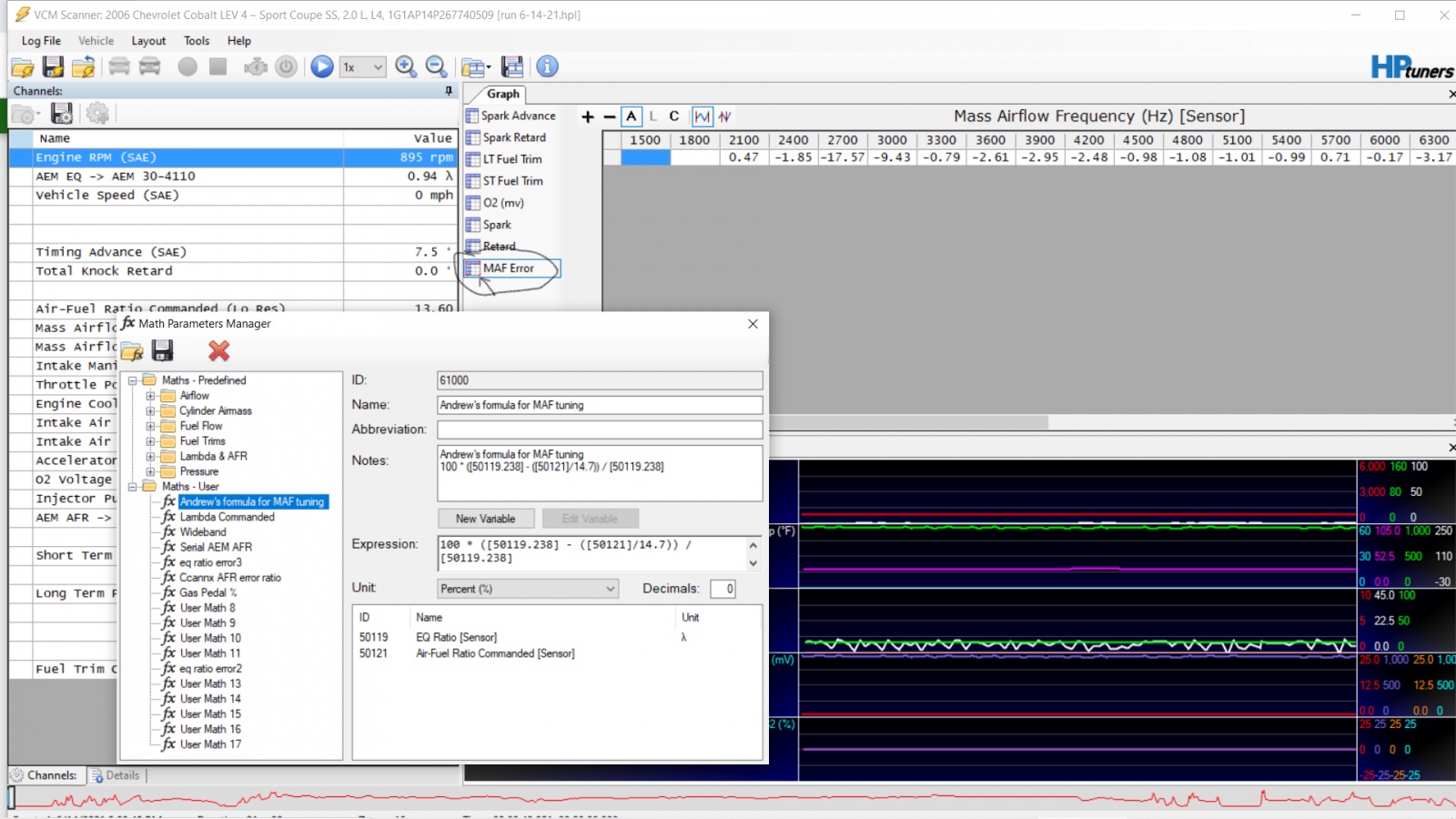

Yes, the EVAP shouldn't have anything play in this, assuming it's plugged off. The template does have the LTFT disabled. Just make sure you clear your current LTFT before you start tuning, you don't want those changing your fueling, you'll be chasing your tail.That 3 min run was just running in the garage to see what the car would do after turning everything that was off to MAF tune back on. I thought I did away with the evap during the build? Believe the template file Chad shared disabled LTFTs.
Well **** that means something in my math/graph is wrong as well, but I've gotten data from it.
Because he cannot see your data, doesn't mean your math is wrong, just both of you are don't have everything set up the exact same.
