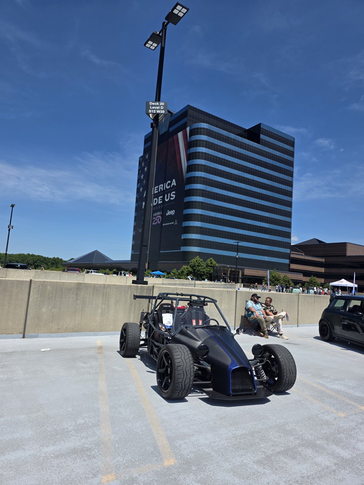

Employee car show at work. So I took the opportunity to get the tower shot with the Goblin. Kinda wish I wouldn't have parked by the light pole but oh well.

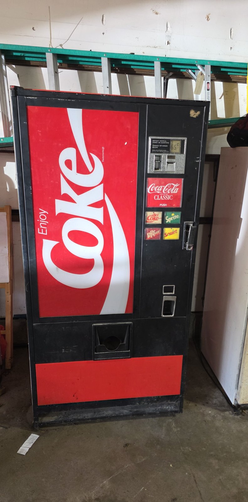

Not goblin related but upgraded the garage beverage fridge. Still figuring out it's quirks but it gets cold and I'm starting to figure out how to get it to spit out a drink. Its a weird mix of issues between the coin reader, how to load it so it doesnt jam up and making sure it doesnt think it's sold out so it just rejects the coins. I feel like it got it at a good price at $100

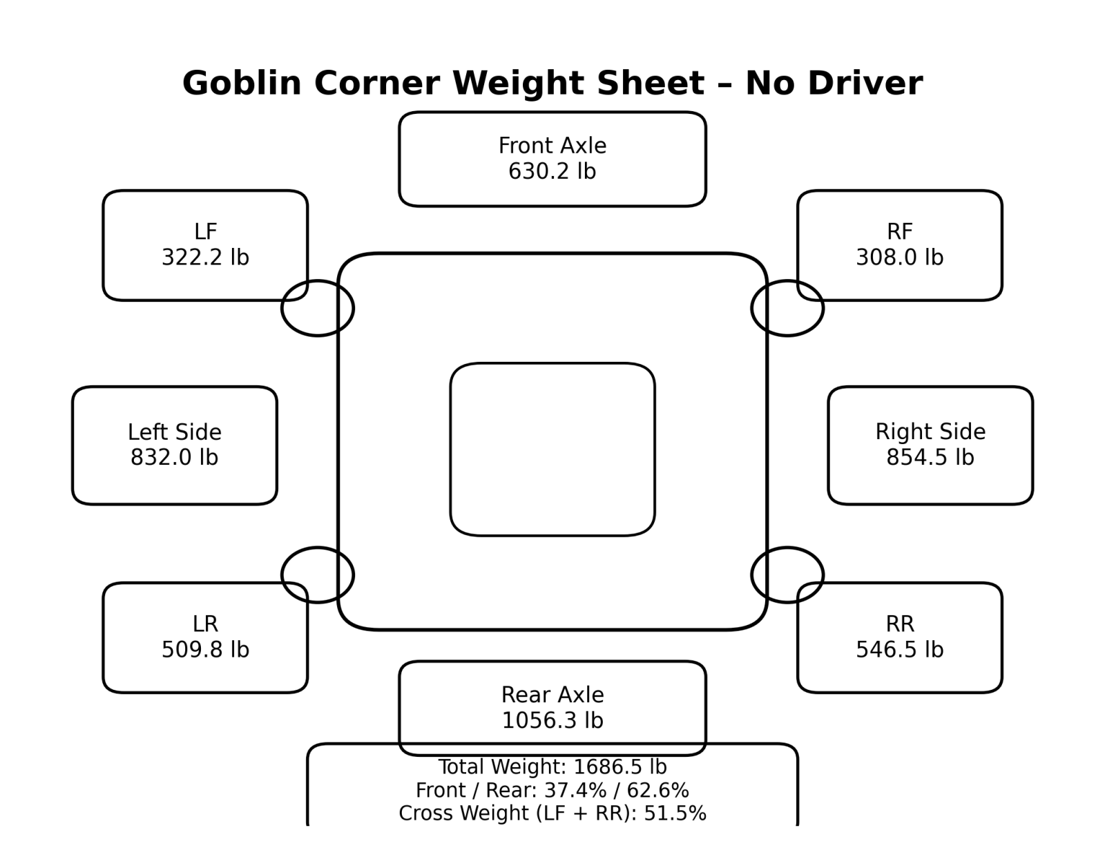

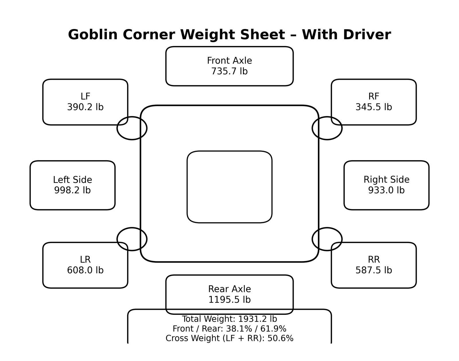

Was dusting the Goblin off to get it ready for the season and decided I finally would like to know what it weighed. Amazon had this 660lb scale for $38. Bought one and put wood under the other tires to match the scale height. I was going to play with spring adjustments if cross weight was off but I'm happy with how it currently sits and now I've scratched the itch of knowing what it weighs.

Was thinking in doing something similar but using 4 scales. Not sure if it would be easier then moving it around.
