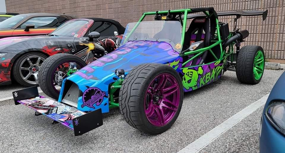

So tell me how you really feel.
Why do you feel that way? Who is Paul? What does his wrap look like?
PS, We really do need a rear suspension redesign. Upper and lower A arms. The goblin has so much more potential.
Maybe they are talking about Paul Clark aka Carproblem.
