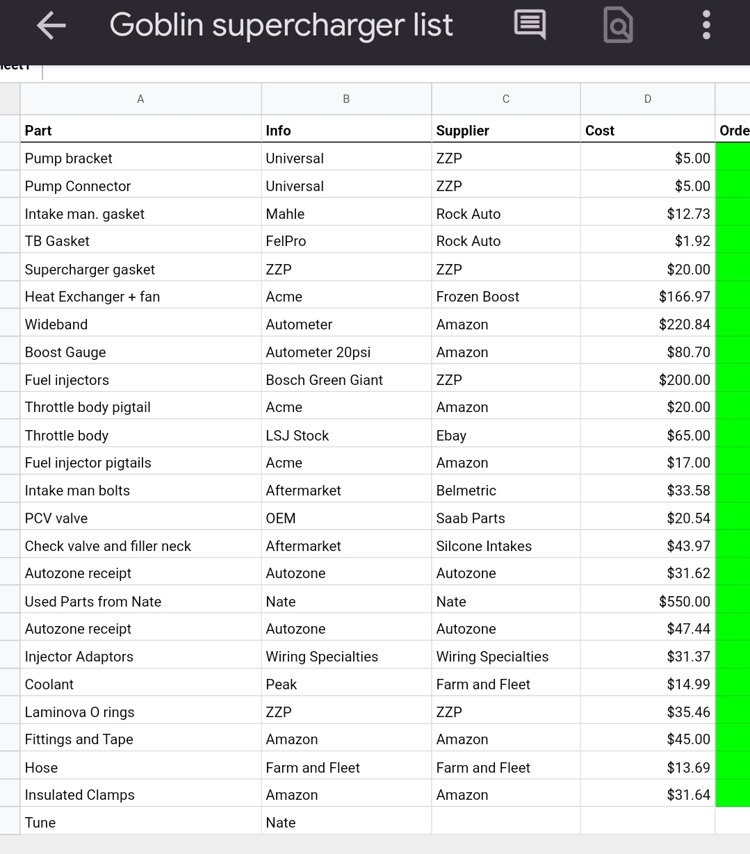

When I read @jirwin build log, it seems like adding the SC is not as easy if you do not have any parts left over from the donor.
