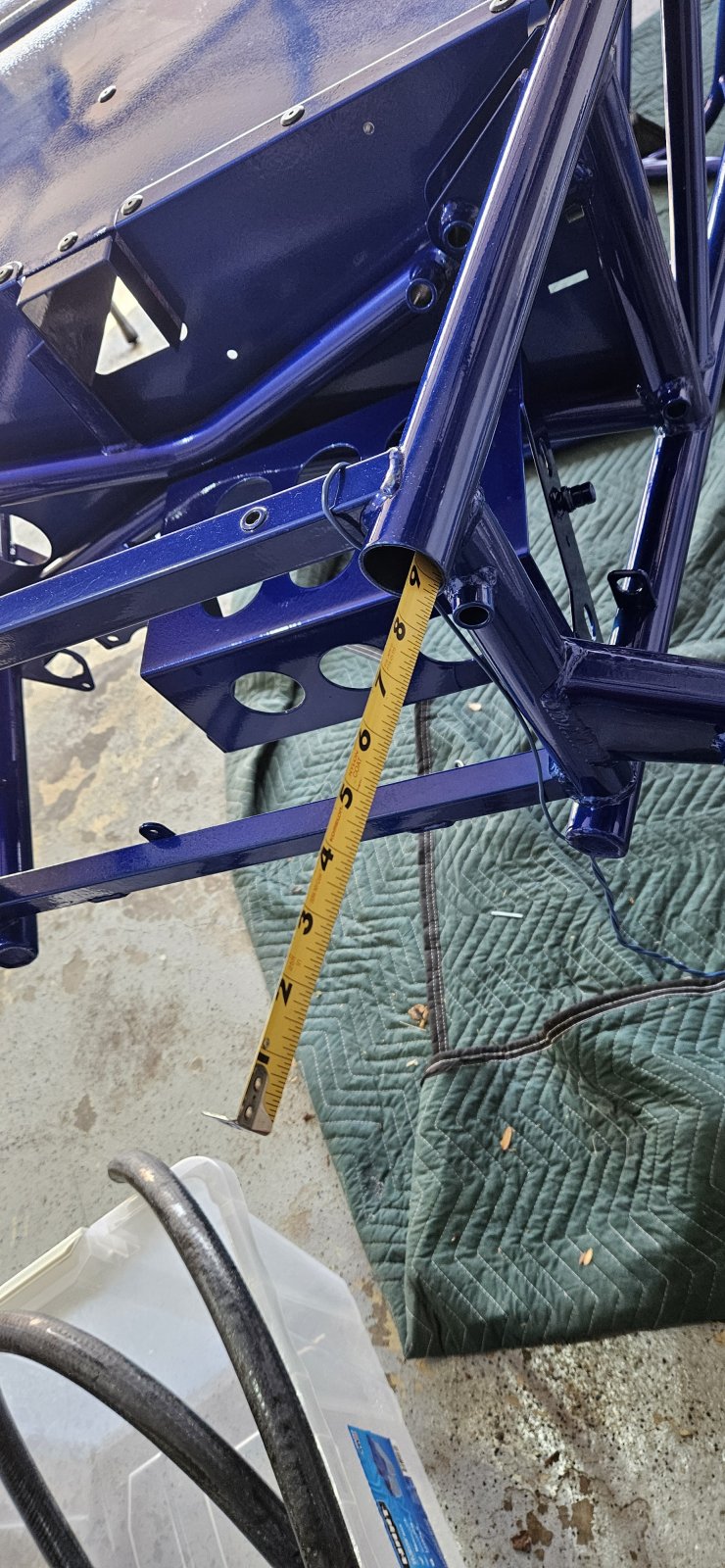

Finally got back to work on the Goblin. Floor is installed and coolant hoses are run. I've got some cleanup with the urethane. Also got it all over me. Running the coolant hoses went ok, though the second one snapped about 2 inches from the end of the frame rail. Luckily it pulled back out without much hassle.
My tip, instead of trying to find a wire stiff enough to run through the rail to pull the rope through, just use a tape measure. Worked great.

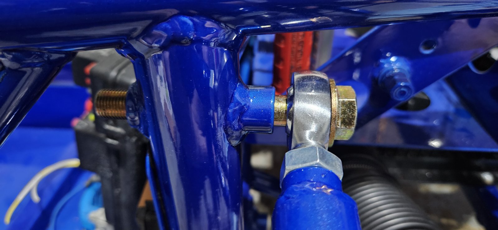

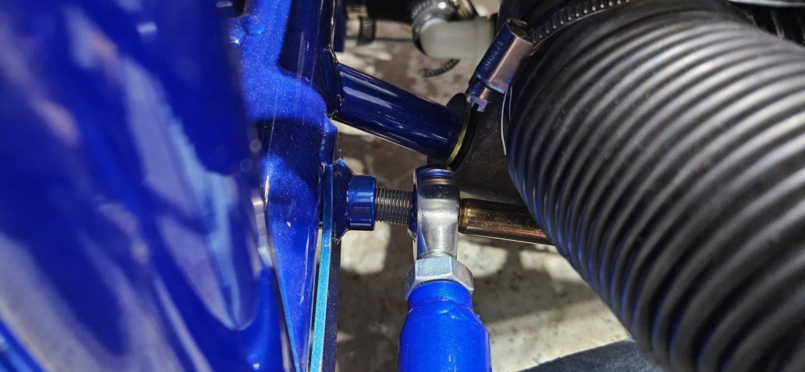

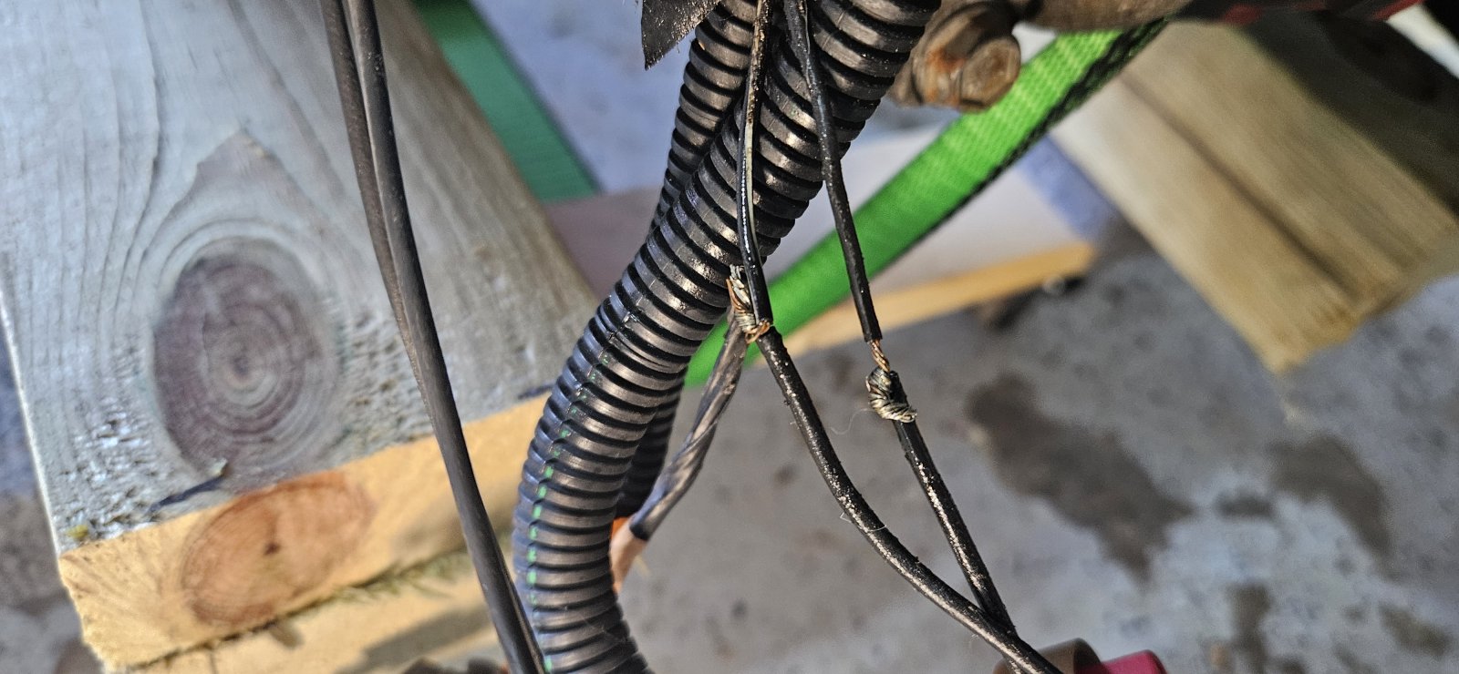

I've been looking at getting the front suspension set up. The arms seem extremely narrow, did anyone have this? I think I could make them flush by just cranking on the bolts but I don't want to go full muscle and break something. The upper arm is pretty close, the lower is pretty bad.
comegetjoe
Yes. I recall this being a thing. Tighten 'em down.

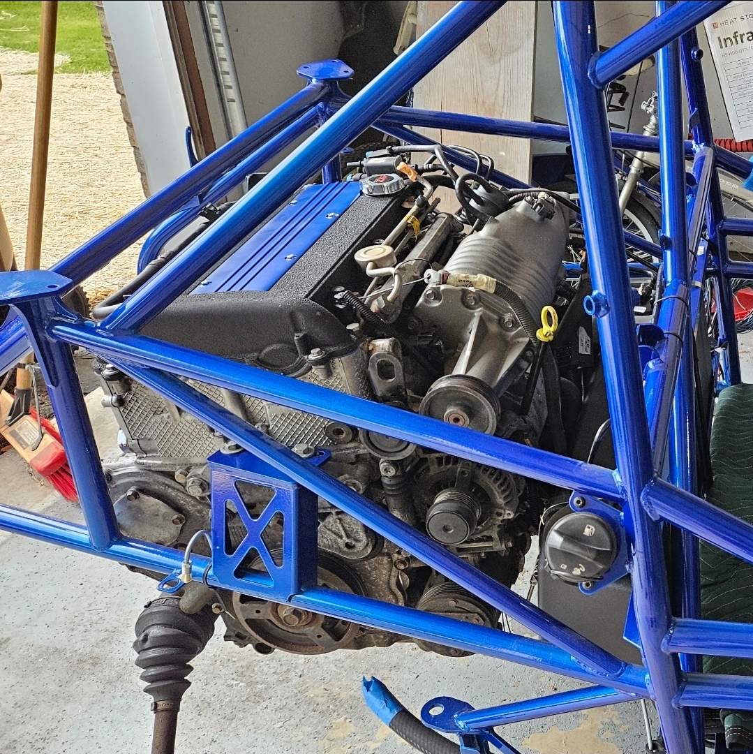

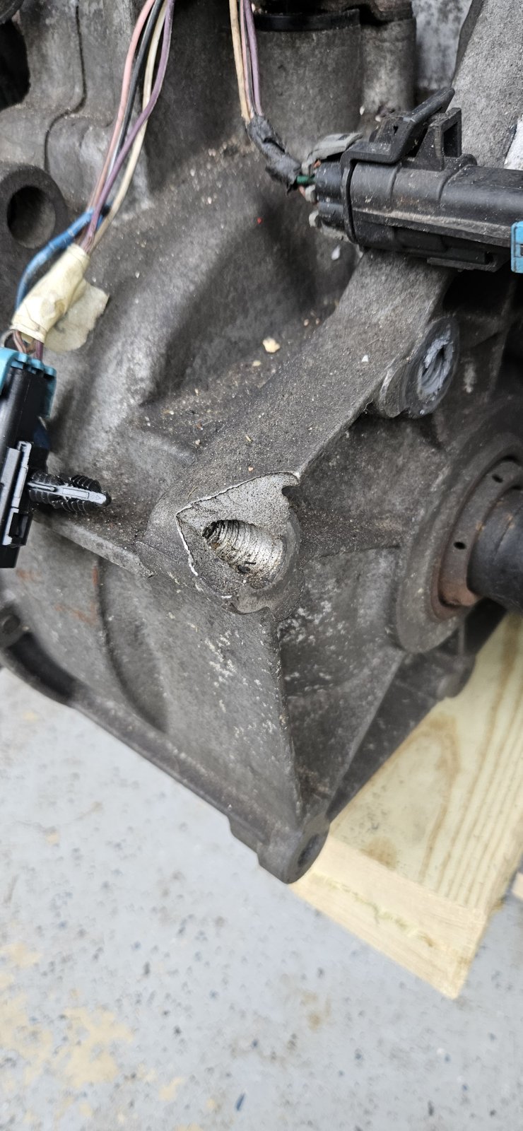

How important would you say the transmission mount is?
Is that the mount between the transmission/engine and the firewall? f so, I ran mine for about half a year without that mount as I had trouble getting it into place. All I noticed once installing it was more vibration through the frame. I didn't notice any engine movement with only 3.
It probably would be fairly simple to grab the other 3 holes in the picture to make a secure mount. The bottom holes might need to be tapped or drilled through since I don't remember exactly what their configuration is.
