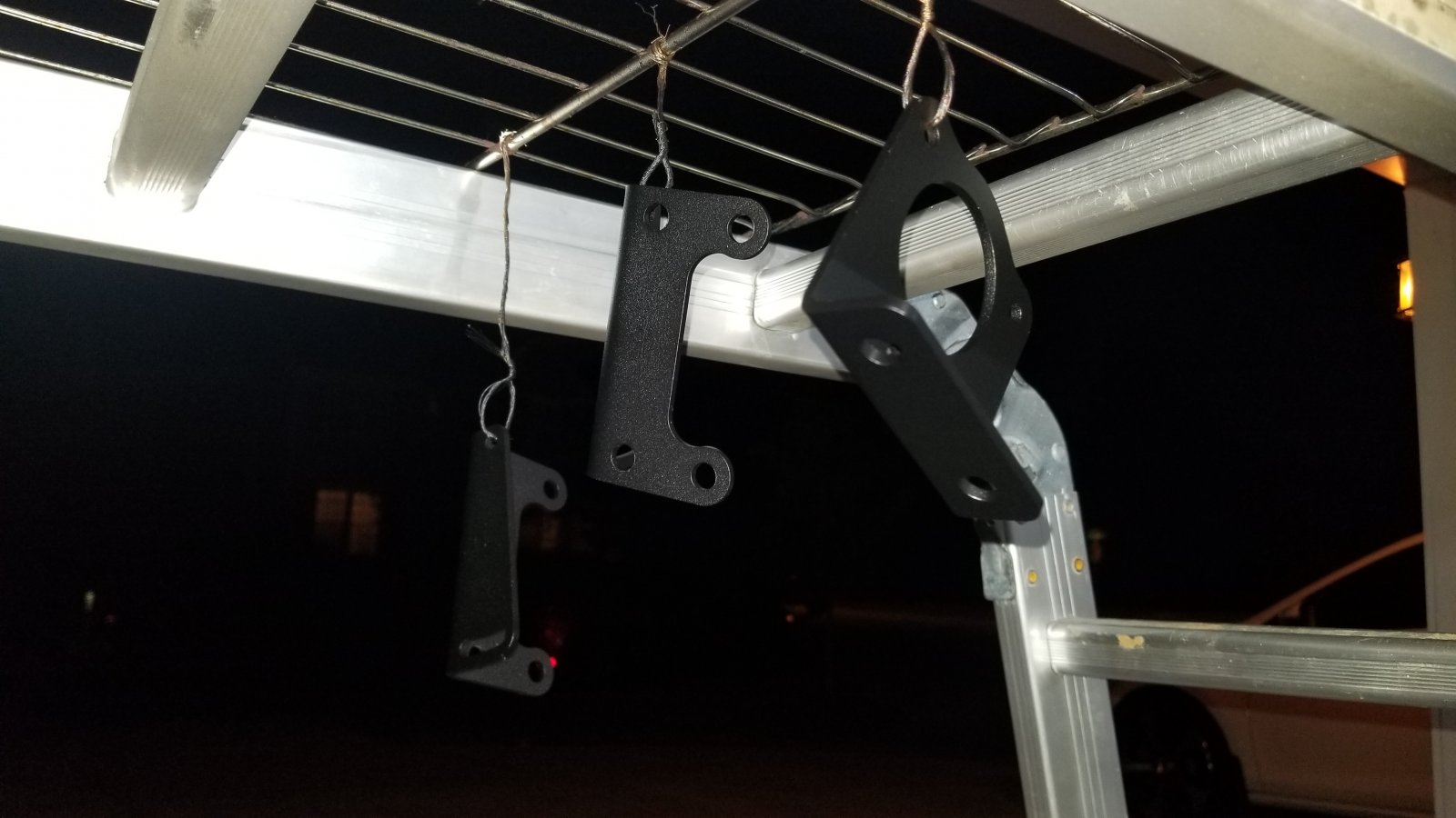

Started assembly on Friday finally, I took my time waiting to get it painted. I'm a little through video 18 now. Thankful for @OptimizePrime and his words of wisdom helping me avoid headaches from his recently finished kit. Lots of great advice.
So far everything is going fairly smoothly. Only missing a one screw clamp so far. The lazer cut panels aren't the best fit, especially the bulkhead one. That's currently proving to need some massaging and that sucks because it's already powder coated.
I wish DF hadn't used so many hex head bolts, they're a pain to use.
I also set up my powder coating wall oven and got some of the smaller brackets done. Pretty pleased with the results. Black Cast is a fantastic color.

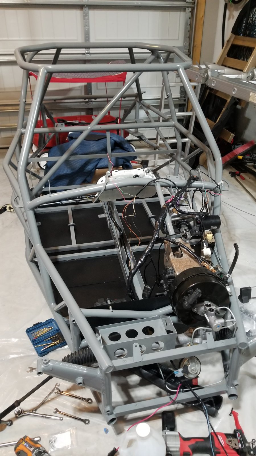

Having a 2 month old and a 20 month old means I don't get to work on this as often as I'd love to, however tonight I was able to get some work done.
I installed the fuel tank, fuel sender, and straps. I took @Zoom Zoom's advice and protected my tank from the straps scratching it, thanks for the tip!
I tidied up the harness in the front area but didn't fully install/plug everything in yet.
I installed the swivel ends on the a-arms and installed the passenger-side arms. I have to say, that bottom a-arm would have been a lot easier to install if I had done it prior to putting in the BCM and steering rack in. I couldn't get a socket on it to torque it down it was so tight in there.
I didn't get around to doing the coil-over's yet, I don't have a good set of snap ring pliers nor do I have any anti-seize.
I alumawelded an AN-16 fitting onto my thermostat housing but I am extremely nervous to actually use it. I'm not certain how I'm going to work about the AN-16 line without spending a billion dollars on AN-16 fittings. I bought 4 aluminum weld-on bungs and planned on alumawelding them to the engine and radiator, but I'm not sure I trust the stuff even though I've watched a bunch of youtube videos and they all hold up well. I'm afraid I'll burn a hole in the radiator while heating it up.
I have a few to-do's to knock out in the hood area such as:
  • My kit didn't come with the two silver screw clamps for the brake hose extension, so I need to go get some new ones
  • I broke one of the 45 degree brass fittings on the brake relocation kit, need to get another.
  • My brake pedal sensor sheared the bolt off inside it. I have a backup but I need to replace the bolt.
    • +1 on the bummer scale for already having to replace my clutch pedal and needing a Tech2 :'(
  • I bought Brad R's ignition switch replacement board and I'm not 100% sure what I want to do with it yet
    • However, I did grind off the circle clamp thing on the ignition switch like everyone else is going
