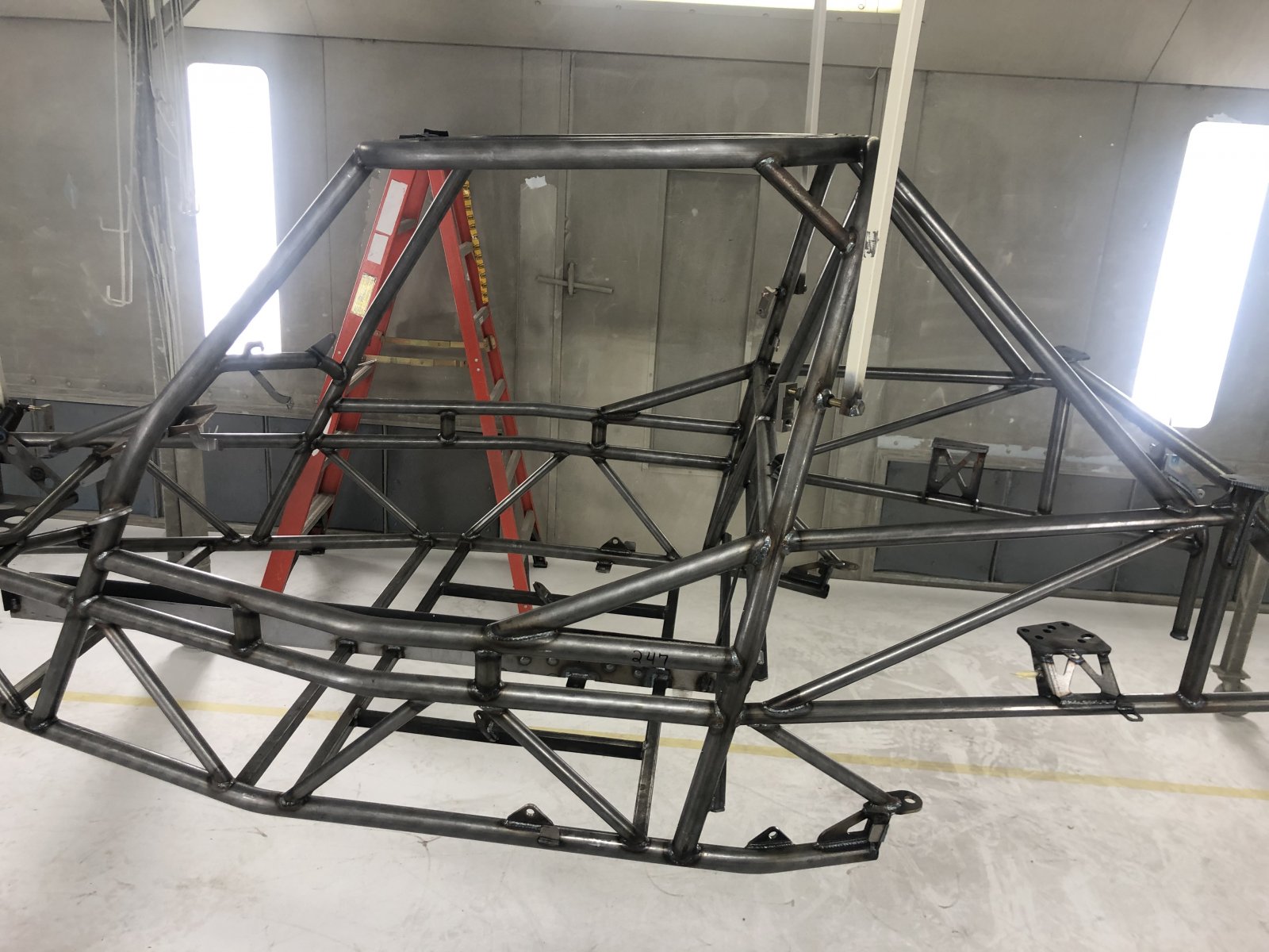

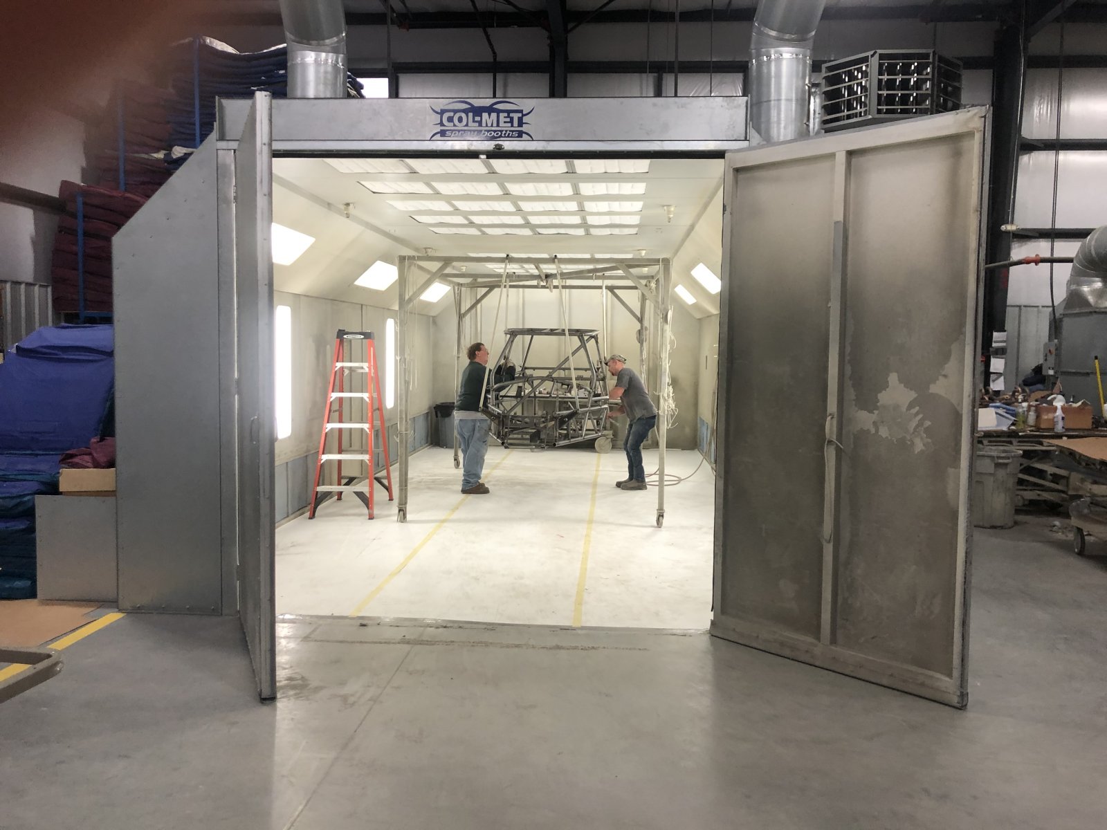

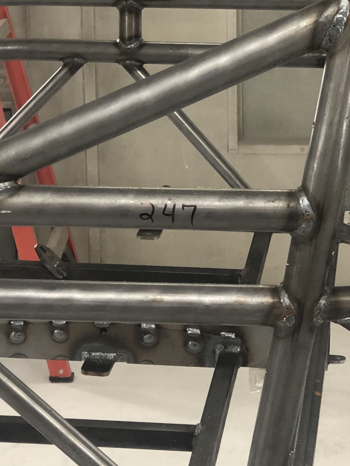

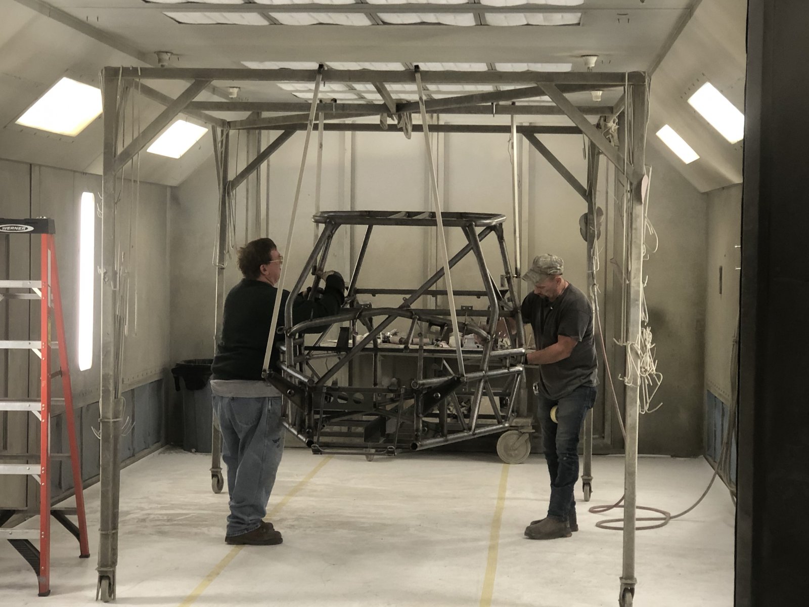

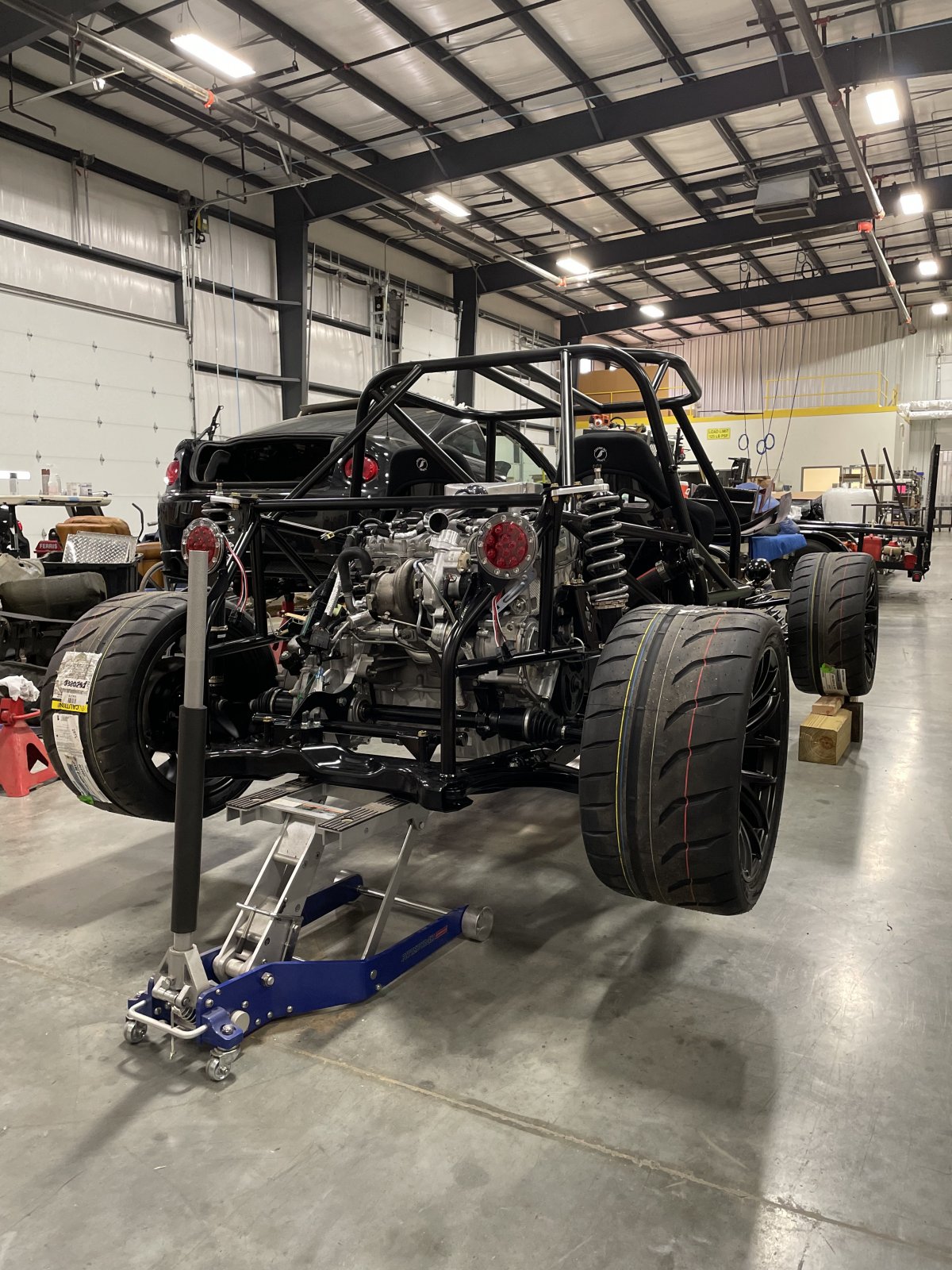

Friday 01/08/21 pushing the Frame into my paint booth. I consider Powder Coating however with having a Paint Booth an Painter on Staff. Well, it’s hard to justify the additional expense. With that being said, it’s getting Primer today!! Paint is ordered an is expected for Monday morning.

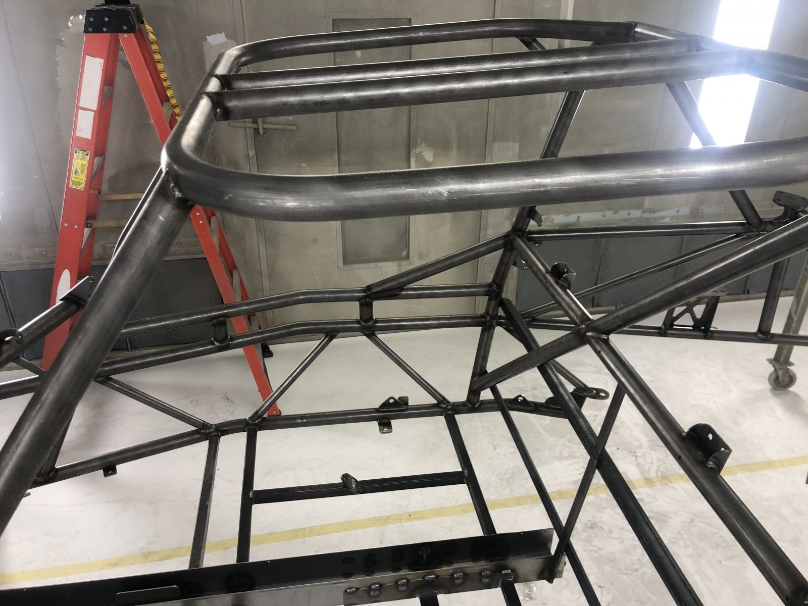

I’m attaching a few pictures an you’ll see the Special frame upgrades Lonnie an Adam did. I believe it’s called Modified Easy Entry/ Modified Full Roll Cage. Currently it’s the first car with the two upgrades. I’m loving it. More to come...

The modified easy entry has been delivered on a street frame previously (Askiles). Gives an interesting look to the track frame, not sure about the look. I spy the double monkey bars in the upper halo. Any other notable frame mods? F40?
2.0 Turbo
Correct, the modified versions have been done a couple of times. However, this was the first that incorporated the two options on one car. I realized I wasn’t very clear after I had Posted that.

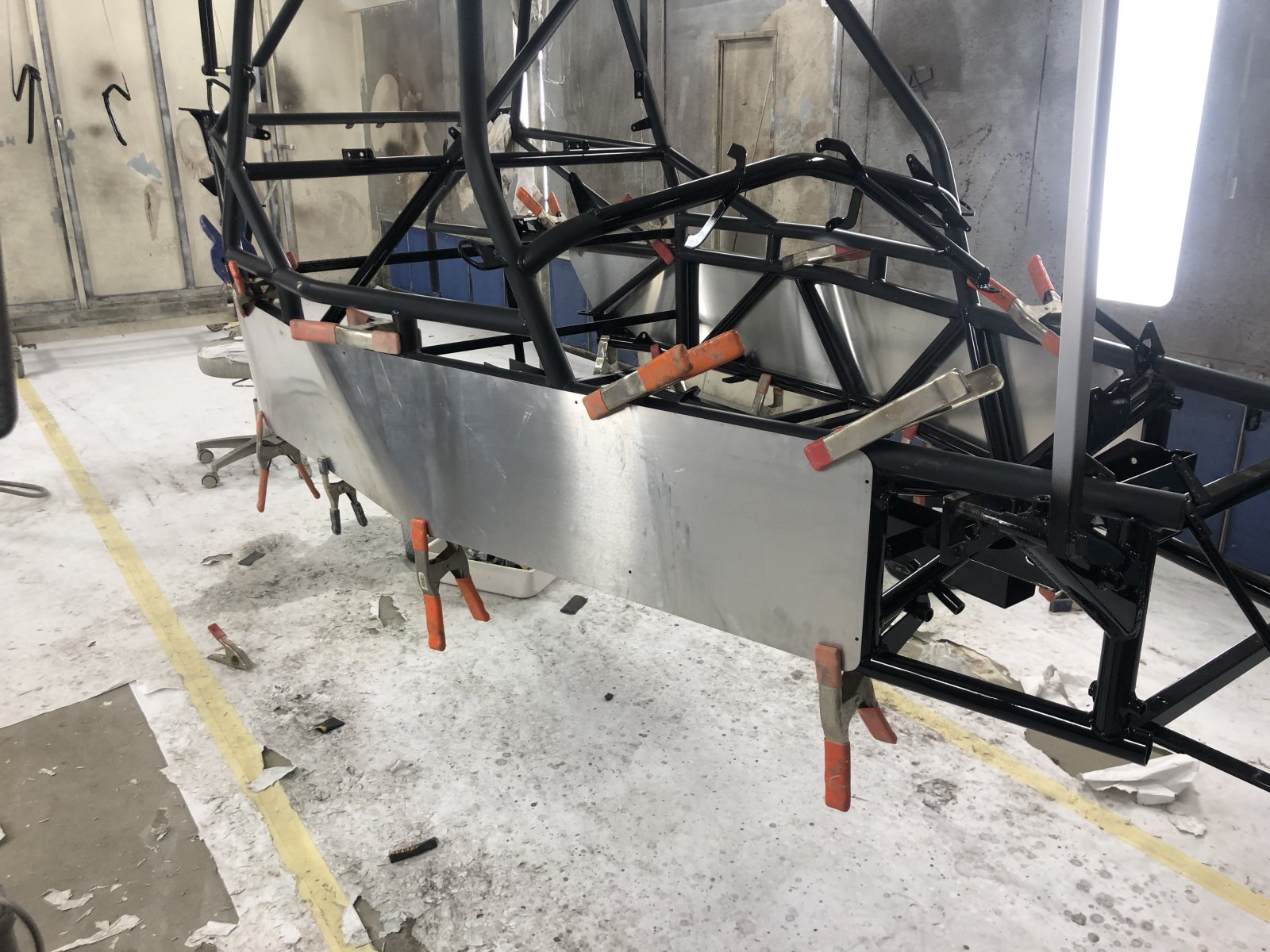

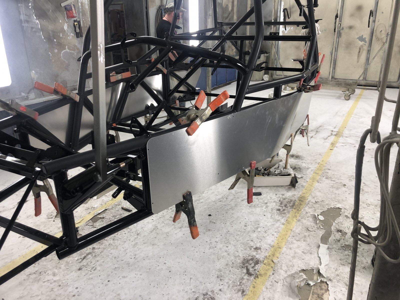

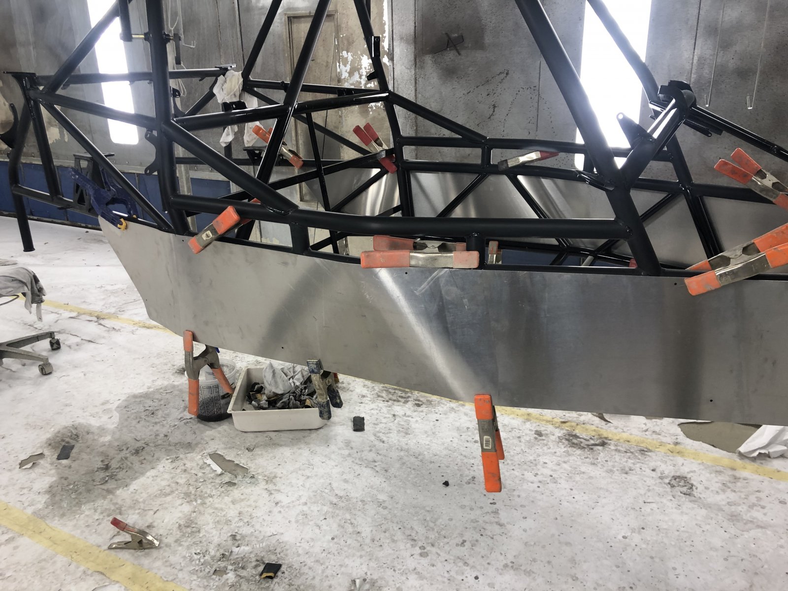

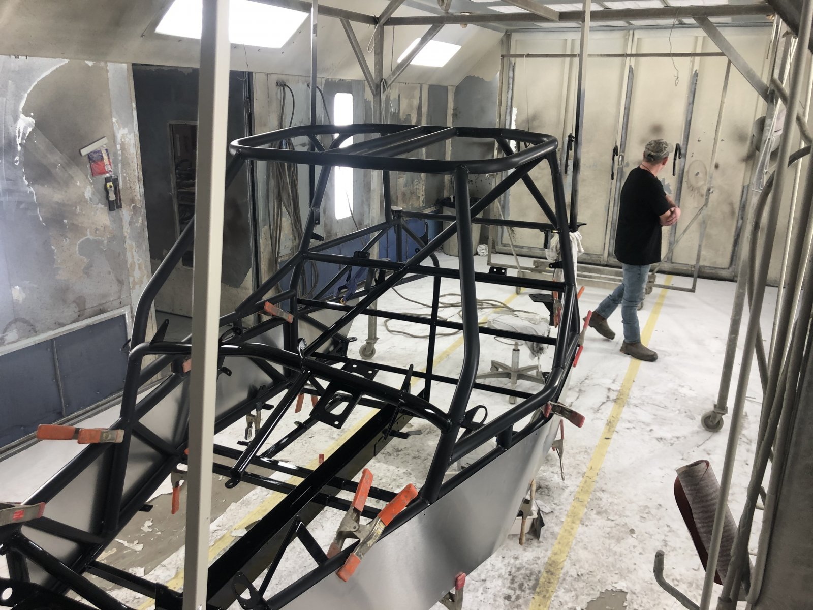

Test fitting an drilling holes for attaching side panels. These clamps worked well for getting everything lined up. Once I was happy with alignment I center punched the holes.

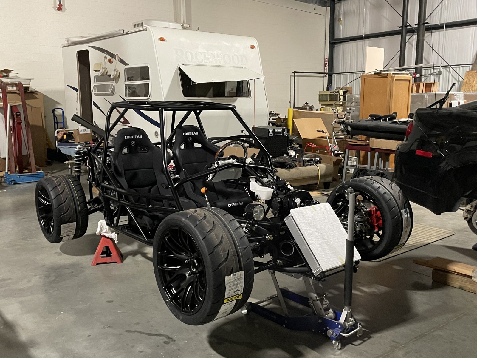

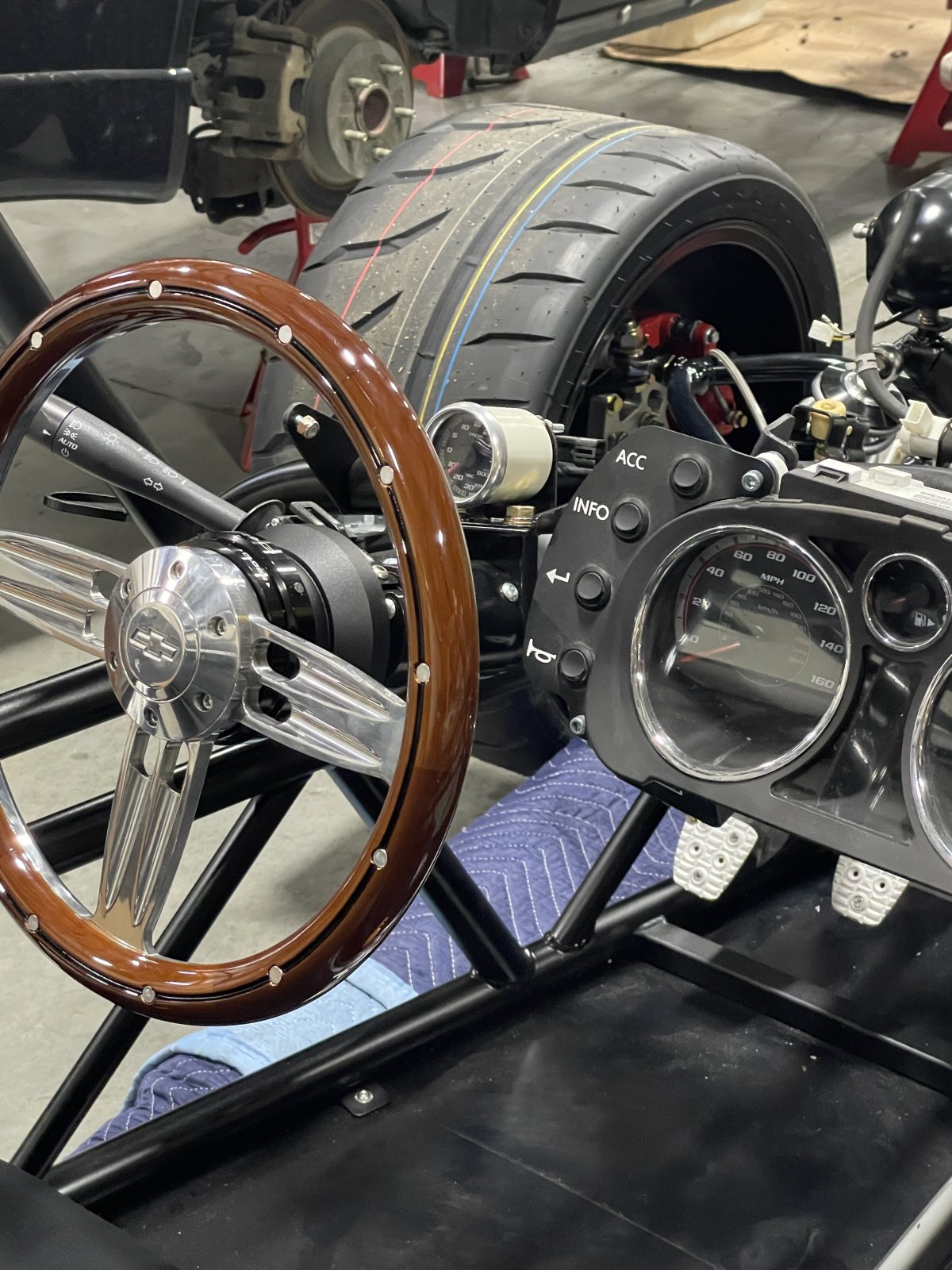

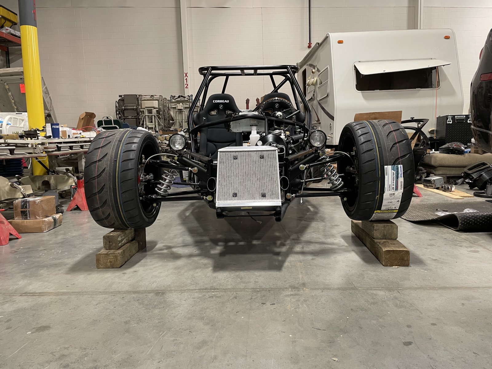

I’m still moving forward as time allows. My first thought was replace only parts as needed an go from there. We’ll, that plan changed quickly! In the end I didn’t use too much from the Donor Car. Definitely looking forward to meeting others in the near future. At this point my goal is to attend the Tail of the Dagon this October. Sharing a few pictures…
