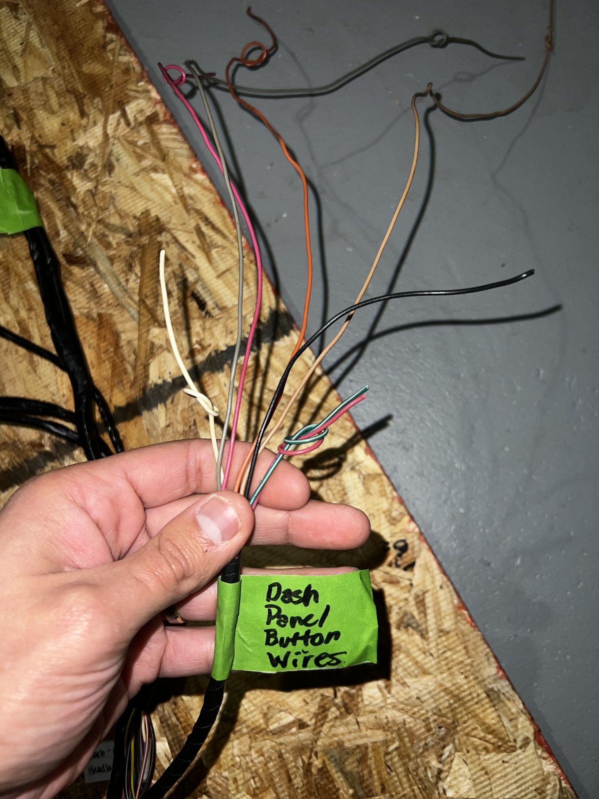

The 1st picture is what I have saved for the button panel. 2nd pic is the list that is sent with the order, I pulled that from the link I mentioned above. The pink and green wires I have tied together are from the gauge cluster and feed the info & return. I have an 06 with a 4 spoke wheel (early model). The late model, seeing in your profiles “about” section states you have an 09, will only have a green wire as mentioned in the wiring harness videos.

Well this picture 3678 explains the ACC, Accessory. Never saw that picture before. Funny thing is, my car had Fog left them in the harness for exact that purpose. Meas ACC switch is clear.
I have the Darkgreen/White cable ciruit 1358 going to the instrument cluster. From the Picture, this should be the Return signal.
But in the steering wheel schematics this circuit is not showing up.
I tried to pull that wire up to 12V and down to ground to see if the DIC changes, but nothing.
The pink cable with seems to be the info button seems to be missing. Now the issue is, I don't know where the pink cable is supposed to becoming from. The wiring diagram picture I posted earlier is the only place where I found the Info and Return switch and they are not labeled in a way that I can find where this cable should be coming from.

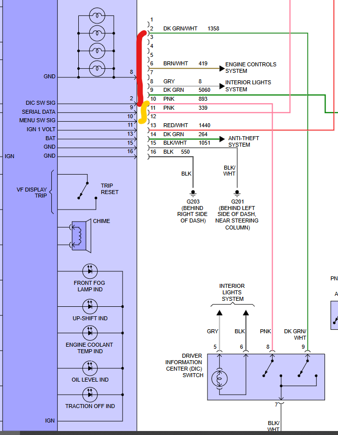

This mystery continues. According to this
44665
The DarkGreen/White goes to pin 2 of the Instrument cluster and is the Return button. Circuit 1358
The Pink Wire goes to pin 10 of the Instrument Cluster and is the MEnu Switch button. Circuit 893
However, my plug on the Instrument Cluster has this pin layout.
And here comes the DarkGreen/White wire Circuit 1358 on Pin 5, while the Pink wire is not existing at all.
Pins 2 and 10 are not wired up in my car. So the diagram picture I posted above seems to be wrong for my car. I will try to just ground Pin 2 and 10 of the IPC Plug and see if the DIC changes.

Looks like you found the other two. "Info" cycles through the electronic display on the cluster. "Arrow" is enter. You hold it to reset your trip odo. These two follow the same path and use resistors to let the computer which button is pressed.
Aha!! Do you know the resistor amount??
Your donor has the late model wiring for the info/return buttons.
The picture above with the pink & dk green/white wires is the early model buttons.
Here is a picture of the late model wiring, with my comments on how to wire the early model ones over top of it.
Resistors are 715 ohm on the return button, and 1270 on the info button.

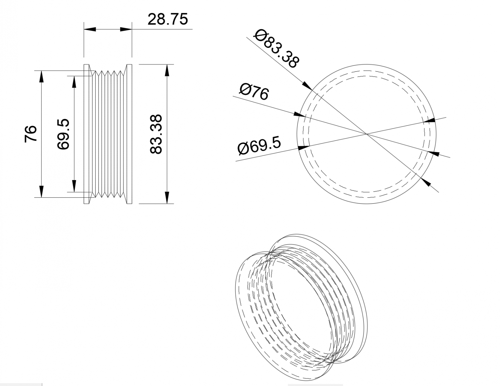

I simply created a quick drawing of the pulley I have. Is your pulley smaller?
So it seems I have the Stage 2 Pulley?
There is 100% no where on my pulley a 77.9mm measurement. Just the stamp upfront says 77.9.

Awesome, just tested it and it works!

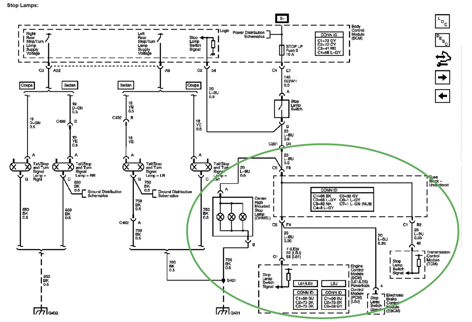

Well, this is all very weird. Spend the complete day to figure out what is going on.
First of all: I had to find out the real wiring of my tail and head lamps. Unfortunately I have no diagram of those and could not find one online. Anyway, figured that out.
Then like Ross said, Black is Ground and Brown is Running light. Yellow is the Turn light.
However, before I even came to this point, I switched the car on this morning and the tail lights were illuminated right away. First I thought, the stop switch must be bad. Disconnected the stop switch, but no change. Then I found out that on the top side of the switch I have 12V as supposed to and on the bottom side around 8V coming from somewhere. I checked the connection back to the BCM C2 54 was also getting the 8V and that seems to be enough to switch on the tail lights. Hmm, then I looked for the C201 plug which I could not find until I remembered that this was one of the plugs which were cut of of the harness.
Then I disconnected the C3 Plug of the FBU. And the 8V were gone. For the moment... Aha, so something from the FBU was feeding voltage back to the system. Tried to figure out where it came from and ended up cutting the wires to C3 F3 and F4 one by one.
I have now identified the cable which comes from the 3rd brake light and the cable which comes from the Stop lamp switch, I also found the wire which goes to the Engine Control Module. Now the tail light works as expected. Running, Turn, Stop and Reverse. The 3rd currently can't work due to the cable being cut. However, all the sudden my front lights stop working at all and it seems like I forgot to pull the ground wire. I have 3 wires high, low and park. No ground. I pulled temporarily a ground to the front lights and now they are working again. My front lights don't have a parking lamp so this cable is not used in my goblin, but the wire has voltage when park lamps are on. To be sure I pulled the high and low beam fuses and confirmed that the front lights are connected correctly.
Well the story continues. All the functions, park, turn, brake, hi and low beam are working. But when the car is off the park wire has 8V again.... Furthermore when I turn on the turn signal, the little park LED in the turn signal goes off when the turn signal goes on. They are blinking opposite. Well, I thought maybe not a good ground at the turn signal and pulled another temp ground, but no change.

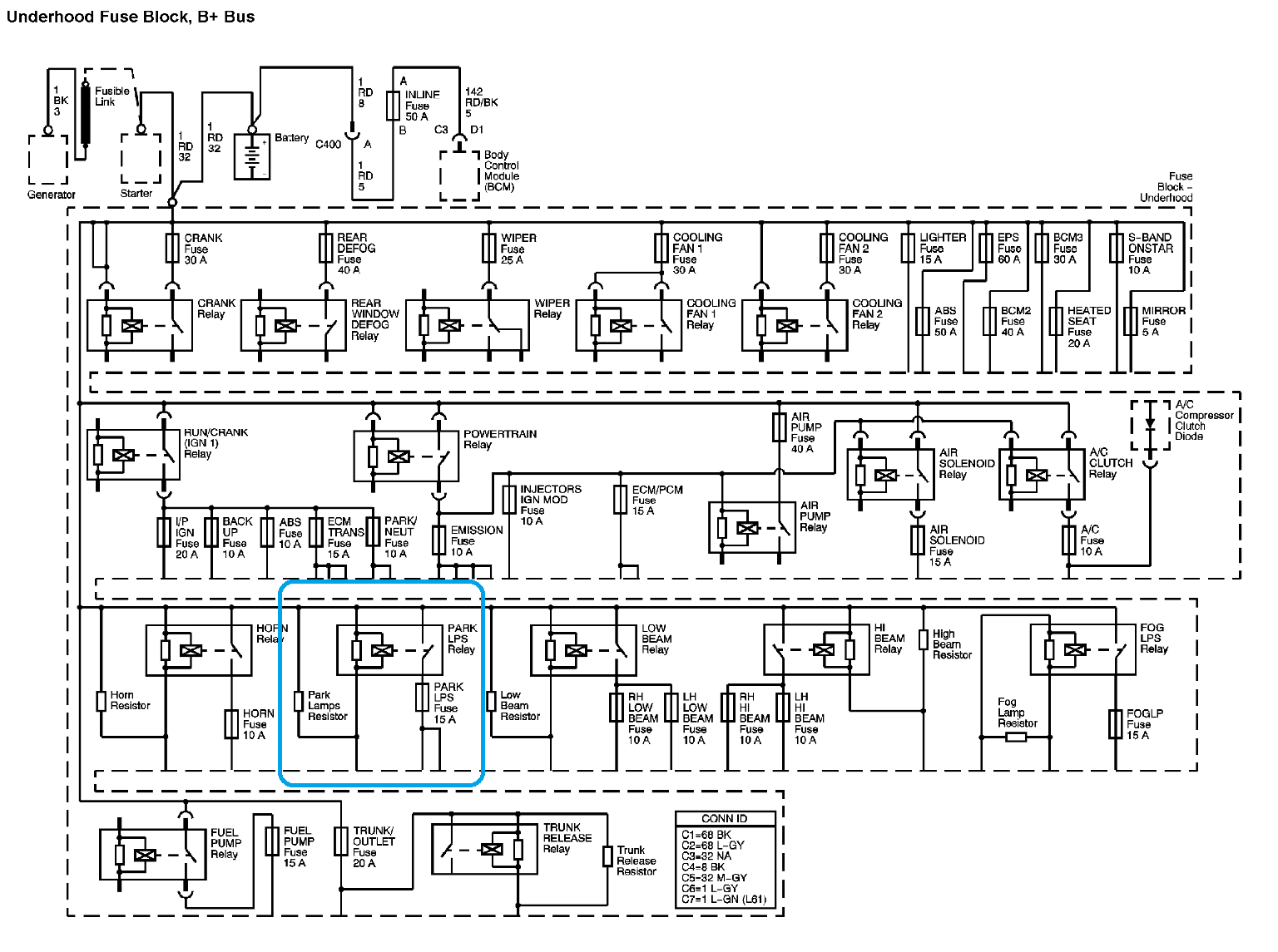

For some odd reason the Park fuse now has 8V on both sides. I wonder if the Park Relay on the PCB board is damaged. The manual says it's not serviceable, but I don't believe that :D Has someone done that? Or any better idea where this 8v could come from? If I pull the park fuse, the park lights in the mirrow and front are not working as expected. But also the running lights on the rear lights are not working. I wonder if I should just pull another cable and put the rear running lamps parallel to the front lights.
Anyone any good ideas what to check now?
I first thought the problem with the 8V came from here, but now I find out that the 8V seems to come from the park light.
44697

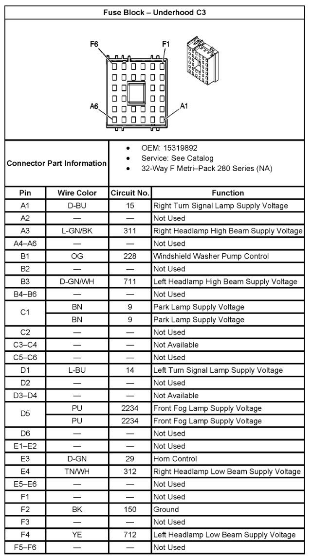

Since pulling C3 fixed the 8V issue, I started there. On my 06 LSJ, The C3 is mostly lights.
So I would start by pulling the lighting fuses one at a time, and see if that one of them is introducing the 8V.
My 06 LSJ has 4 10A fuses for the headlights, a 15A for the parking lights, 10A for the backup light & 15A for the fog lamps.
If it isn't one of those fuses, keep pulling fuses and testing... find out which fuse stops the stray 8V.
44704

I think there is something going on with the Park Circuit. If I pull that fuse and measure at the connectors of the fuse, the side which points to the center of the car has 12V the other side nothing and no 8V on any other point. If I put the fuse back in I measure on both sides of the fuse 8V. For me that sounds like the PCB relay is not interrupting the circuit correctly. As long as I just measure I get 12V but as soon as I have load on the circuit it collapses to 8V. But if I leave the Park fuse out the rear running lights don‘t work anymore.
Try soldering on a new parking lamps relay? It is the only thing between the 12V power and the parking lamp 15A fuse.
Guess you should test it first. Measure resistance between the 12V post on the FBU, and the 12V side of the parking lamp fuse. Should be under 1 ohm... but if the relay contact is worn out, it will be > 1 ohm.
I see the parking lamp 15A fuse in the fuse box underhood, but I don't see a removable relay for it, so I am guessing it is soldered onto the PCB board.
44705
