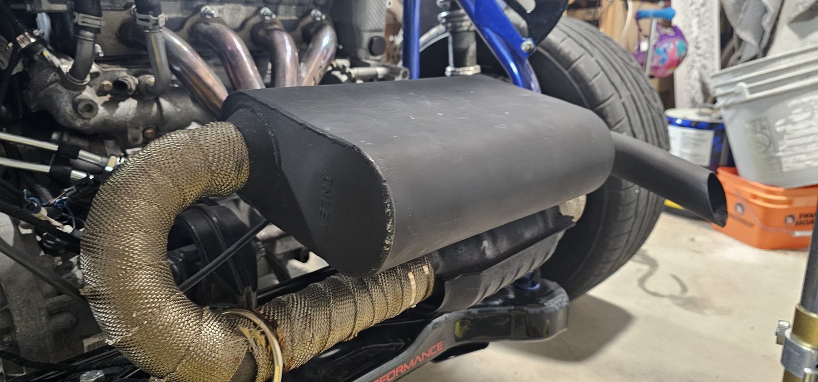

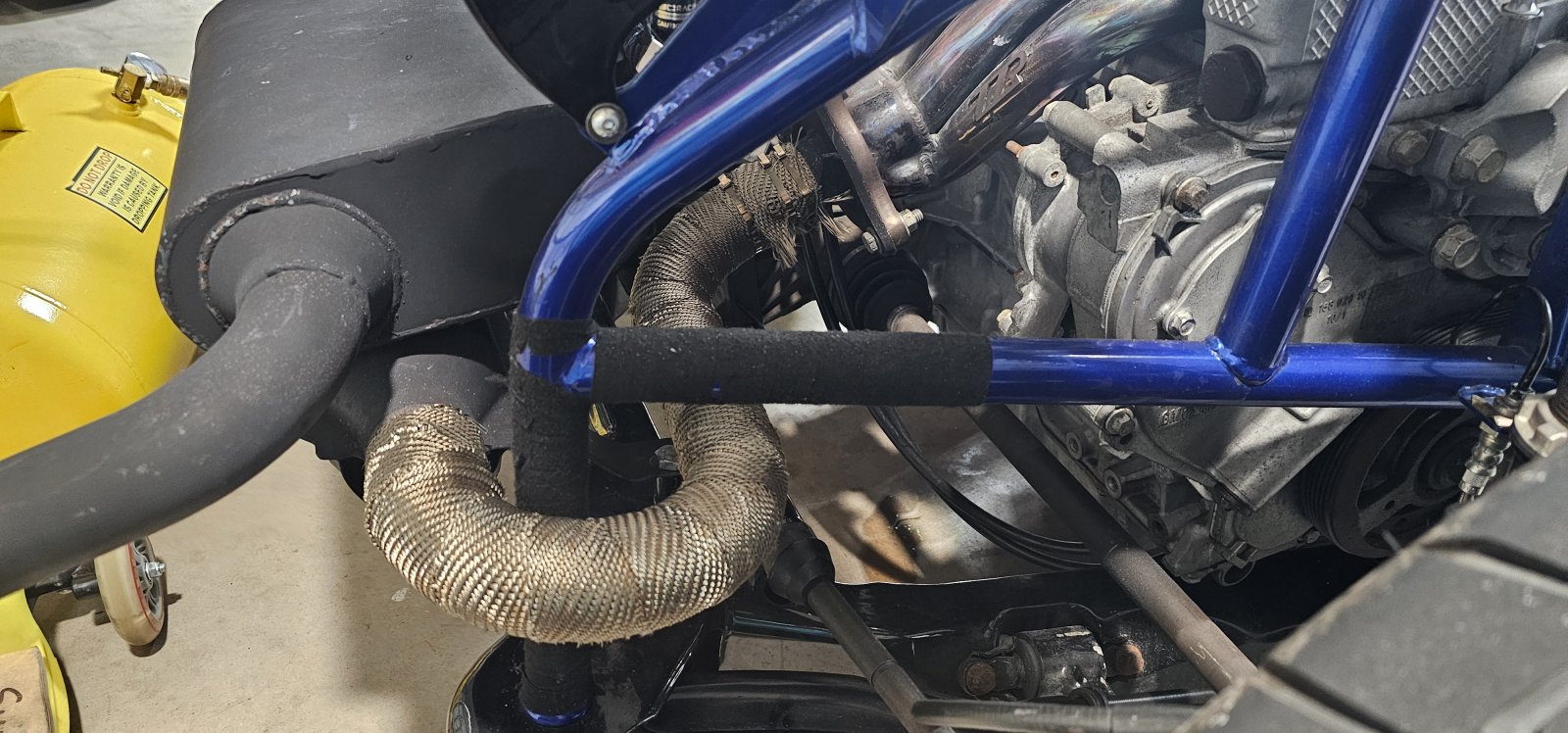

Can you share a picture of your exhaust?
The wideband should be about 18" away from the head. Too close and it burns up, too far and it responds slow.
M
Hmm, the manual call for 24in.
Will have to stop by a muffler shop and ask if they can weld the bung in
