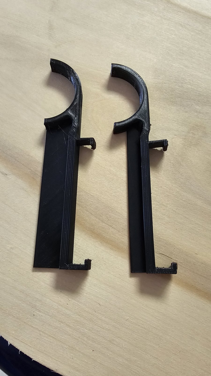

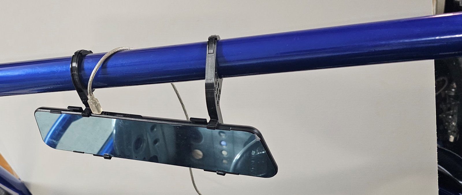

Hi all,
I was really missing an inside mirror in my Goblin. I bought this Mirror with dash cam from Amazon https://amzn.to/45jdmgg and designed some brackets.
After a few iterations I had the right angle and stable design. The cable needs to be routed nicer. Will do new pictures when it's all done.
I uploaded the files to cults. Print settings and material as well.

The mirror I used has 2 cameras as well. It's with an 4.5" display, it's just hard to see in the sun.... Still working on my roof but I belive I'll print some smaller sun shade for the mirror interim. :)
The reverse camera isn't mounted yet, as I first need to print an adapter for the 12v outlet and clean that wire up mess.

Well, my original design vibrated, but after a few rounds I found a design which works.

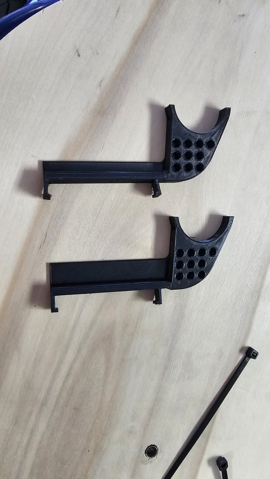

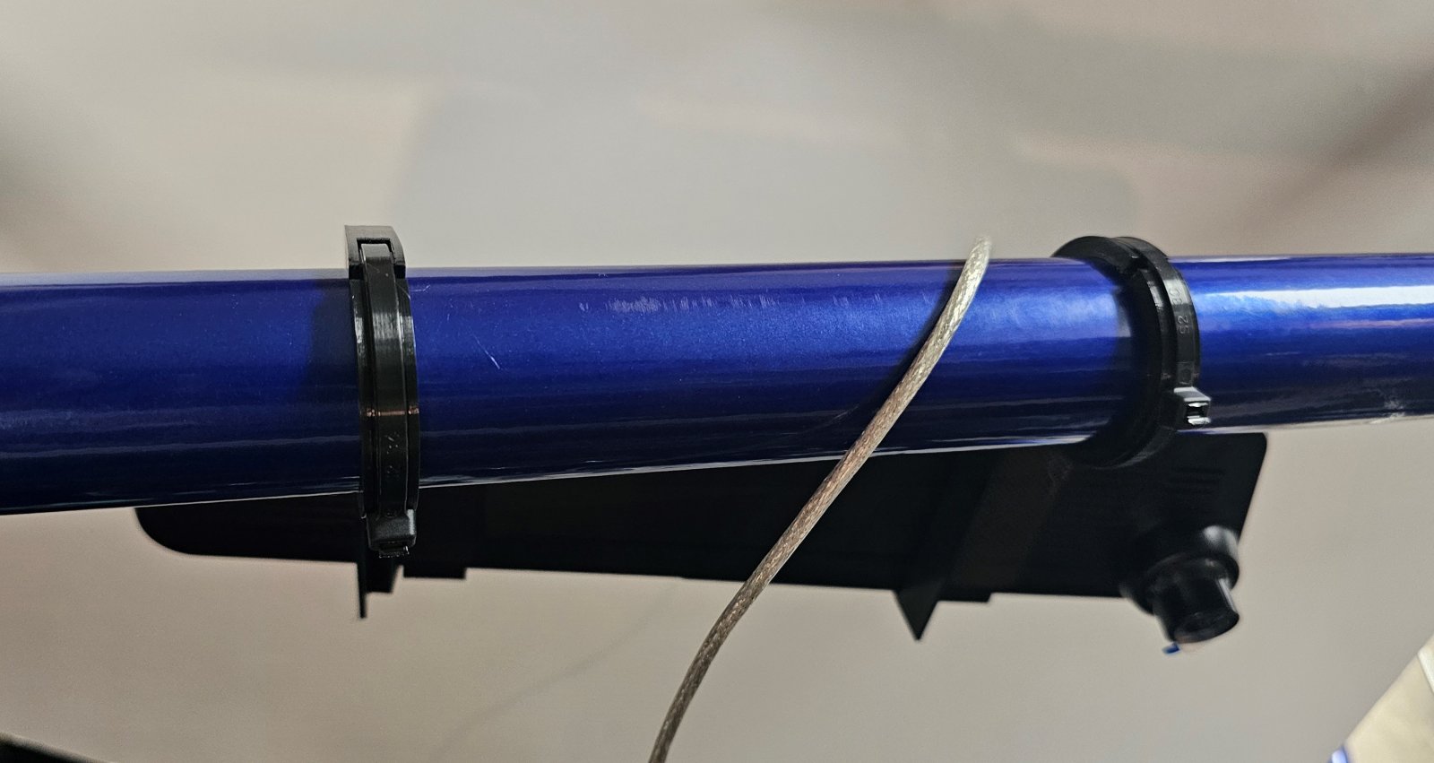

All, I blieve I uploaded the wrong part to Cults. I think Version 1.0 was a mirrored version of what you need. Sorry for that. I just uploaded an even better version 1.1 this time it's for sure correct.
@jamesm This vibration thing is now becoming an OCD. I looked at the mirror while driving and saw some vibration. I beefed the part up and desinged Version 1.1. Funny is, if you look in the mirror, now you can see that the upper part for the rear spoiler starts to swing from 30mphs and more. I will put my gopro on the wing at some point, to get a close up video for that.

You might try adding some weight to the mirror. We use to do it to motorcycles mirrors. Some lead shot or fill it full of silicone if it’s hollow. Helps dampen vibrations.
