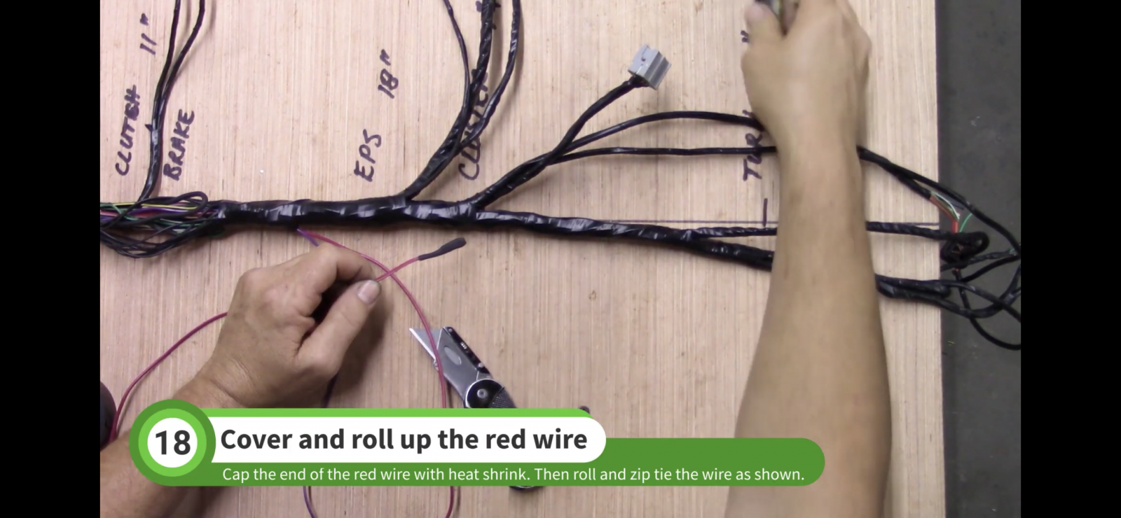

Behind the dash I have two wires; a purple and a red. I believe the purple goes to the ACC button and the red would go to an intercooler fan, but I didn't use one. I'm not getting power to these wires and I'm guess I might have blown a fuse. Does anyone know where the fuse for these wires are located? Would it be the fuse box by the engine or the one under the kick plate?
Not sure about the red wire off the top of my head, but the fog lamp fuse is in the engine fuse box:
R
Video 11 doesn’t mention what it is for. Just says to roll and zip tie it. Must be key on power for any accessories you want to run like... a radio? ;)
MisterDave
The purple wire is fog... I found the fuse, looked fine. So I'm not really sure why I wasn't getting power to it... maybe something with the switch...
After a quick email and response from Lonny, the red wire is labeled at amp. This fuse is located in the front panel. That fuse was blown... I replaced it and there is power to the wire. Looks like it is always on, not a key-on wire.

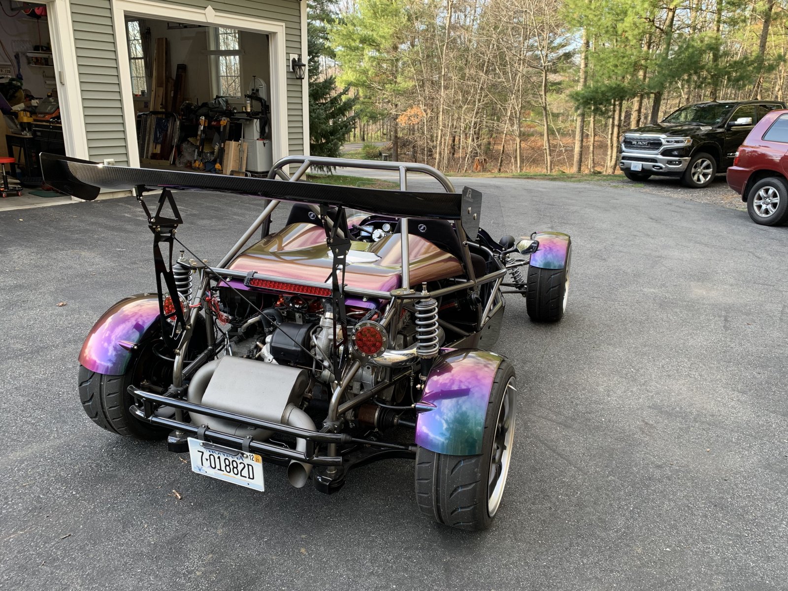

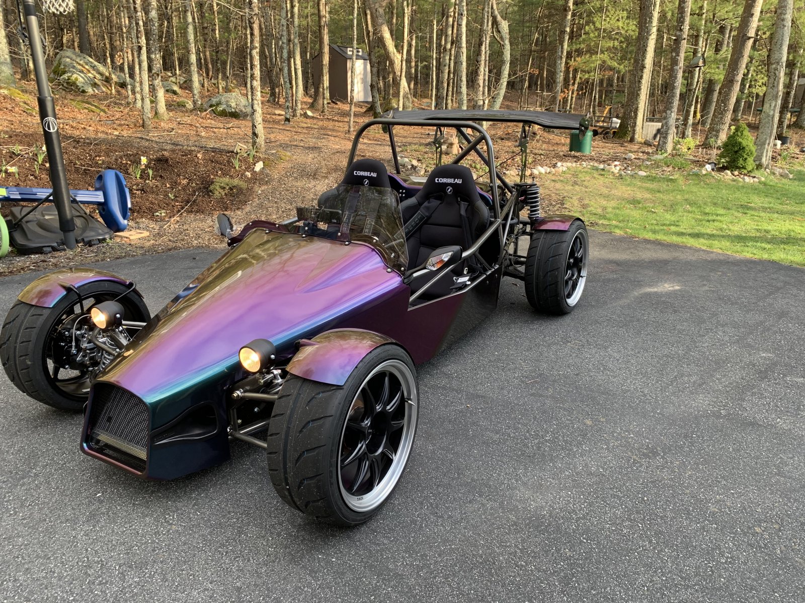

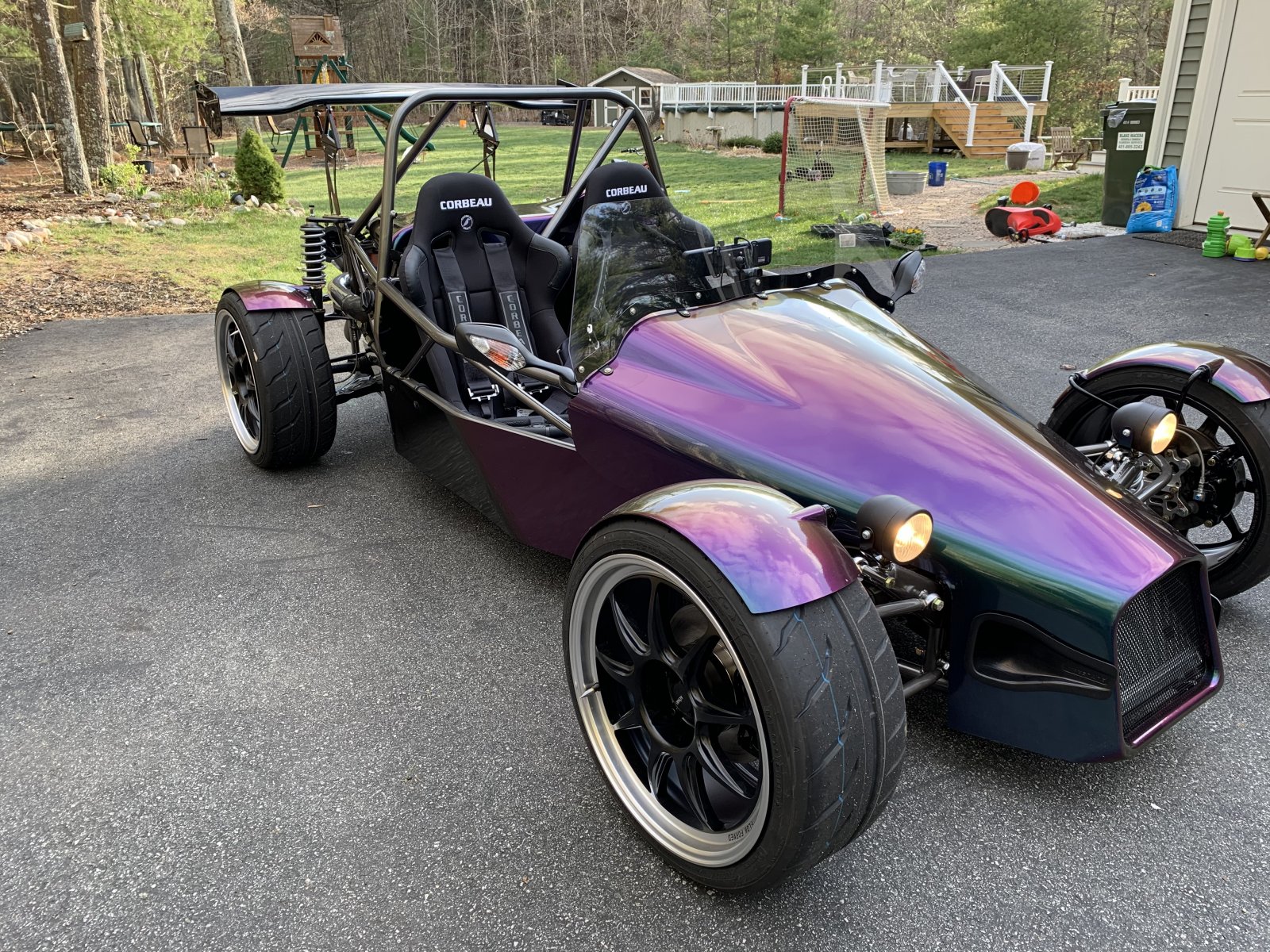

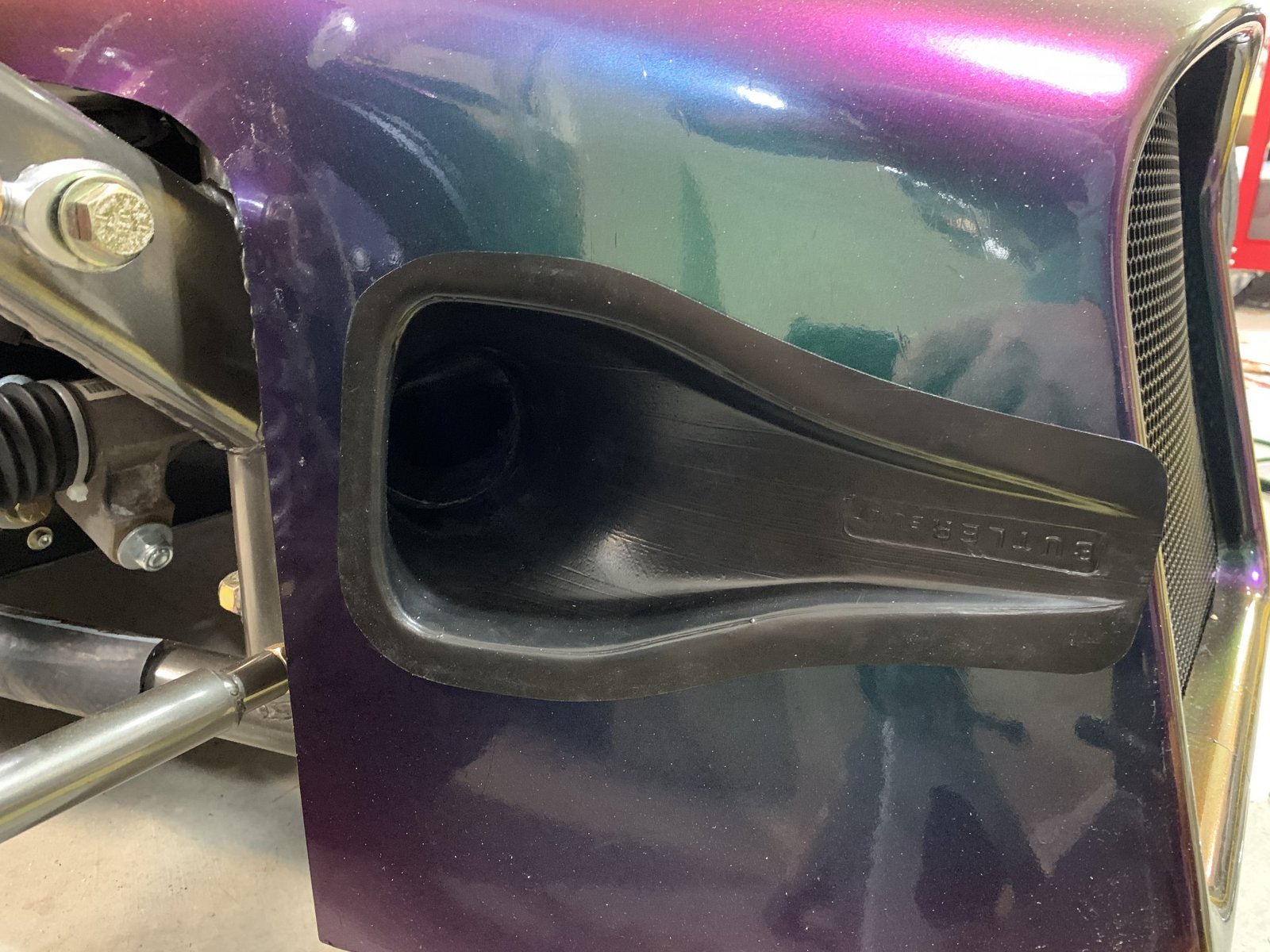

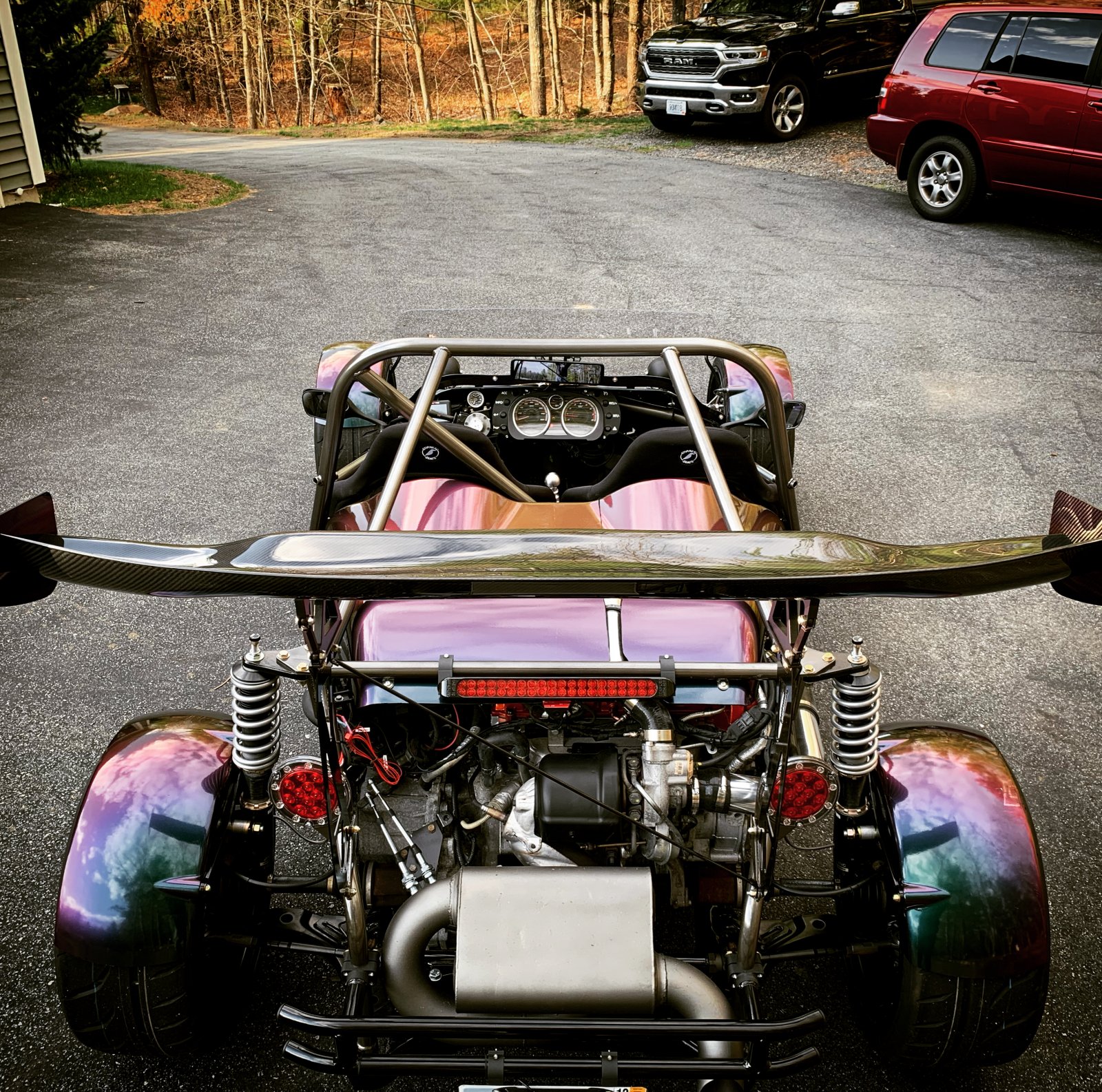

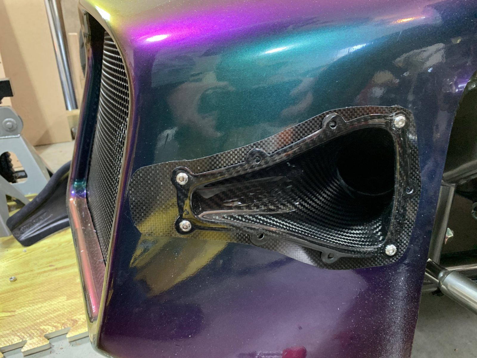

I’m hesitant to say it’s finished because there is still a list of things I want to do. But it is now registered and insured and ready for its first drive on public roads. So.... is it finished? I still want to change the way the naca ducts are attached, upgrade the shifter with the new setup I purchased from sactx, and then there are some interior wiring and mounting of accessories. Oh and possibly change the headlights. All of those things are outside of the “kit” so maybe I can say I’m done.... maybe
Zoom Zoom
I’m hesitant to say it’s finished because there is still a list of things I want to do. But it is now registered and insured and ready for its first drive on public roads. So.... is it finished? I still want to change the way the naca ducts are attached, upgrade the shifter with the new setup I purchased from sactx, and then there are some interior wiring and mounting of accessories. Oh and possibly change the headlights. All of those things are outside of the “kit” so maybe I can say I’m done.... maybeView attachment 22988View attachment 22989View attachment 22990View attachment 22991
That’s the first time l’ve noticed a wing being mounted that way , I like it :)
