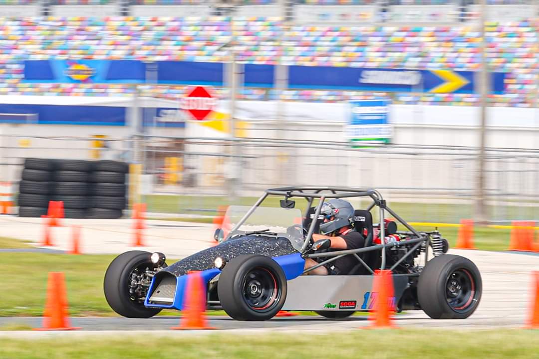

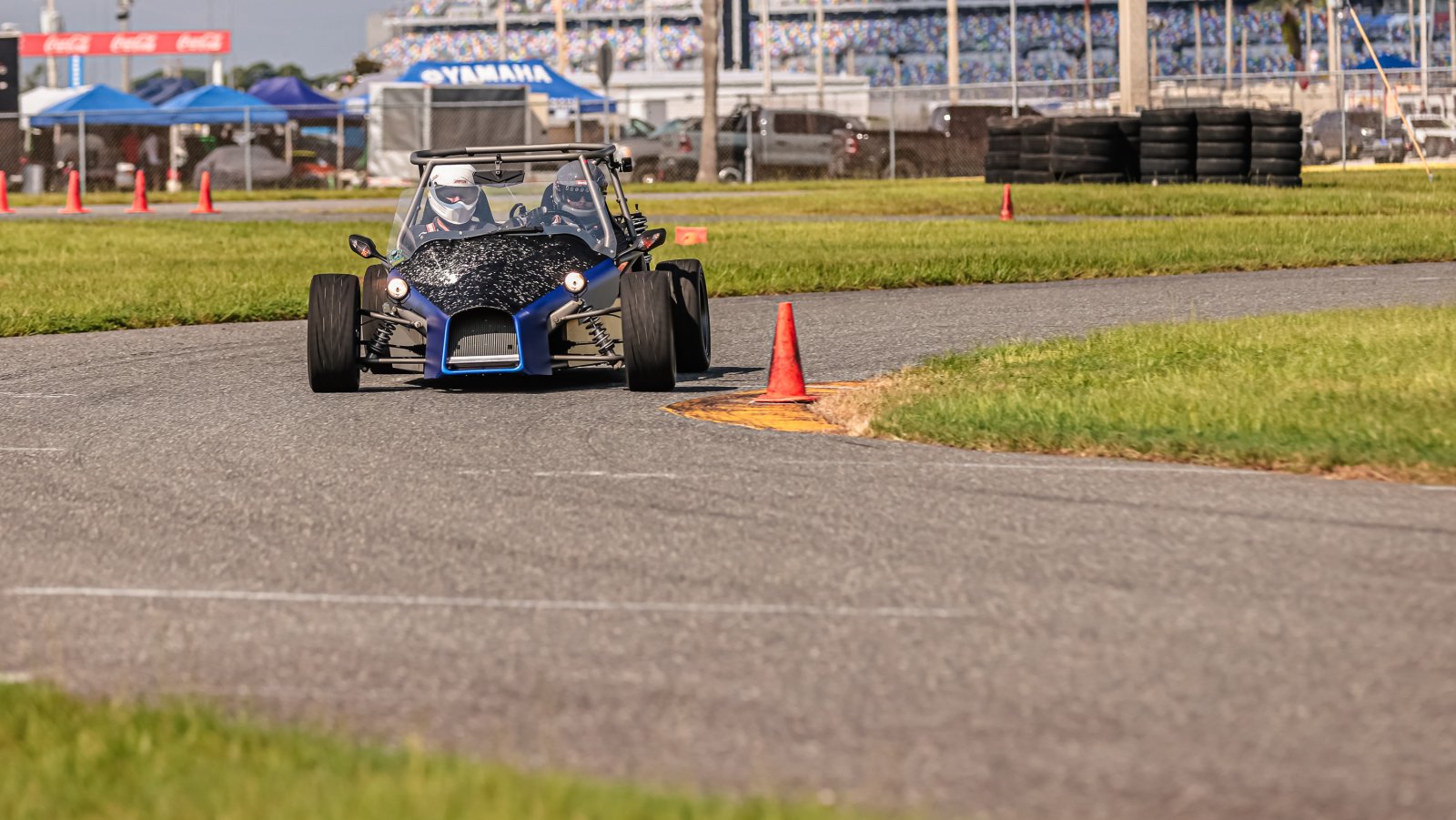

Some random photos from the last autocross at daytona.
43602
43603
Check out that rear tire :oops:
43604
After looking at these photos I'm beginning to thing the slicks have so much extra grip that the rear suspension might be flexing. I'll put a gopro on it next time I have those tires on the car. But they were good for a 2 second quicker lap than I did last I was here on my street tires.

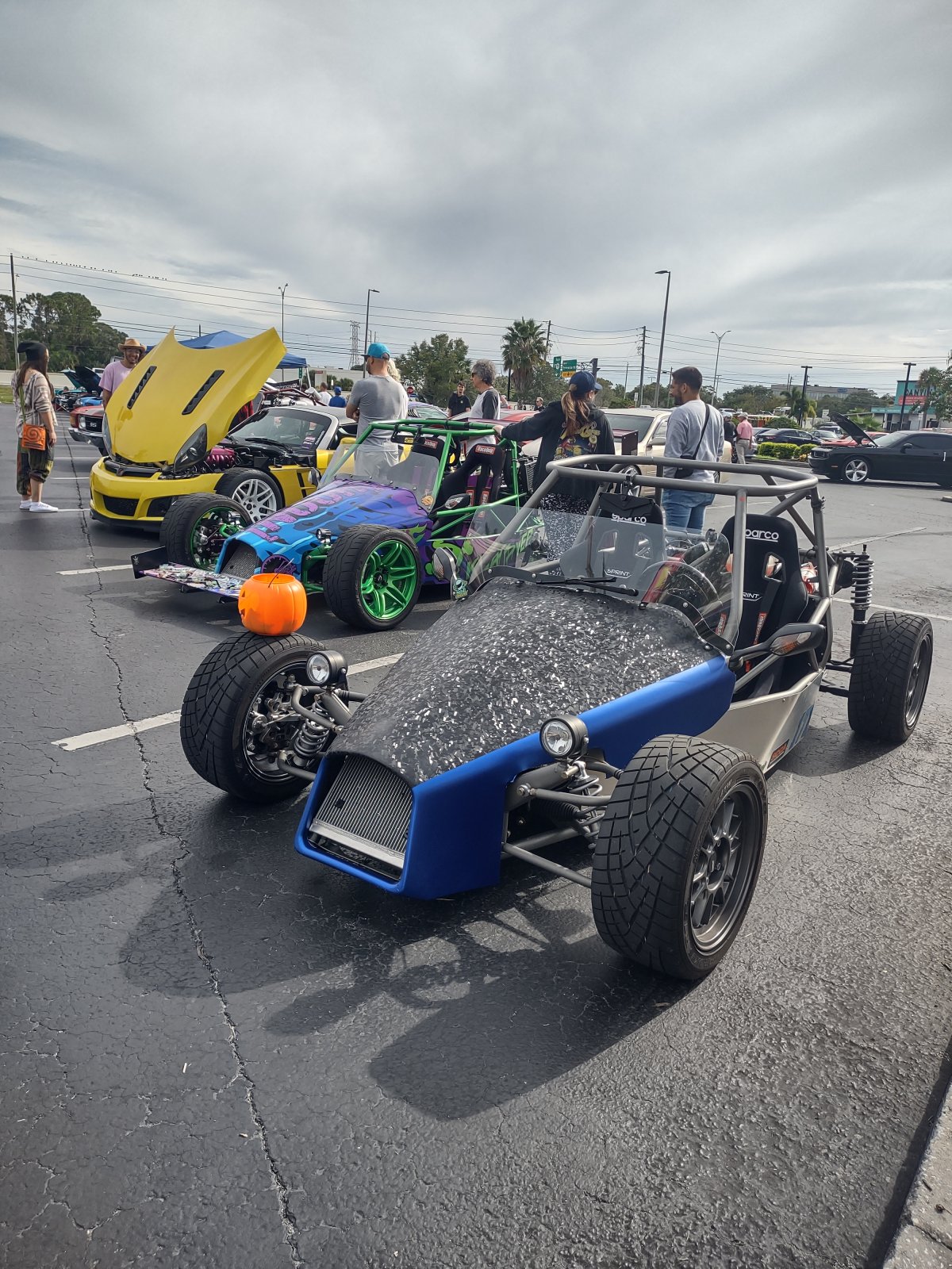

Also hit the local cars and coffee with my neighbor and his goblin a couple of weeks ago. That's his 2jz swapped sky as well.

I’m coming for that title at Orlando :cool: . I’m curios to see your slicks on the smaller course. Do you have stock bushings in the rear arms? I know some people complained about them flexing too much in the past. I have the moog ones and they keep true so far.
MX184
I think if you make it to Orlando it would qualify you for the end trophy. You've beat me at every event you've shown up for, I think I have to finish ahead of you in Orlando and have a car or two between us to win overall. So you better show up cause its yours for the taking!
I have stock base model arms and the stock bushing on my right now. Paul put the ZZP arms on his car and offered me his LSJ ones when I want to try them. Which I may do eventually.

I’d absolutely switch to the other arms or moog bushings when you can. I changed the circular ones not the front smaller ones. If they were flexing and changing toe that could make it very unpredictable, especially with your corner capability.
