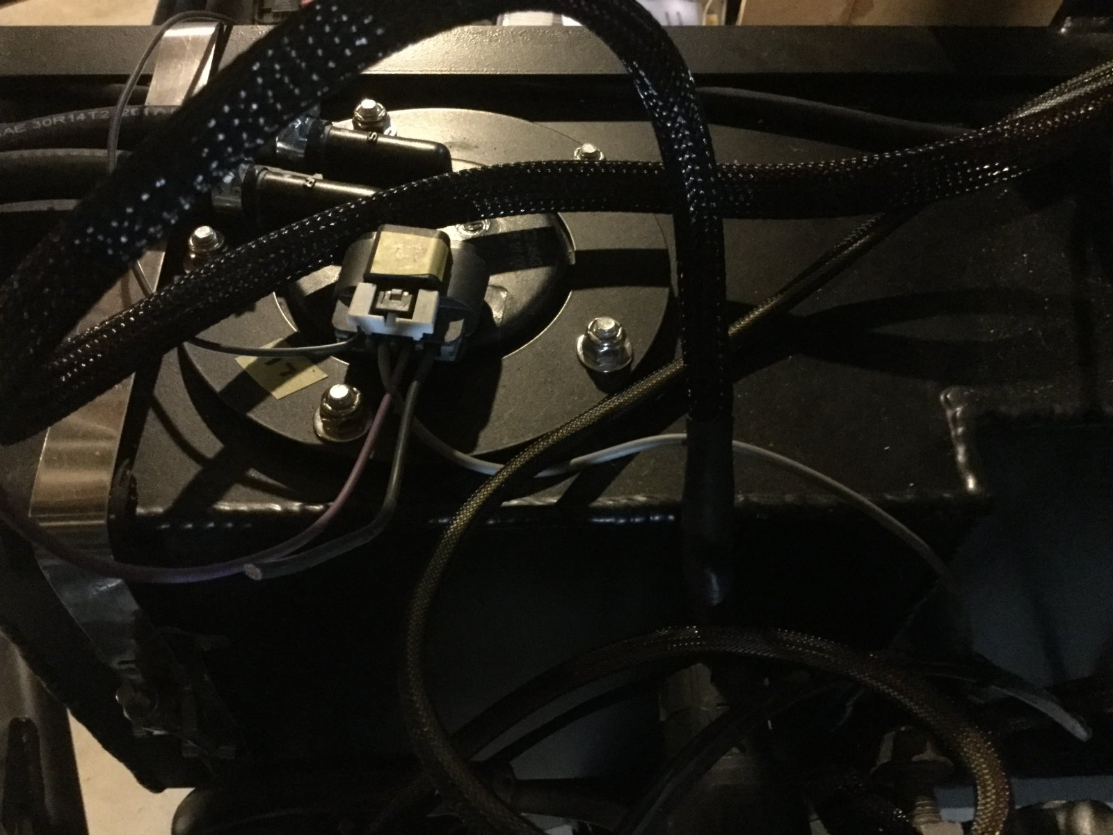

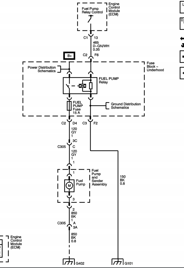

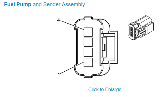

Does anyone have or know the wiring schematic for the 4 wires going to the fuel pump. You have a ground (first wire on the left), you have a power (next to the ground moving right). Then you have an additional two wires (one for the fuel gauge? And one for?) and which is which.... reason for question Nate’s car has a completely standalone wiring harness so NO main fuse block NO BCM. So the fuel pump primes the fuel rail just as it should but I don’t think the fuel pump is running after the engine starts So are one of those two wires the continuous power to run the pump after engine start or is the continuous power to the fuel pump supplied by the power wire through the ECM (so at power up the ECM puts power to the pump just to prime the fuel rail then takes the power off until engine start where it supplies continuous power to the pump.

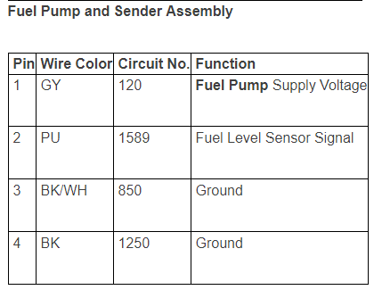

You should be able to measure the 12vdc going to the fuel pump using the first two wires (GND and Power). Make sure that it's getting power not only at ignition, but during cranking and then also after cranking. You could even jump the relay to force the pump on all the time just to see if it's a fuel pump issue or not. I would recommend doing this next to take the pump issue out of the question.
I'm sure the other two wires are for the float, but I will check and confirm.
What you are describing for the wiring to the fuel pump does not match up with what I looked up. I used a 2007 Cobalt SS as an example. Maybe there is a difference in the models, but it's not wired the same as you are describing.
