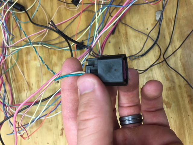

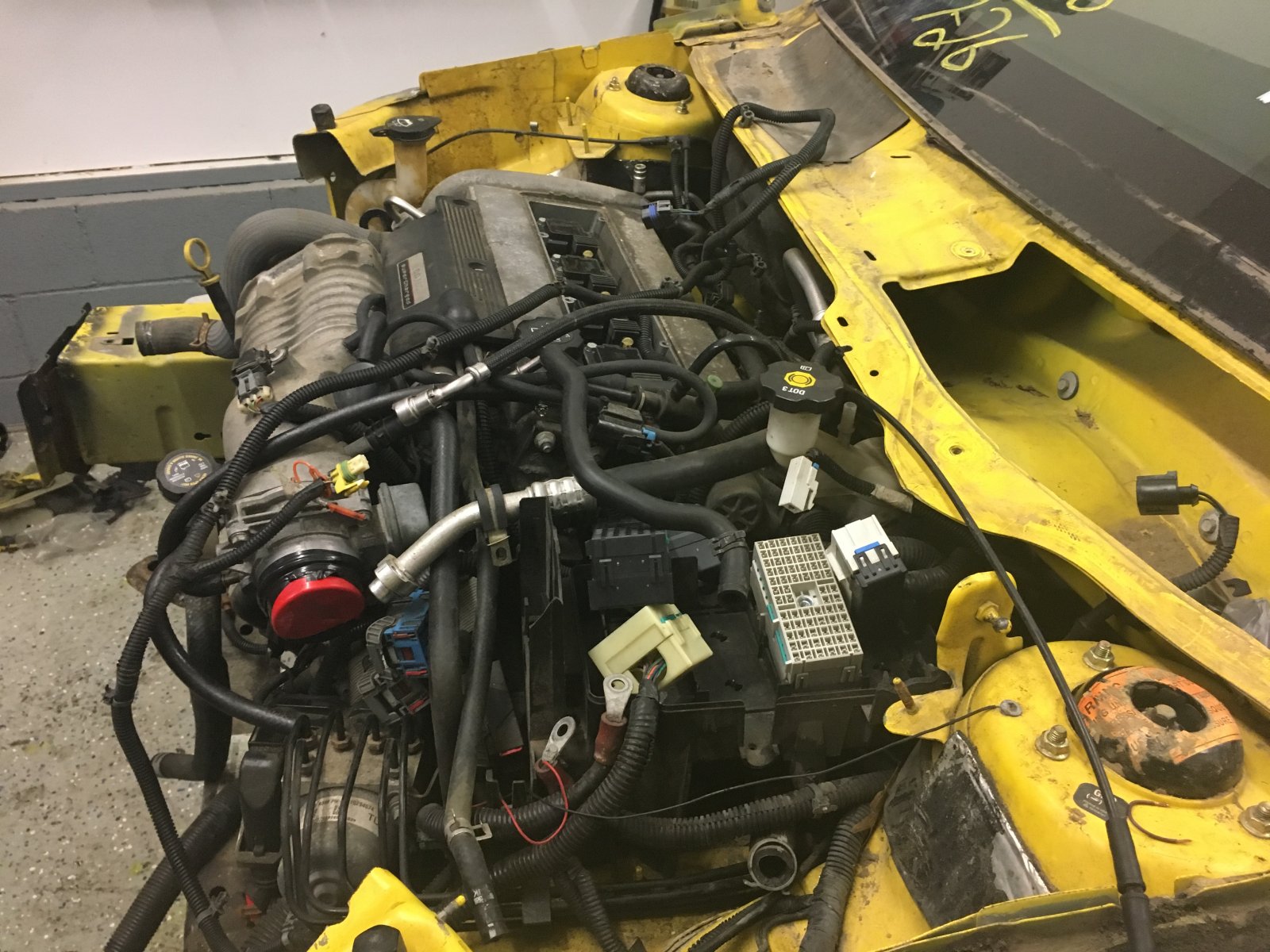

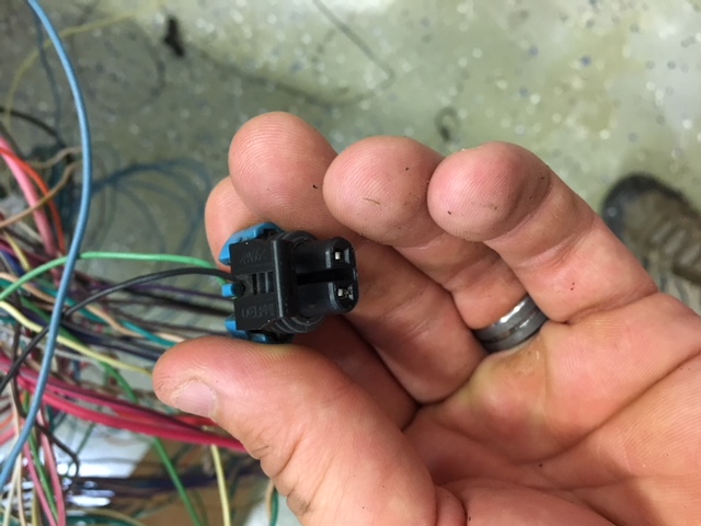

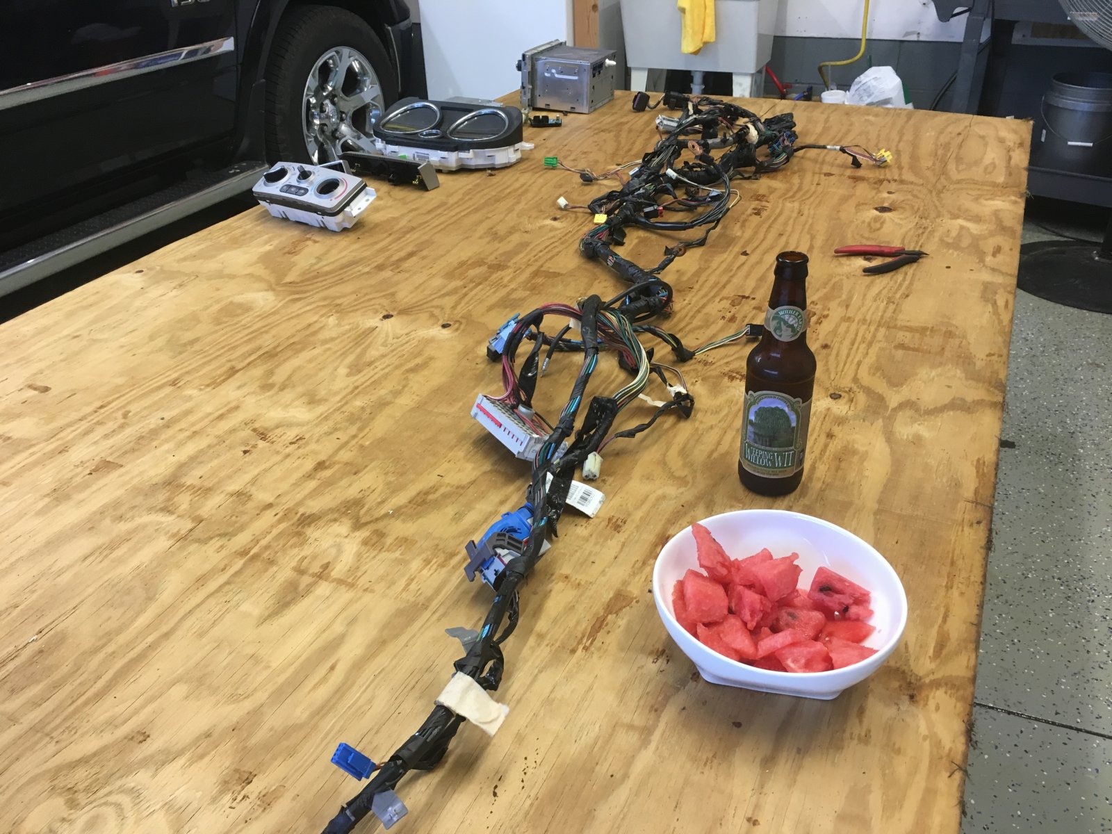

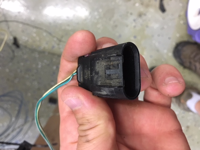

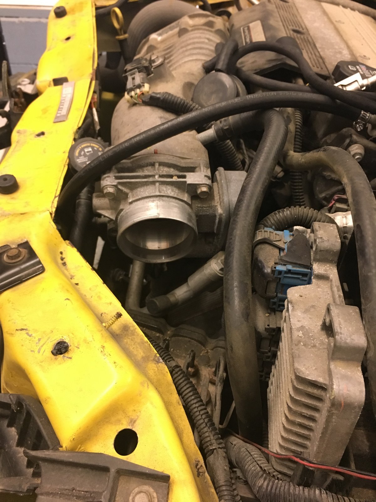

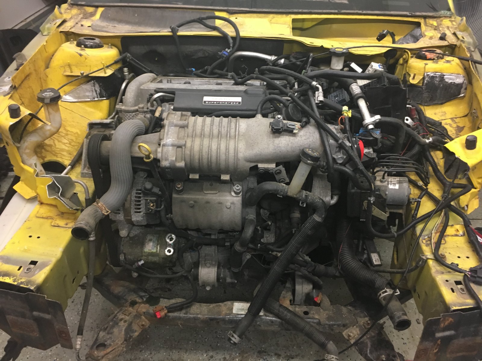

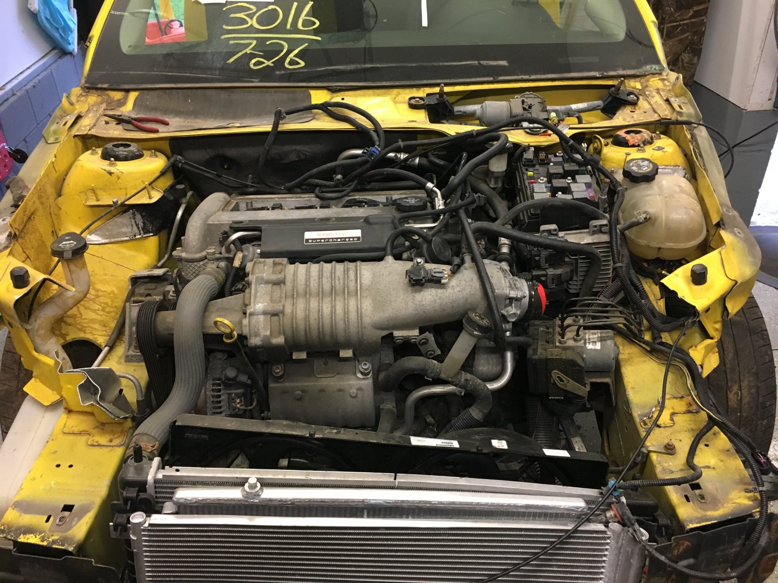

Well I am onto the harness and complete with step 11. I have some extra plugs and am wondering if I could get some assistance if I should cut them or not.
Verified: Picture 1-2 (Battery current sensor), Picture 4-5 (Auxillary Power), Picture 7-8 (Body to Engine plug). Still need help with pictures 6, and 9.
Waterdriver
At work right now, but I would reference the online Chilton manual that's posted here in the forum. I think someone posted it in DPerkins Build log. Search for Chilton and you will find the site and passcode.
My wiring/connectors differed from what was in the manual but it was close enough to help identify what they were for.

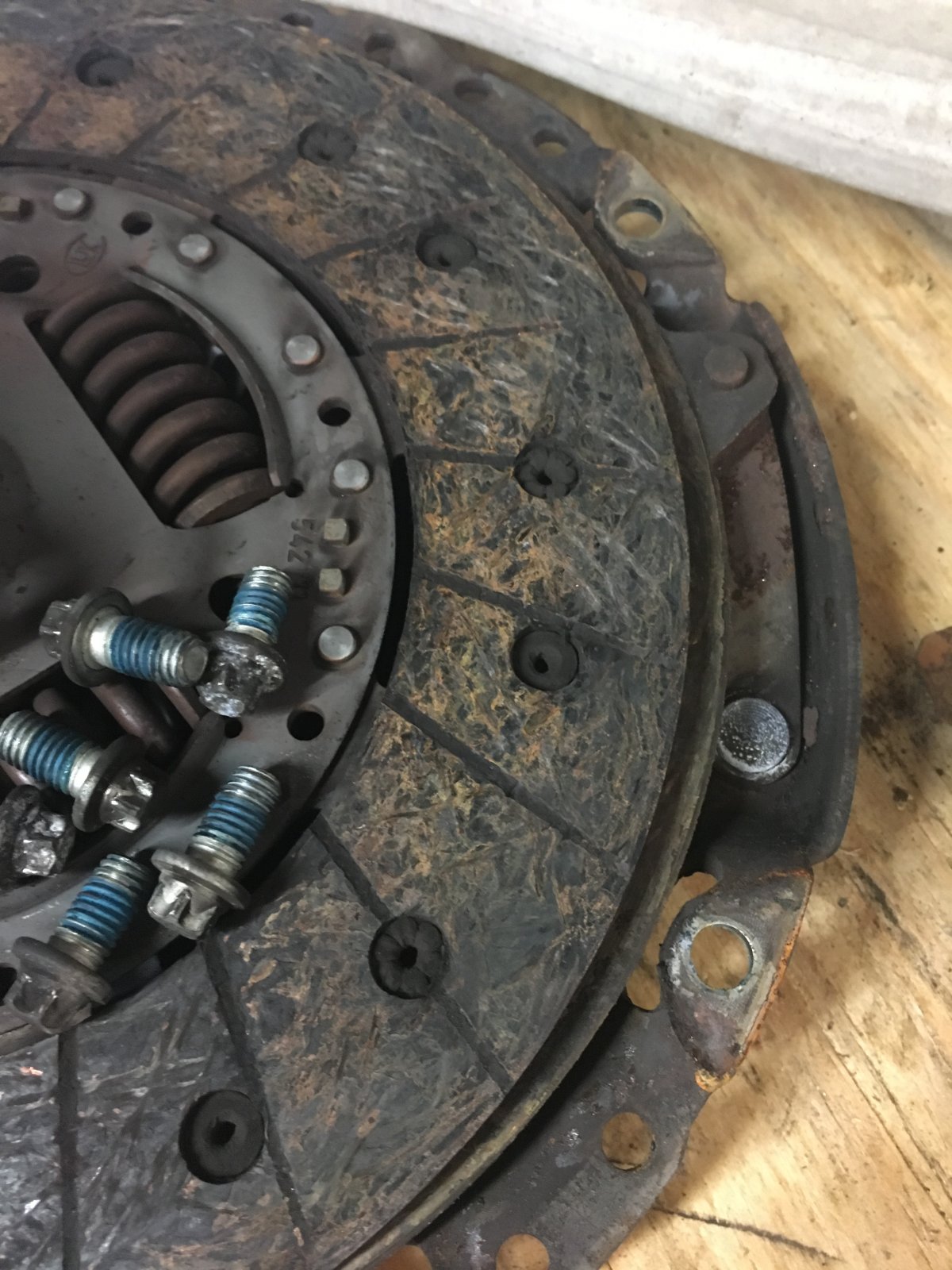

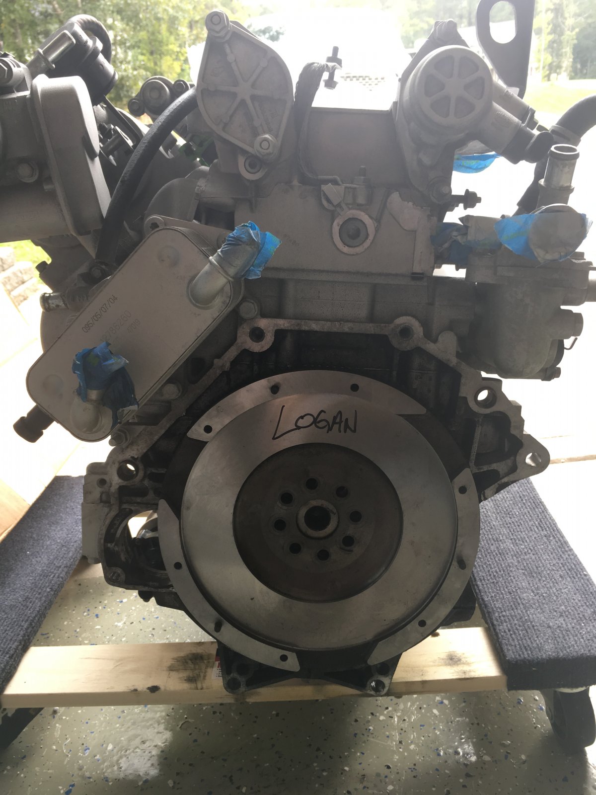

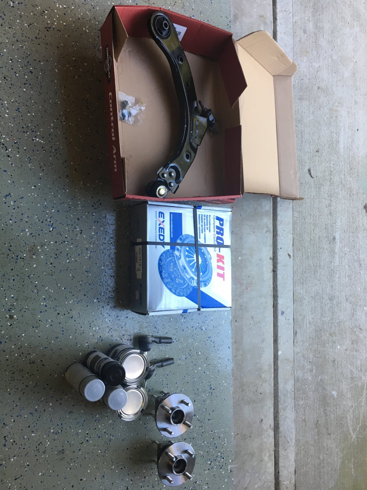

Clutch was gone I ended up ordering an exedy clutch/flywheel/bearing combo.

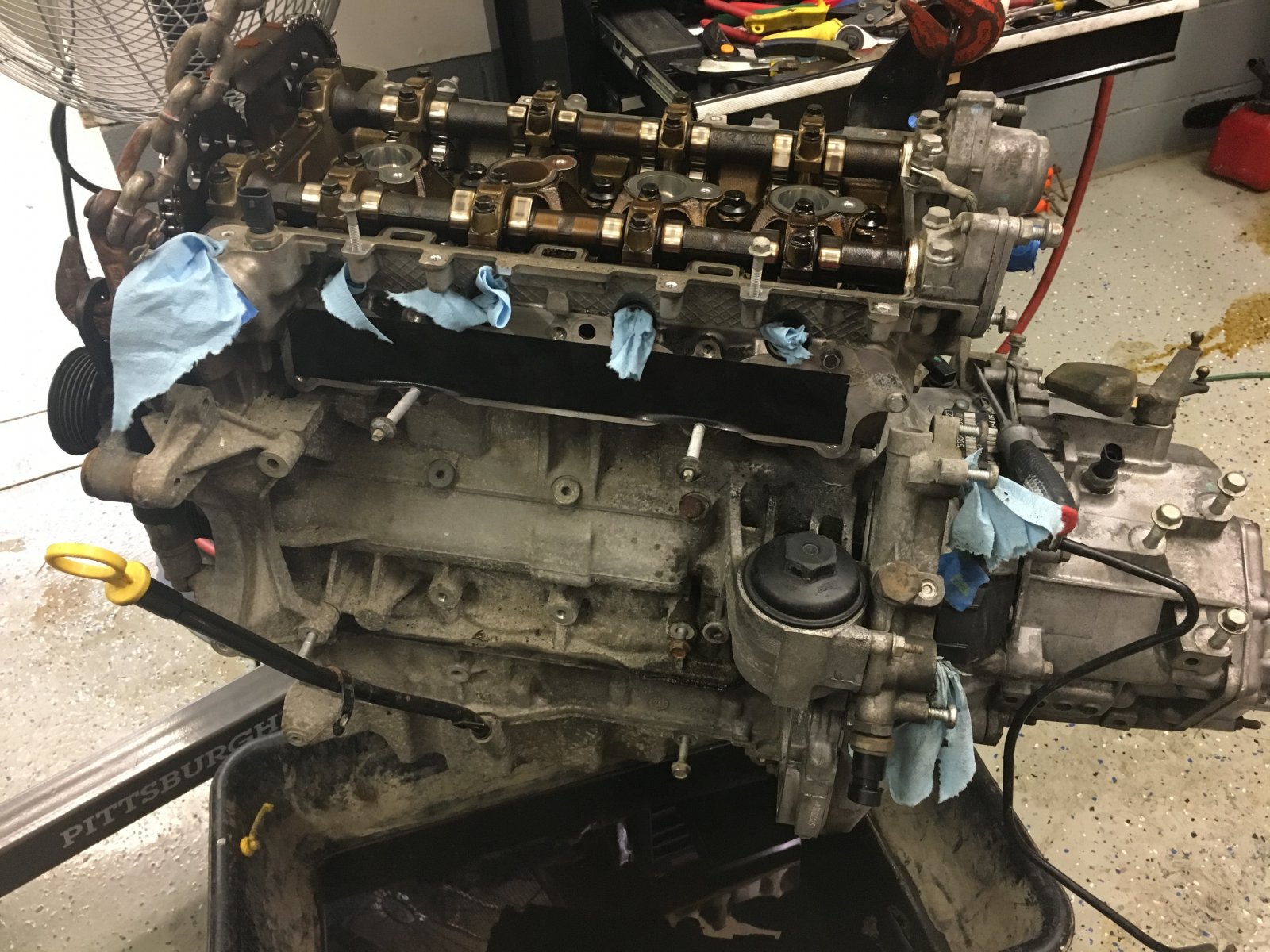

Engine before

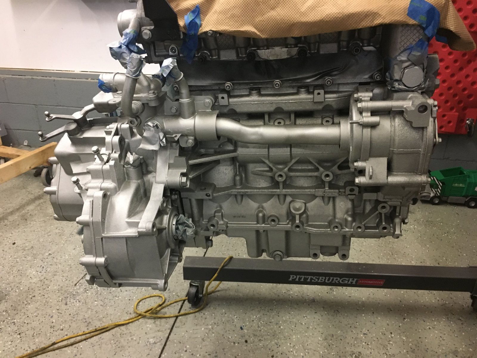

East Coast Paint ceramic aluminum paint. I love black but my logic behind this one is the paint will eventually age and silver over silver will not show as many imperfections over time.

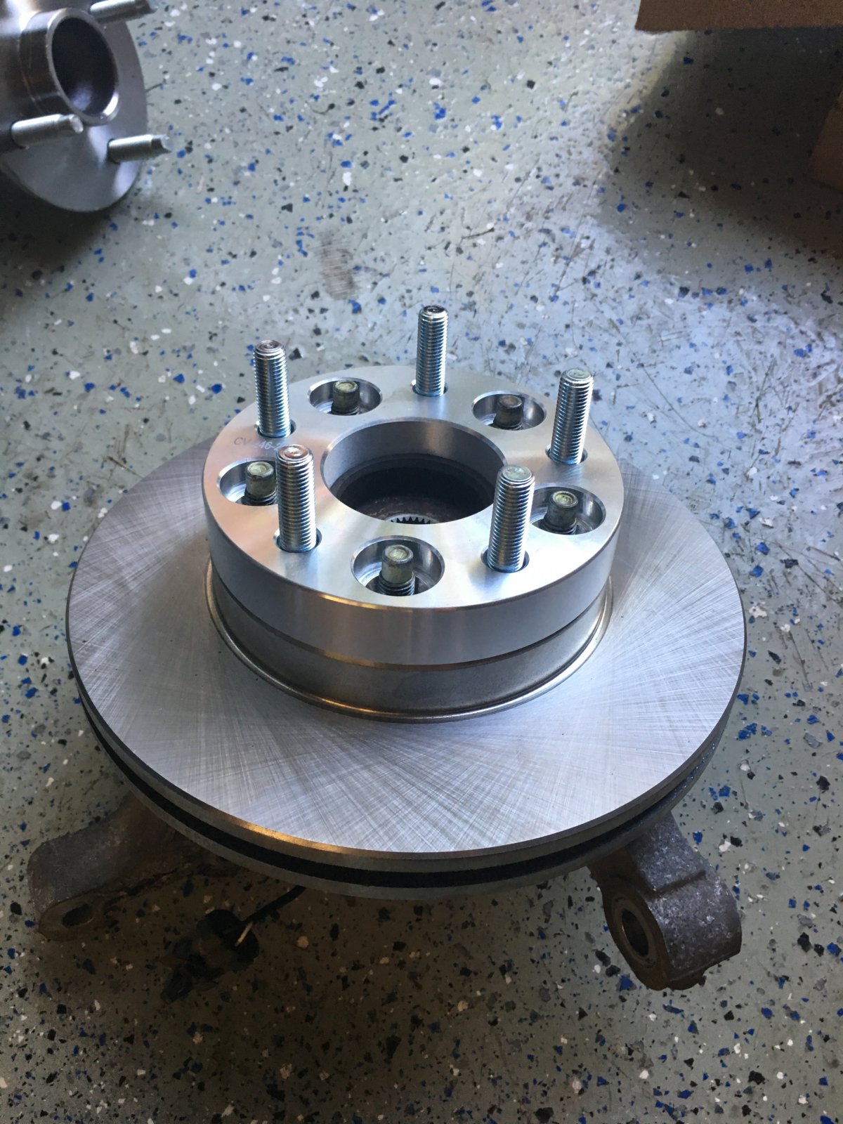

Some goodies. I am going with 4x100 in the front and 5x114.3 in the rear lug pattern. I had to purchase LT front bearings.
5x110 To 5x114.3 wheel spaces 1" to fit my 275 tires.
205s in the front, 275 in the rear

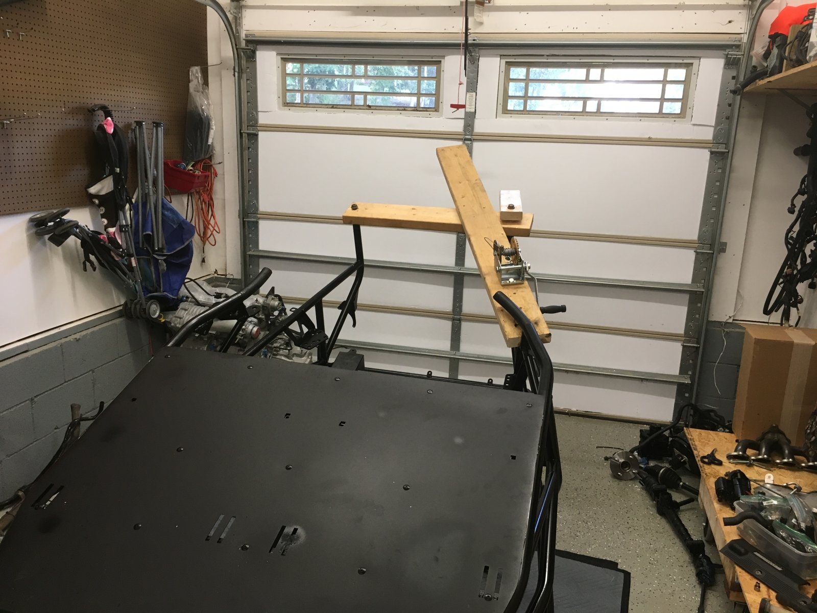

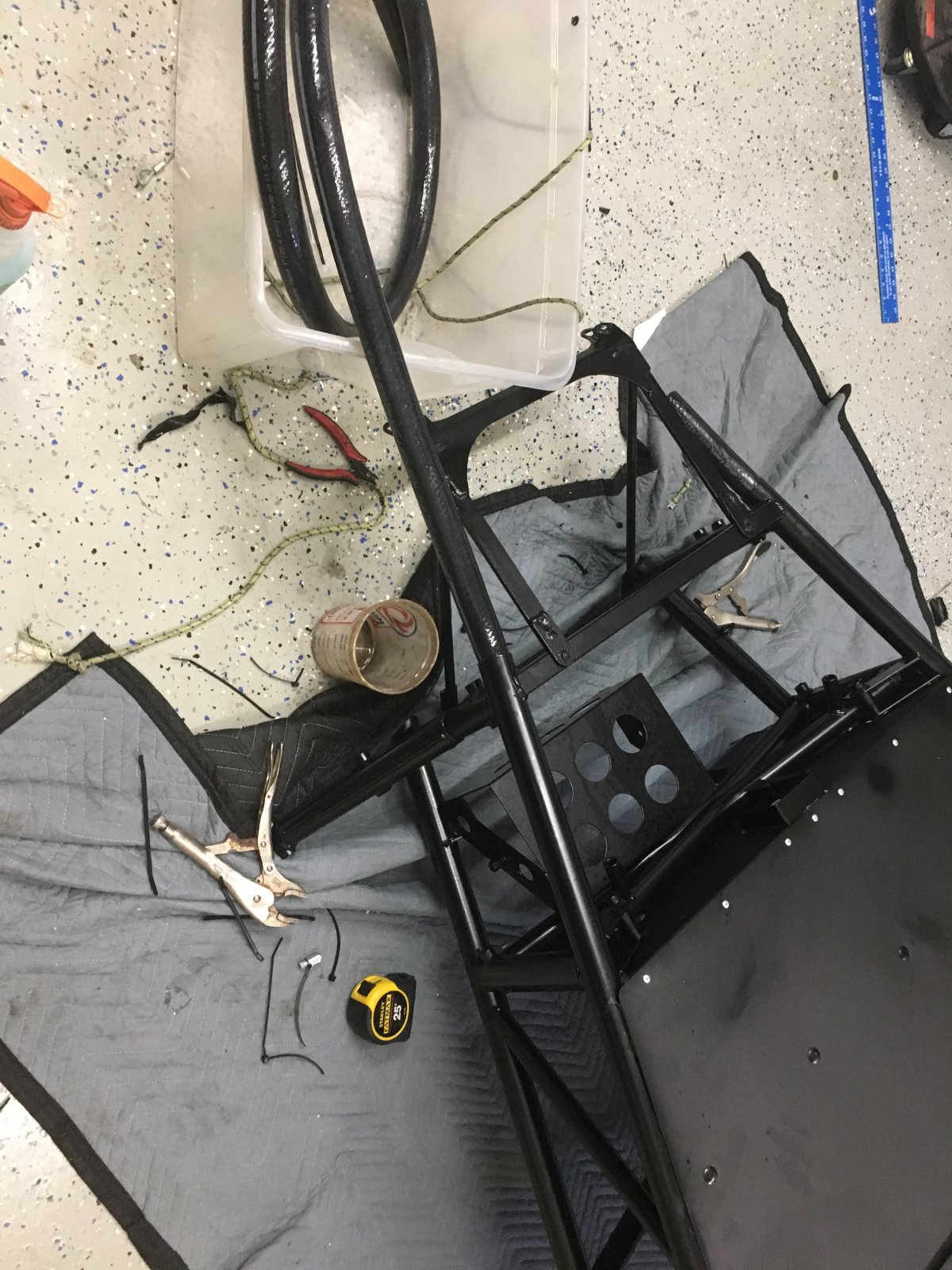

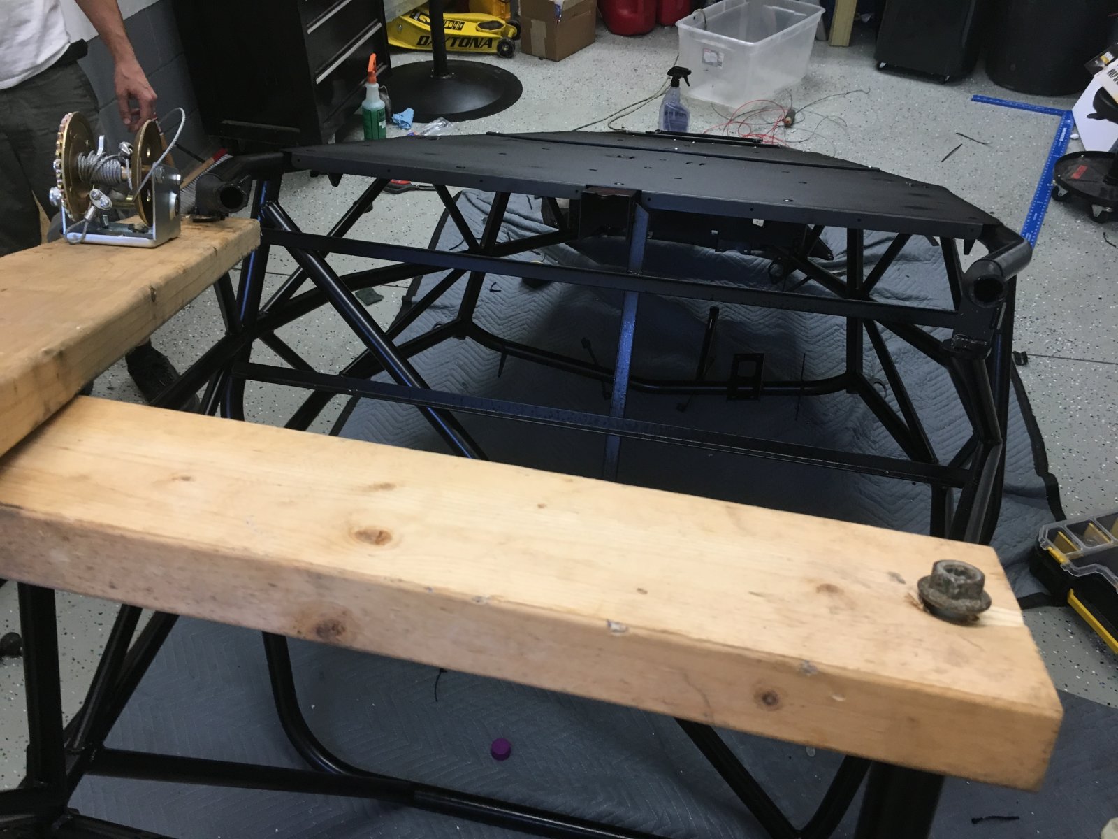

It’s really not an option any other way the winch from tractor supply was $20 pulling by hand is close to impossible if at best frustrating. We pulled this with one hand on a crank in a perfect sitution 1 hour. Most important part is make sure to use (2) zip ties and clamp hose down first for 15 mins like in the videos then remove clamp and pull ties very tight so they fit in the pipe. I had 3 hours combining the pulling by hand then giving up. I actually laughed when we started cranking just due to the effort I waisted Saturday. Thanks to Lonnie for giving me the idea he saved my weekend from being a failure.

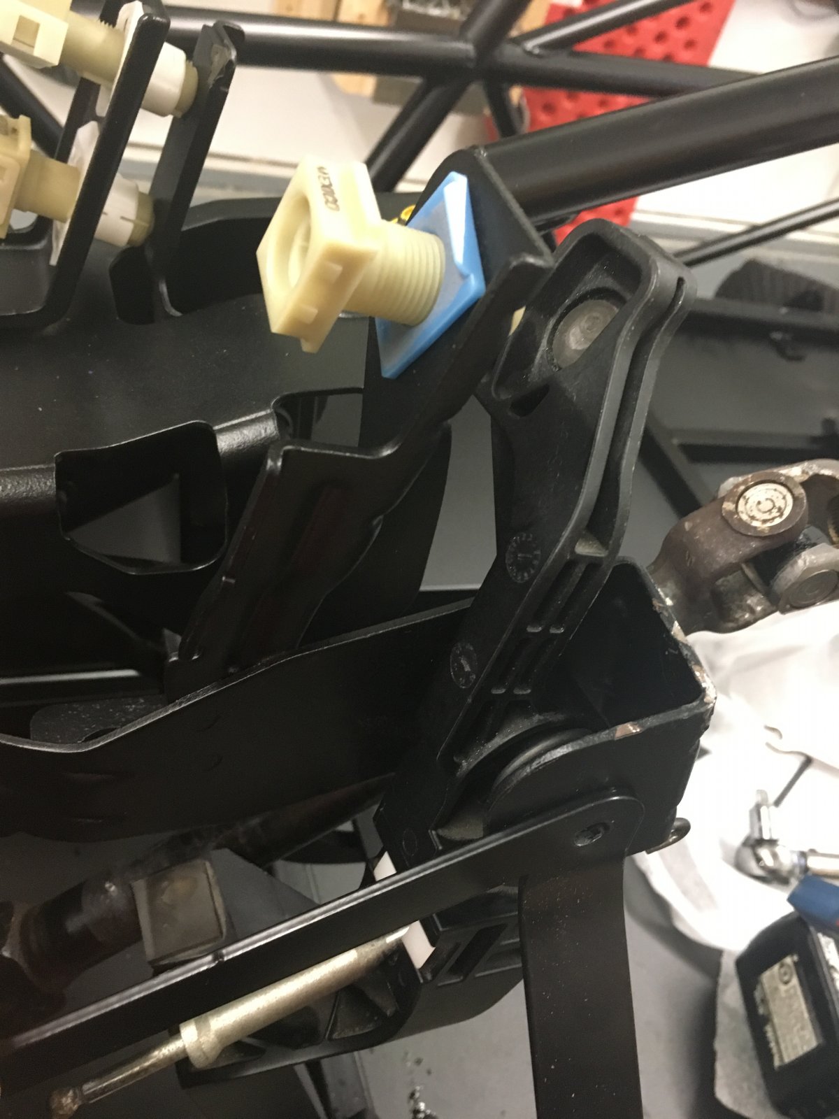

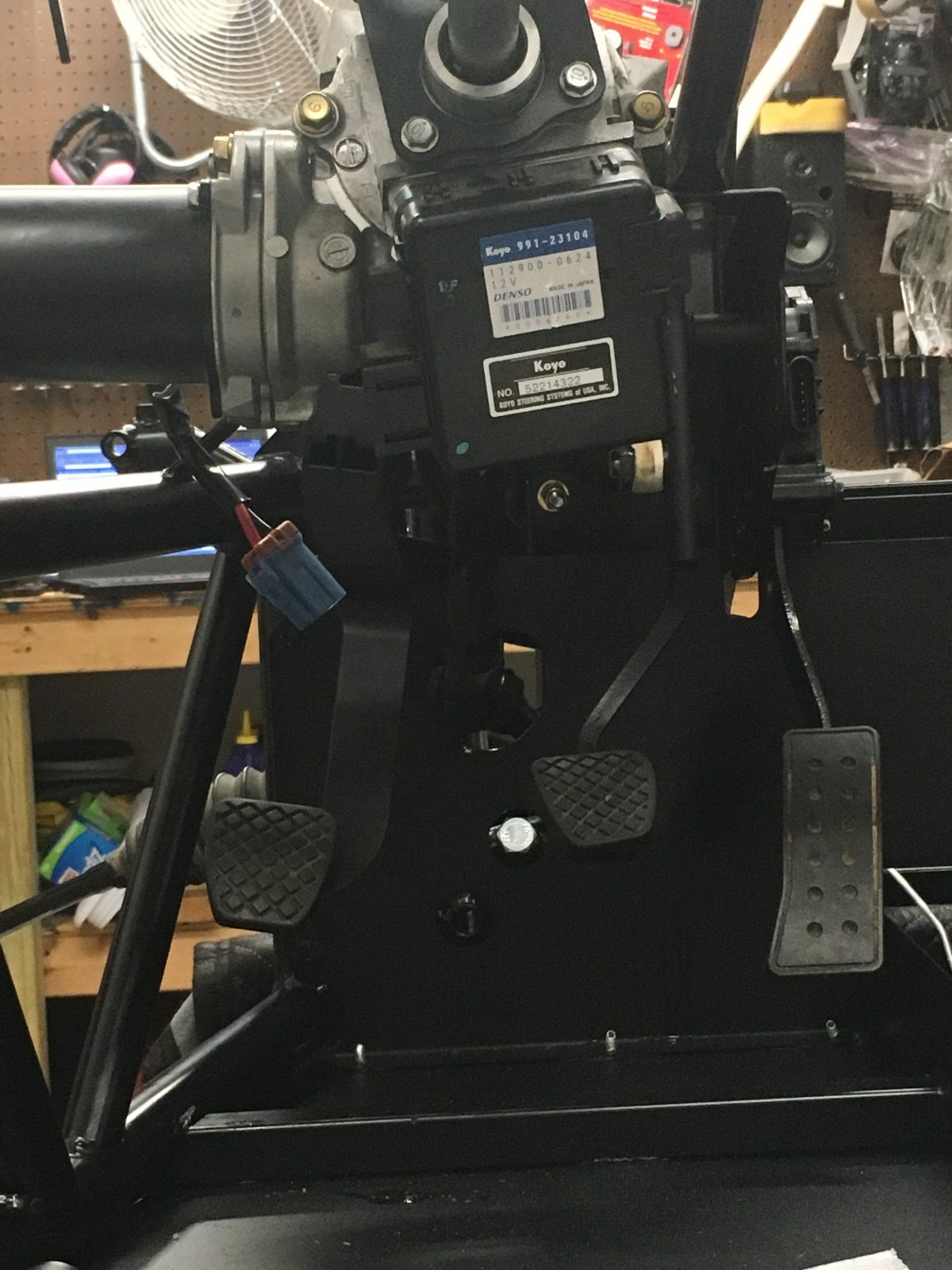

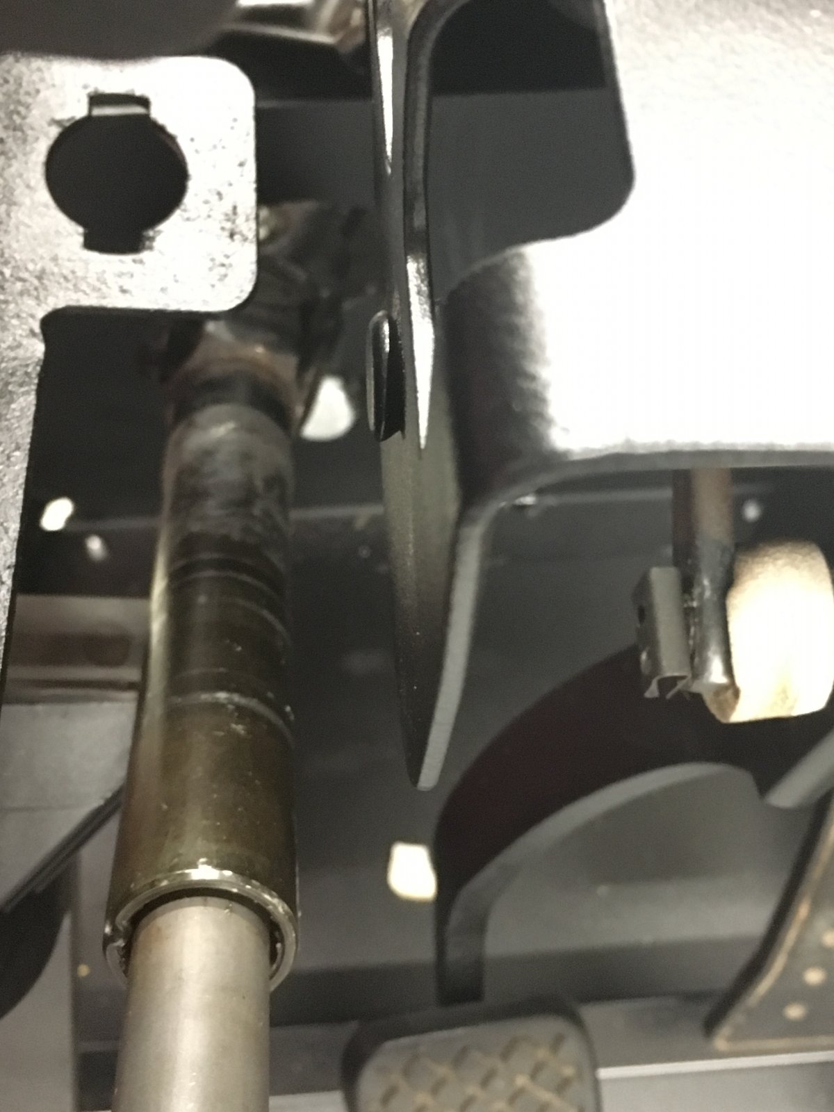

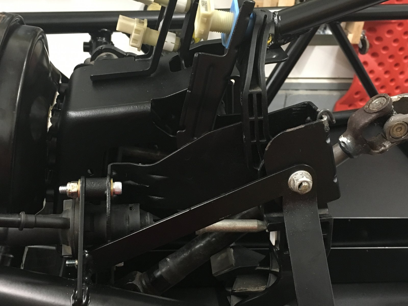

Hey guys any tips on how to install this clutch pedal all the examples I have come across are for 2009+ mine is a 2005. My pedal hits the steering shaft.
Thanks in advance.
Once you get the pedal assembly bolted up you will need to push away the top while pulling the pedal away from the steering shaft to gain some clearance. You will also need to remove some of the material from behind the pad that depresses the switch.
If you don't bend it far enough from the steering shaft it will hit the universal joint when the pedal is fully depressed, especially while turning the wheel.
ncgoblin
I am thinking I may be missing something the pedal is not vertically strait pulling the bracket away from the steering shaft causes it to bend more. It’s almost as if I installed it incorrectly.

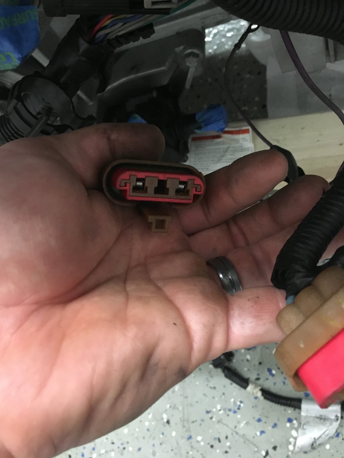

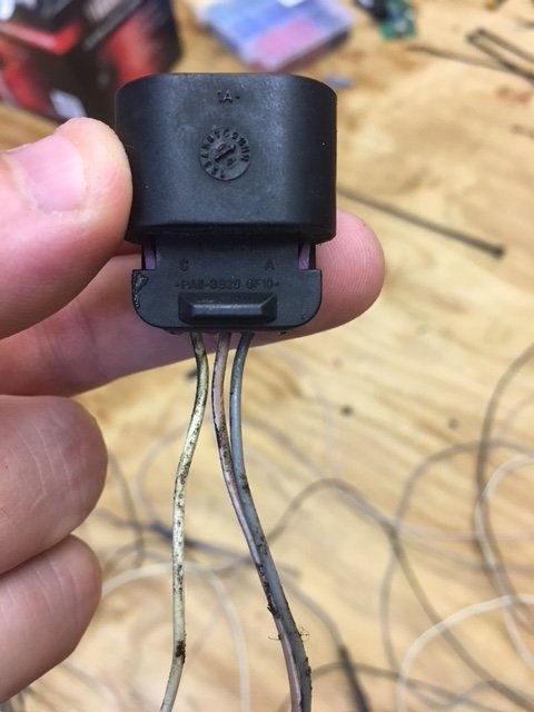

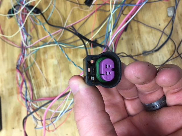

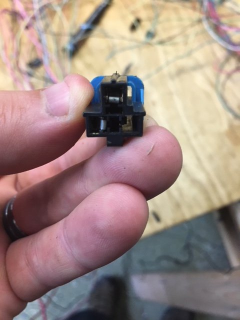

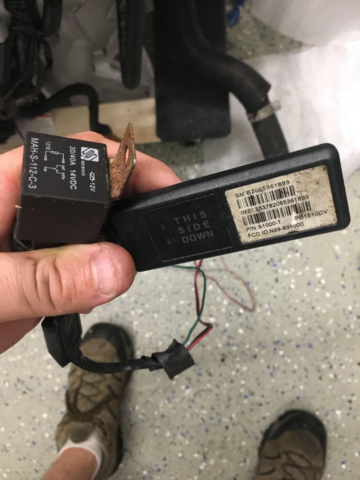

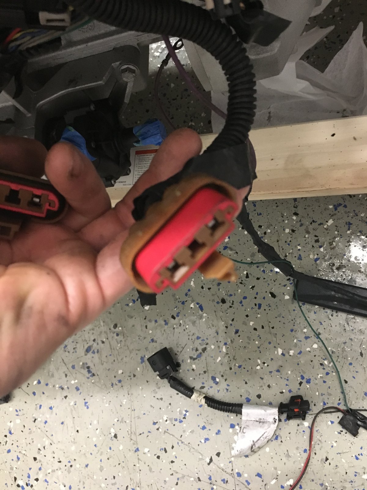

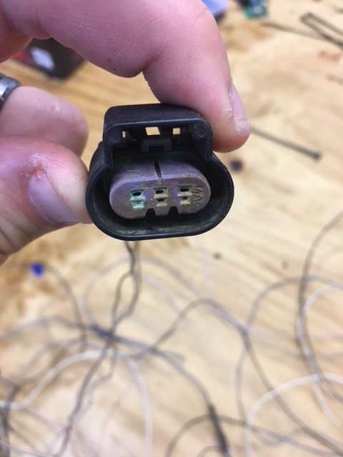

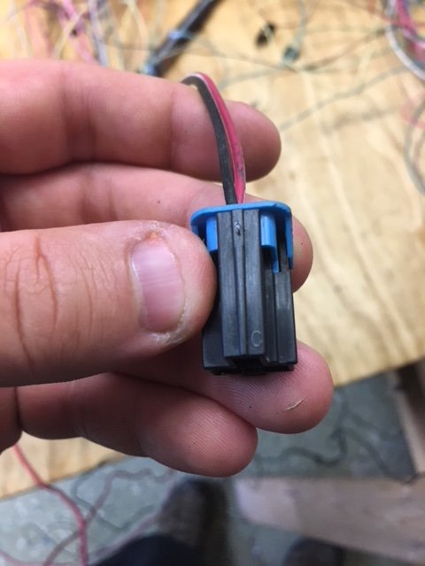

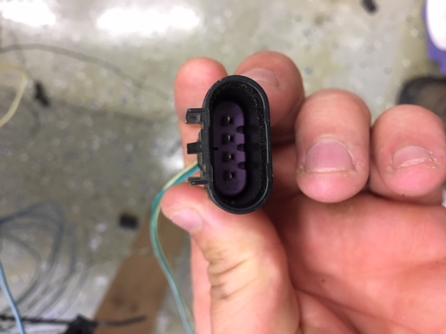

Not sure what these connectors are I’m starting to add back engine harness. Really wish I would have taken more
Photos I guess I’m learning now
Wes
Toss the stuff from the first pic, one is a gps tracking device... The plug looks like one from radiator fan wiring, have to look up wire colors to be sure
