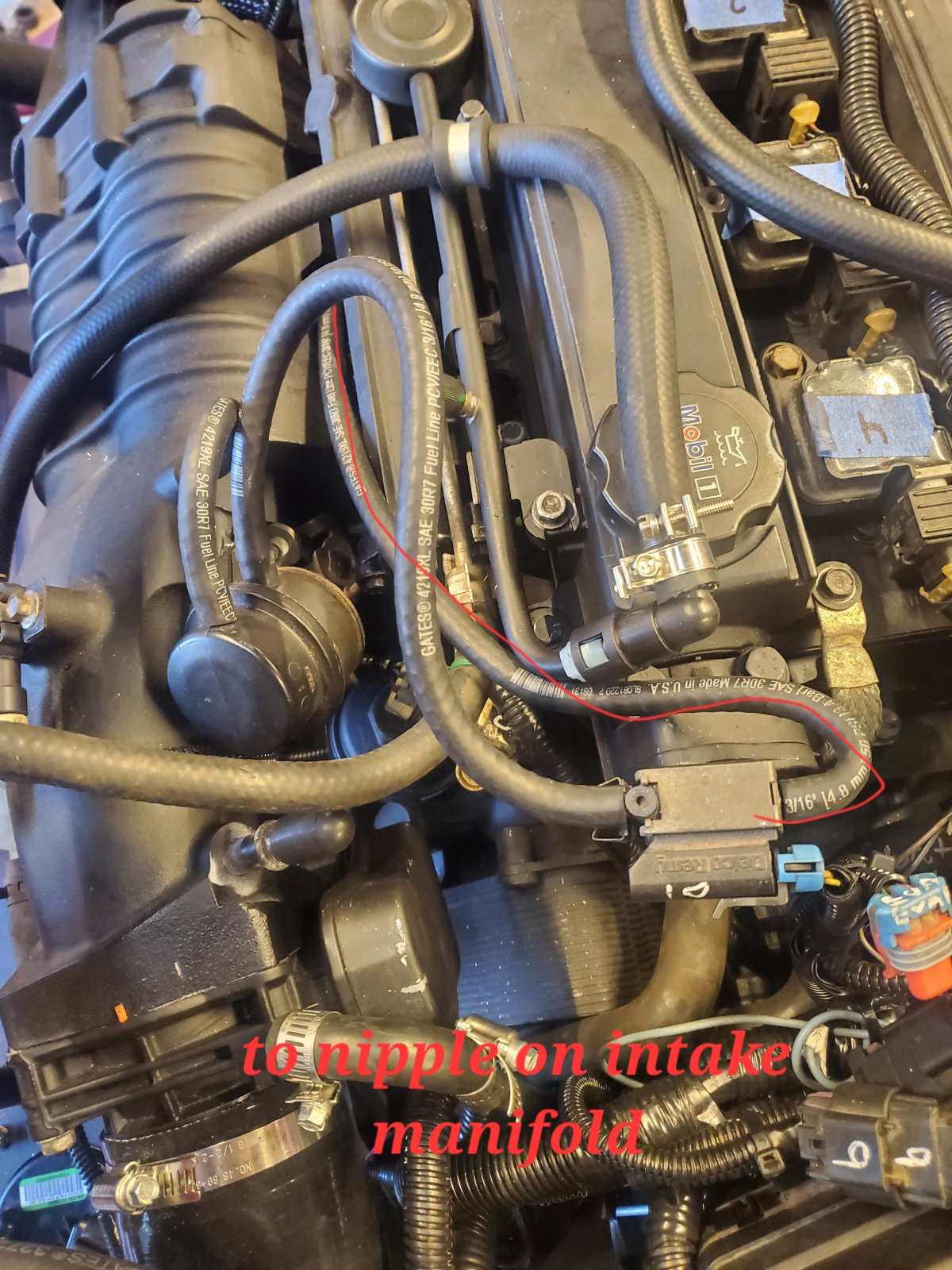

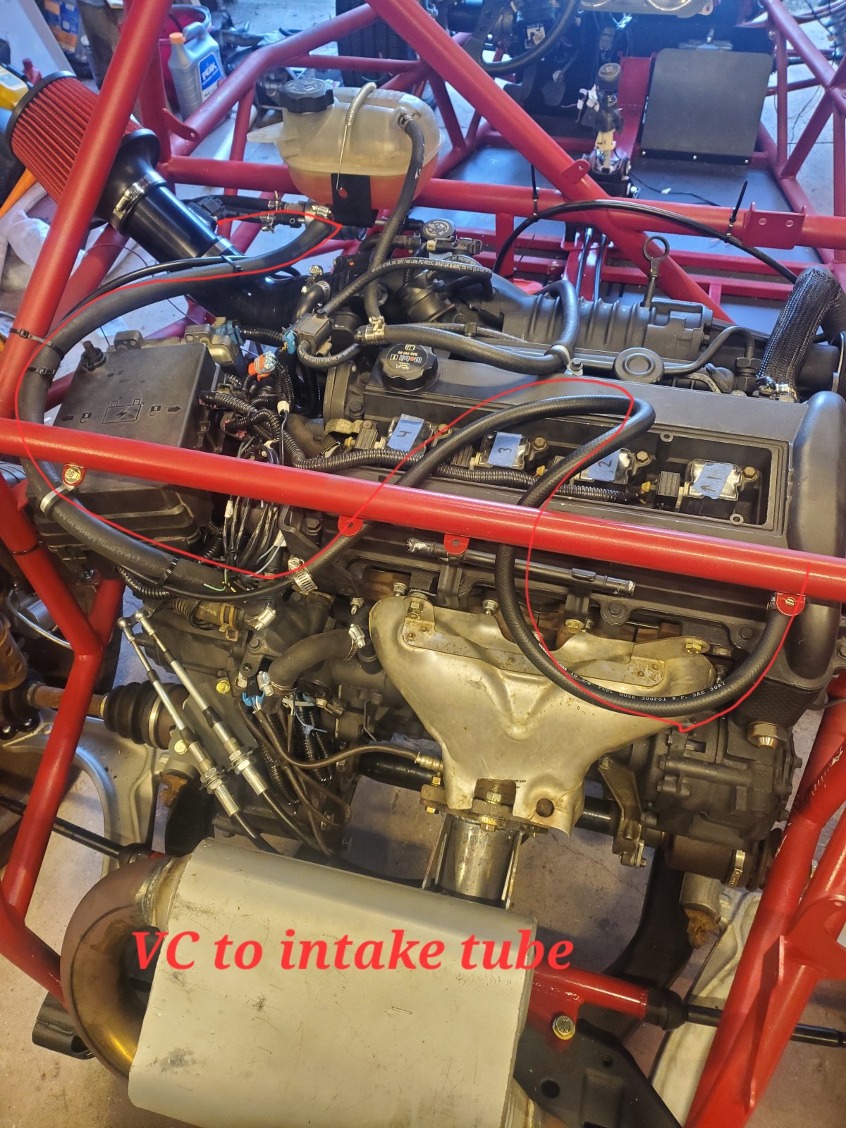

As far as I know there's just the hose that runs from back of valve cover to intake and a pcv valve/check valve near the mating surface of the intake manifold that just pushes in with an o-ring I think that's the whole system

I think Ross is on the right track. It really does sound like the crankcase is getting pressurized. LSJ…is it possible a hose is routed to the wrong port? With your smoke tester, can you warm the engine and see if the smoke gets sucked into the dipstick or blown away from it or is there too much airflow?

Specifically which hose are u thinking may be routed incorrectly?

This
