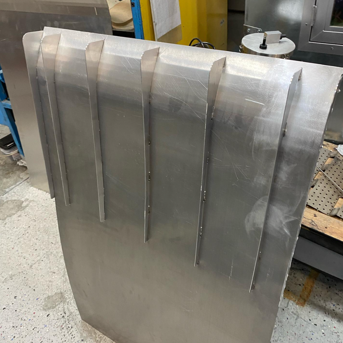

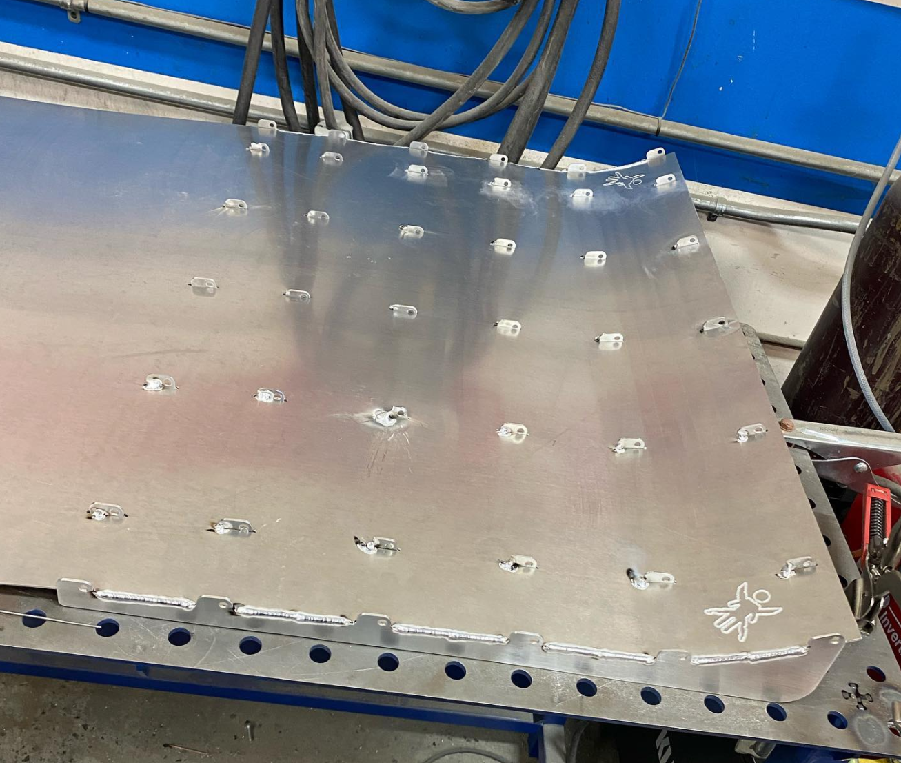

Does anyone have any install pictures (specifically mounting points on the Goblin) or feedback?

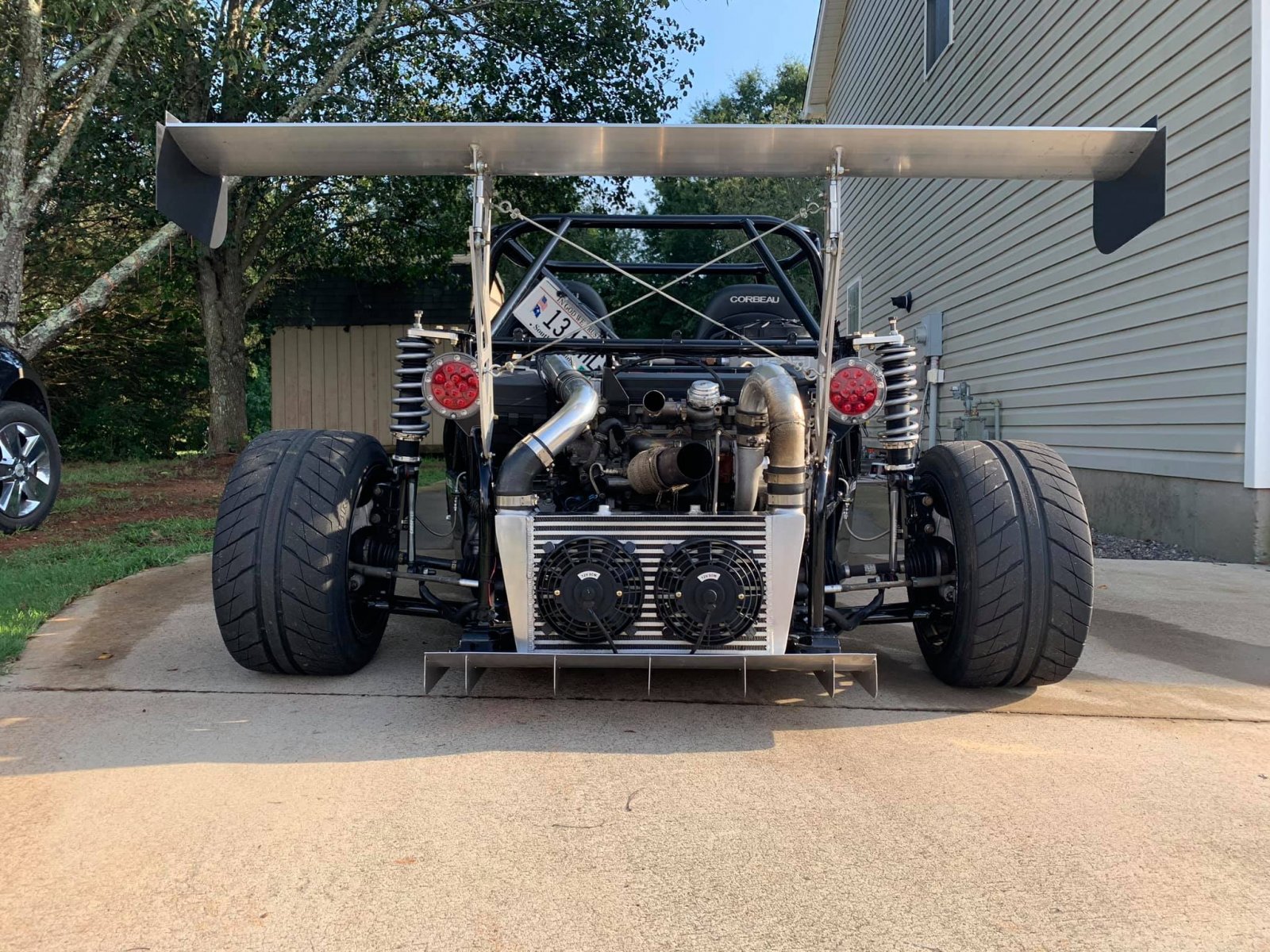

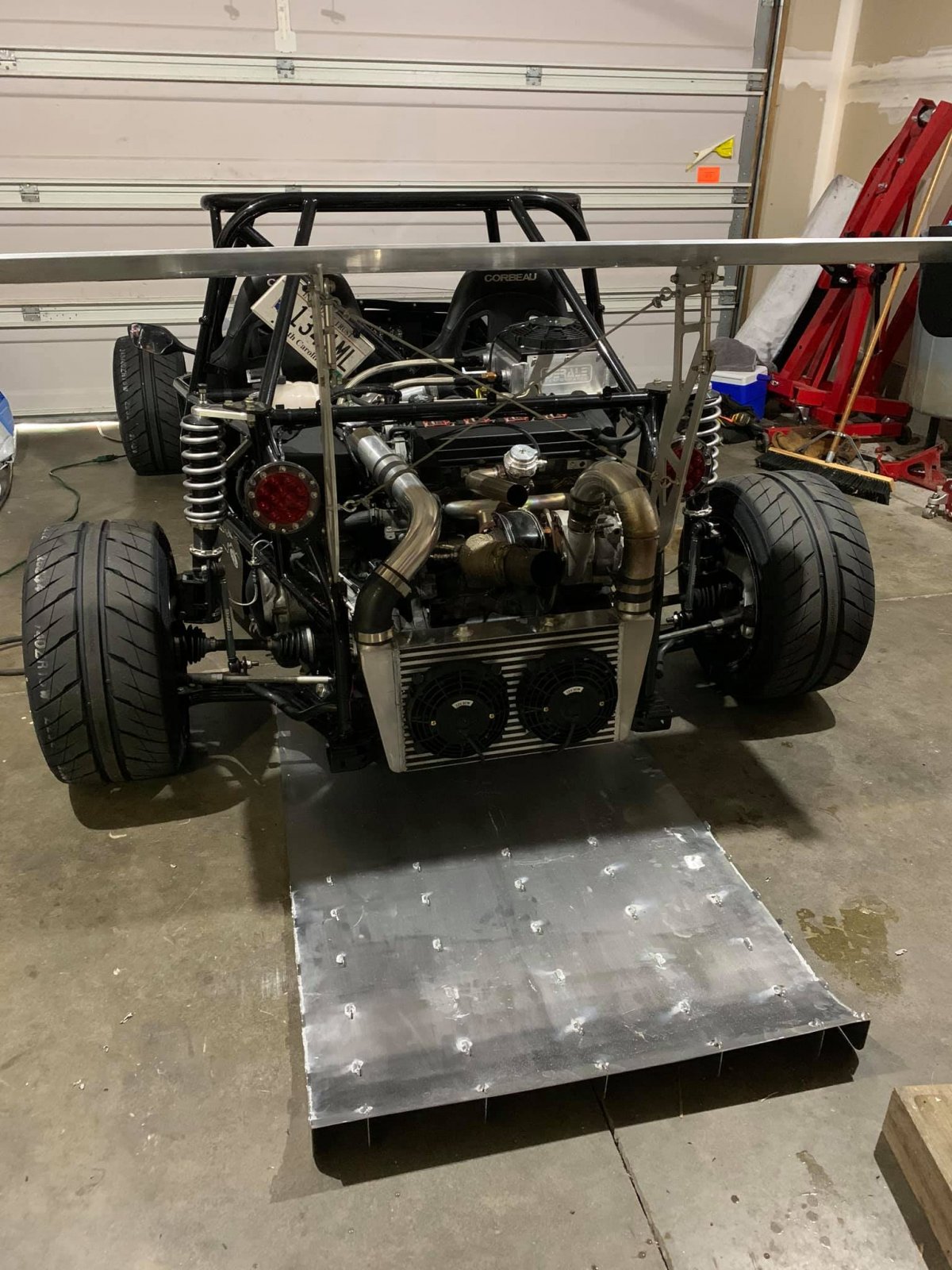

The rear wing is 69". The diffuser is probably closer to 48" wide. I don't have any feedback for the diffuser, but I did send Johnny my pylon design that works with the Exocet mount's AoA adjustment scheme (from -5° to 20°) yesterday, so those may be available in a while to go with the rear wings.

Making some assumptions:
12guage 5052, 32"x48" Main sheet
2.06mm x 812.8 x 1219.2 = 2,041,389 mm^3
2,041,389 * 2.7 g/ cm^3 = 5511.75g -> 12.15lbs
Another wild guess saying the ribs are all ~10% of the main sheets volume:
12.15 +1.2 = ~13.35 lbs total weight
I was going to guess 15 lbs or so...

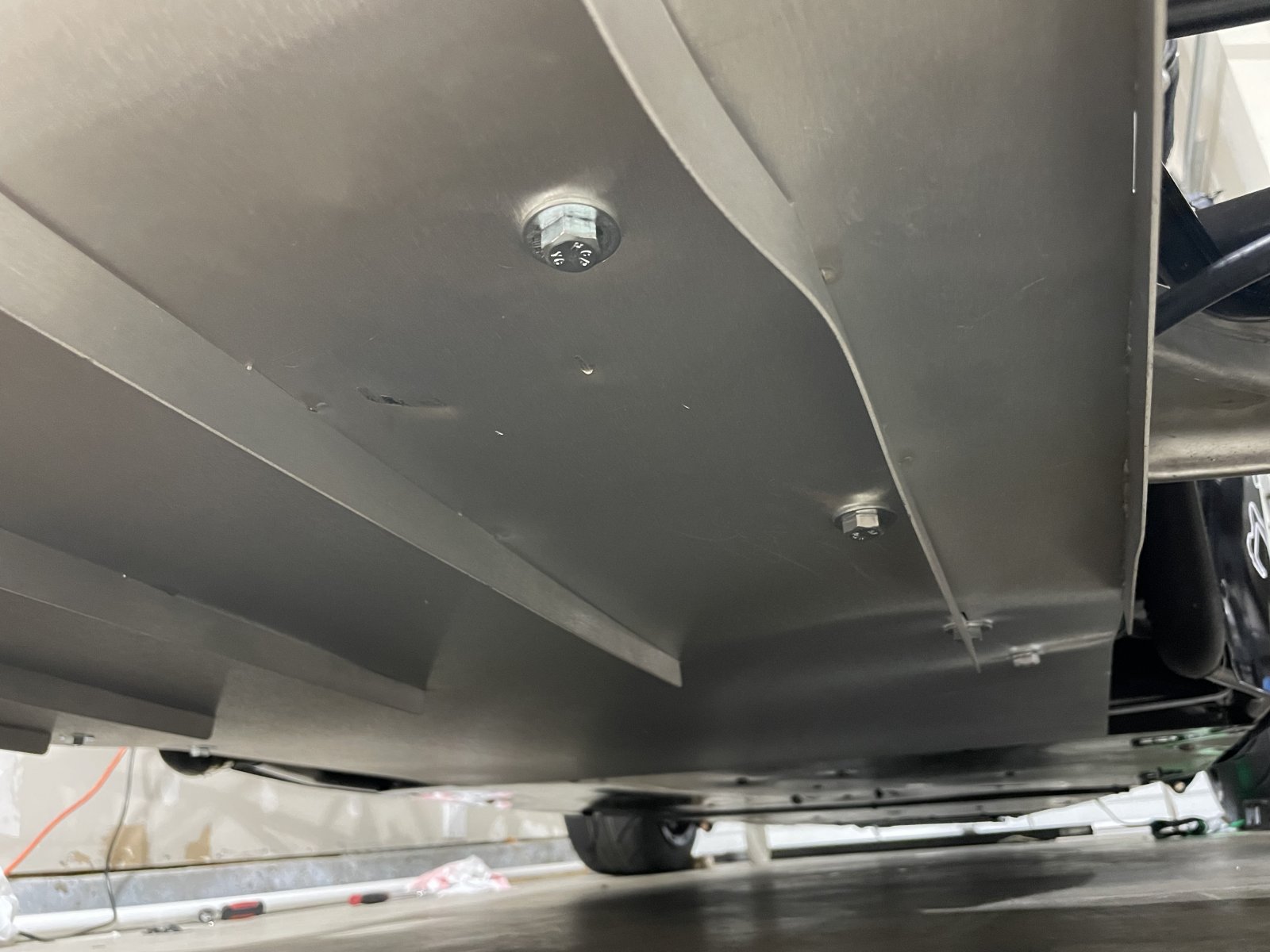

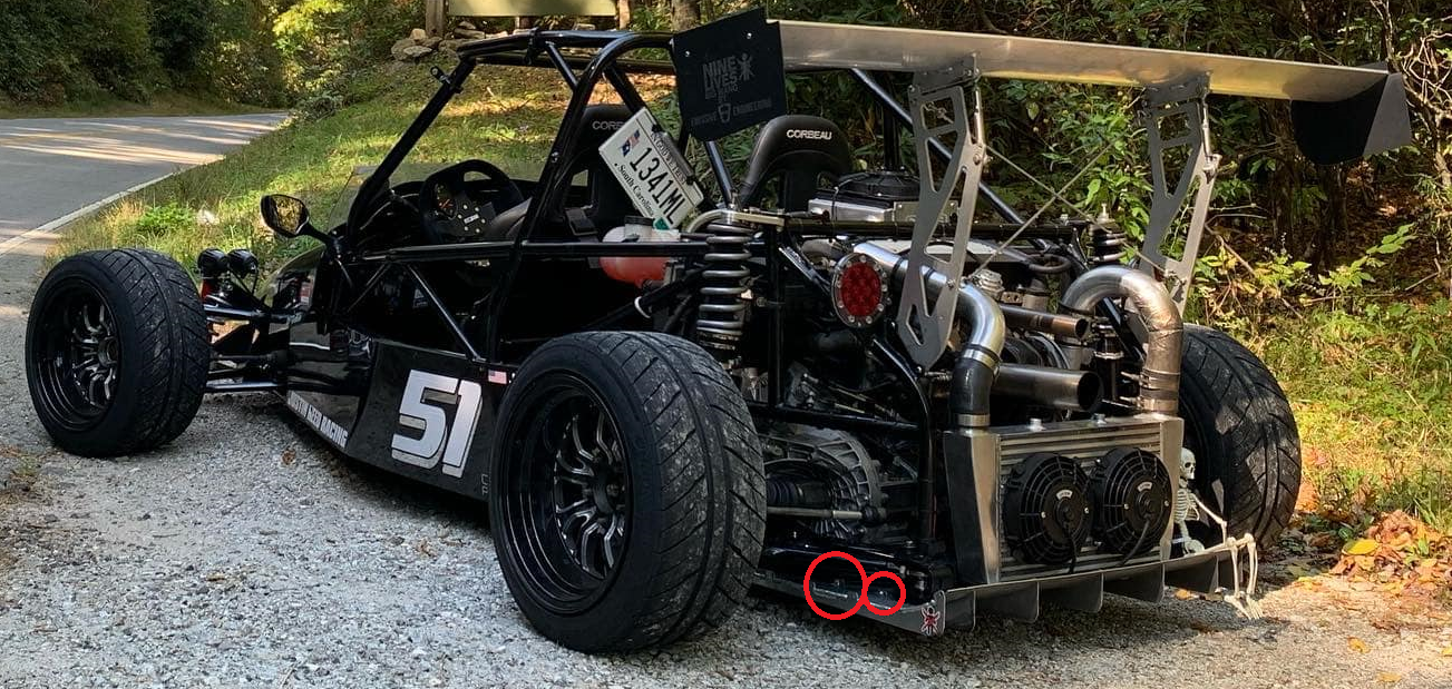

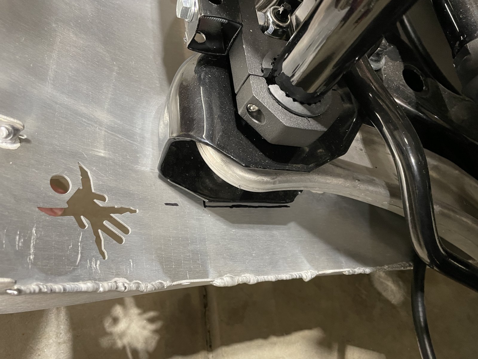

dastrups
Kind of complicated but I measured out equal lengths right and left and then found out how far it would stick out so that the other end would overlap the floor of the cabin. Then I used several vise grips to hold it there in place and then drilled through it and into the subframe. Then I placed nutserts in the subframe. Tedious for sure. Takes time to really square it up and measure where to drill so you’re mostly centered over the subframe. Probably a better way to do it than this. Ground down some of the tabs a little without ruining the welds so that it could sit mostly flush with the subframe. Need to mount the front portion to the floorboard to make it more solid so it doesn’t catch any air underneath. So far just 4 bolts on each side.
Interesting, seems like those side / inner mounting tabs are fairly useless then.
Anyone near Buford, GA 30518 want to offer up their subframe / Goblin for them to use for actual mounts? I have to imagine these are pretty high profit margin pieces for them, they could atleast give a steep discount and make our lives easier
Kinda defeats the purpose of the aero at that point, no? :p

Not sure a 3D printed diffuser would hold up, if assembled in that manner. If the diffuser is actually doing what it's supposed to do, there will be a suction force being applied between the road surface and the diffuser, pulling the car towards the ground. The OSB diffuser template I built (couldn't resist testing it) sucked the vertical strakes off. So there is a suction force being applied. Not that they were attached very securely in the first place, but enough to pull them off and bend the screws attaching them.
I mean it could work but you'd have to have a lot of attachment points to support it well enough.
