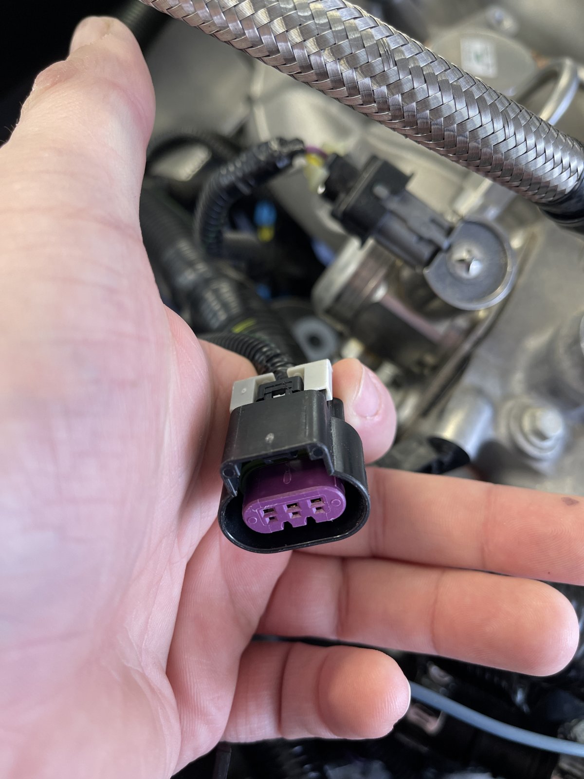

Nuker-

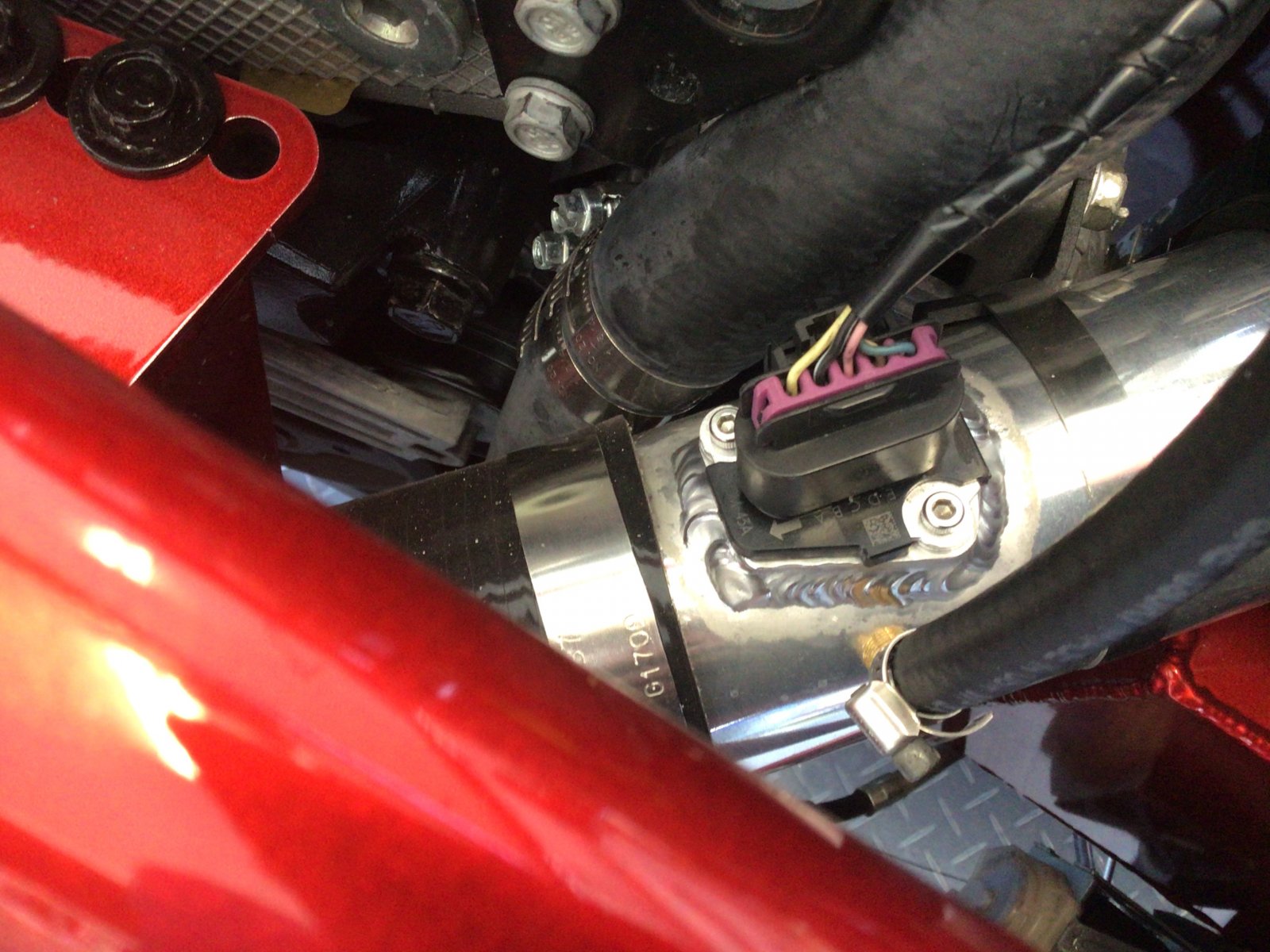

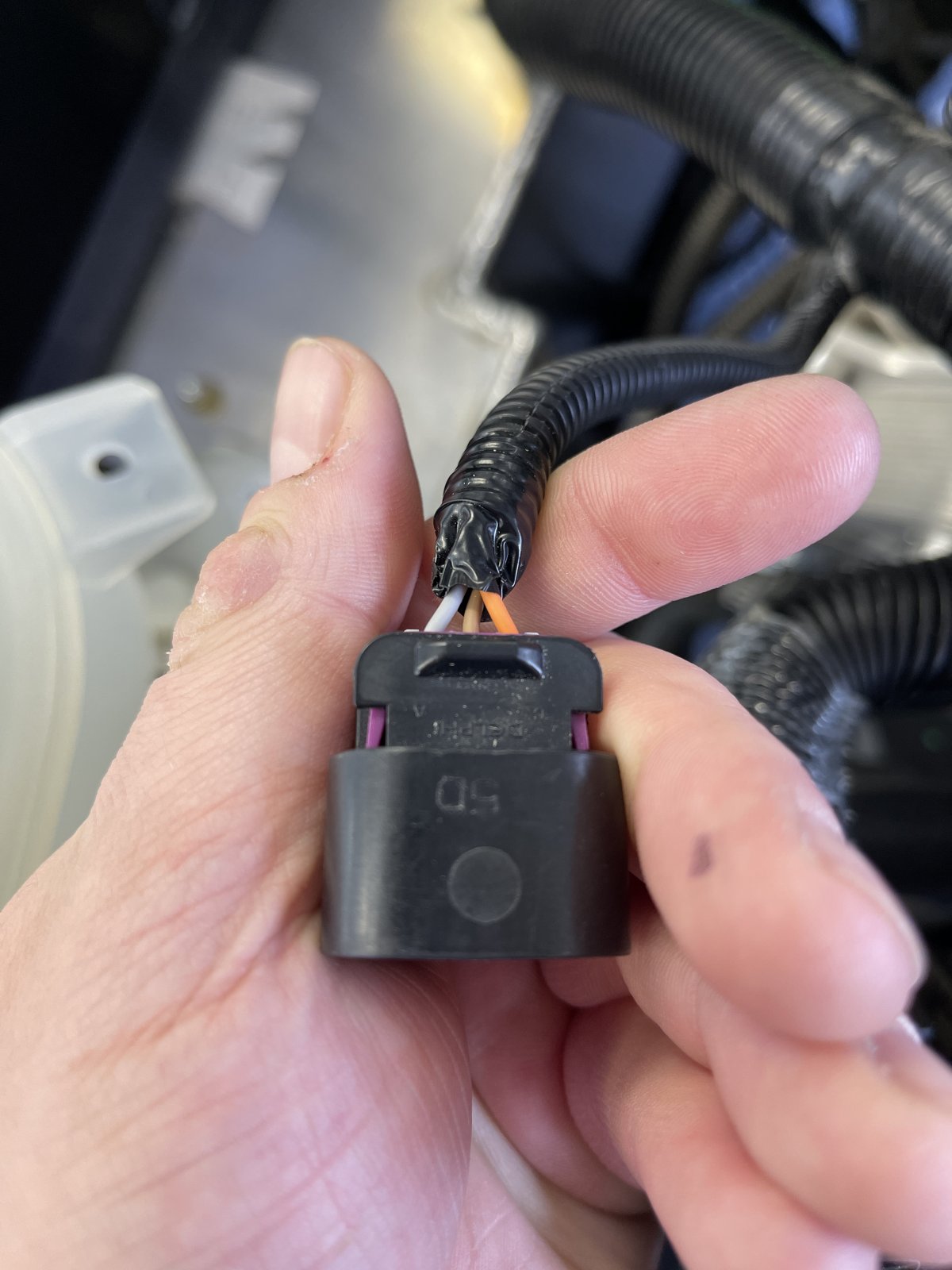

#7 looks like one of the 5-pin connectors that is unfortunately the same design for the MAF and the sub-harnesses for both the coil packs and the injectors. If that's the case then you can either narrow it down by process of elimination or checking wire colors.
TheNuker

TheNuker
That looks like the MAP sensor connector.

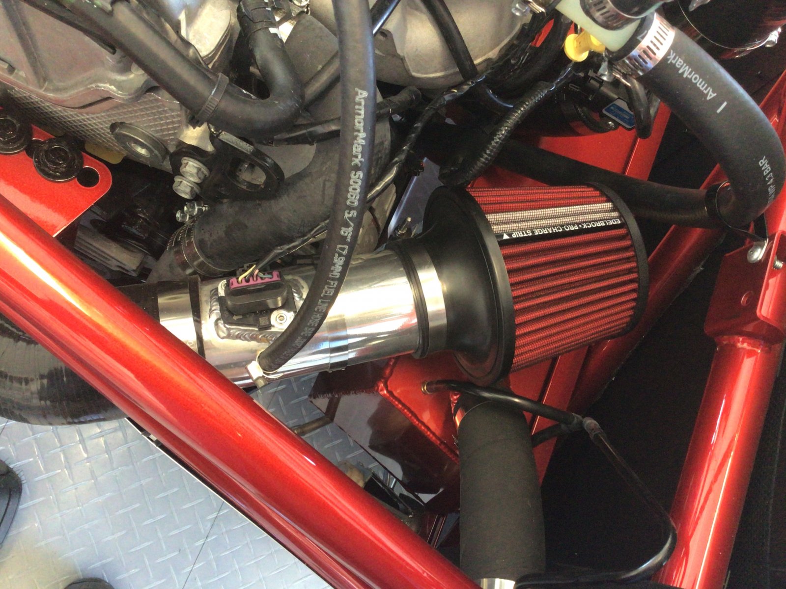

Hmmm I think I have the 2 map sensors plugged in right just verified they are different plugs then this one.

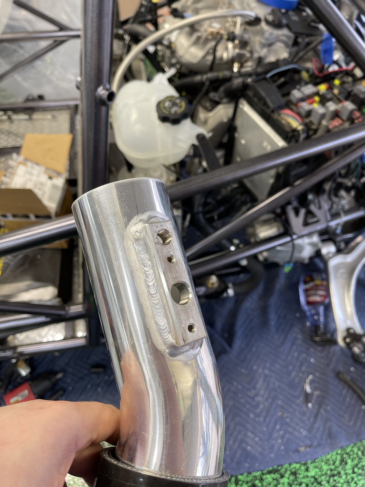

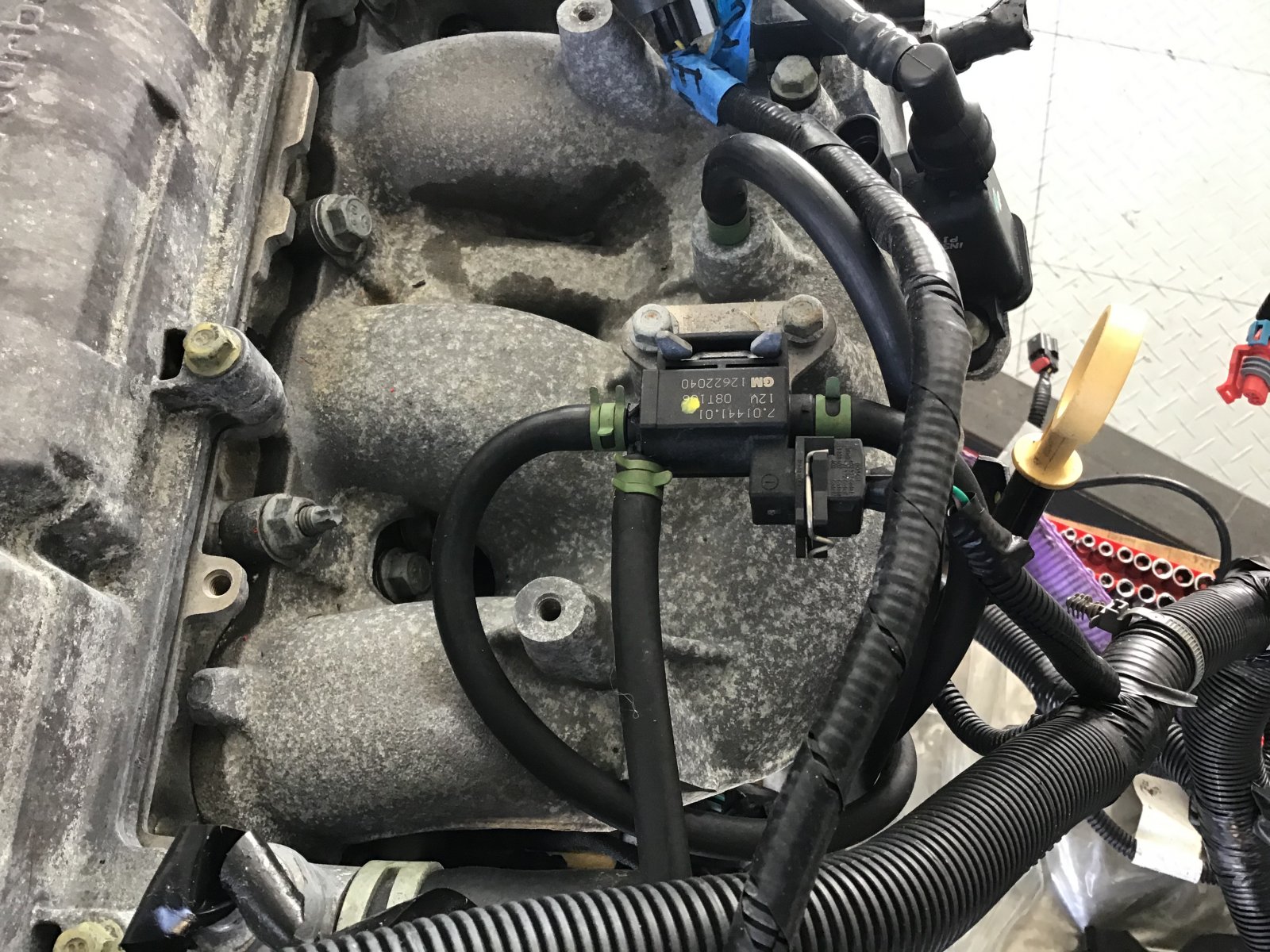

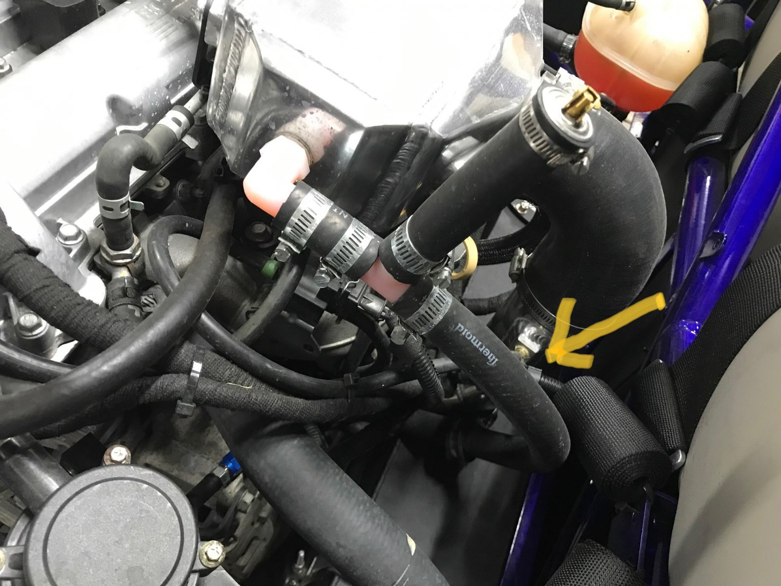

What attaches to this tube that DF provides for the lower TMAP sensor there is another port kinda like what a brass nipple would screw into.

jennam

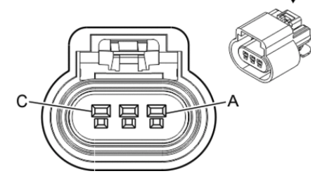

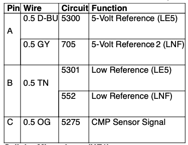

I scanned back through my connector list and compared the wire colors. That actually looks to be the cam position sensor connector.
21963
21964
Zoom Zoom
One of the GM STAGE 1 Sensors hook to that one and the other one here
and then the MAP sensors here

TheNuker
Yep you're right I feel stupid LOL I thought I had them both plugged in and could not see the front one. Yeah sure enough.... That means I have no outstanding plugs or sensors!
Thanks everyone. Hoping to start this sucker this weekend.
