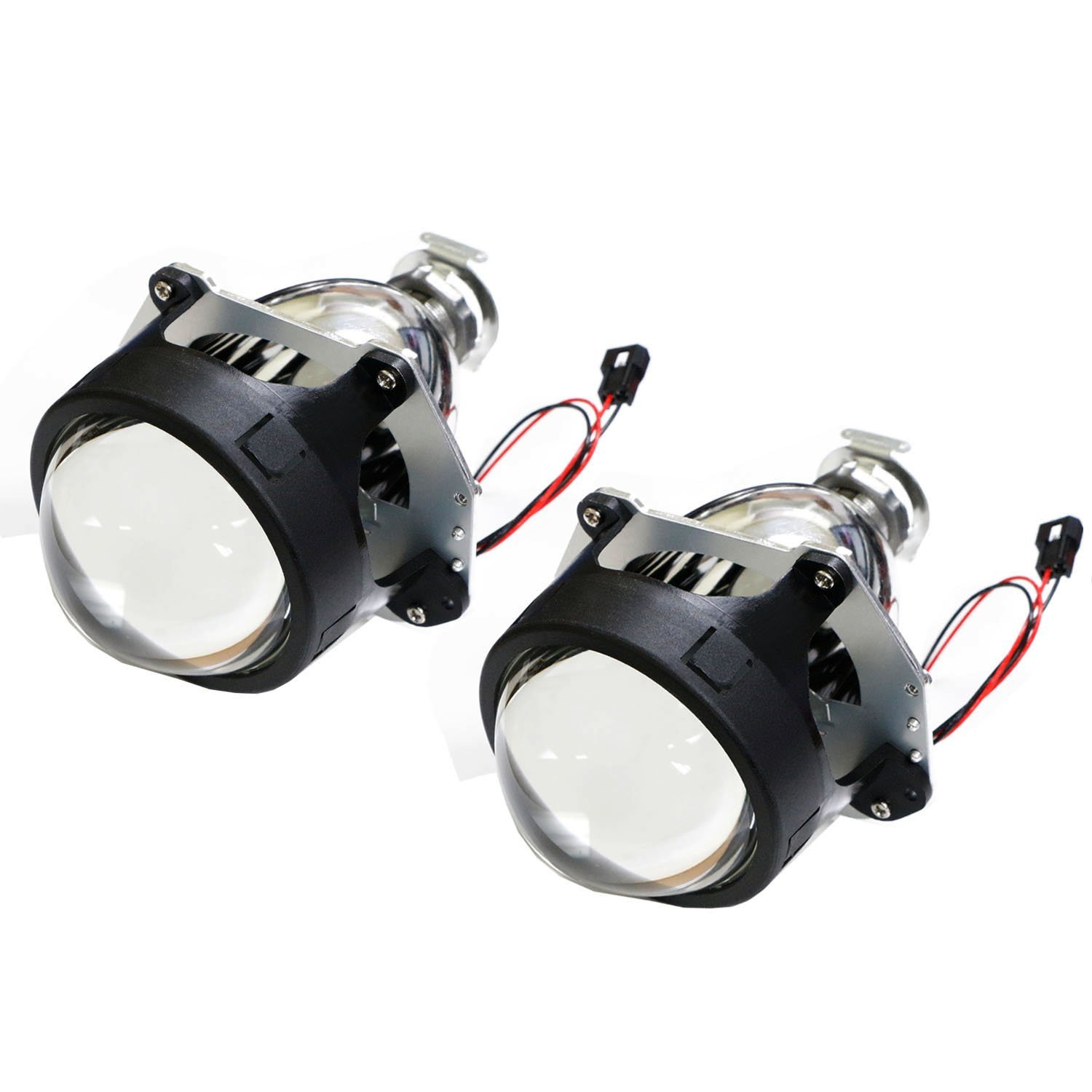

I also got tired of the headlights even with LED lamps they were just throwing light everwhere blinding people, while not putting a lot of light where I needed it.
So what do you do? Make your own!
I got these guys yesterday along with some CREE led chips and boost converter LED drivers. I'm going to work on building some custom LED headlights with projector lens over the next week.
Parts so far

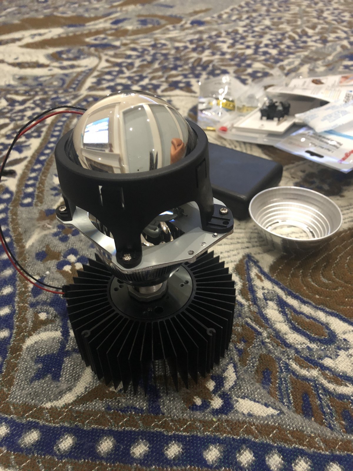

I'm going to modify the projectors to mount the LED chips and design/3d print a case to hold the back side, But I'm going to use the stock lights you can buy with the goblin and just cut the back off to house the LED heatsink.
The LEDs will be slightly under driven at 37volts and should produce around 8k lumens each. Your typical headlights in say a BMW produce around 2700lm on high beam
