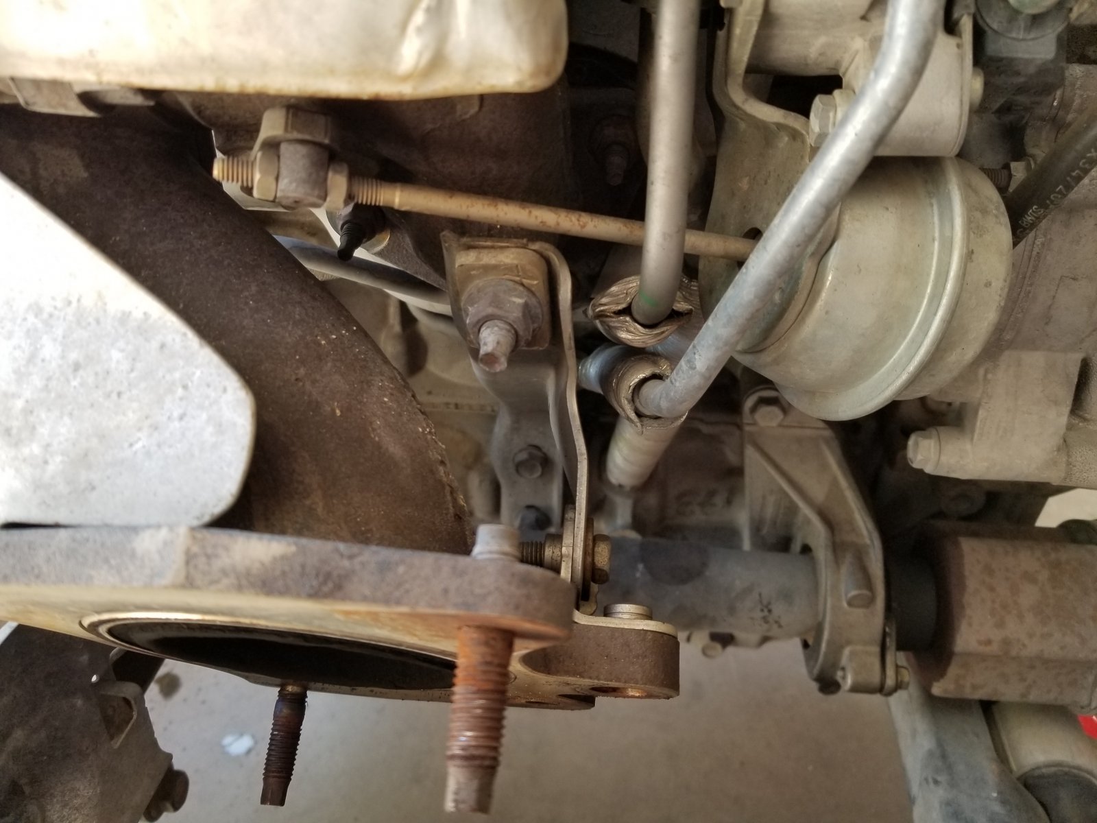

Scanned it twice no codes, but cheap scanners were used. I can plug into it on Monday. What does the waste gate connection look like?
I don't have a picture, but the wastegate is on the bottom side of the turbo. It's a can shaped thing with a single vacuum line and a push rod that goes that goes towards the exhaust. Check the vacuum connection and the push rod. I think there is a locking nut on it. Make sure nothing is loose.

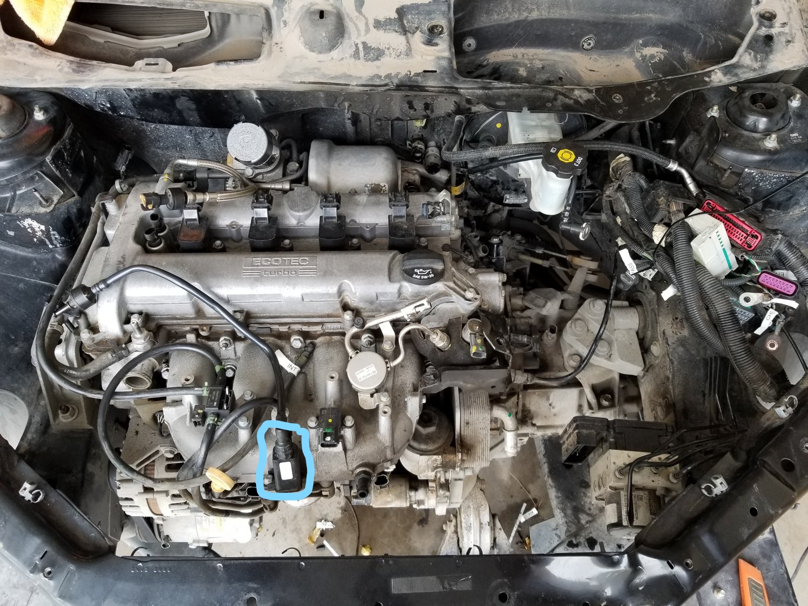

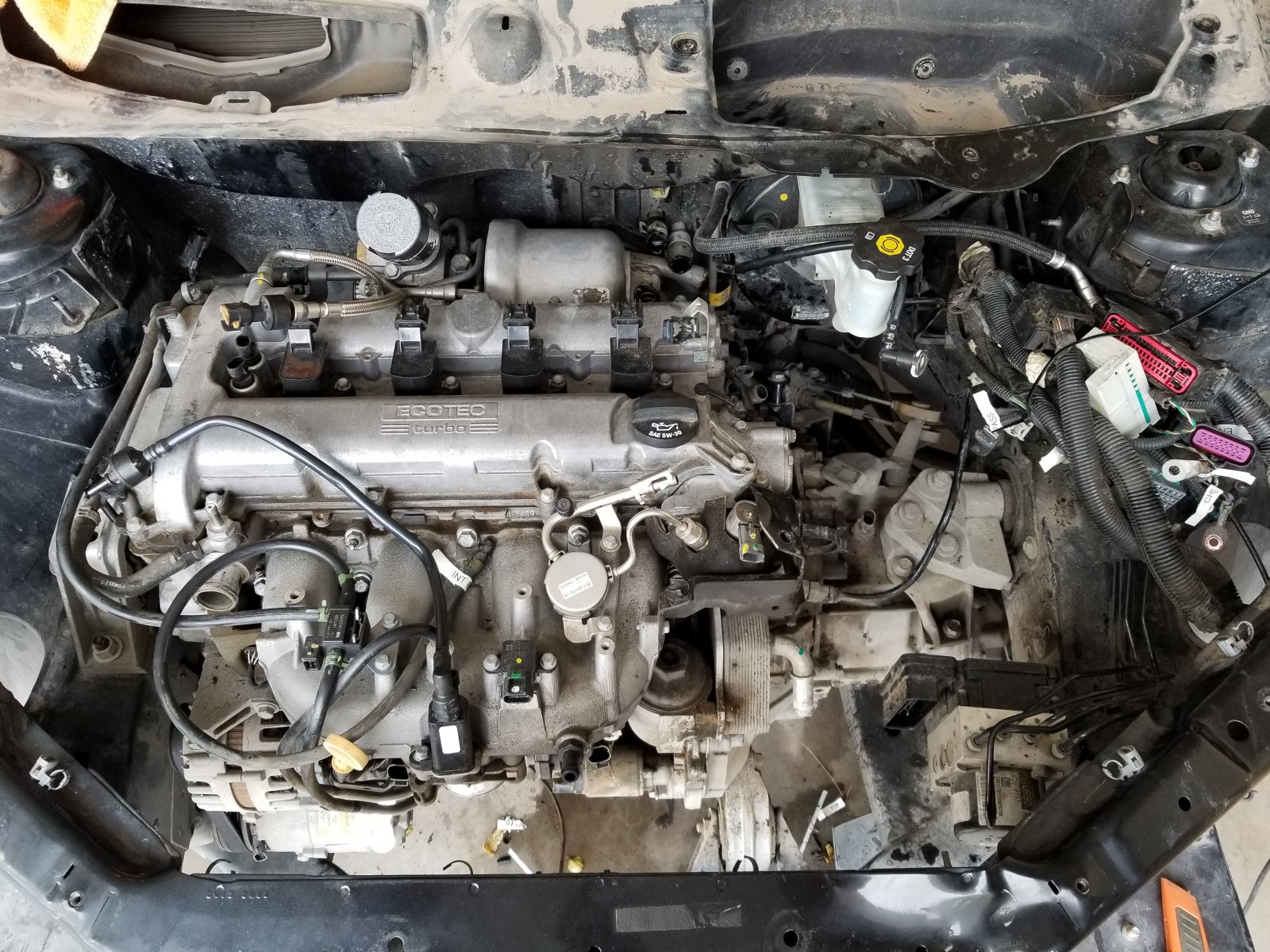

I'm guessing Brian is talking about this?
The rectangular box mounted on the intake manifold between the cylinder 1 and 2 runners with the 3 tubes connected is your boost reference. The hose coming off the 'front' side closest to the cylinder 1 intake runner goes from this box to the waste gate. The hose on the side closest to the engine block goes to your turbo plumbing pipe (pressurized) very close to the MAP sensor. If these are connected correctly it has to be some electrical connection.
