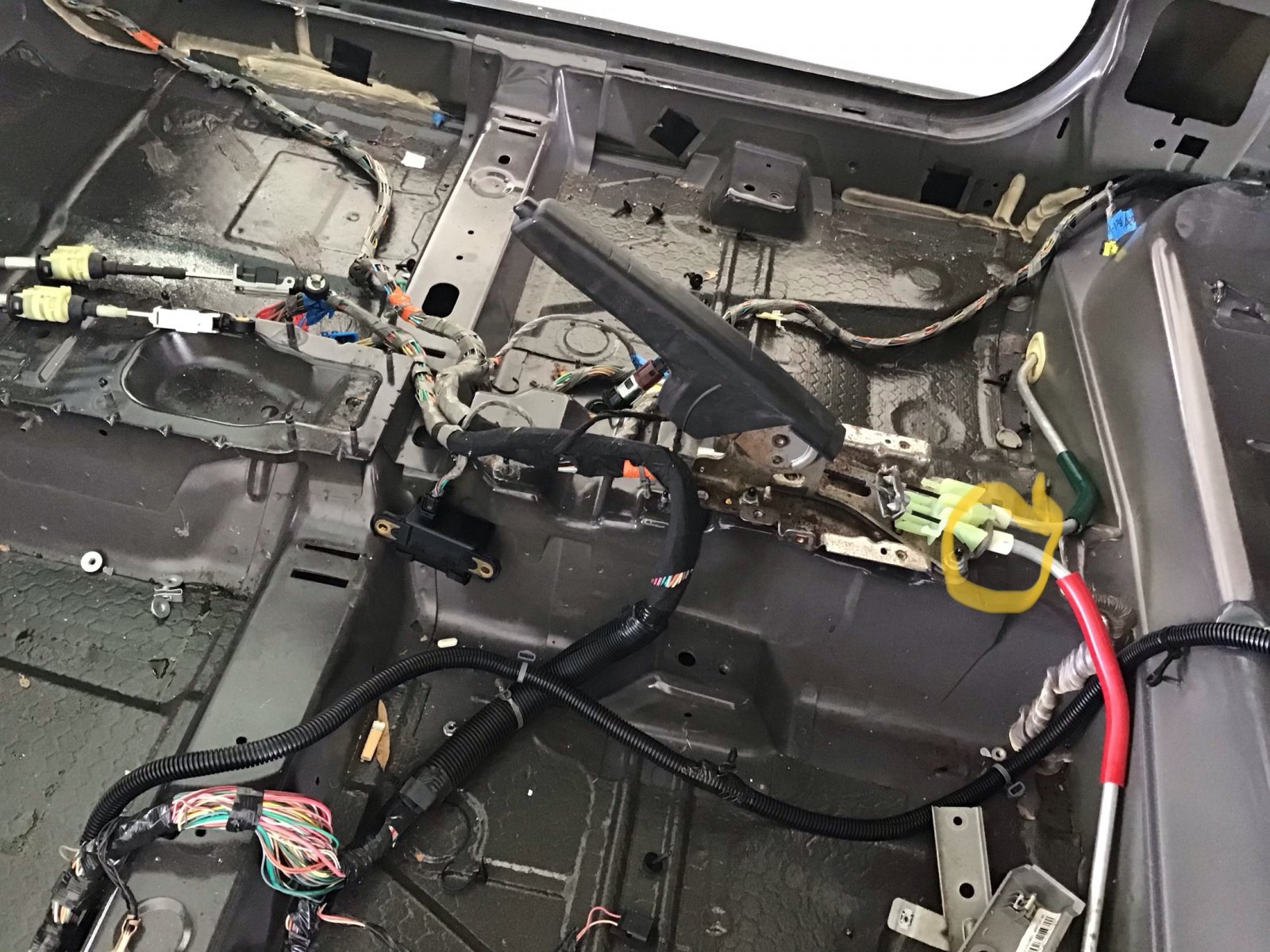

In addition to what DF supplies when you order the parking brake kit you will need the ebrake handle with the short cable to splitter that the cables hook to. You will also need the aluminum e-brake tubes. I think thats all you need from the donor.
