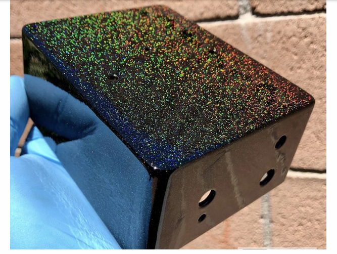

I had a hard time picking a color for my powder coat.
My guy sent me to a website that had over 6500 colors!!! I was overwhelmed to say the least.
too many options.
This is what I went with!!!
too many options.
Awesome Color! Can't wait to see it on the car.
