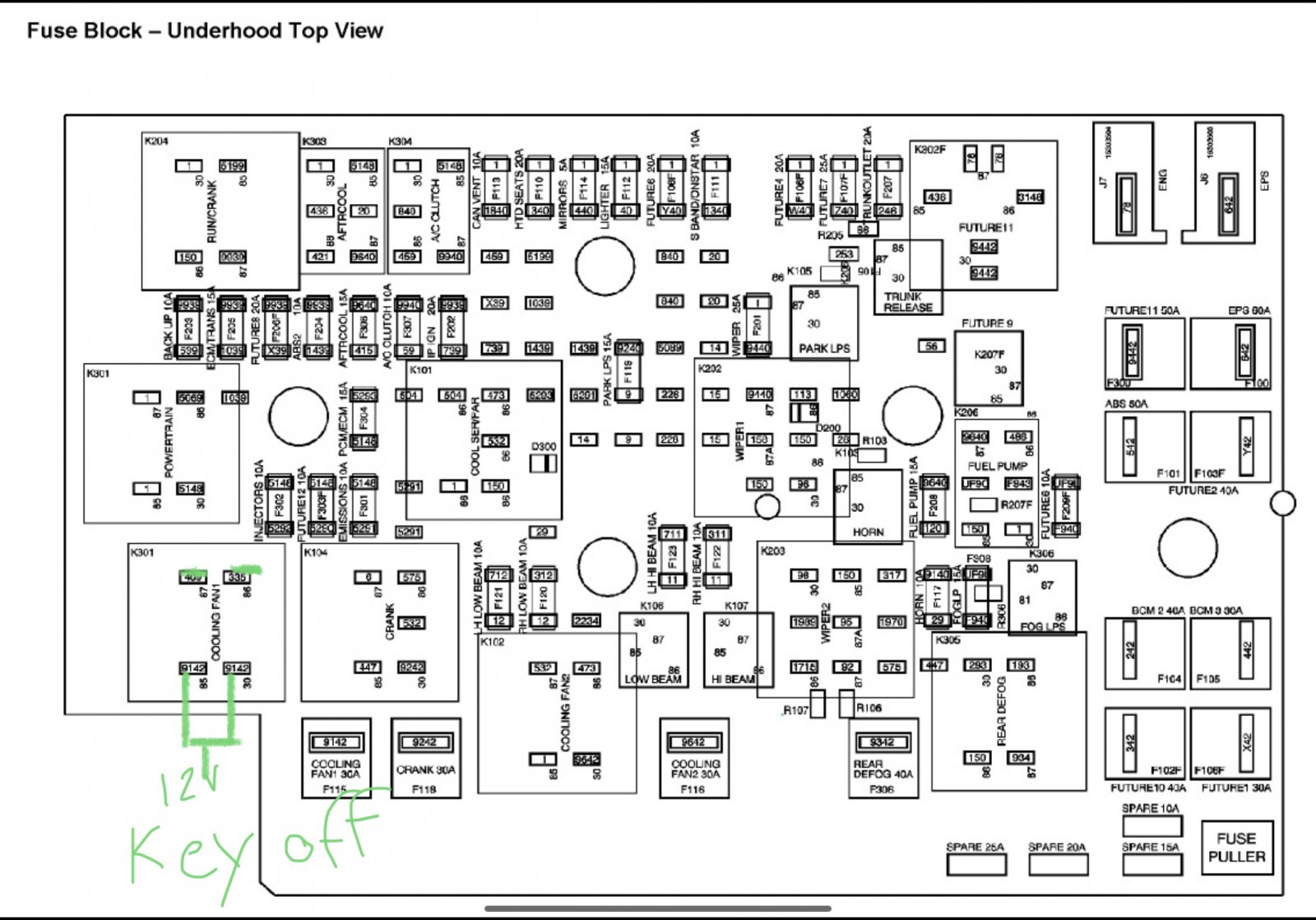

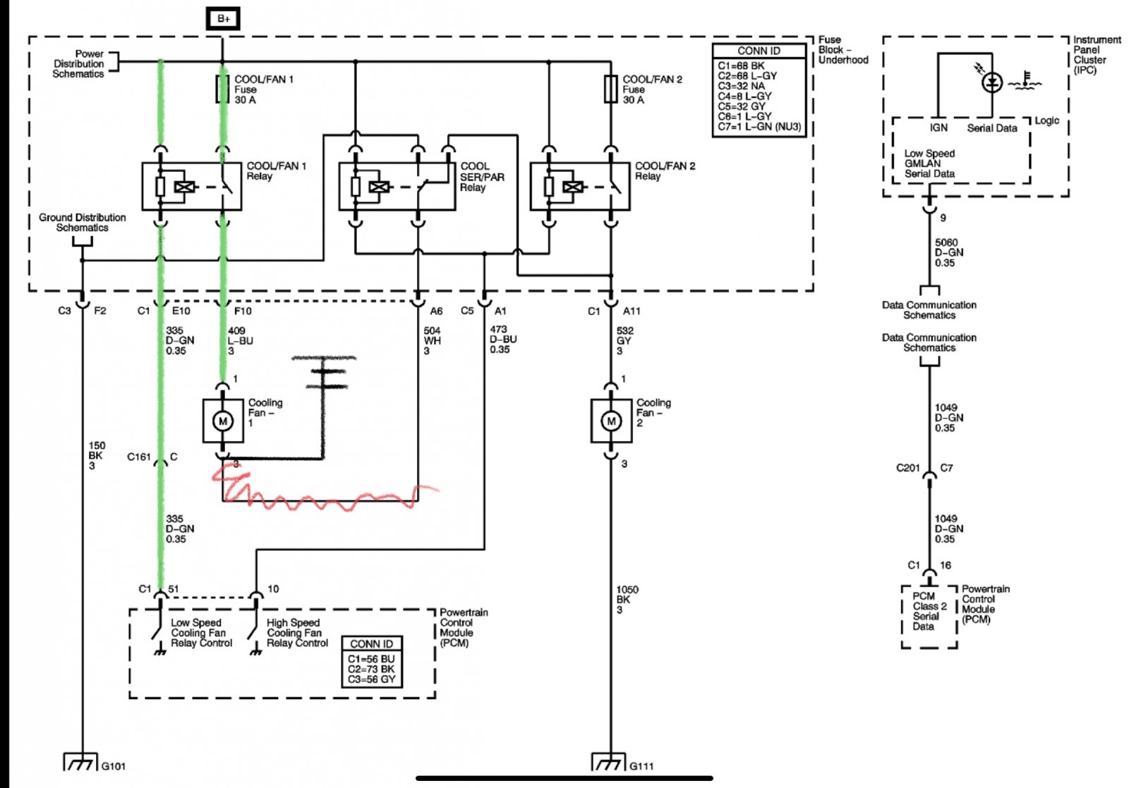

I have verified that the fan is good. I have verified that I have 12V with key off and on at the relay slots 30 and 85 circuit 9142 at the fuse box. I read the signal wire for the PCM C1 pin 51 to the fuse box slot 86 circuit 335, it has continuity. Fuse box slot 87 circuit 409 has continuity to the fan positive. When the engine is up to fan operating temp nothing happens. I have tried using HPTuners VCM scanner to control the fan to turn on and still nothing. If I pull the relay and jump either slot 30 or 85 to slot 87 the fan will turn on. I have swapped the relay with the aftercool/heat exchanger relay and the fan relay works fine for the heat exchanger fan. So I don’t believe the relay is bad. I’m kinda at a lose.

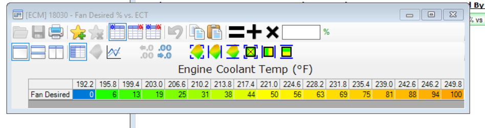

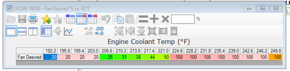

Ok, so wanted to check my tune settings. One is what the base tune was, the other it what my current tune sets at. I should be able to adjust the fan to turn on at a lower temperature and feel safe with the temp range?

I would set it to 100% at 200 degrees and zero below that. I'm not sure how the less than 100% works within the the wiring diagrams since it looks like it is either low speed with both fans running at a reduced voltage (in series) or high speed with both fans running full voltage (in parallel). With it set to 100%, I think you should be able to use either cool/fan relay 1 or 2.

Alright, a couple of things. Set the the tune to 100% fan at 199.4. Fan turns on as it should. Found also that with VCM Scanner, with the engine running I was able to enable the fan, however I could not get it to turn back off. Shut of the engine and turned back on and fan was off.
