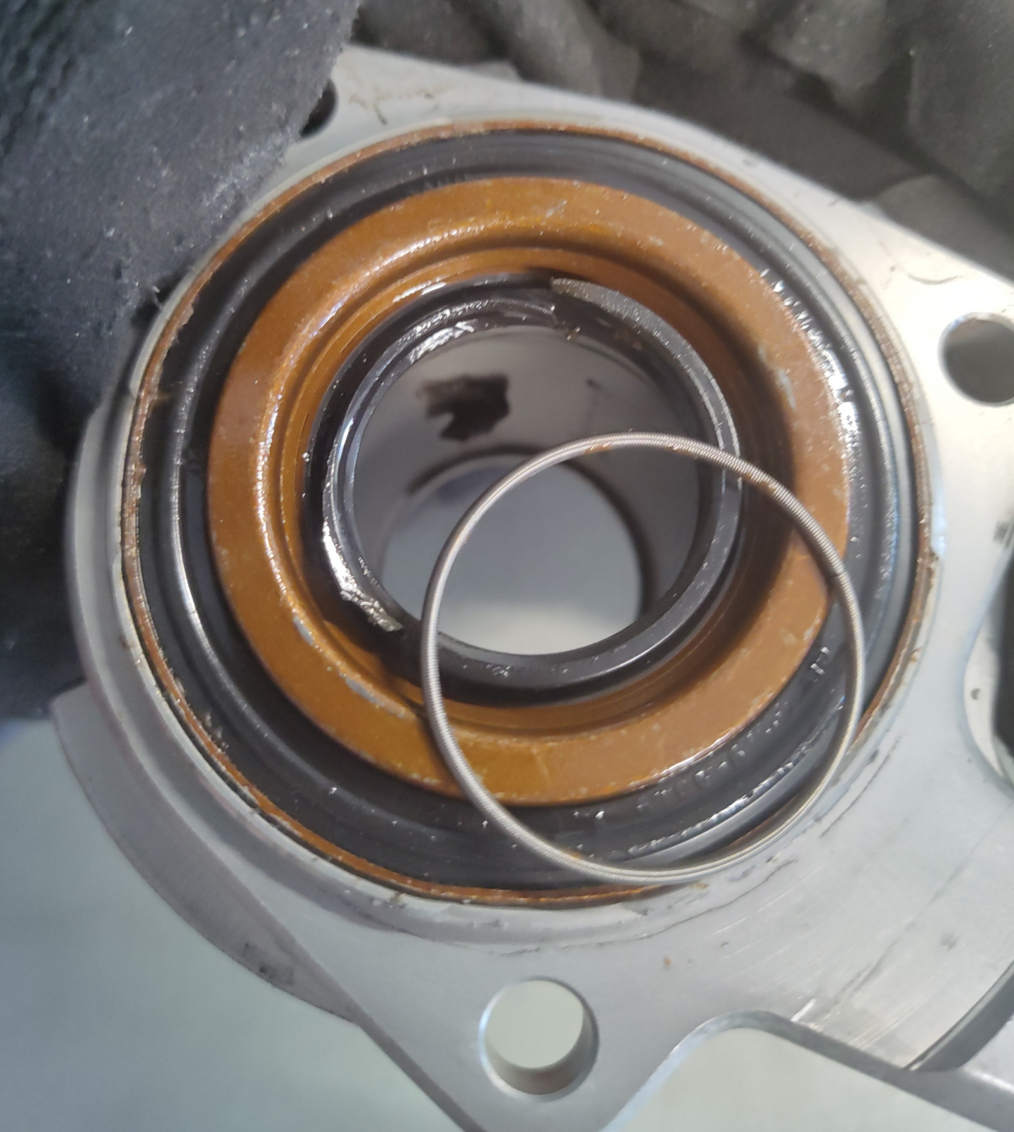

I did manage to make my 4 hour round trip, plus a couple mountain passes, on the new F23 setup. Unfortunately I had a decent fluid leak from inside the bellhousing that contaminated the clutch disc, preventing me from putting down anything more than half throttle. I still managed to hang with everyone in the mountains. I surprisingly didn't seem to have any issues with trans fluid levels, only topped off twice.
I got everything pulled back apart and found this torn input shaft seal. The seal surface on the input shaft was cleaned up, and the seal and input shaft lubed during assembly. Not sure if I just didn't do an adequate job there or if the seal was defective and I just didn't notice it. In any case, I have a new clutch disc and slave cylinder on the way, and will slap everything back together and get back on the road.

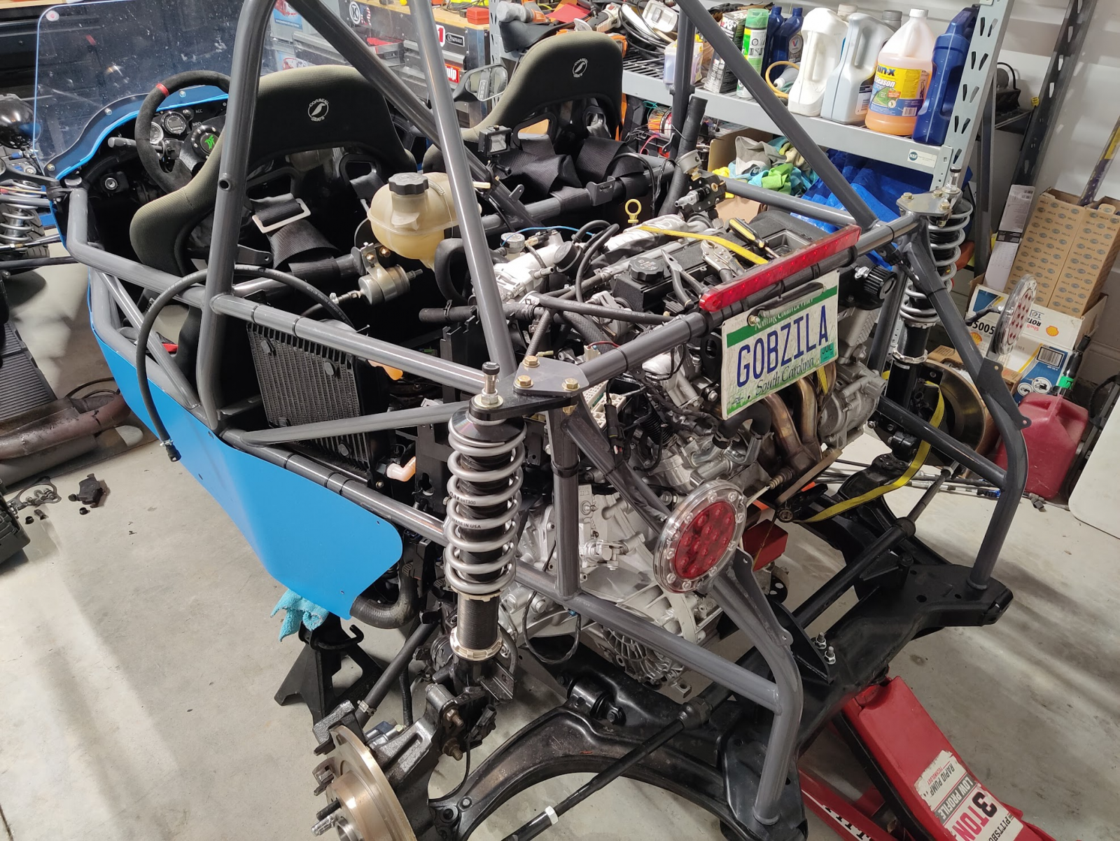

Reunited once again... besides the clutch hydraulic line, the only other things actually connected are the subframe to the frame and the trans, and the side trans and motor mounts to the frame. Hoping to get everything else buttoned up tonight.

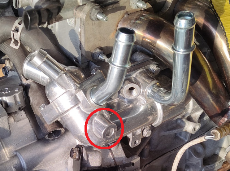

For an LSJ, the swap requires a base model thermostat housing, as the LSJ one interferes with the shifter cable bracket mount on the F23 transmission. While the base model and turbo thermostat housings are nearly identical, you will need the base model thermostat housing- the turbo one has an additional threaded hole for the turbo coolant feed line. Both will have a threaded hole for a temp sensor (LSJ is the only one with a sensor in the head). You can plug that hole with a BMW oil drain plug. You will also have to re-plumb the coolant lines that go to the oil cooler. To pipe them like the LNF, you will need a 3/4" hose tee to splice the oil cooler return into the expansion tank line, and a 1 1/4" hose tee to splice into the radiator incoming line.

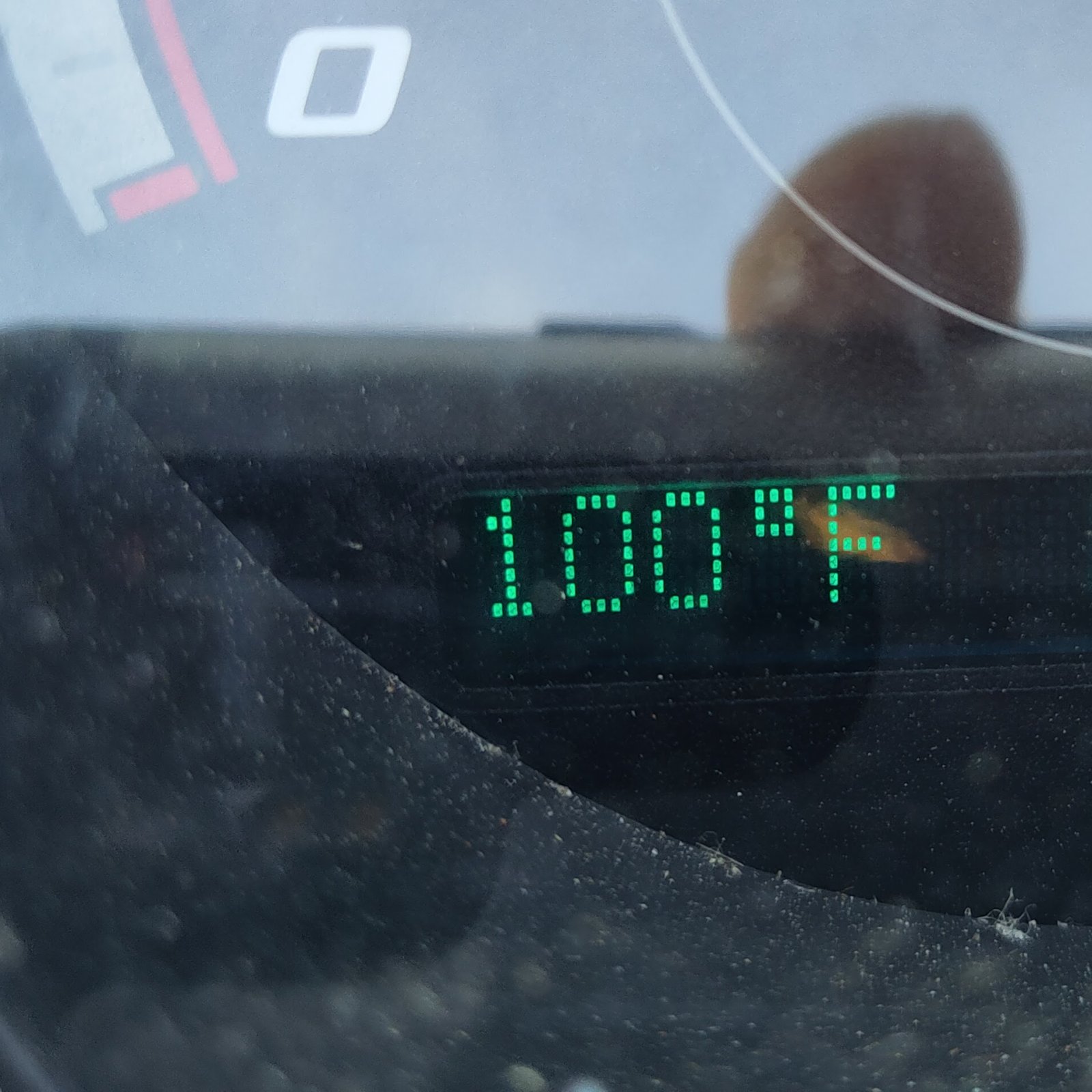

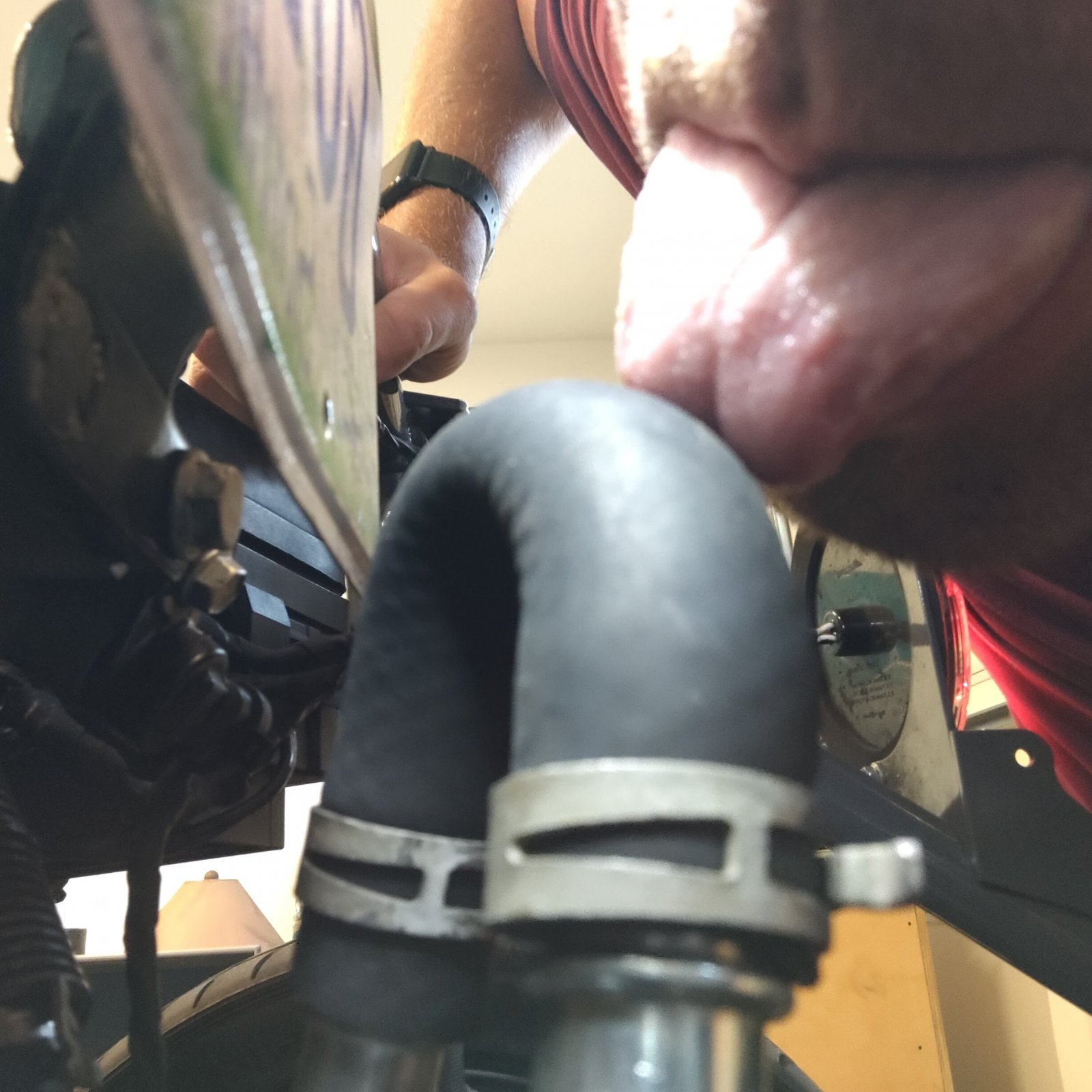

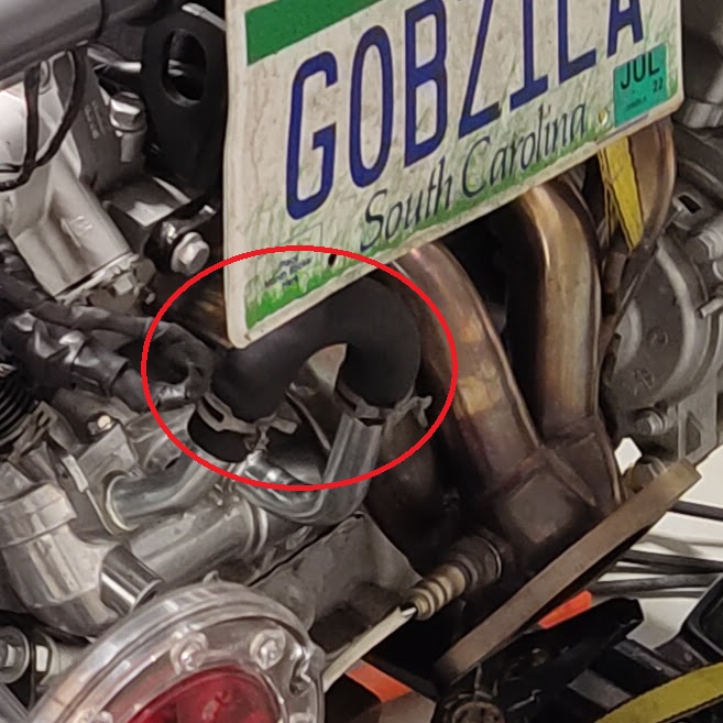

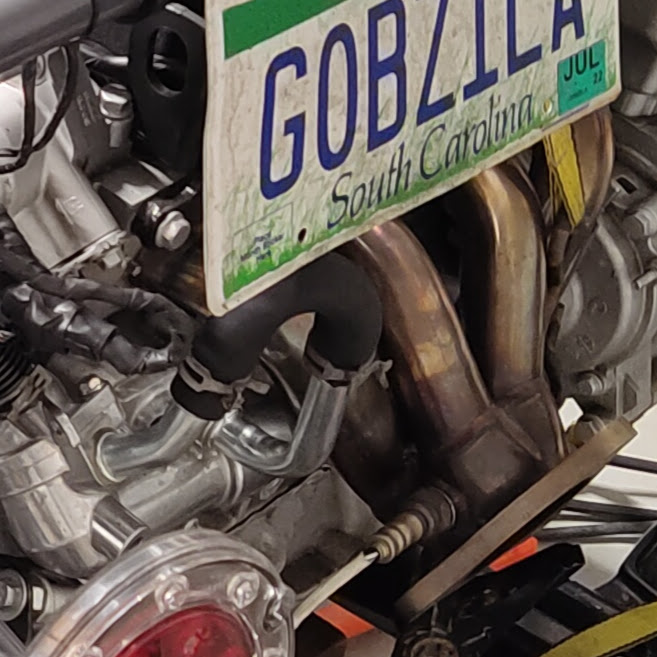

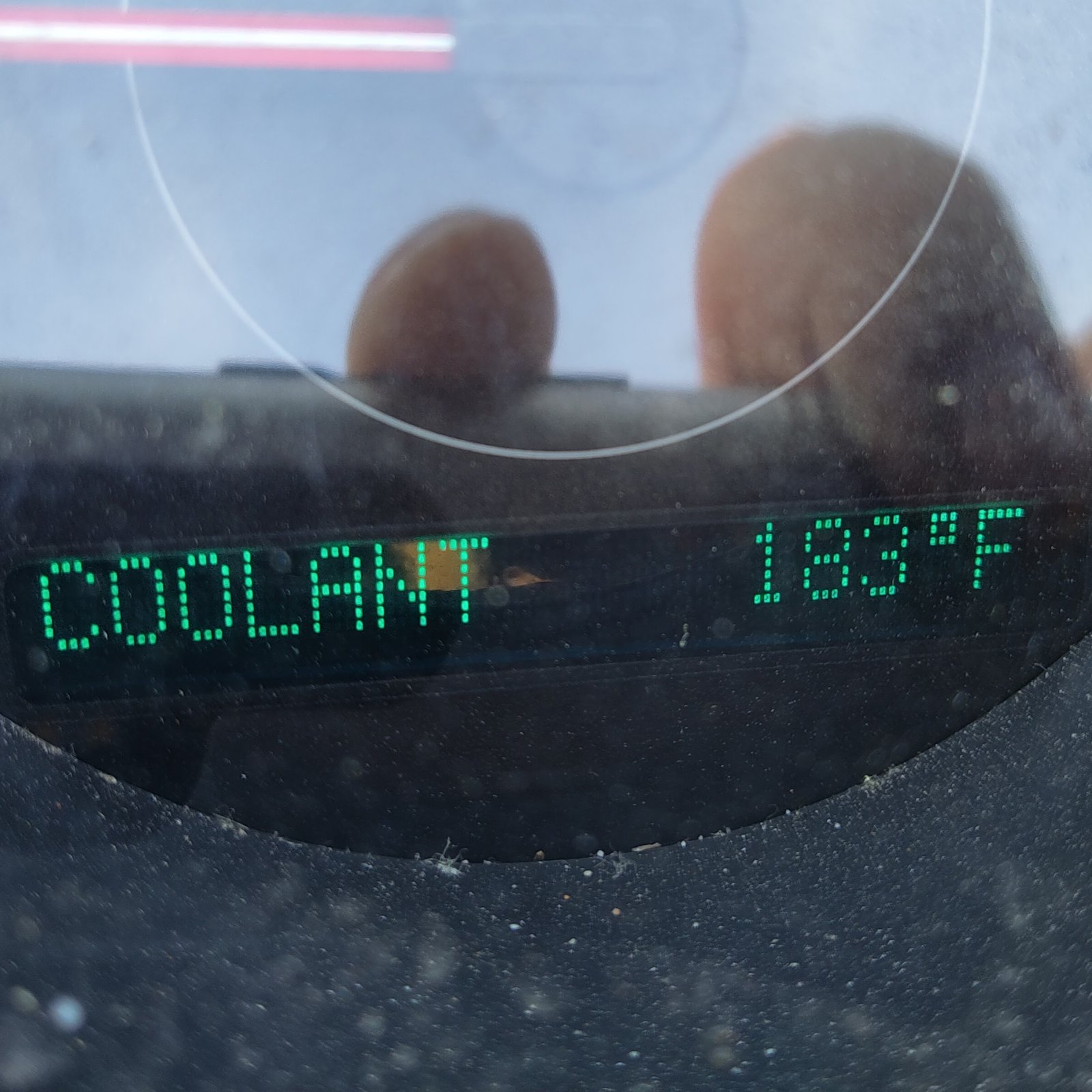

Almost forgot I owed this update. There were concerns about the heater core loop being too close to the exhaust, picking up heat, dumping it into the coolant. I said I'd post a pic of my tongue on that hose. Here you go. 100°F outside, fresh blacktop, stop and go at a long line quick cycling intersection, coolant temps as high as they ever get...
