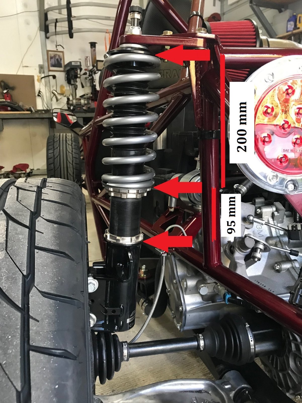

This is how I have done my preliminary setup on the rear Coil-Overs. Are these numbers a decent starting point? Thanks
If your rear control arms are horizontal when the car has the weight of passengers in it, then you are perfect.
Same with the front lower control arm, horizontal = perfect.
