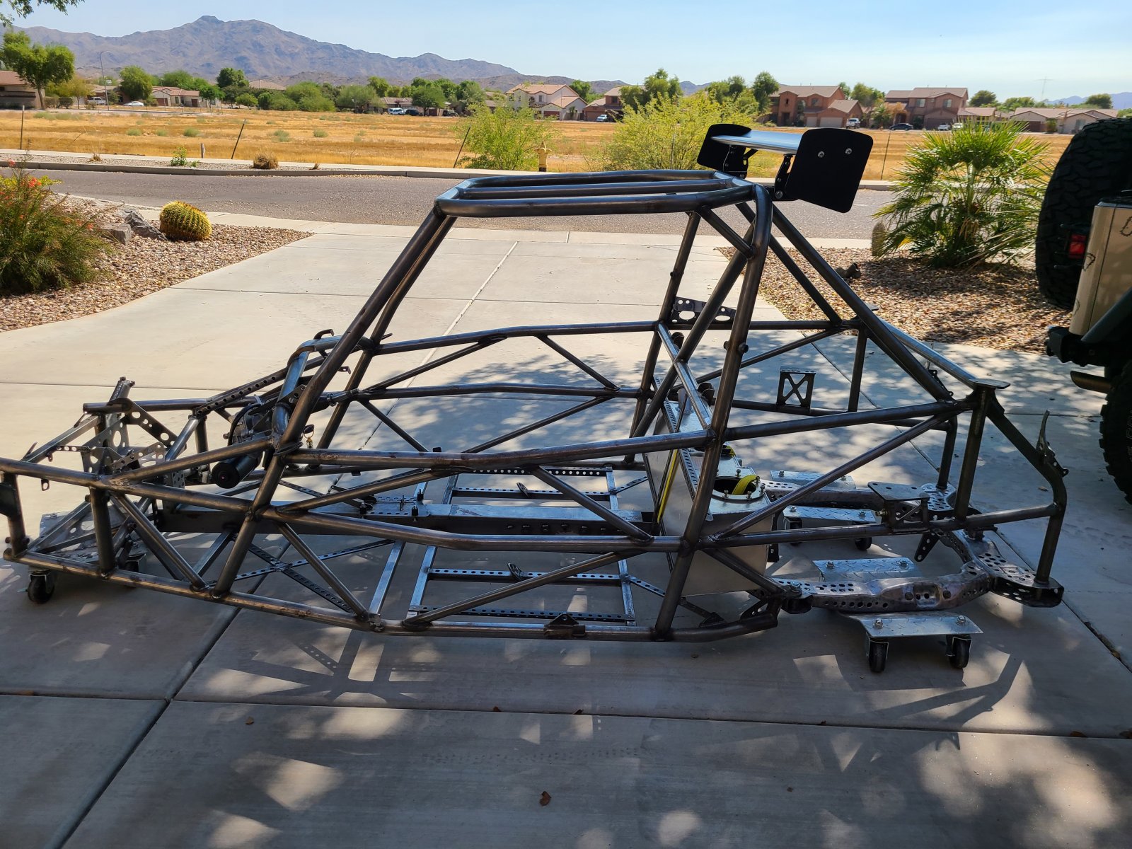

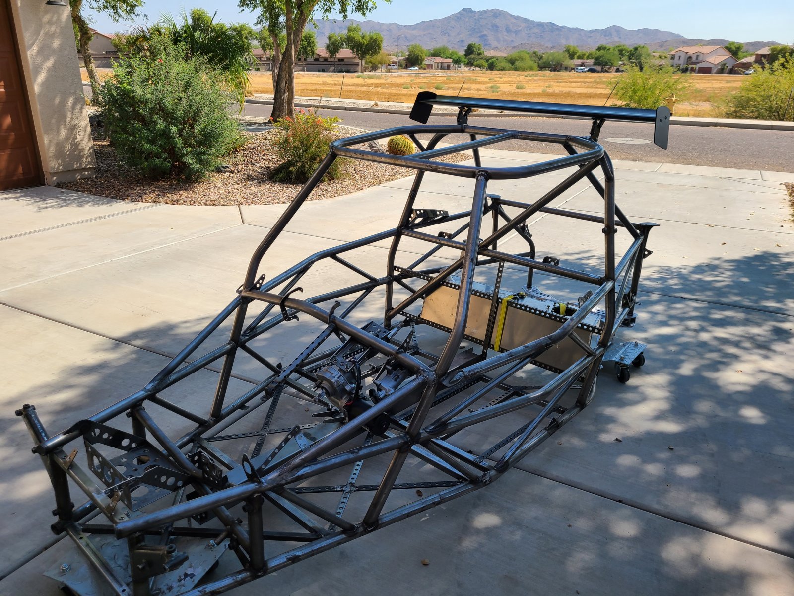

Since wings work most efficiently in clean air, logic says to put it up high - so mine will be mounted at the back edge of the 'roof'. This provides for short mounts with almost undisturbed airflow - a flat roof panel provides good laminar flow in front of the wing. And because the wing is working efficiently, a smaller one is needed to have the same effect as a big rear wing, a bonus is it produces less drag. Plus the downforce is pushing onto the CG location of the chassis, not behind the rear wheel centerline that tries to lift the front of the car. So the application of front end downforce is 100% for stability and not as a rear wing counter-force, making it smaller for less drag too. Yeah, I've put a lot of thought and research into this. ;):D
