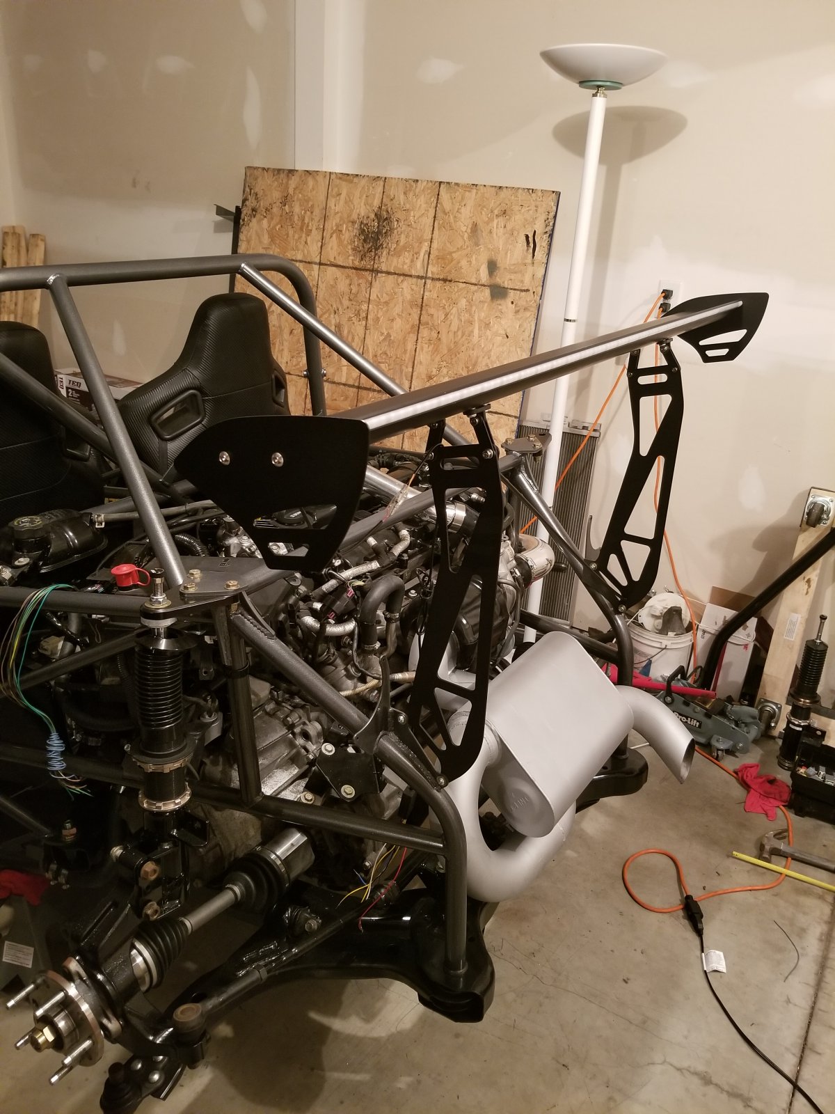

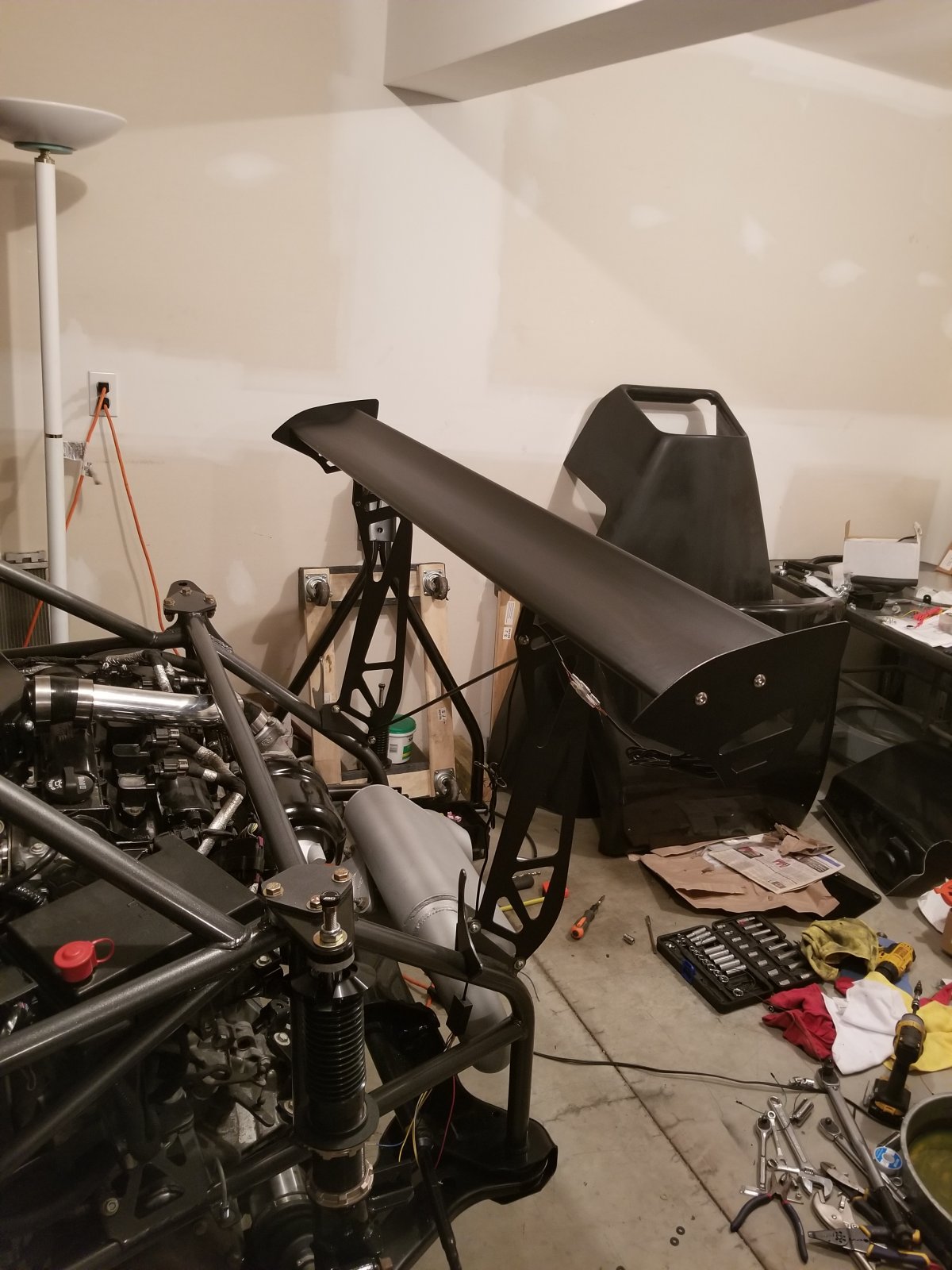

With how far over-budget I am, I only spent about $190 on my wing, shipped. We'll see how it turns out. It's just plain aluminum, but it looks ok in the pics.
It's going on THAT list ... you know the one. The "If I don't like it, I'll buy a better one later" list.

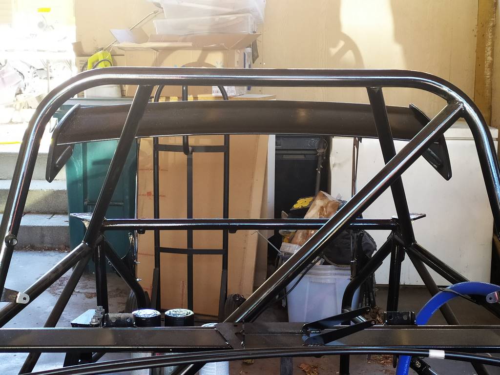

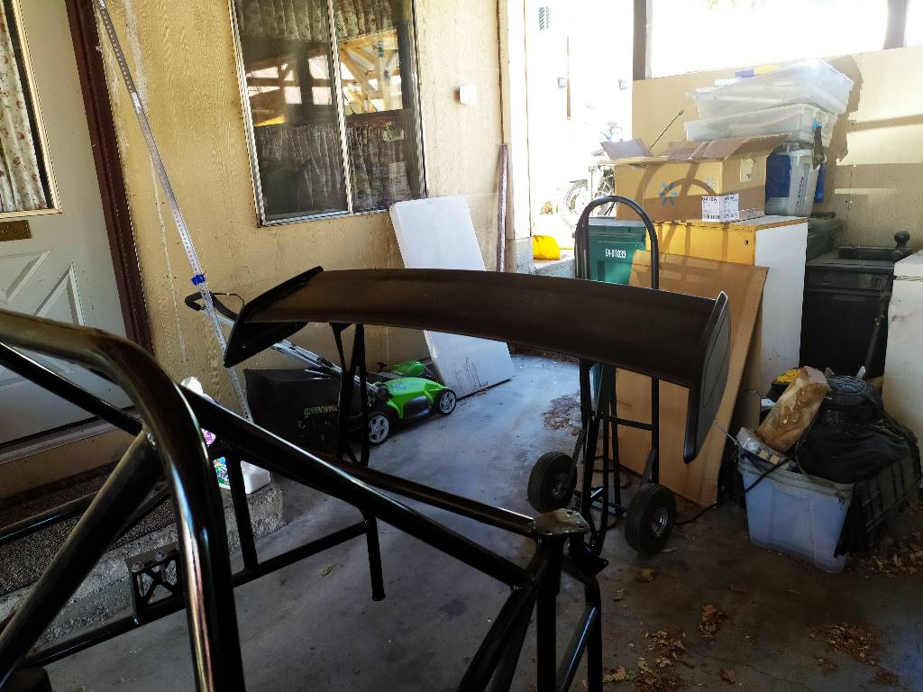

Has anyone tried using the Cobalt wing? I did a test fit with mine early on to see if I wanted to keep it. I decided I would rather have an aluminum wing instead (which I have yet to purchase).
The wing is made of plastic and is not really that stiff. Across the entire wing on the underside is an inch-wide channel that runs the full length of the wing. I think it's there to add some stiffness.
I cut the supports off, then filled the holes where the supports where with epoxy. I slightly bent a piece of 1" x 1/8" x 40"ish flatbar to follow the curve of the channel and welded some brackets to it for attaching to the supports. I attached it to the wing with the flatbar in the channel, then filled the channel with epoxy. It's very stiff now. I had taken some pictures of the process but the camera I was using apparently was not saving every picture.
Here it is on the doner:
15120
And here it is on my frame after painting with plastic primer - i didn't go any further because I didn't think I was going to use it:
15122
15123
