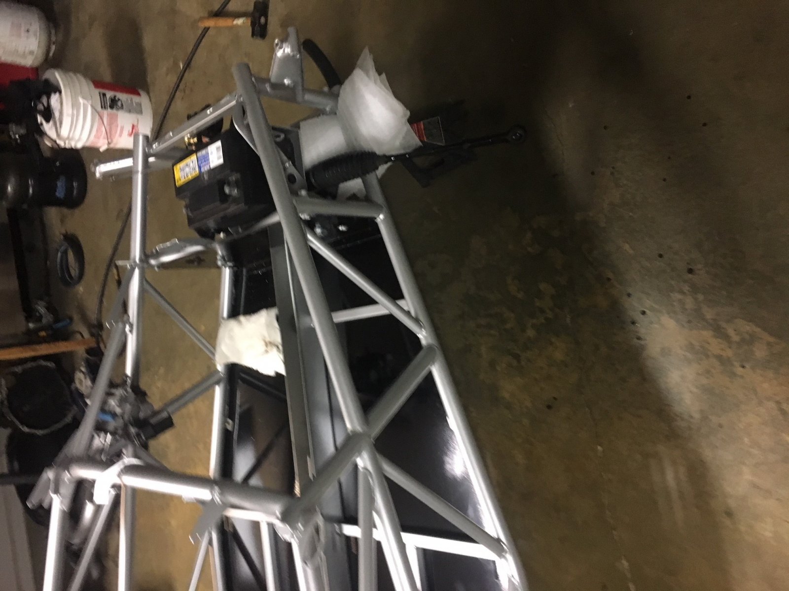

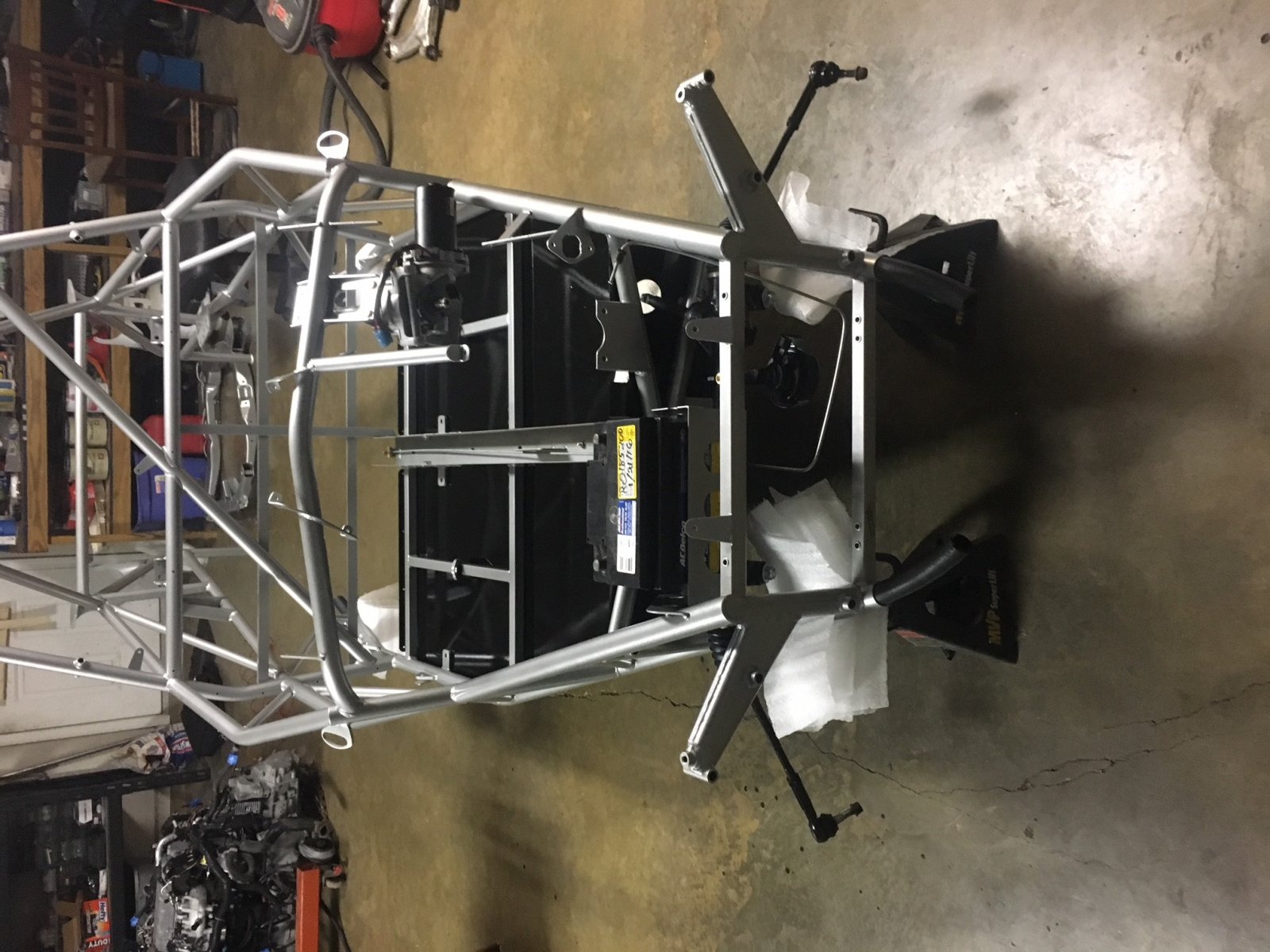

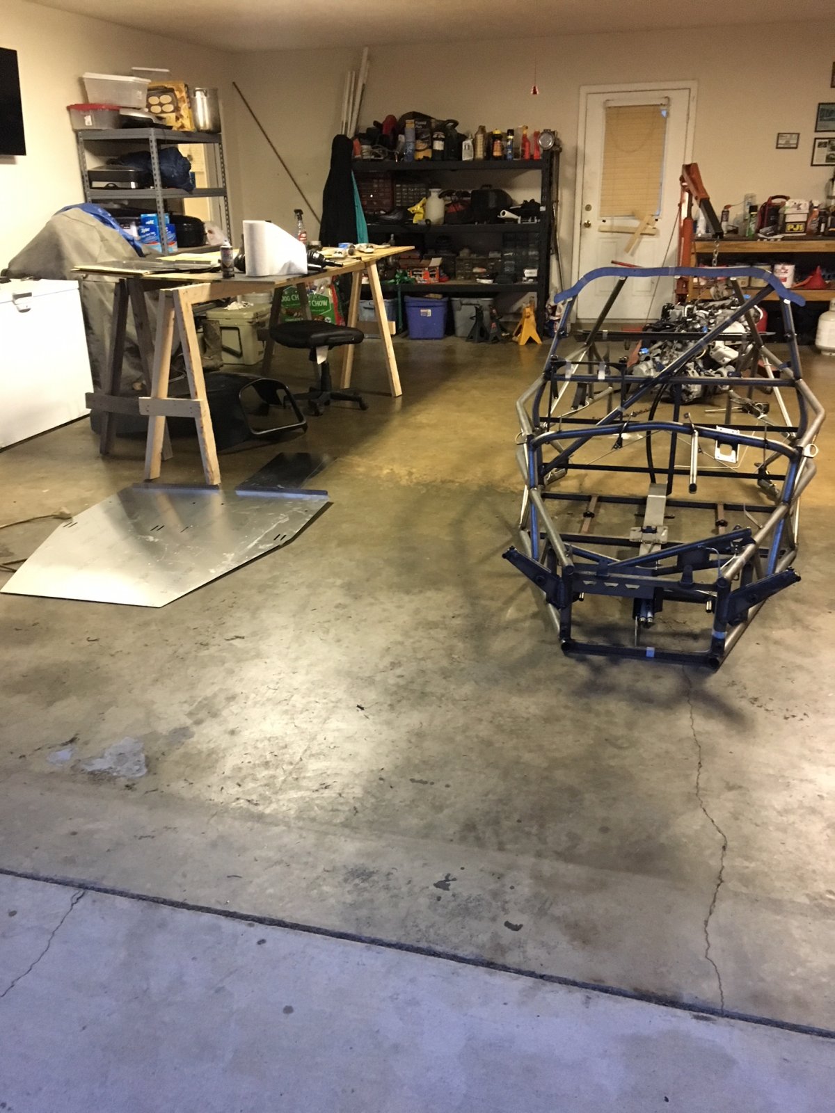

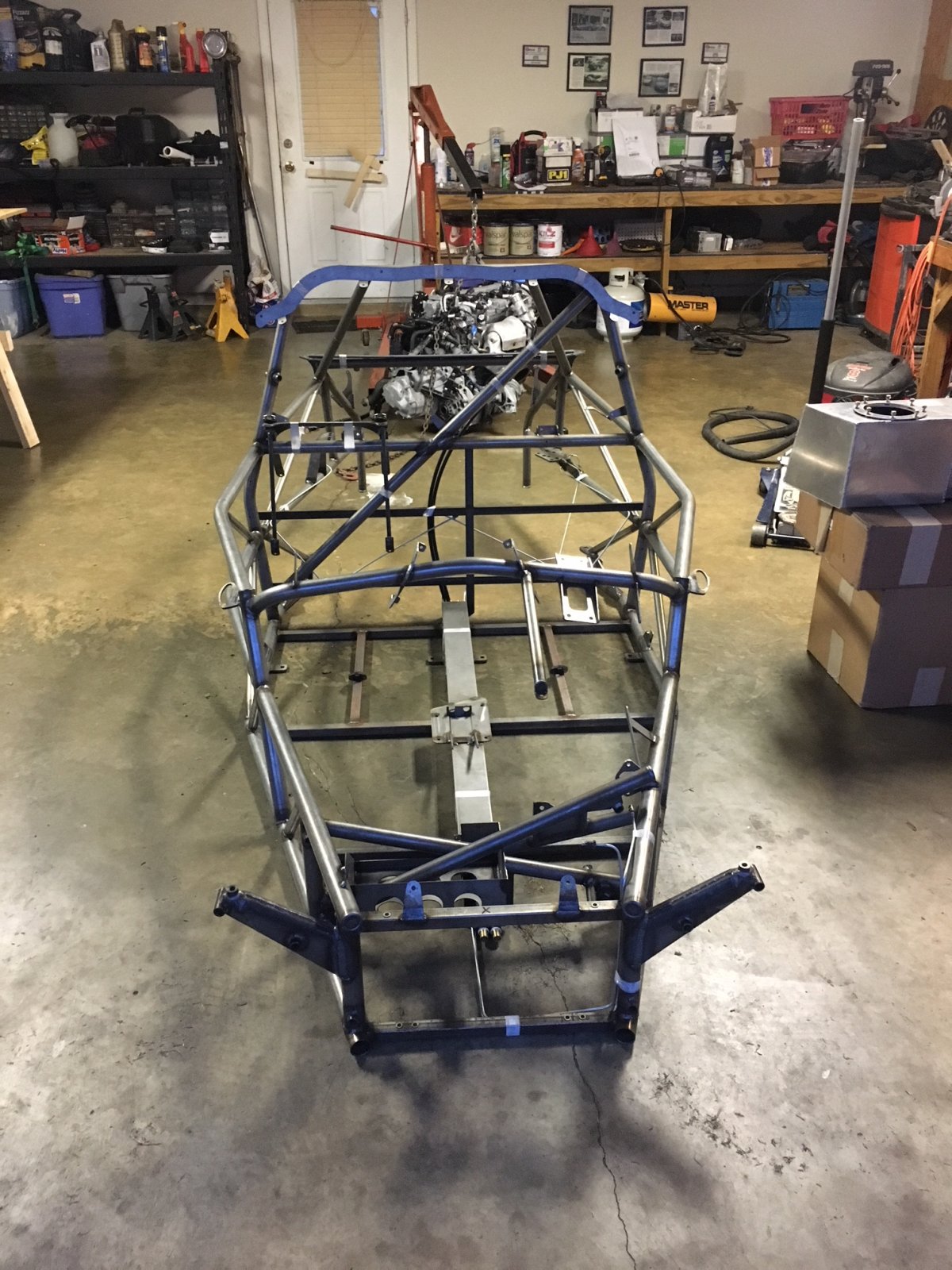

Read my build about the steering shaft. You don't have to press it or break it. It's just lube in there that has thickened. Heat, strong degreaser, and time to soak and it will move without effort!.Day one resulted in the hoses getting pulled, bulk head and floor-pan installed, Steering installed until I ran into the slider shaft which will not slide. I shall motivate it at work today with a press that will either move it or break it. I got to put in about 2.5 hours of work in and some of that was organizing all the parts/hardware. figured it would be good to record actual time spent.

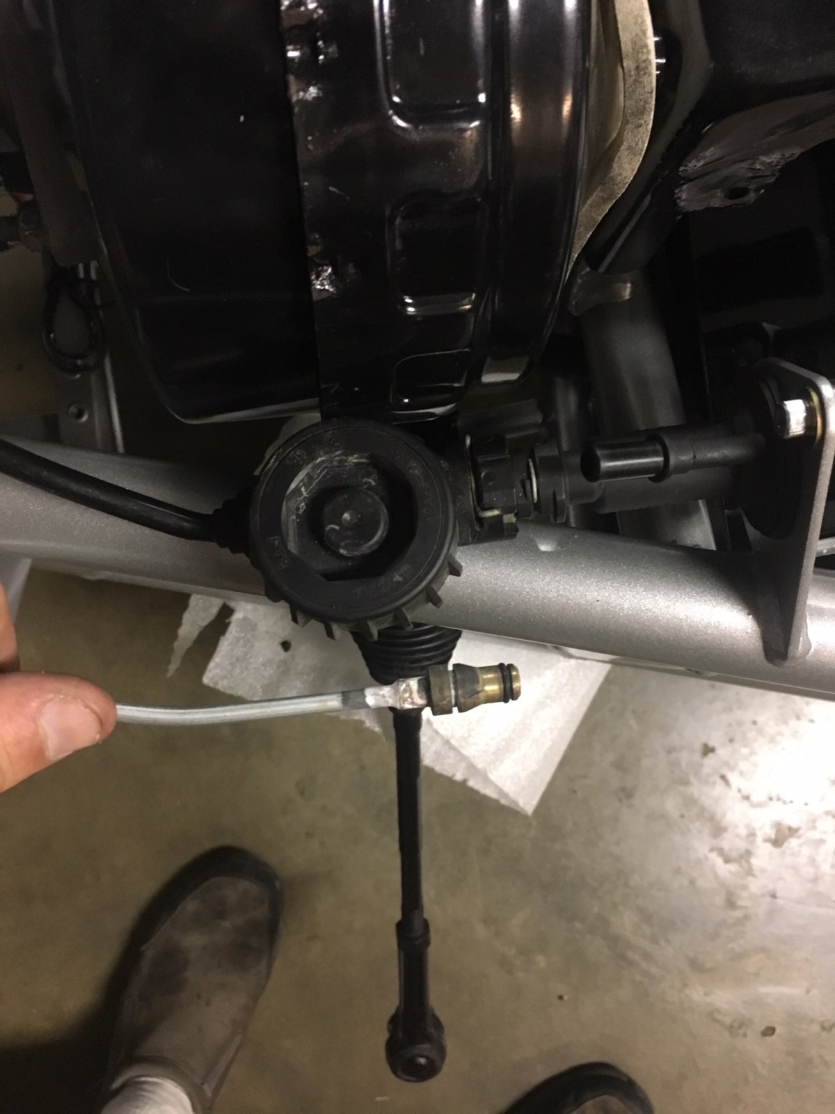

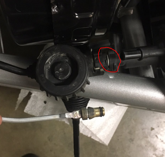

The holes for the engine depend on the engine/transmission you have. That's why there are so many holes. One plate fits all. I'll see if I can find the post about it.Thank you, We got it moving and installed. I am at a loss on how the clutch line runs. anyone have any pics that show it? I have been searching random and haven't seen any yet. Same with what holes to use for engine mounting. I have seen that thread but can't remember which one it was.

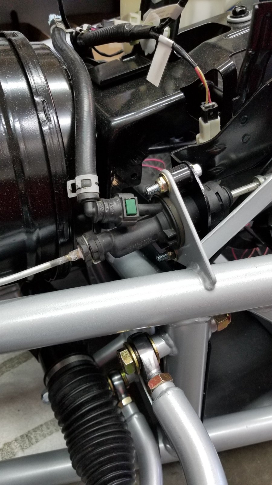

that was my next question. not sure how the brake res gets mounted and what is done with the 2 open holes on the master. I don't think I got that far in video I guess. Thank you guys.Upper clutch master port goes to your brake fluid reservoir.
Lower port is where the hard line goes into.
