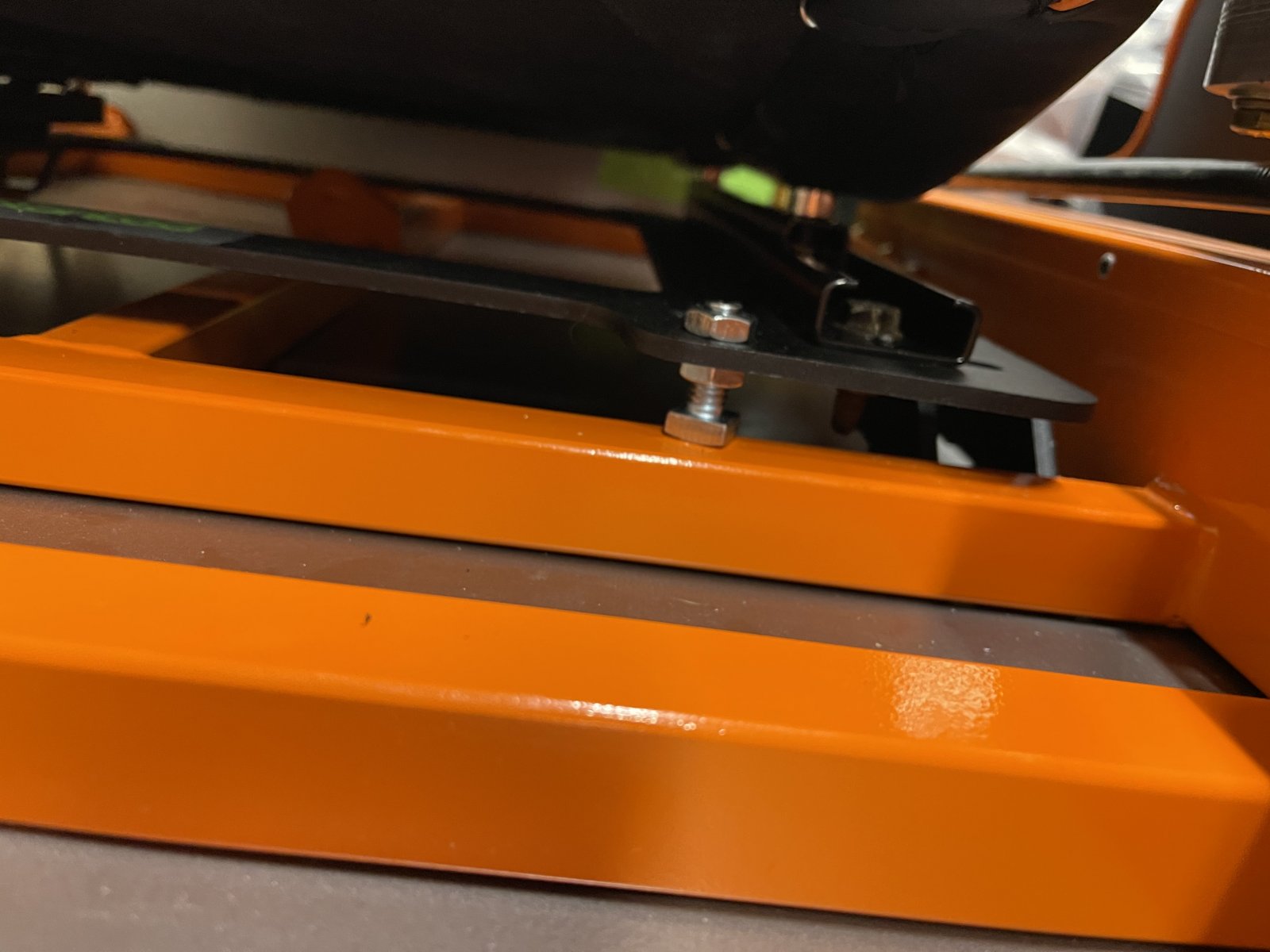

Yes. NRG recline seats, with adjusters. Mounting base is for a cobalt. Can’t remember the brand, but many have used there here after posted about it. It mounts like a cobalt seat, but it’s loose up front, so I added a spacer and hard mounted it to the crossmember.

Yes. Those are the ones I have. It slides right in, but I also modified the front so it was more stable. I’ll have to find it in my build thread.
They should work, but look a little tall and you may need to modify things to make them work properly.

I added a threaded hole in the front and ran 2 bolts up from the bottom to take up the space.
