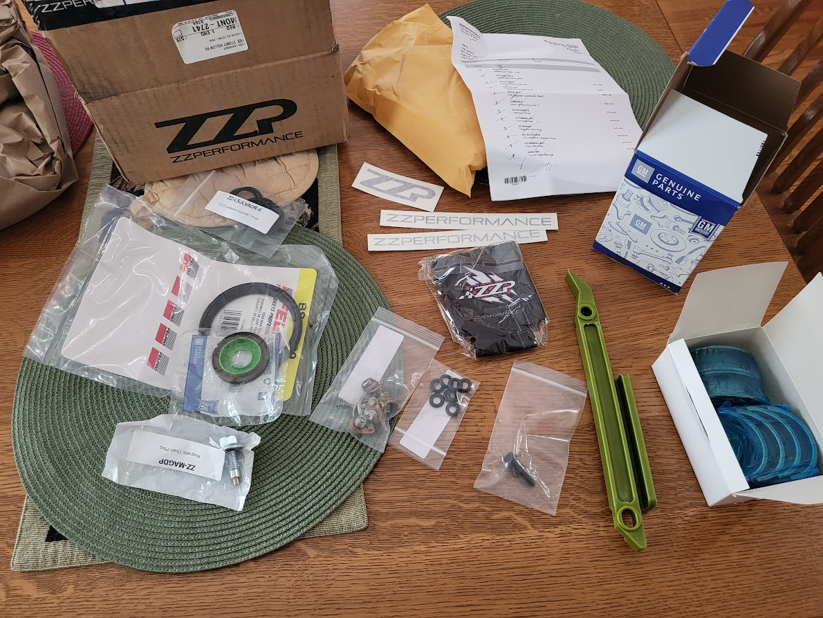

Always like seeing this box at the front door. More parts for the engine build collection.
38354
Top: Laminova tube Orings, ZZP +5MPH stickers,
Middle: Crankshaft front and rear seals, LNF oil squirters for each piston, injector Orings, ZZP magnetic beer coozie... this thing holds a full beer on the side of a fridge... or any steel surface. That's worth at least $4!
Bottom: magnetic oil plug, bolt and ZZP green timing chain guide, crankshaft bearings

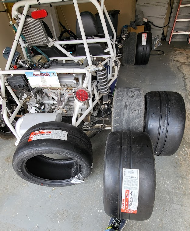

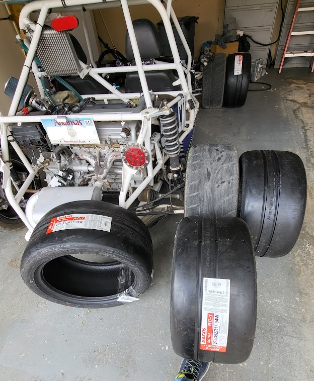

My wife saw the stack of new tires.
Alice: "You bought bald tires."
Me: "They have DOT approval."
"Your not driving those on the street are you?".
They are tread wear 100, and my racing tires are tread wear 40, so these are my hard tires.
But they don't have any tread! The last tires barely had any tread, and these are worse.
39414
39416
Gotta love Arkansas. The po-po don't even pull you over if you're running the racing slicks.
Best part of getting new tires is abusing the old tires. :)

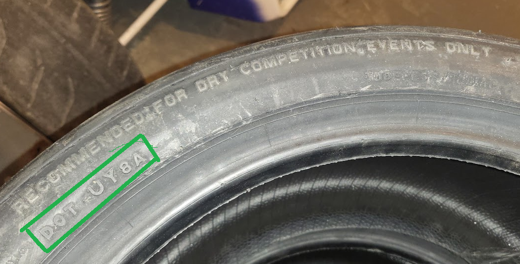

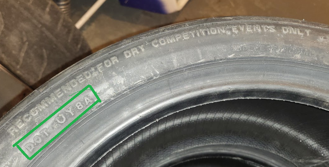

View attachment 39414 View attachment 39416

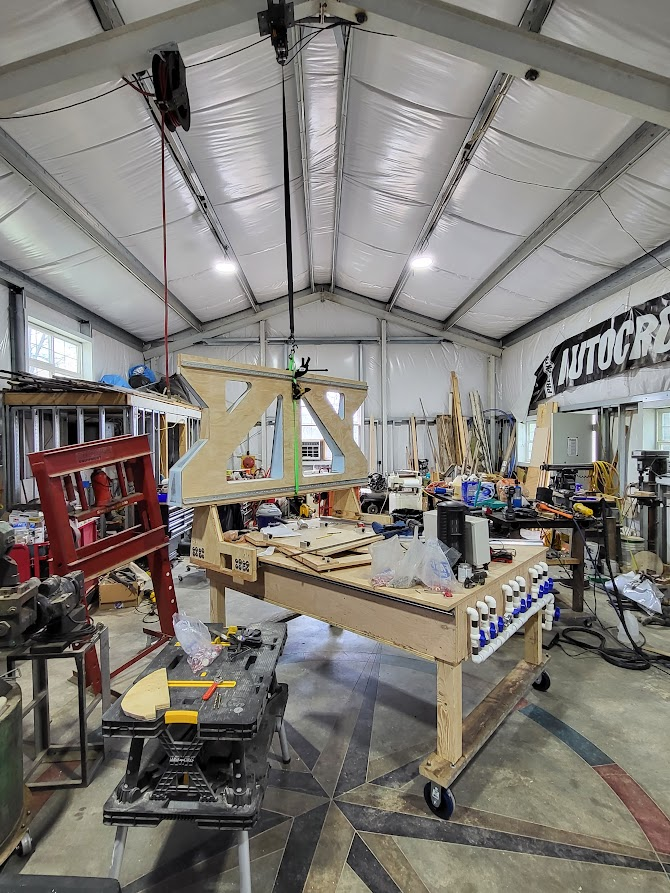

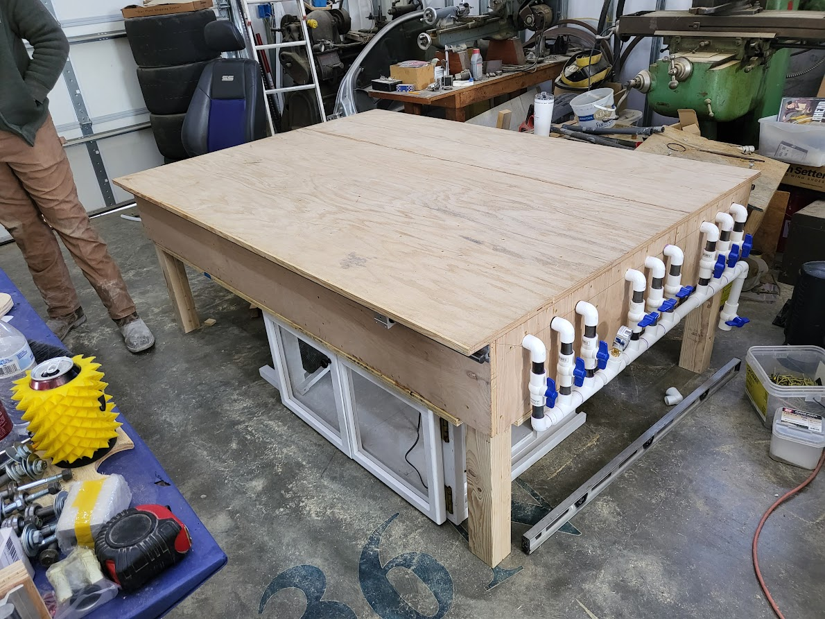

My shop needs to finish the CNC to make room for the engine swap. We replaced the gantry rails and linear bearings after a few failed testing runs with the older light weight rails.
39423

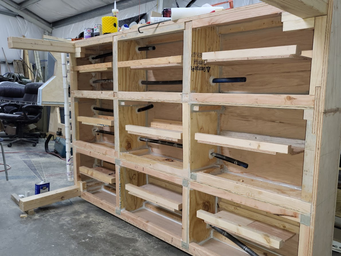

This winter we did get the vacuum chambers built inside the table, and plumbed. The table is divided into 9 vacuum chambers, and each chamber can apply more than 6000lbs clamping force. So we added an extra support in the middle each chamber.
39424

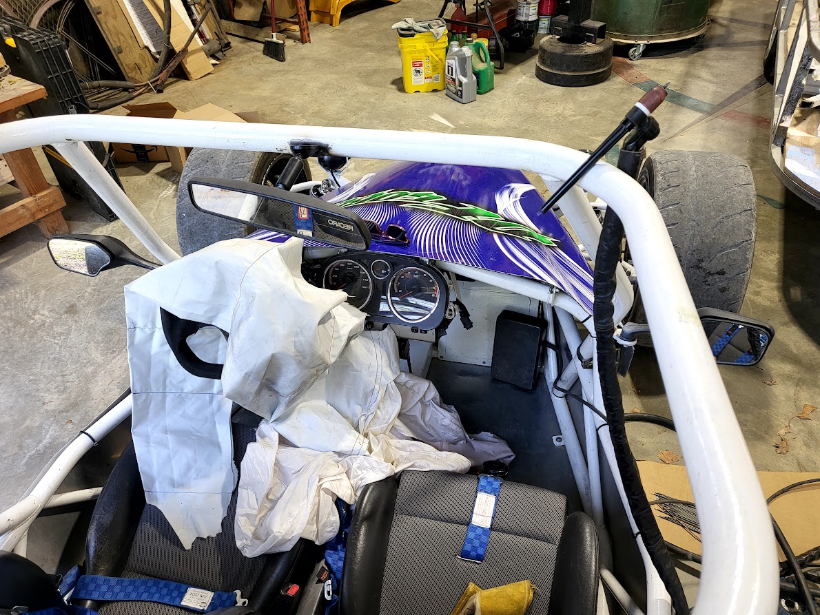

The air bags went off!
40039

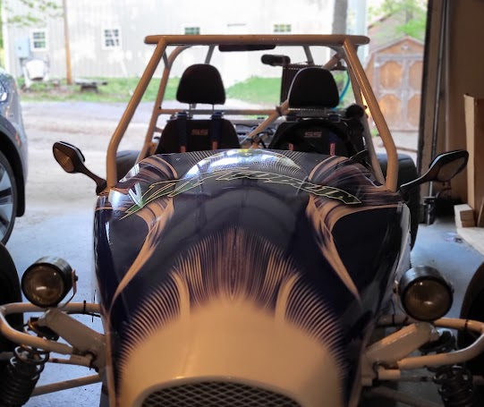

They went off in the donor Cobalt, I just used them as a fire blanket, while I welded on a Cobalt rear view mirror.
Notice the TIG "gas" pedal on the passenger side? My first time welding while sitting in the car.
The rear view mirror is behind the front halo bar... well mostly.
40042
