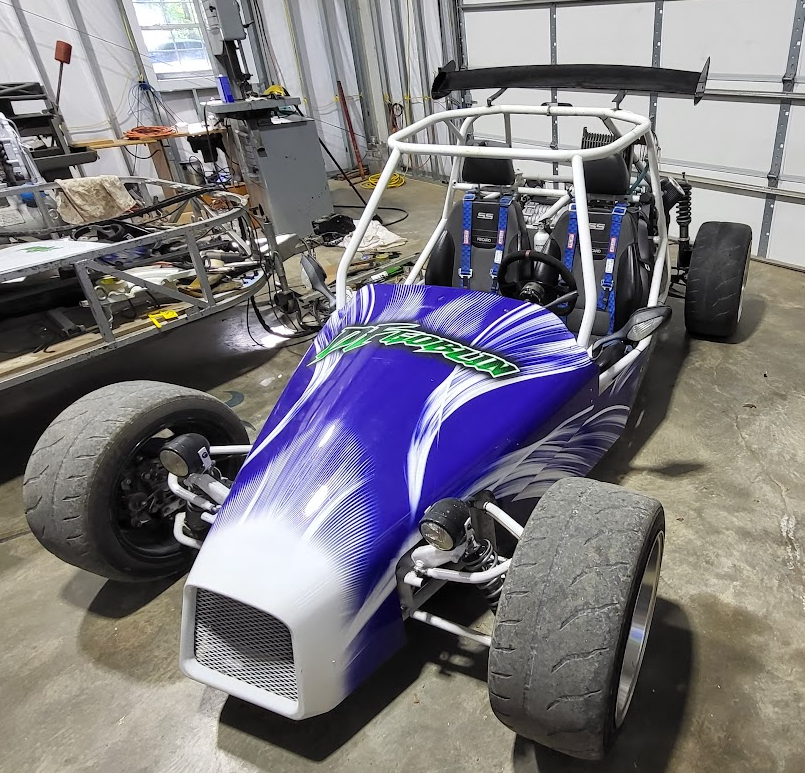

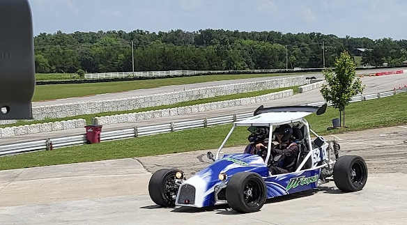

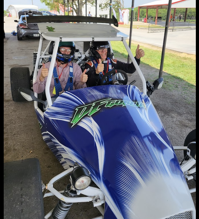

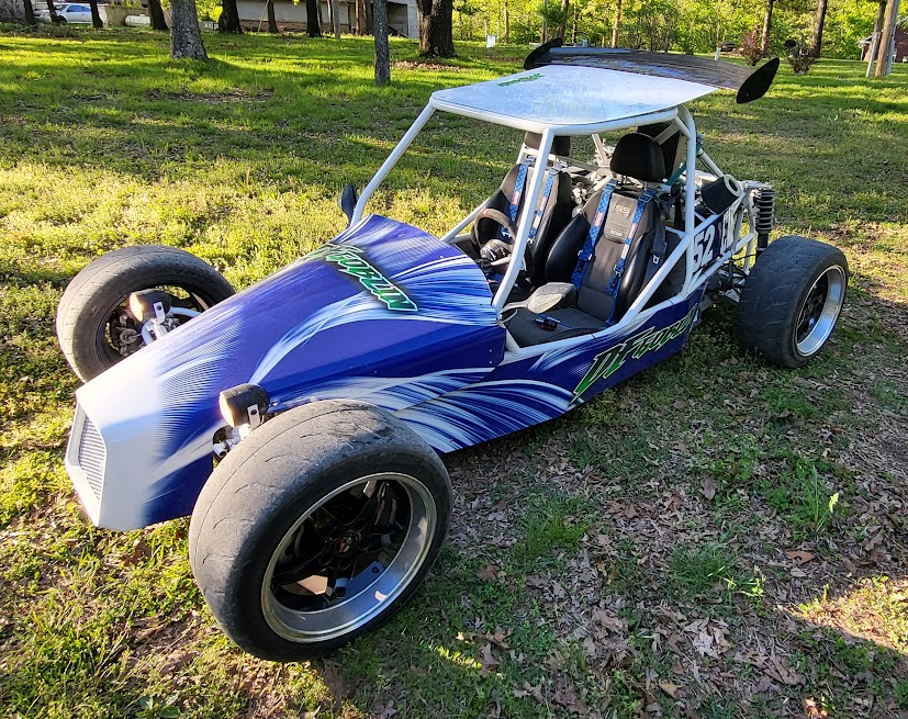

I asked Randy Pobst take my goblin for some fast laps at Hallett Raceway today.
I set up 3 cameras to capture the fun for y'all, but ended up having no usable video
So no nice video like Randy made
here.
He showed me how fast I should be going, and where. Randy has great reflexes, and was able to catch the car drifting quickly... up to 5 times in one corner! Just keeping the car on the edge.
After the session he explained what my car was doing. It is too quick at transferring weight to the front of the car, when getting off the throttle, and that would induce oversteer to the front. So we adjusted the rear shocks to be harder, to slow down the rebound. He also felt the front shocks were too stiff, so we softened them.
Then I went out for a session, and the car was handling much better at the transistion between getting off the gas and cornering. I also carried more speed in certain spots on the track. Managed to get within 4.5 seconds of Randy's time. Then we added a bit more hardness to the rear shocks, and then got my fastest lap on the final session.
My best lap was 1:30.718 which put me 4th of the 14 cars with transponders.
Randy's best lap of 1:28.563 put my goblin in 3rd place overall. Really wish Randy could have drove it after the changes, as it is much improved.

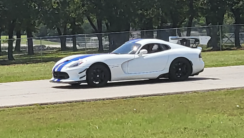

Richard Norris managed a 1:26.244 in his Viper. Nice fast car!
Great day overall, and my first time with the goblin at a big track (1.8 mile lap), was doing 110mph on the main straight, 70mph thru turn 1, 100+ on next straight. Reminds me of the days when I ran my Yamaha R6 at this track.
