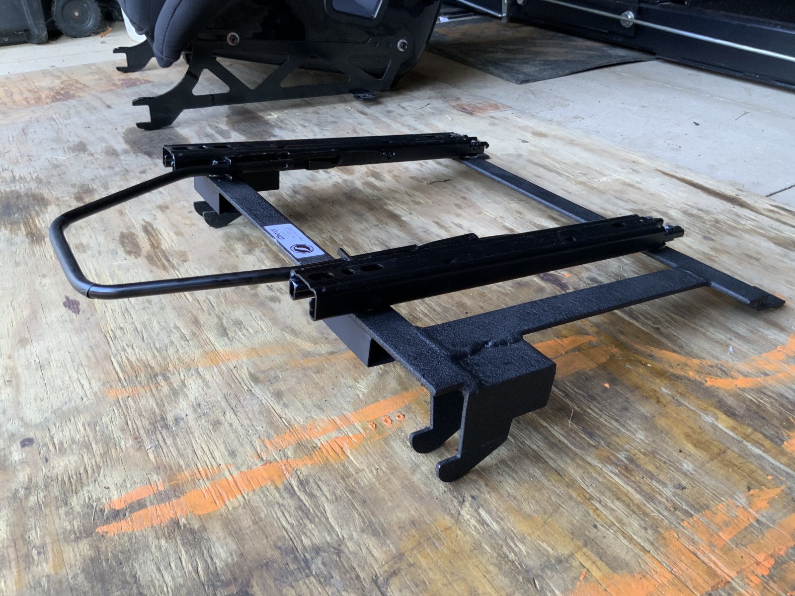

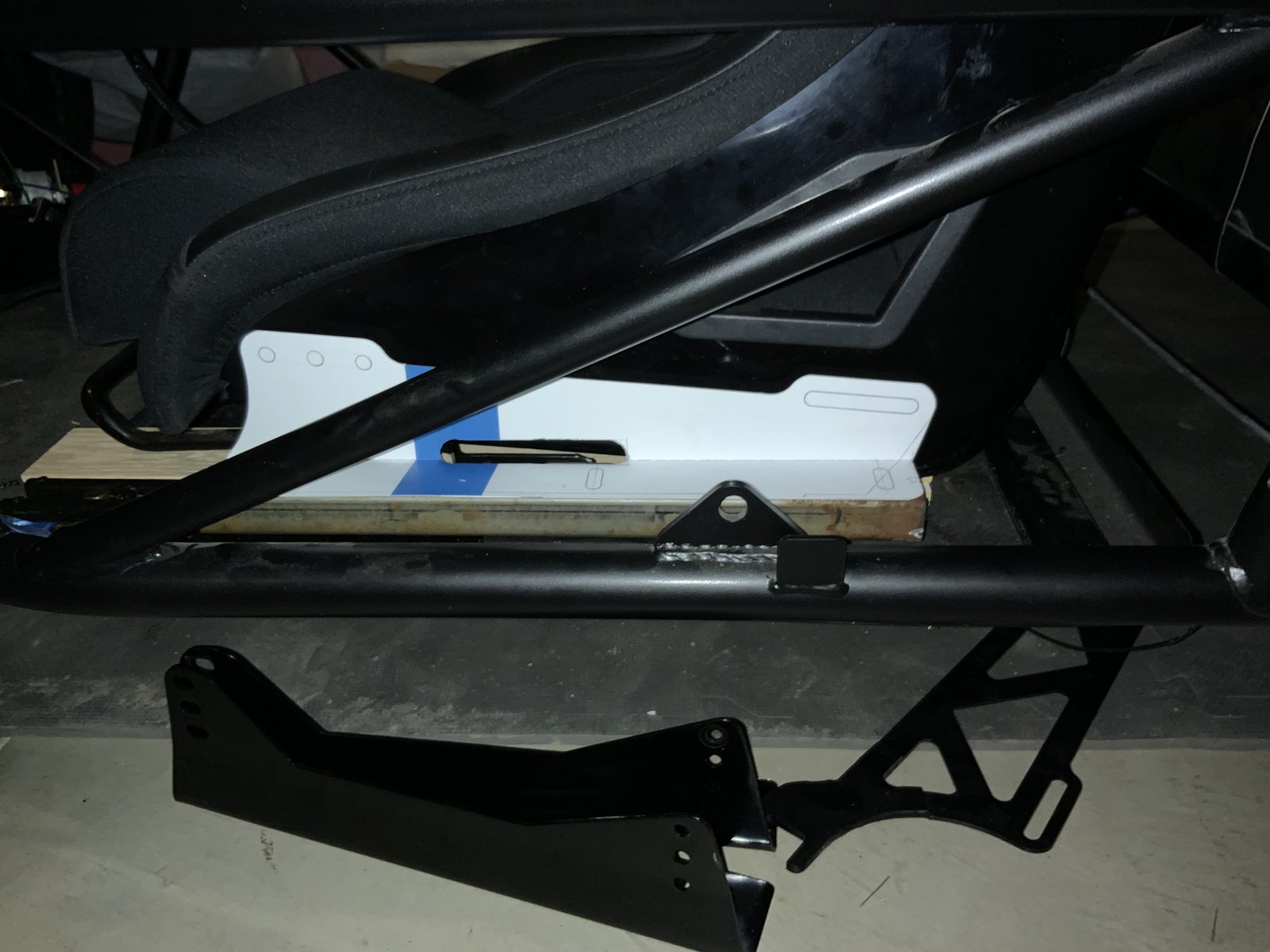

First you also have to add 1” front blocks to it. Okay not a big deal... mount your seat on it and drop it into the car and low and behold it fits like cr@p. Instead of the seat laying back it actually pitches the seat forward leaving about 4” between the back on the seat and the back tube that the seat originally mounted to. While the seat is mounted correctly and does have forward movement there is no way that I can drive this comfortably and I’m only 5-10...

OEM drivers seat track (drilled out the 6 pivots to disconnect it from the factory seat) as per CTUINSTA build log kind of a pain.

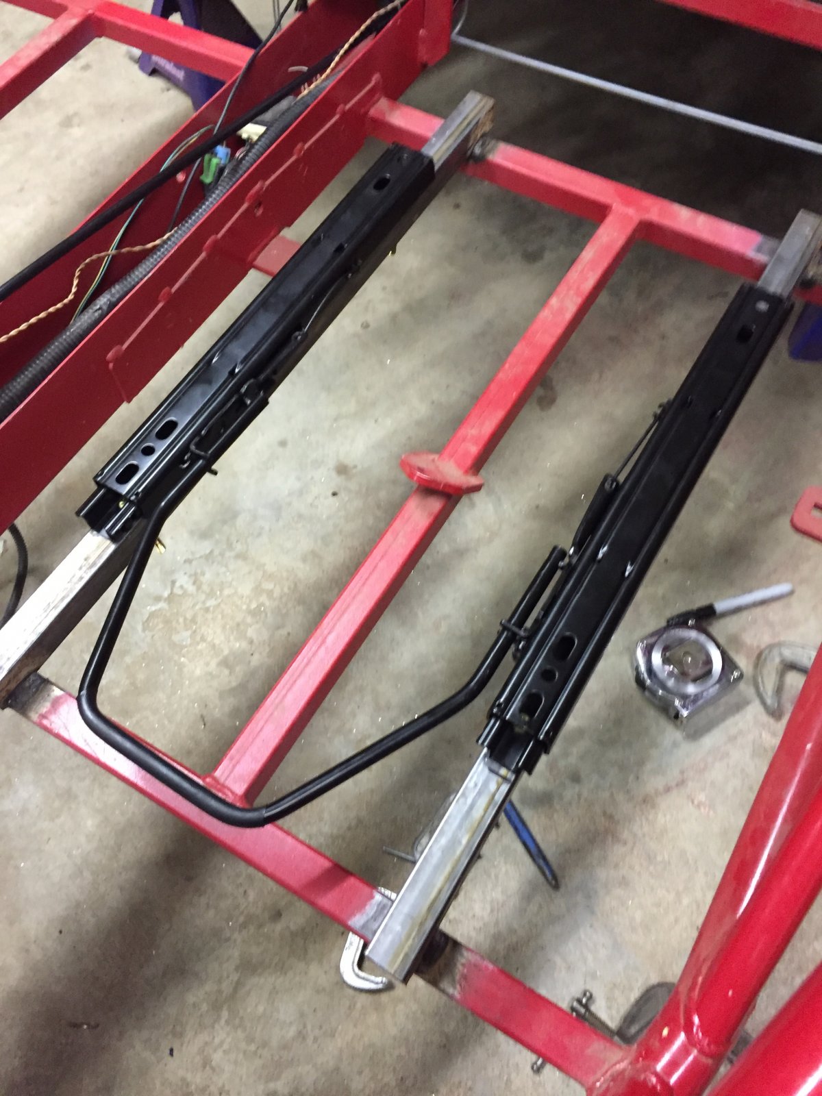

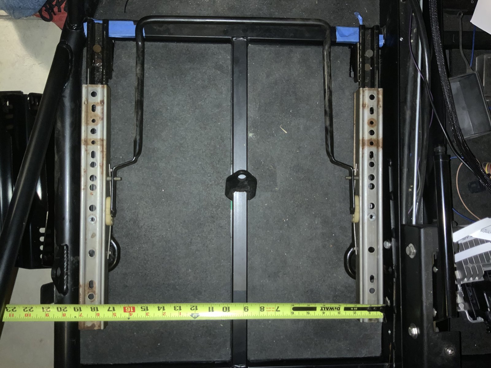

So here is the bare OEM seat track in the Goblin. Good and the Bad... first the OEM seat tracks are a lot better then other aftermarket tracks that I have purchased. They sit much wider then the Corbeau (Cobalt) tracks above this is also a Bad because you can only get about 4” of movement seeing that the outer track interferes with the cars frame in the forward direction. (while you can see they are not aligned straight you can also see at the top right of the picture the interference problem). You will also need to grind about a 1/4” off the bolted sides pad for them to fit into the frame.

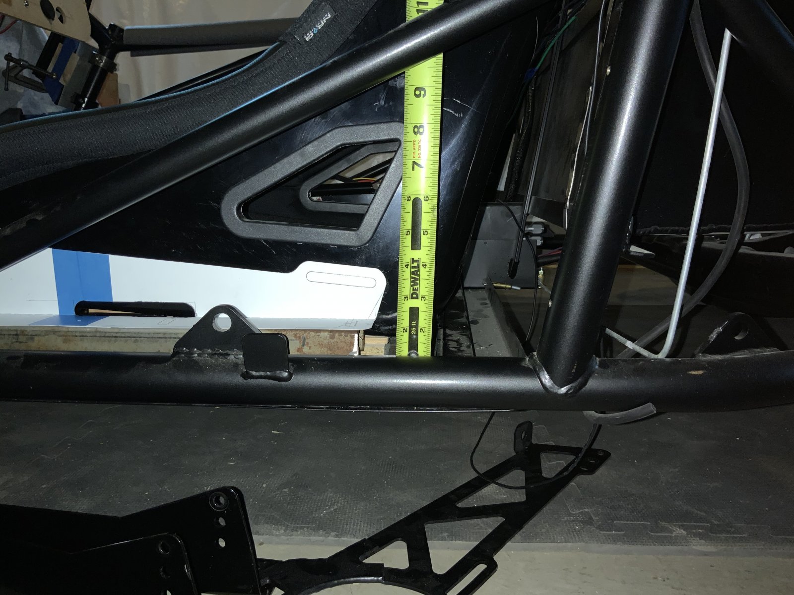

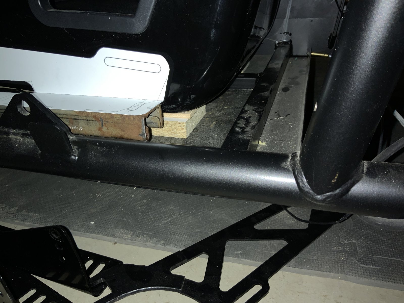

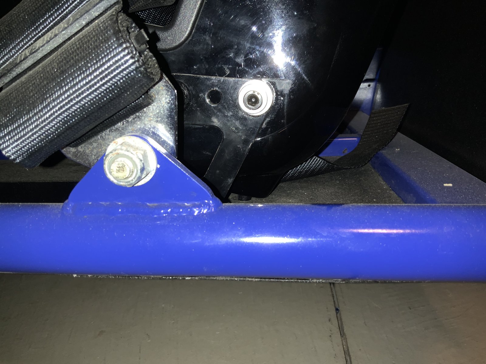

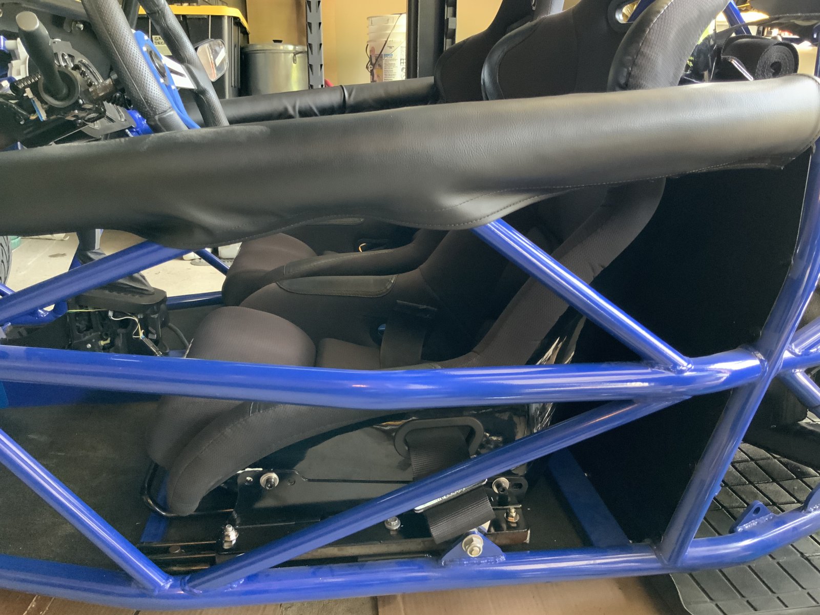

This is a picture of the Corbeau seat in BLUE if you look closely at the bottom of the seat you can make out the aft bottom bolt attachment the rubber on the cars floor is 1/4” thick and the head of that bolt is touching it. So you can see how much you would have to raise that if it was sitting on top of the seat tracks (2 1/2” at a minimum)...

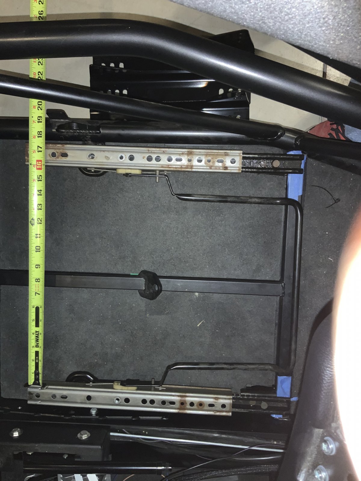

Above just dimensions of the OEM seat tracks in place.

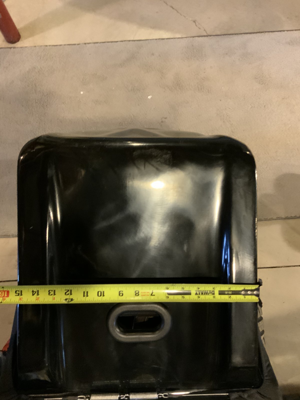

Above just dimensions on the NRG seats from Nathan’s Goblin. His seats are slightly narrower then the Corbeau seats in my car (15 1/4” on the NRG’s and 16” on the Corbeau’s....)

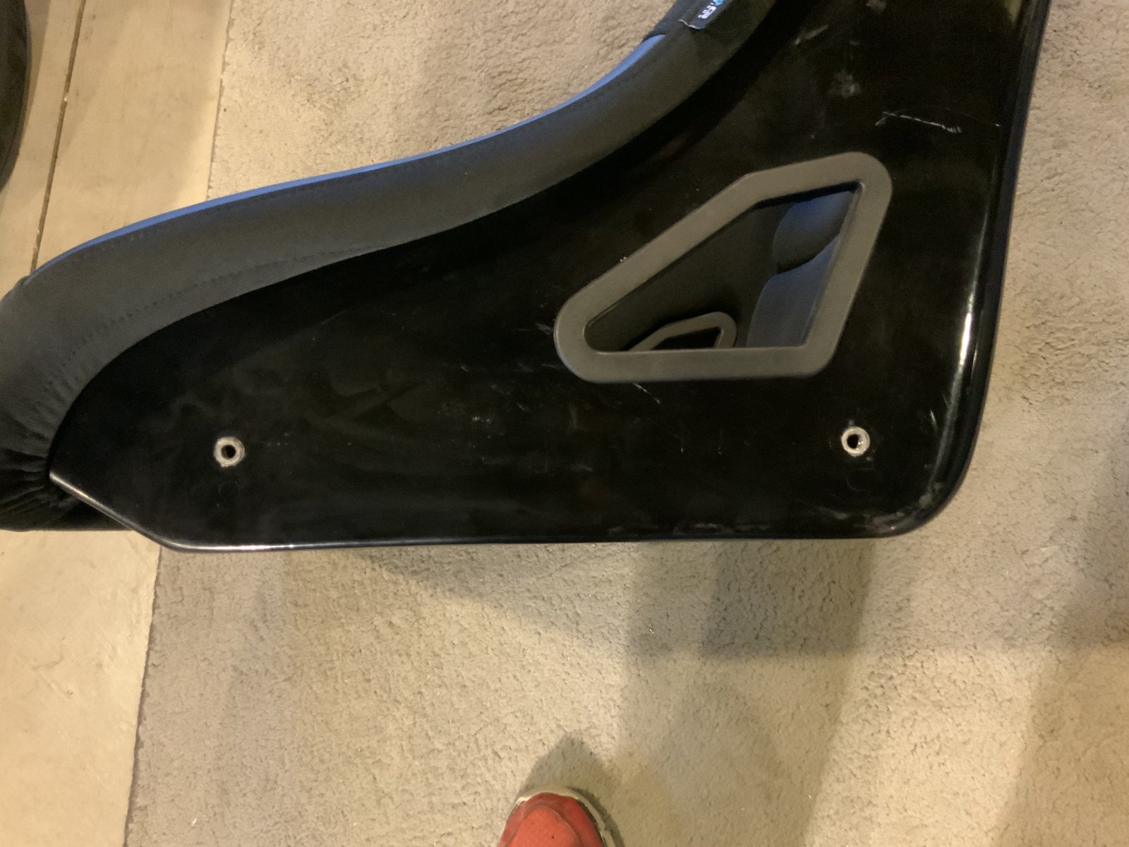

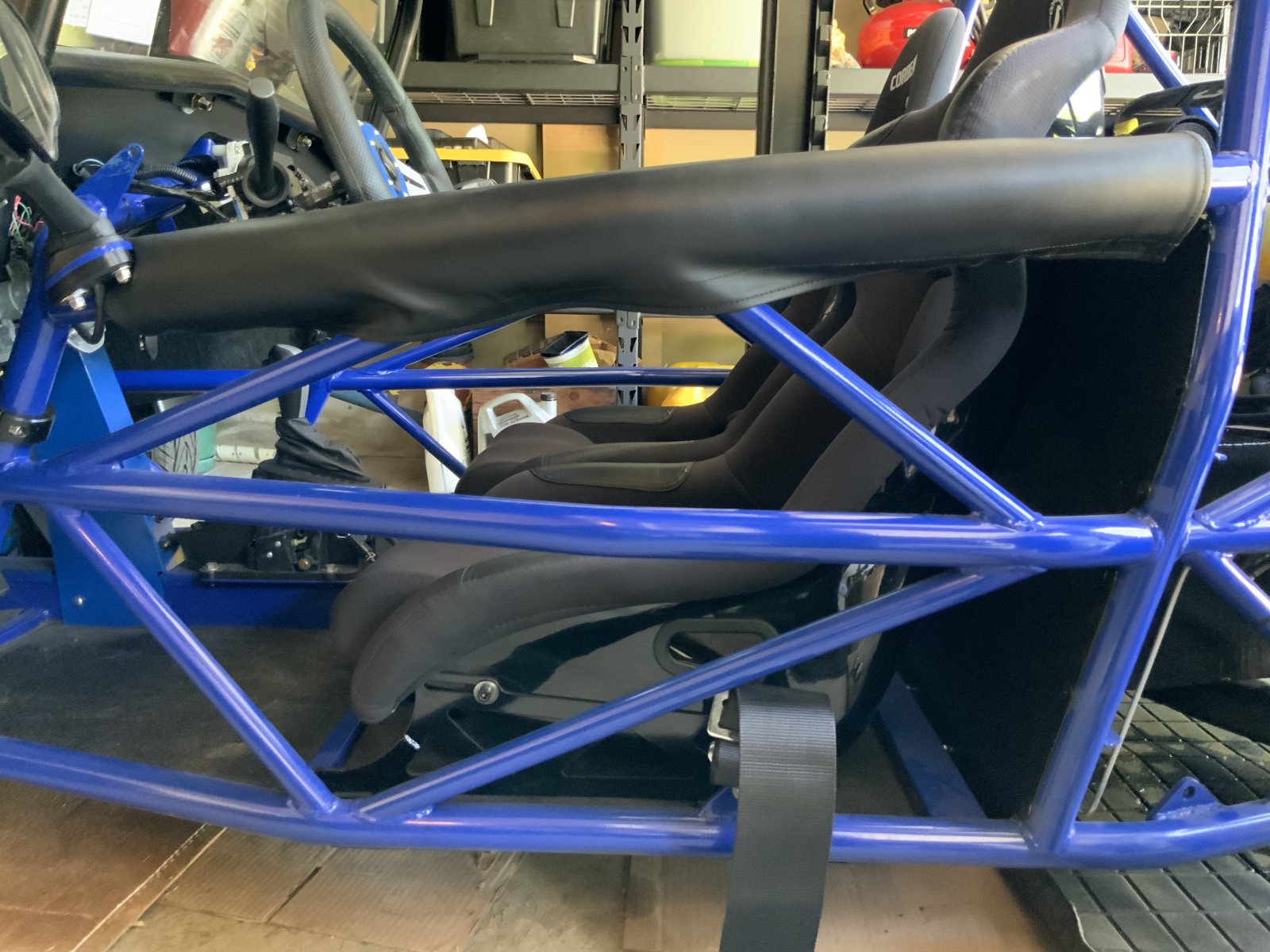

So this is the basic seat position that I’m looking for both of the seats that we are using are narrow enough for the aft portion of the seat to extend between and below the seat tracks. Going to use the side mount seat attachments (seeing that the NRG’s don’t have bottom attachment points).

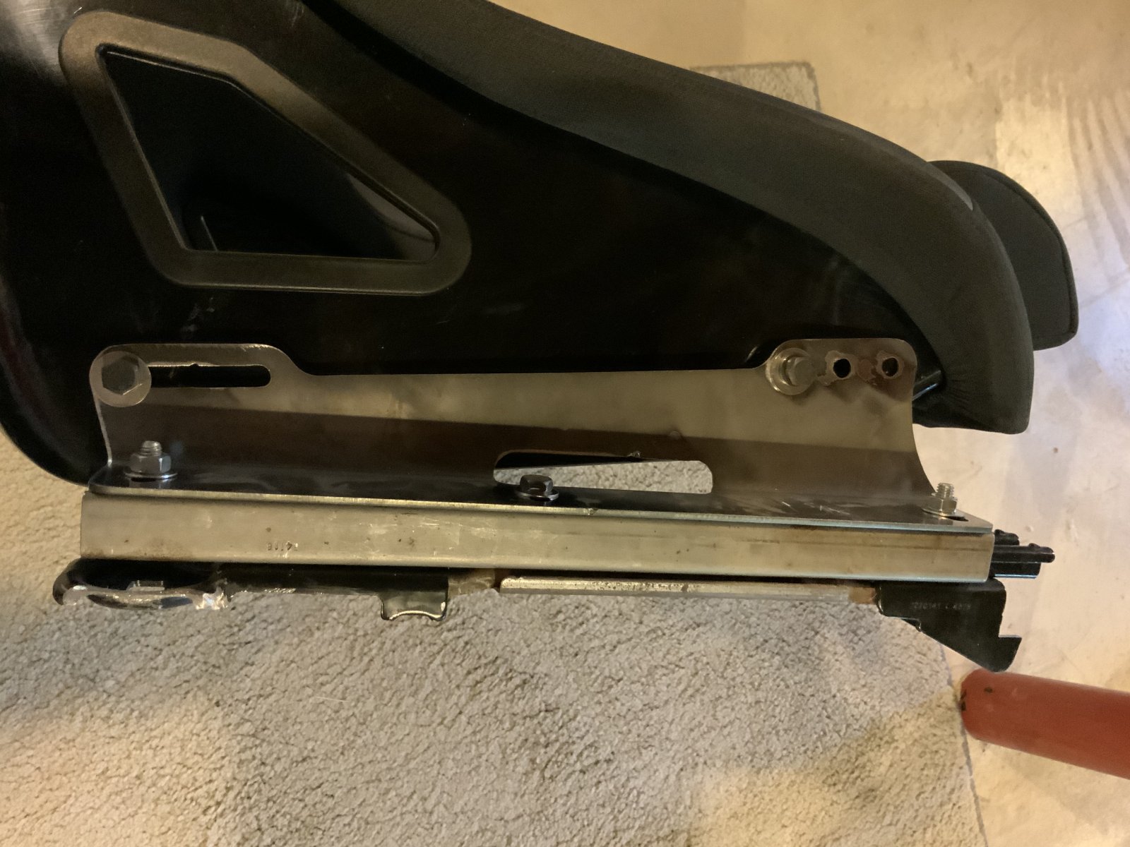

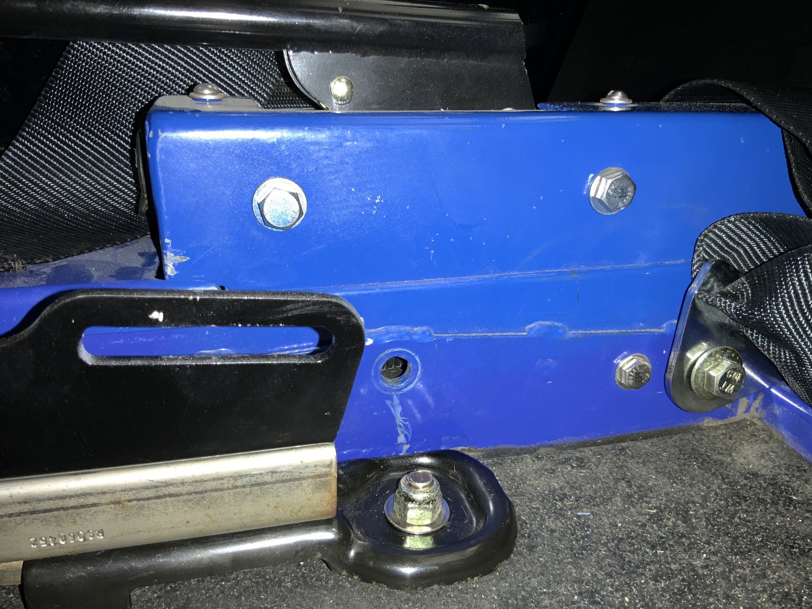

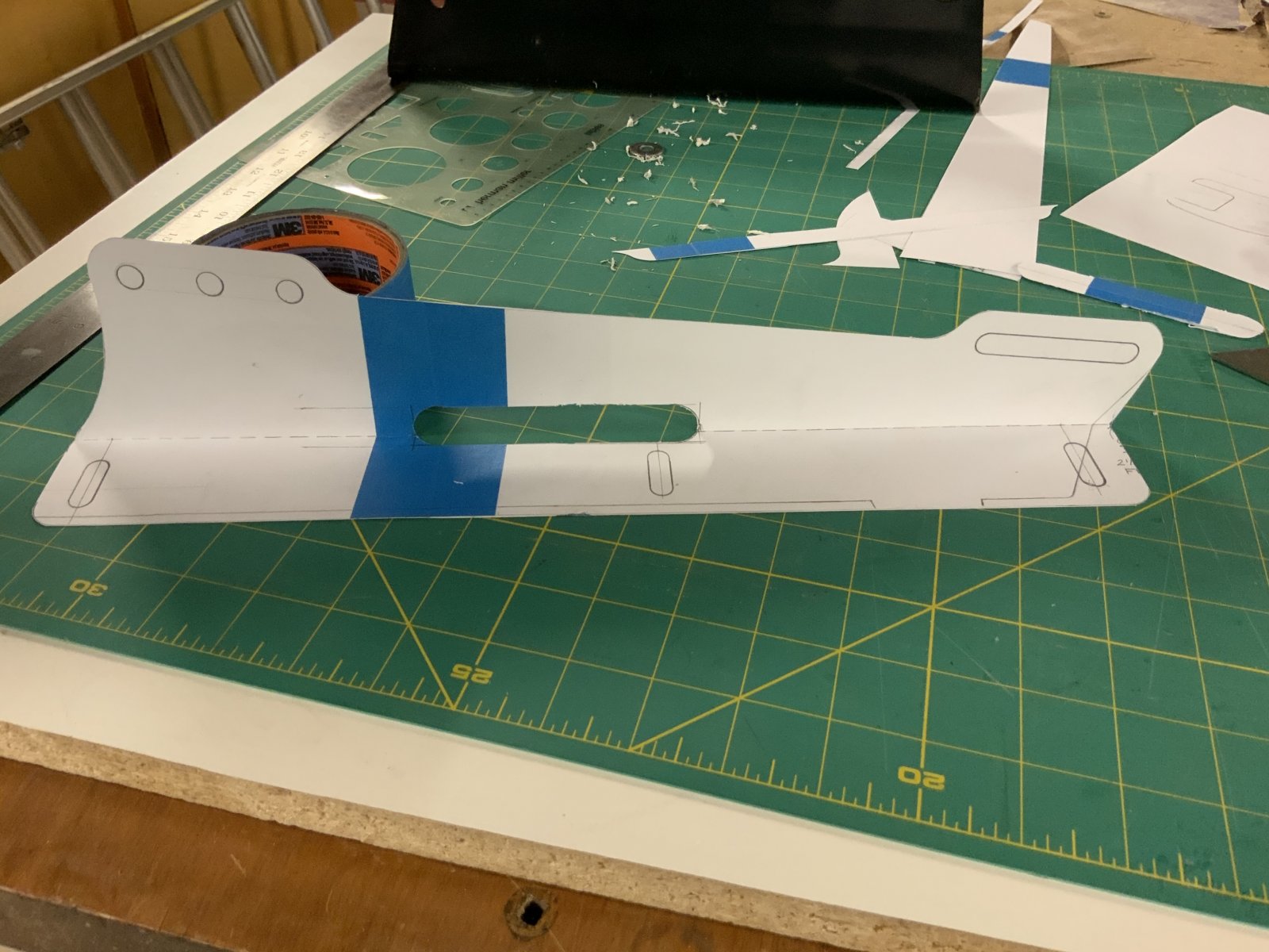

Paper board mark up just a combination of the DFKITCAR’s solid mounts and a set of universal mounts that will bolt up to the OEM seat track. SIDE NOTE; you will see that the holes and the slot is reversed for the seat attachment from experience if you have the emergency brake handle removing that bolt and reattaching is a pain (with the slot you just have to loosen).

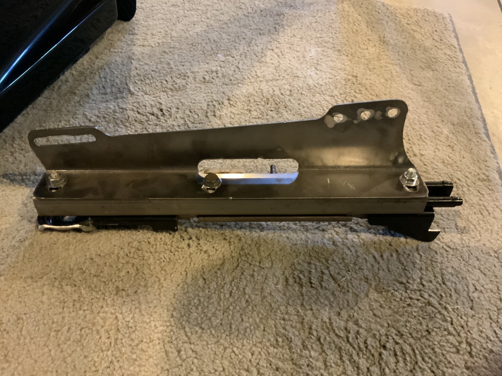

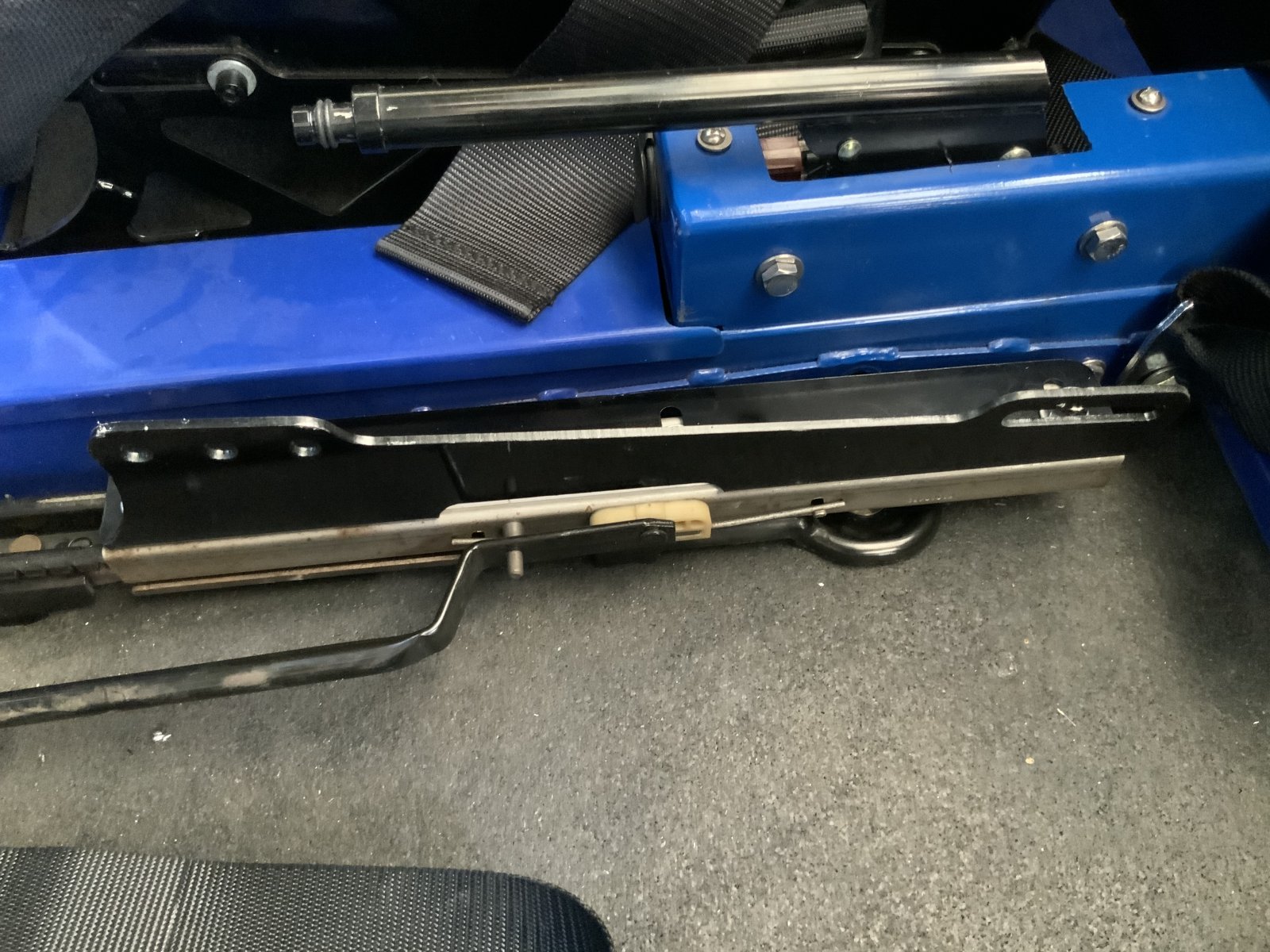

Seat on the OEM seat track and the paper version of the new attachment (the orientation of the seat is the same as the seat placement with the DFKITCAR’s solid mount)... seat will slide 4” forward and have an additional 2” of forward movement by the holes and slot on the bracket itself...

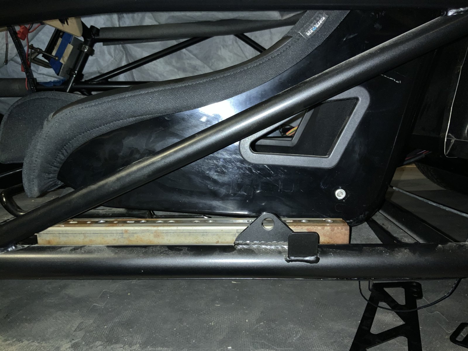

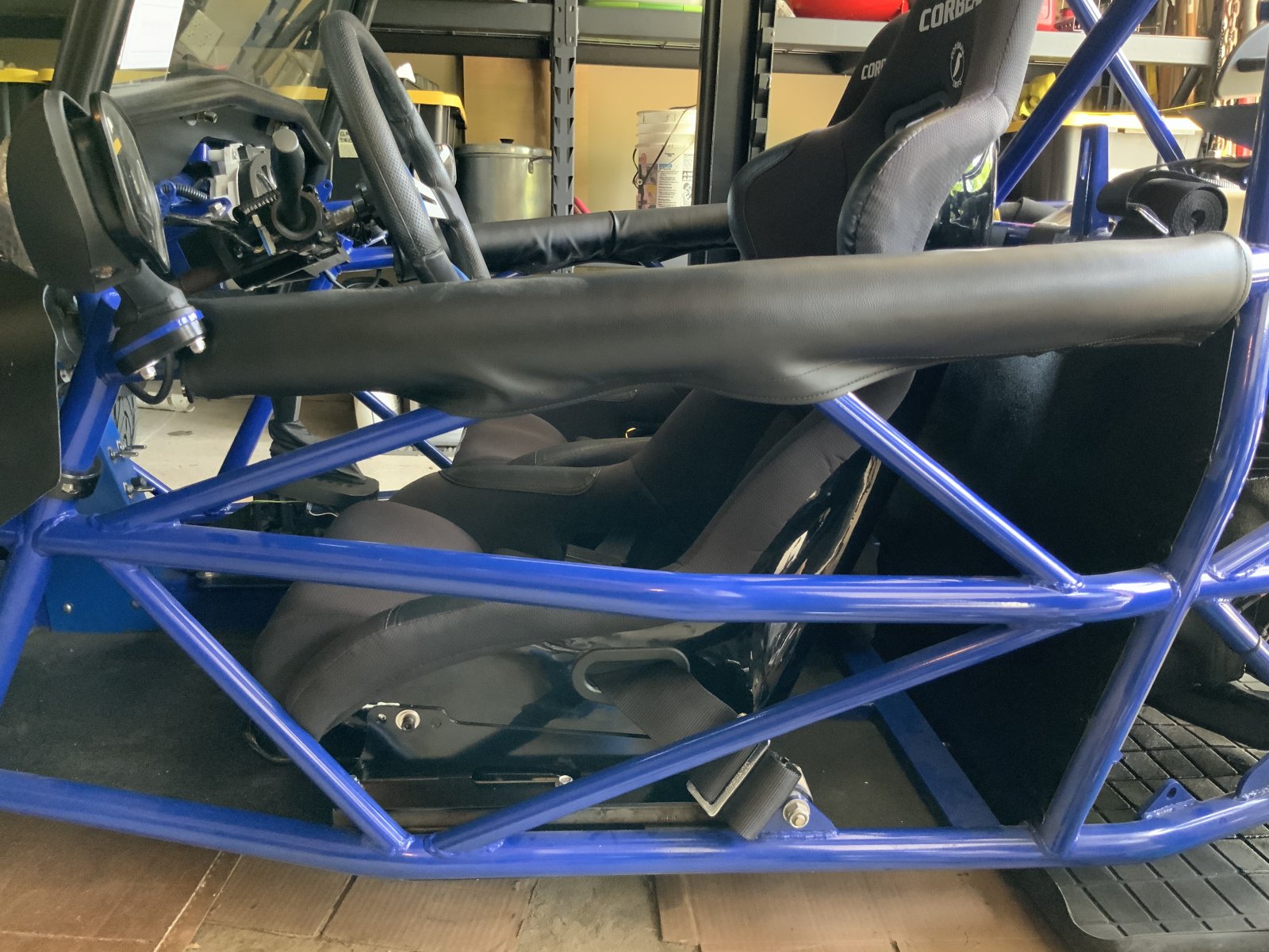

While Nathan’s NRG seats don’t have the bosses for the bottom attachment points you can see that his seat still sits pretty low in the car. The Corbeau seats sit about another 1/2” lower (just due to the bosses).
