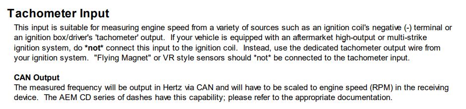

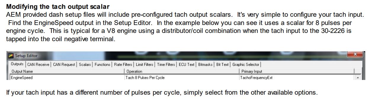

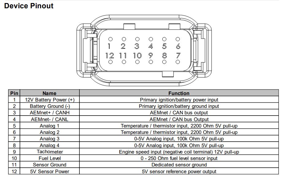

Hi all in the process of planning and preparing to run an AEM CD digital display on my Goblin using their Can Bus Module and aftermarket sensors. I would like to use this to replace the current cluster. It has GPS Speedo but need a signal for the Tachometer / RPM reading. Anyone used and aftermarket tachometer? If so wondering what wire you used to get the signal. TIA
