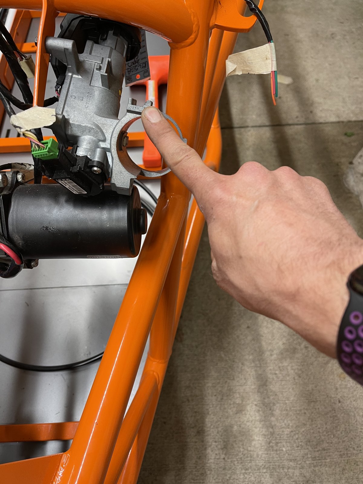

Can I cut this piece off the ignition switch? I don’t see what will mount inside it.

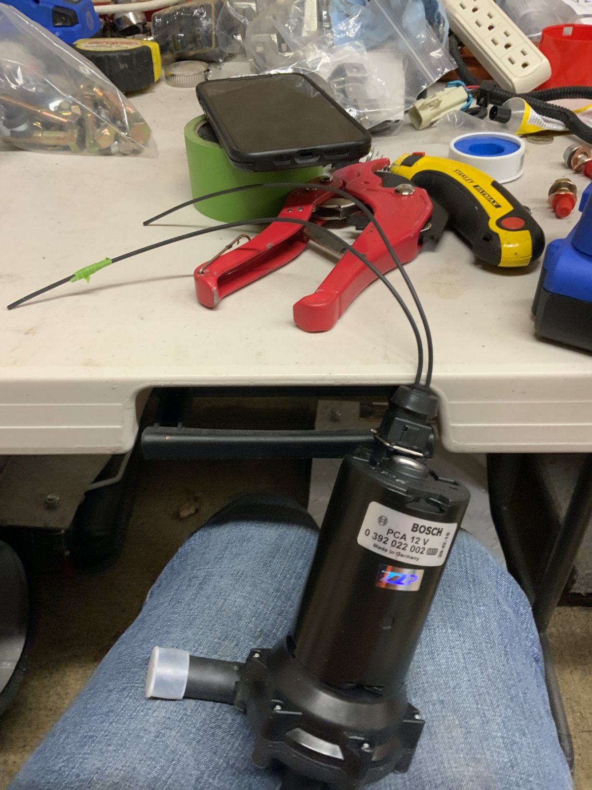

SmsDetroit
Well since I have mr electrical here. How do I tell which side is power and which is ground on the intercooler pump? The wire with the green tape has a 1 at the connector

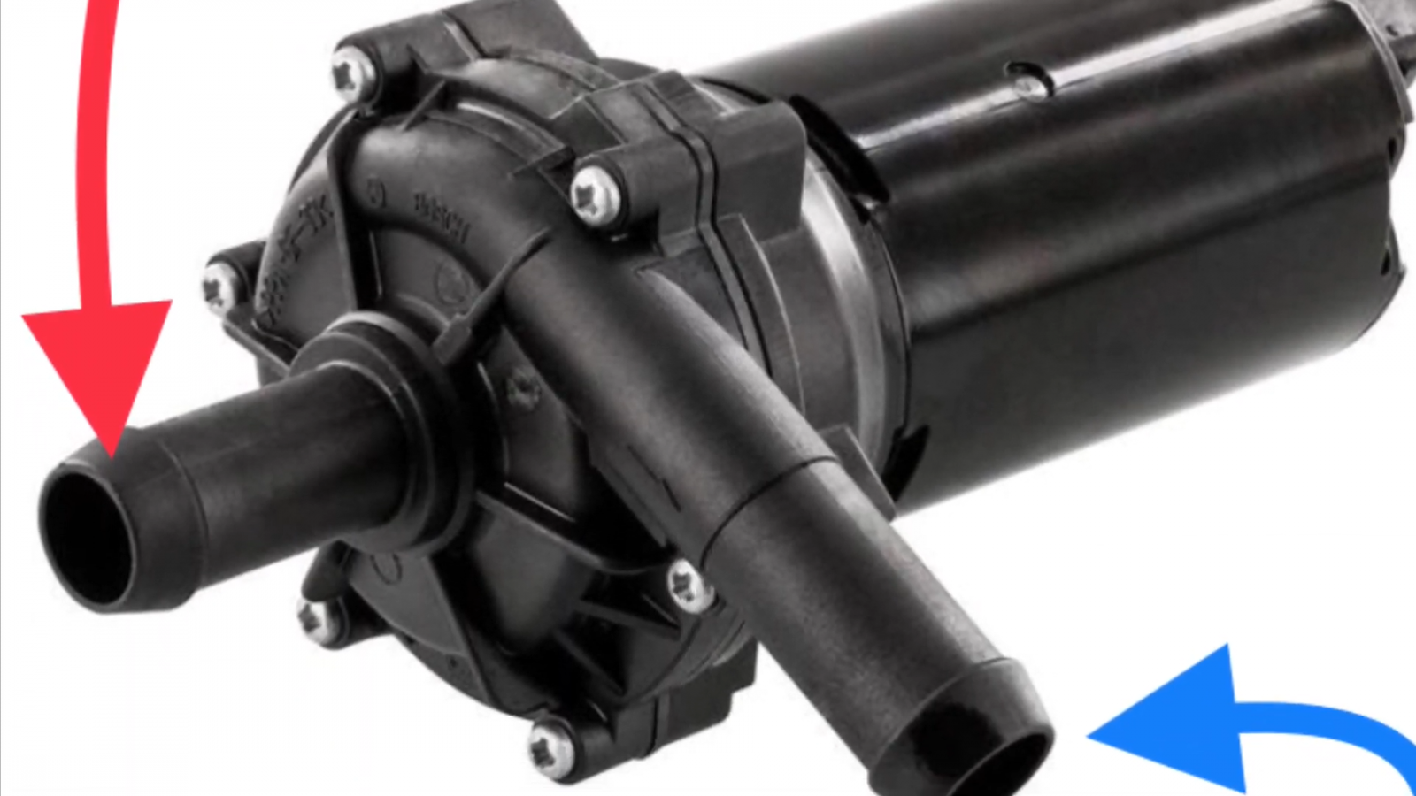

Test it on the battery. it will spin backwards if the polarity is reversed.
And you can tell if it is spinning the correct way by the direction it will pump water.
Water should go in the red arrow, and out the blue arrow. Spinning clockwise in this view.
22197
I think the Bosch pump has a small + and - beside the connectors.

Don’t know if this helps, but the connector for the pump I received from DF has a red wire on the right side and black on the left (from the viewpoint of your picture) So I wired ground to the black (left) wire.

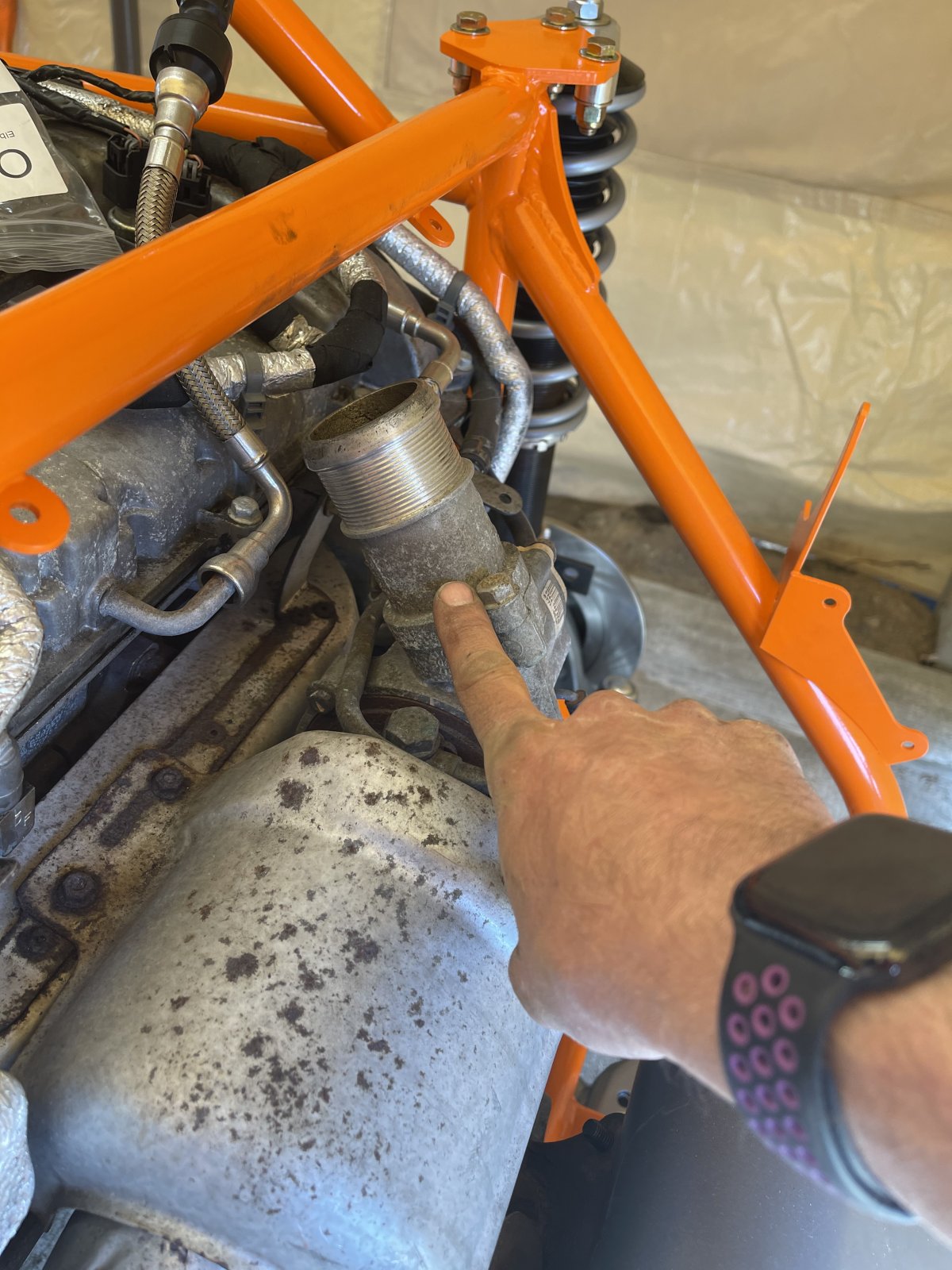

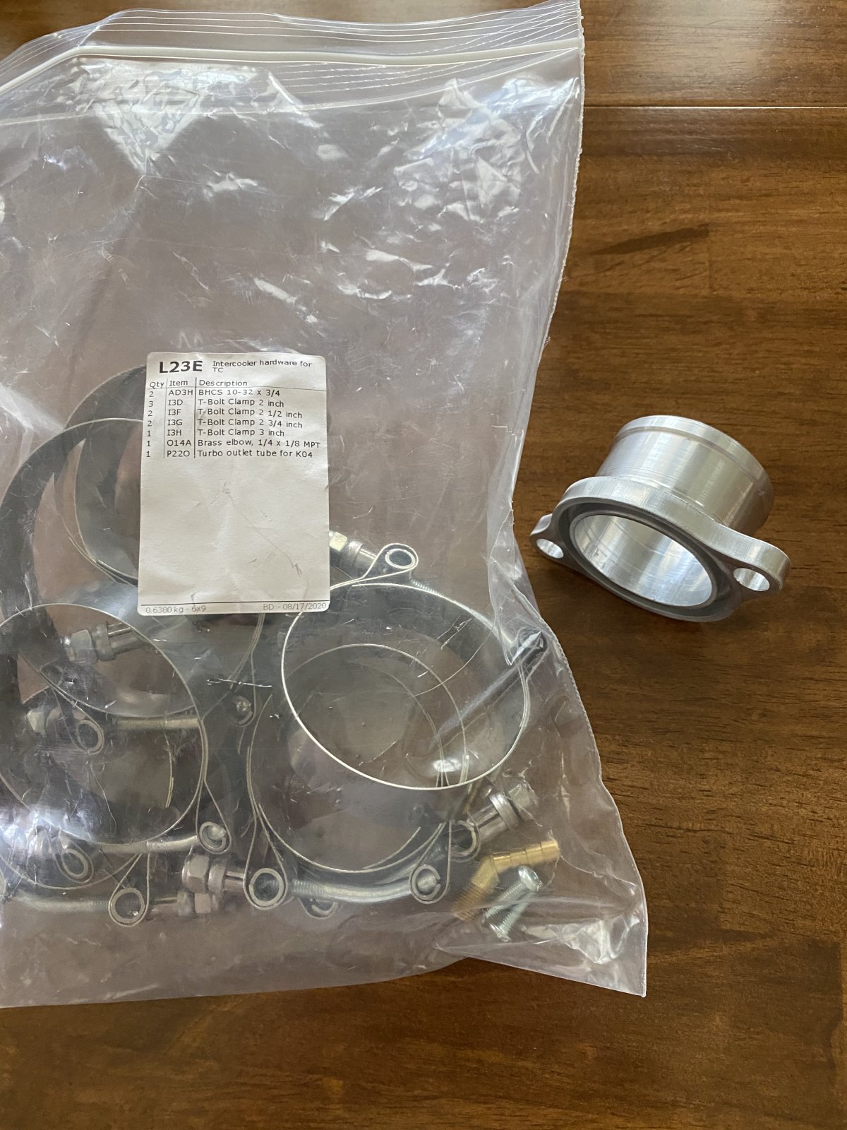

I could have sworn Lonny said the pipe on top of the turbo gets replaced for clearance but I can not find it anywhere. I gone though everything. Am I just imagining it.
It definitely gets replaced, and a new one should have been included in your kit. If you didn't receive it, send an email to [email protected] and they'll get you fixed up. Remember to retain the gasket out of the stock one and transfer it to the DF one, once you receive it.
