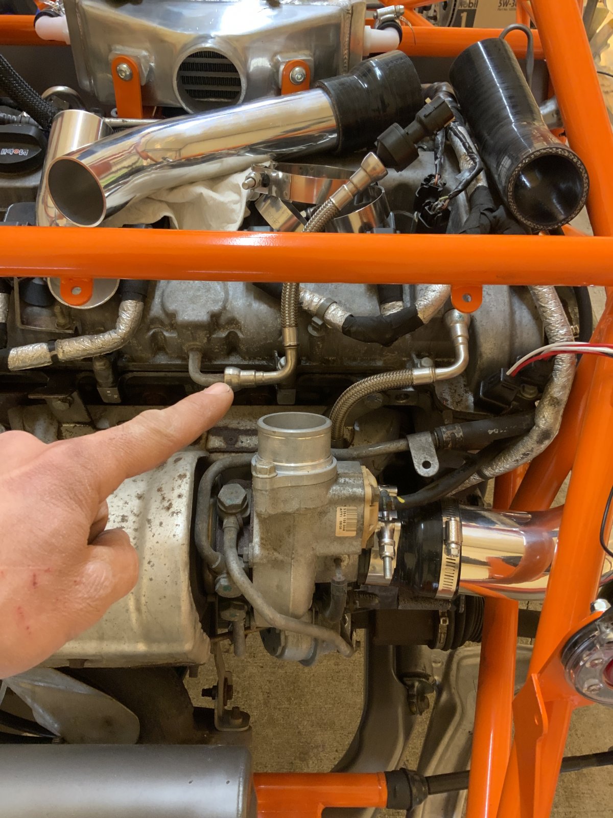

Where does this attach?

The vacuum system is not as simple as some other engines - especially since you have a turbo.
I suggest you read this thread which covers a little more than your question asked, but will enlighten you nonetheless.

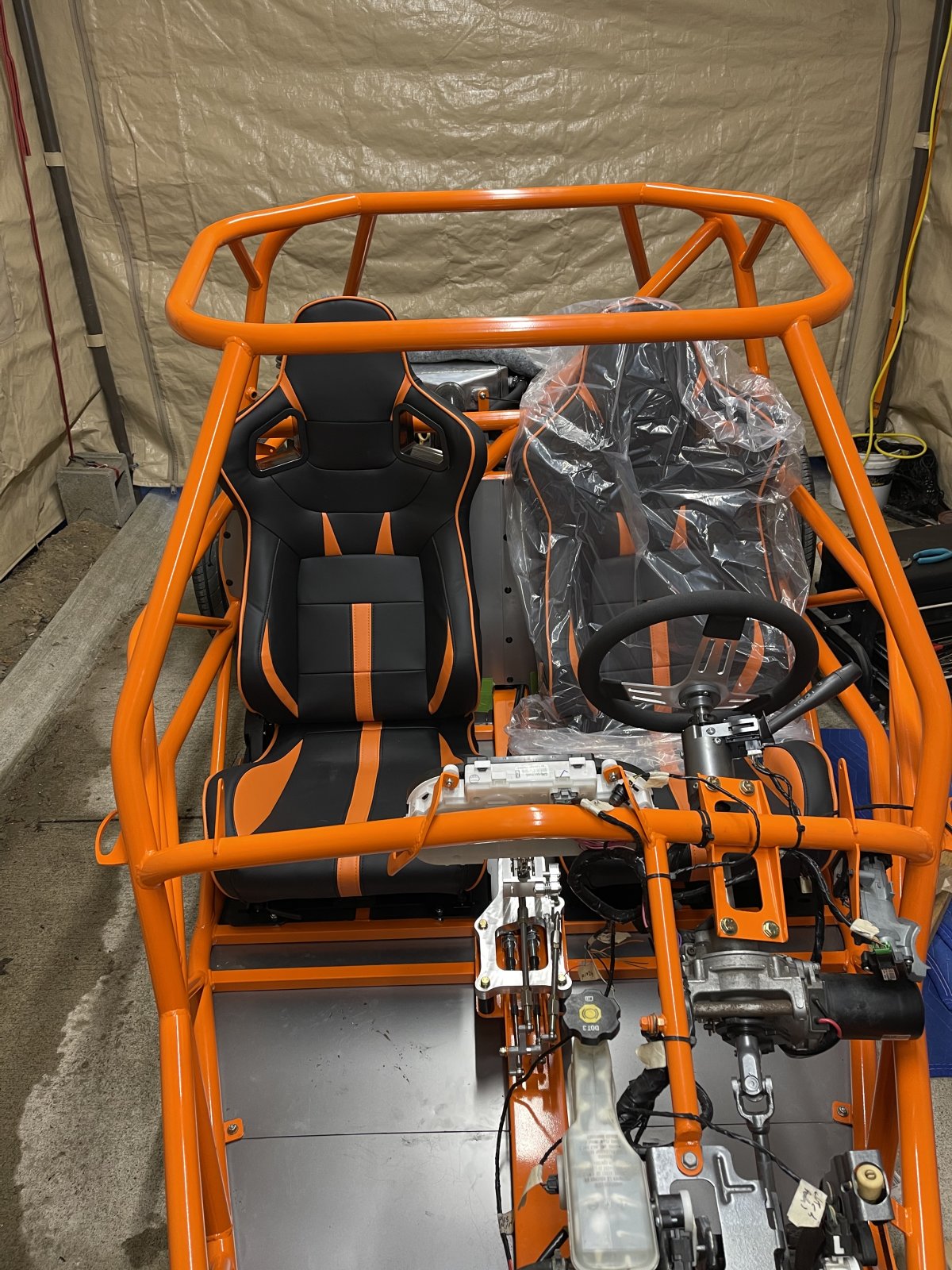

No seat but 2 shipping blankets worked to take her out on her maiden voyage. Still have to wire the brake lights and figure out why the passenger low beam is so dim. I know that usually means a bad ground but the high beam is fine.

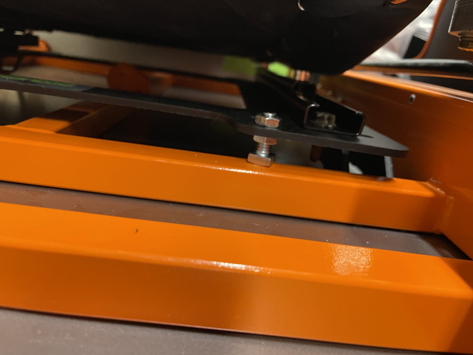

Got my seats today. The passenger (of course) went together flawlessly. The driver when a bolt was about 3/4 of the way in it stopped and snapped. It was not cross threaded I was being super careful. I think I had a faulty bolt. Then when trying to drill it out to retap it the bit snapped. Not I’m at a loss.
On a side not I ordered planted tech seat brackets. Came up with a clever design. Instead of putting flat stock in to take up the 1/2” gap I drilled and taped 2 holes then ran a bolt from the bottom up to apply tension.

Man those look sweet!

I think that’s the best looking seats that I have seen ! Top notch :)
