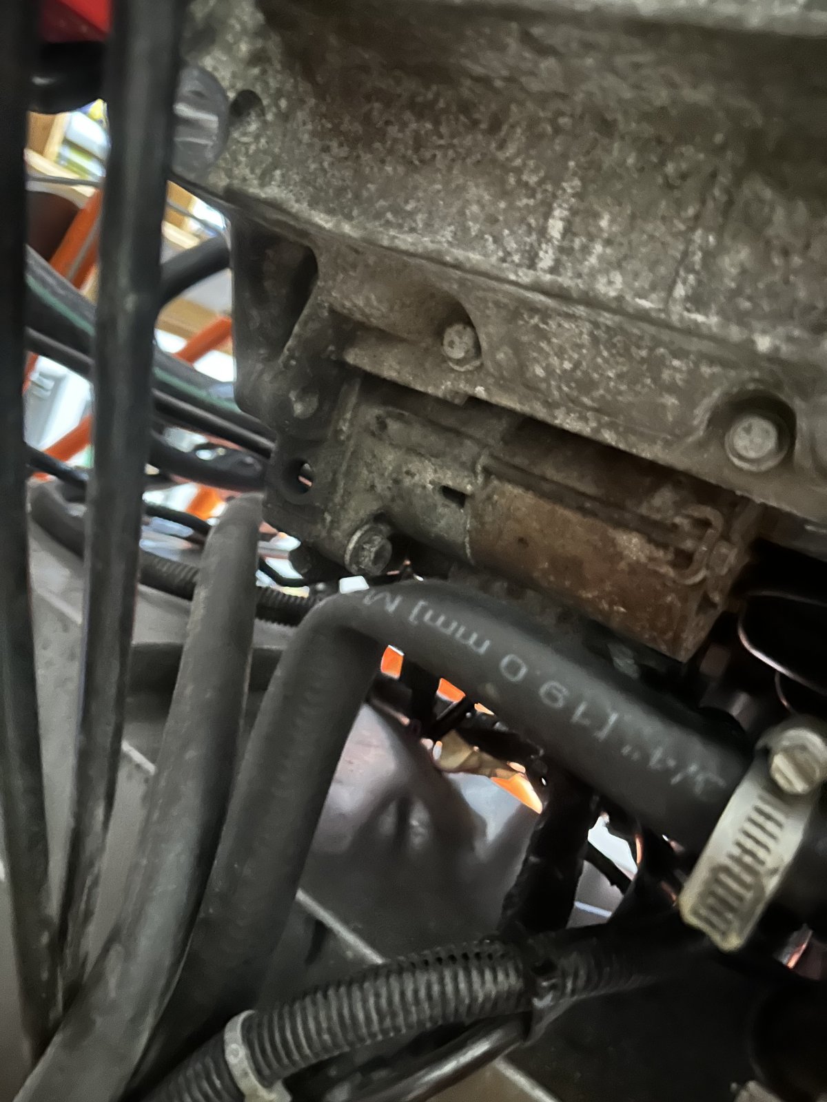

SmsDetroit
I could be wrong but I think this might restrict the flow on my inner cooler. Lol
Sluggonaut
Mine had a similar kink and I replaced it with a hose from the local parts store. I took my hose in and asked to look at their hoses in the back and I found one shaped similar to mine. I should have saved the hose part # but didn't unfortunately.
