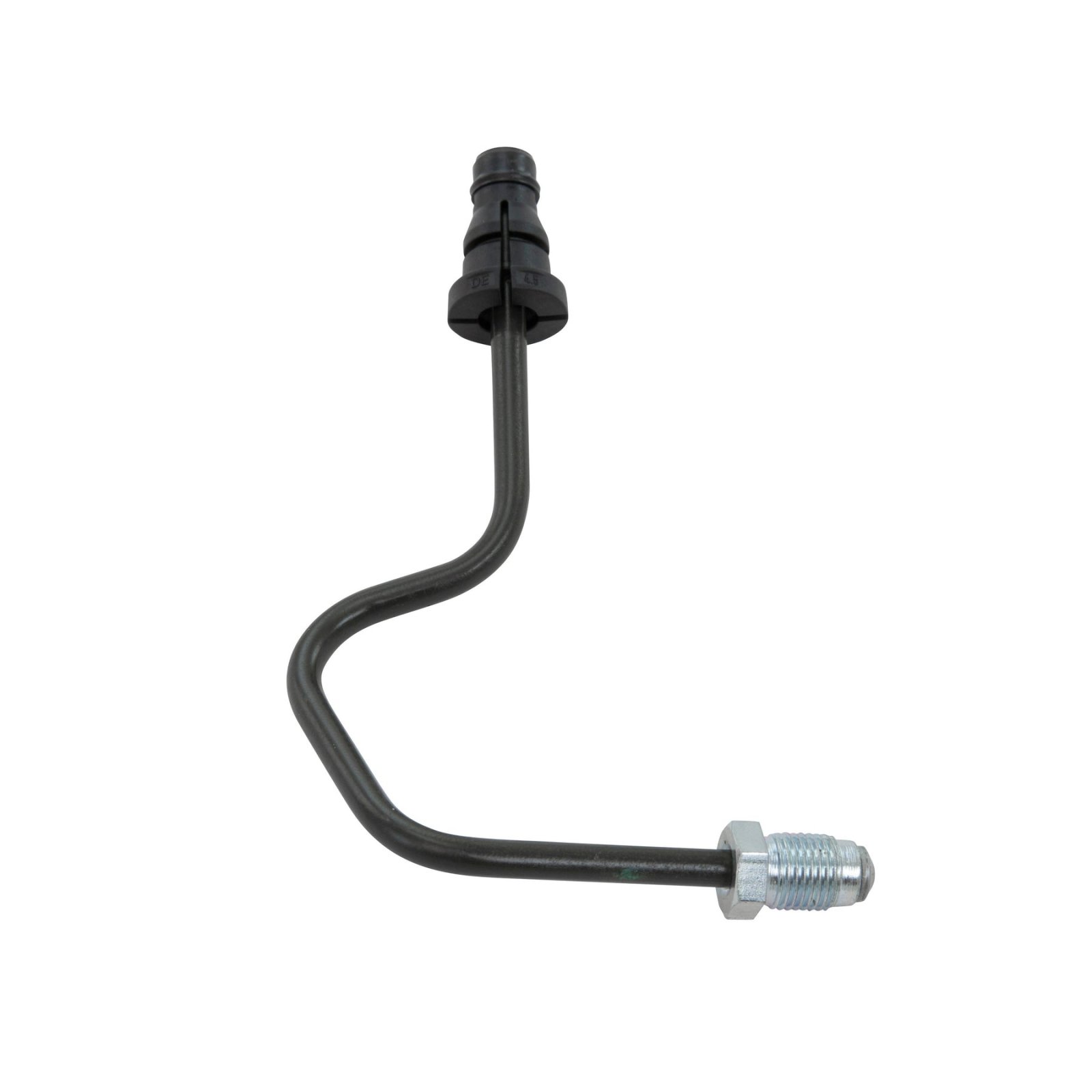

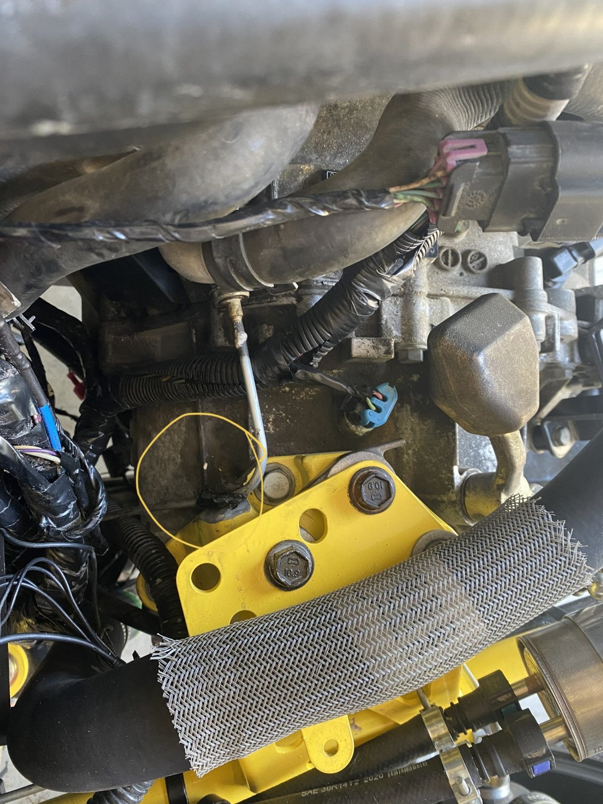

Okay so I installed a new disruption block and purchased the clutch pipe because that’s the only way to get the seal. I tried to just swap the seal to the pipe on the car so I didn’t have to pull the trans again. I still have a bit of a leak and am at a bit of a loss now. Any suggestions would be helpful
Not sure what a disruption block is. I think you are talking about what Chevy calls the distribution block.
Maybe the pipe is not aligned well and pulling it over too one side?
Maybe a scratch is causing it to leak?
It is sooooo hard to get to that pipe, it might be easier to lower the subframe and engine 4", to give you some room.
One thing I had a problem with, but I don’t think anyone else has, is the clutch line was hitting the motor mount and kind of **** the lime and that elbow. that misalignment would cause a leak. I ended up grinding down the mount a little so everything was relaxed and it spcould seal properly.
39552
Be warned on the F35 the clutch slave line has a seal on the end that can sit on the end of the line or clip over the line. Can be assembled either way bit will only seal one way. The seal is the black one on the top.
