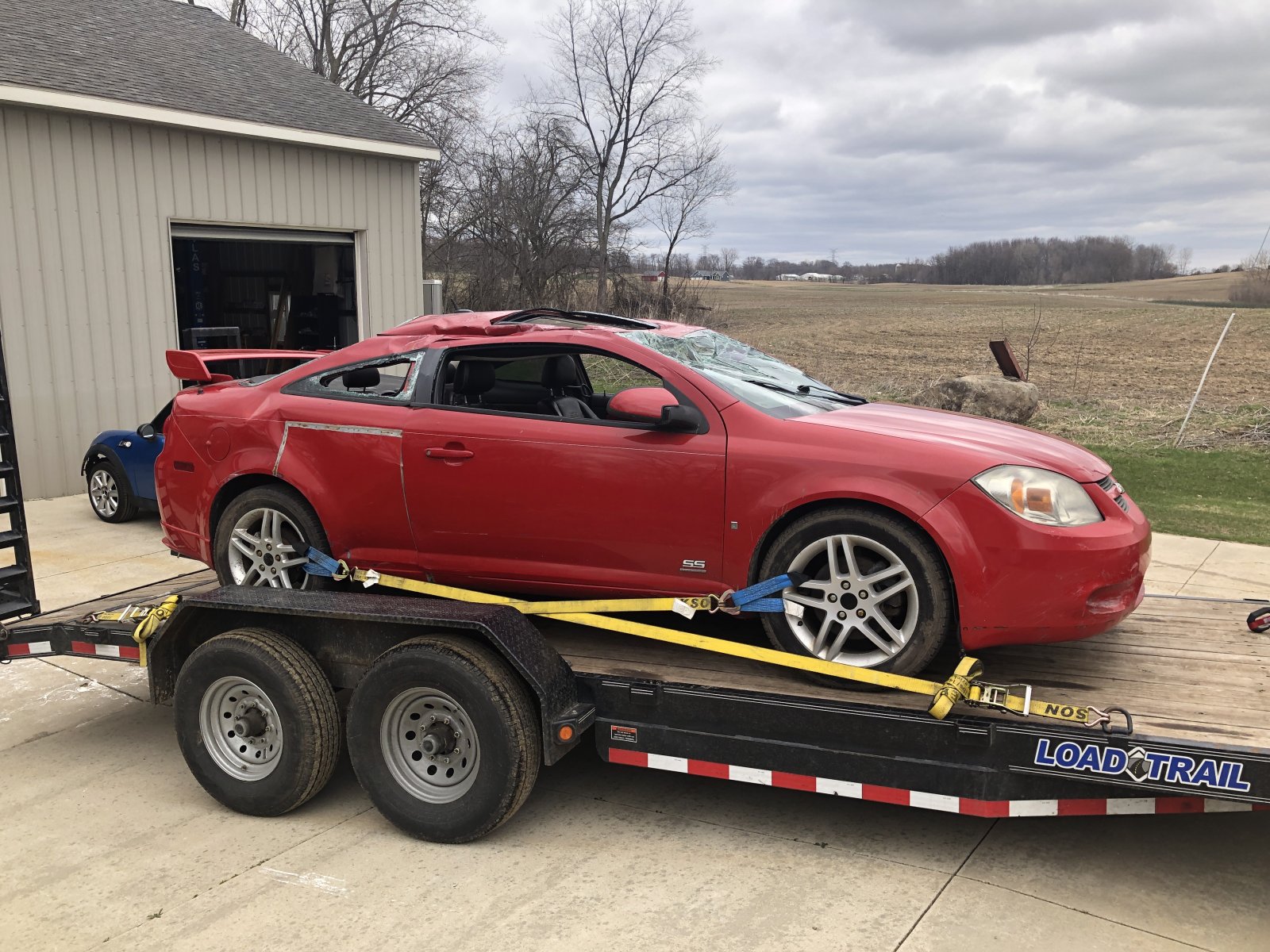

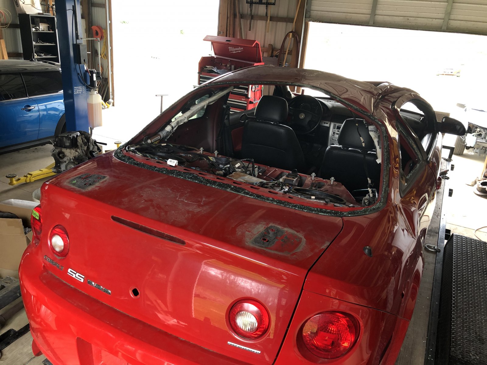

Hello fellow Goblin-ers. I don’t have my frame yet, but I’ve been hanging around the forum for about a year now, so I kind of feel like part of the family already. After what seemed like an eternity searching for a donor (part of the problem is not being sure what donor would be best – Std/SS/SC/TC/manual/auto) my son found me a donor on FB marketplace (I don’t do any social media). It was a 2006 SS/SC with only 115k on it. It ran and drove, but was a rollover, so there was no fixing it. The only unbroken piece of glass left in it was the LH backseat window.
38879
38880
38881
The CEL was on and it ran like poo, but a couple new vacuum hoses, a fresh set of plugs and some fresh gas fixed all that.

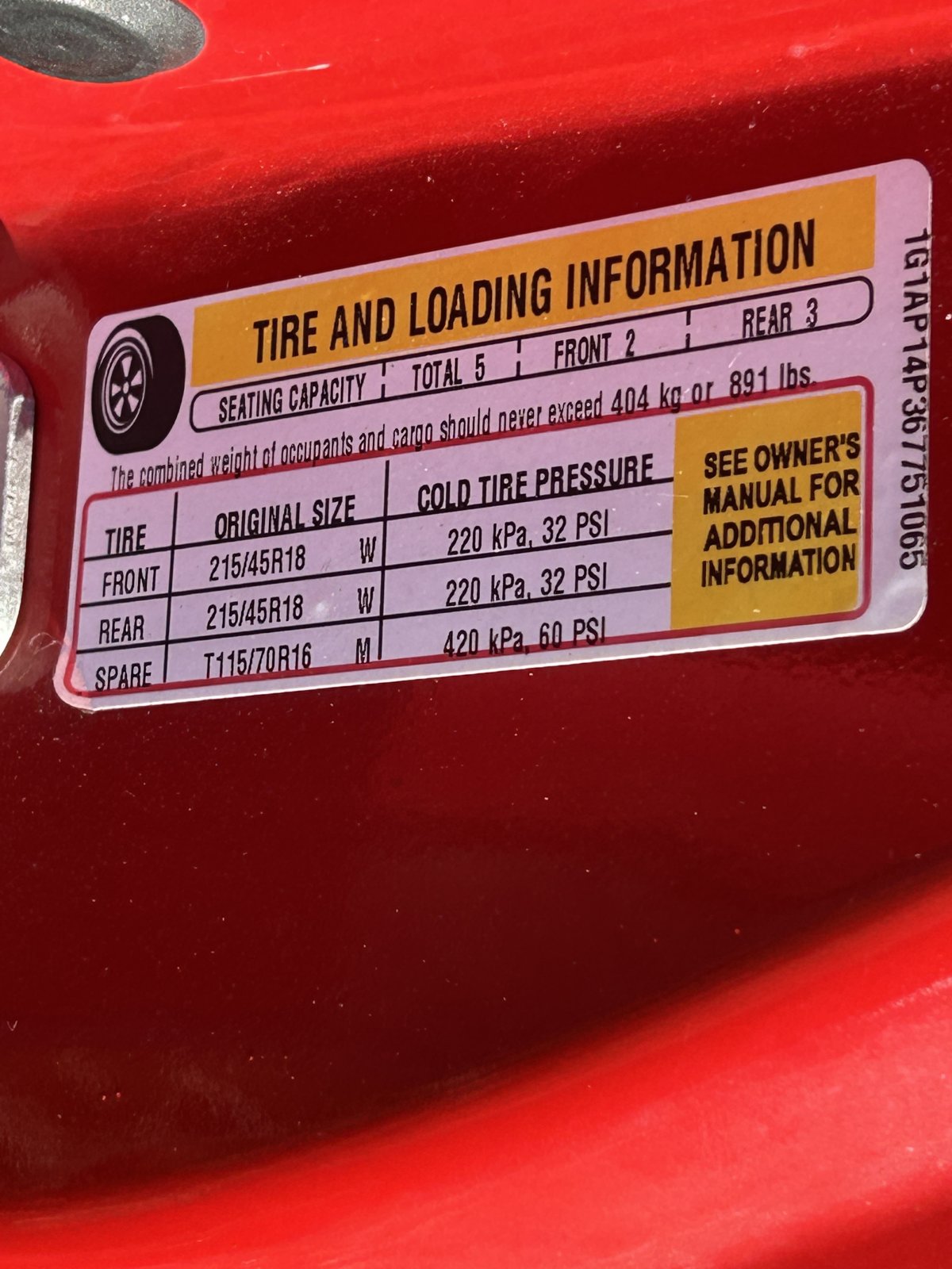

The tire sticker in the door jamb of my SS/SC says the car came with 215/45-18 tires:
38929

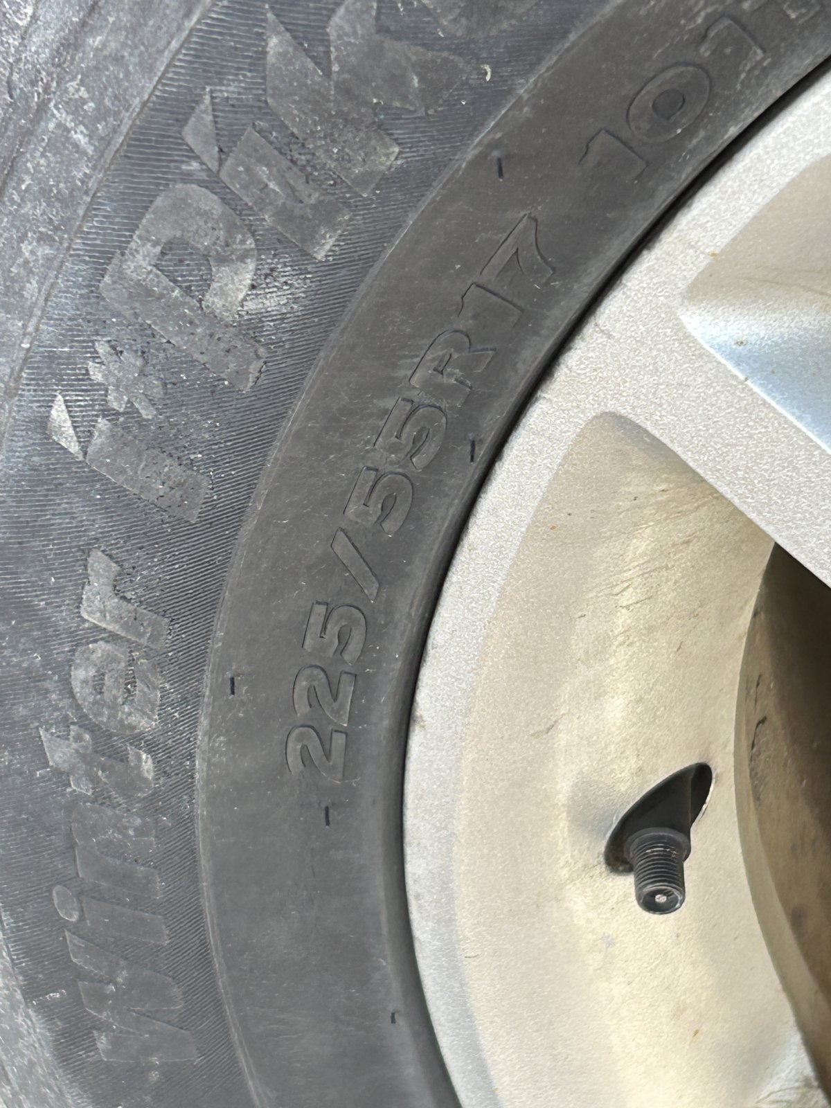

The clown who I bought the car from had fitted it with 225/55-17 snow tires:
38930

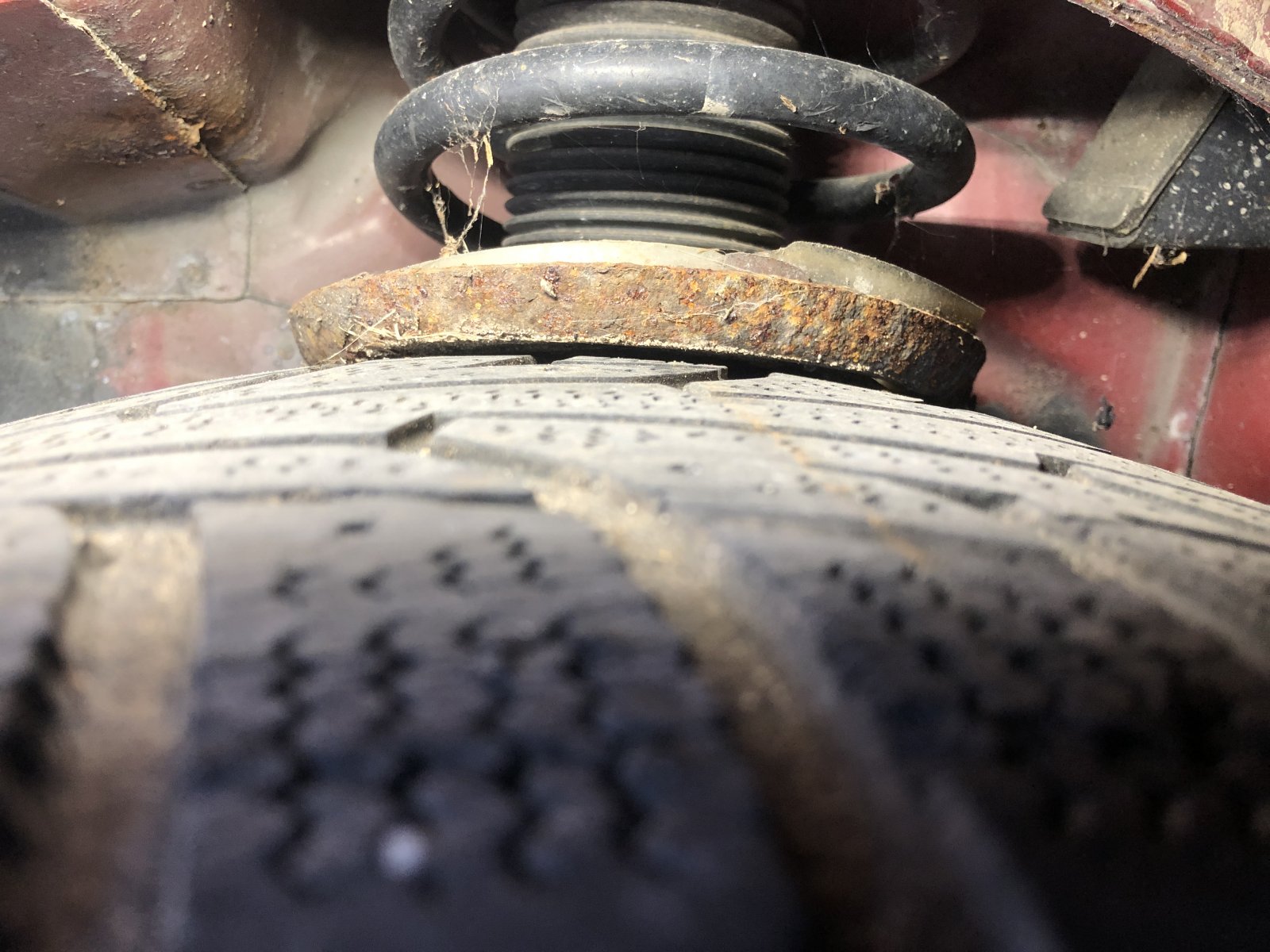

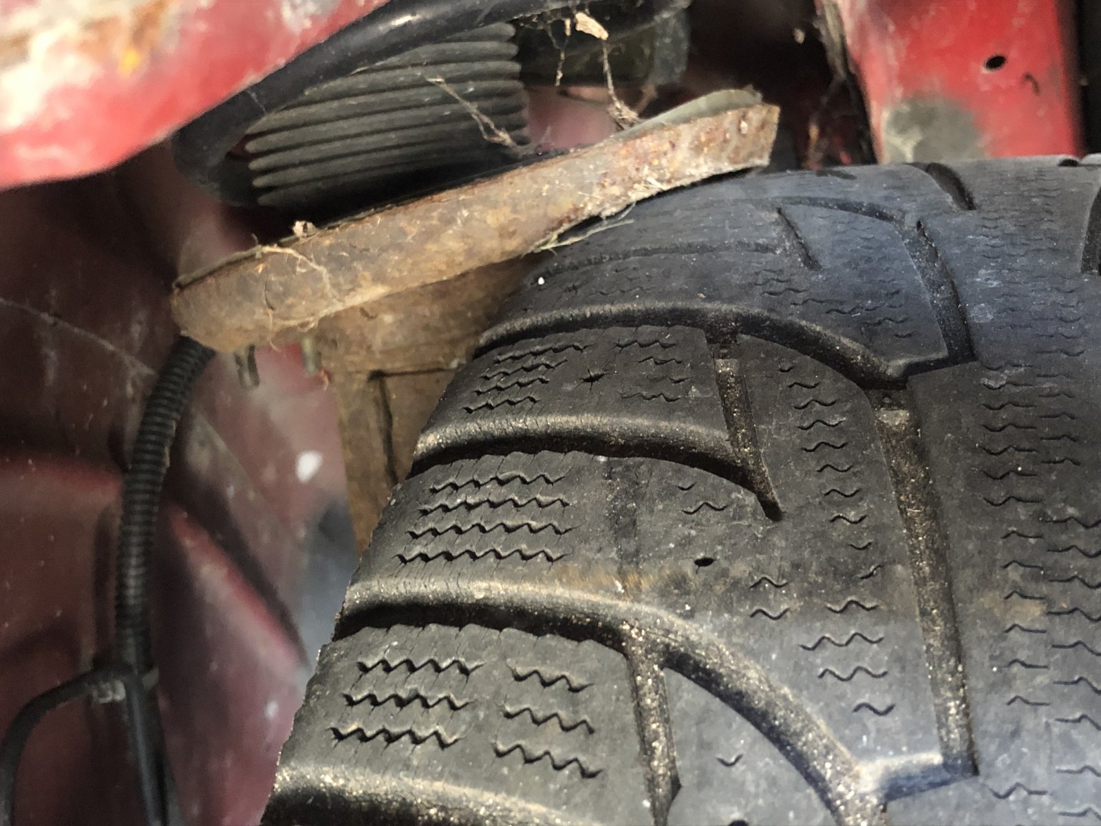

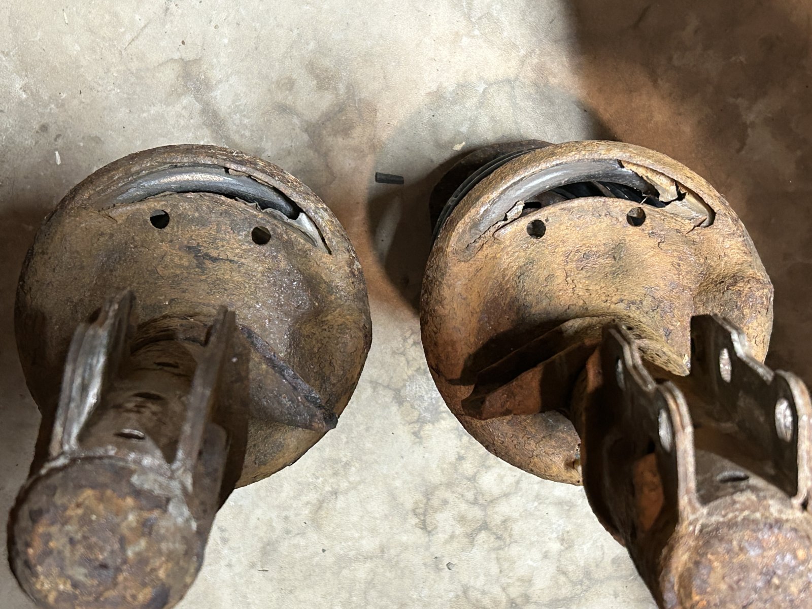

During disassembly I thought the tires came awfully close to the struts:
38931
38932
And during cleanup I find out yeah, maybe that's a little too close.
38933
Holy balls, how do you not notice that while driving? The tire wear, the smell of melting rubber... Geez.
Hard to tell through the rust, but maybe a little angle grinder work was done to get them to fit by someone. It would take more than just one set of tires rubbing to get through the steel spring cup. Wow!

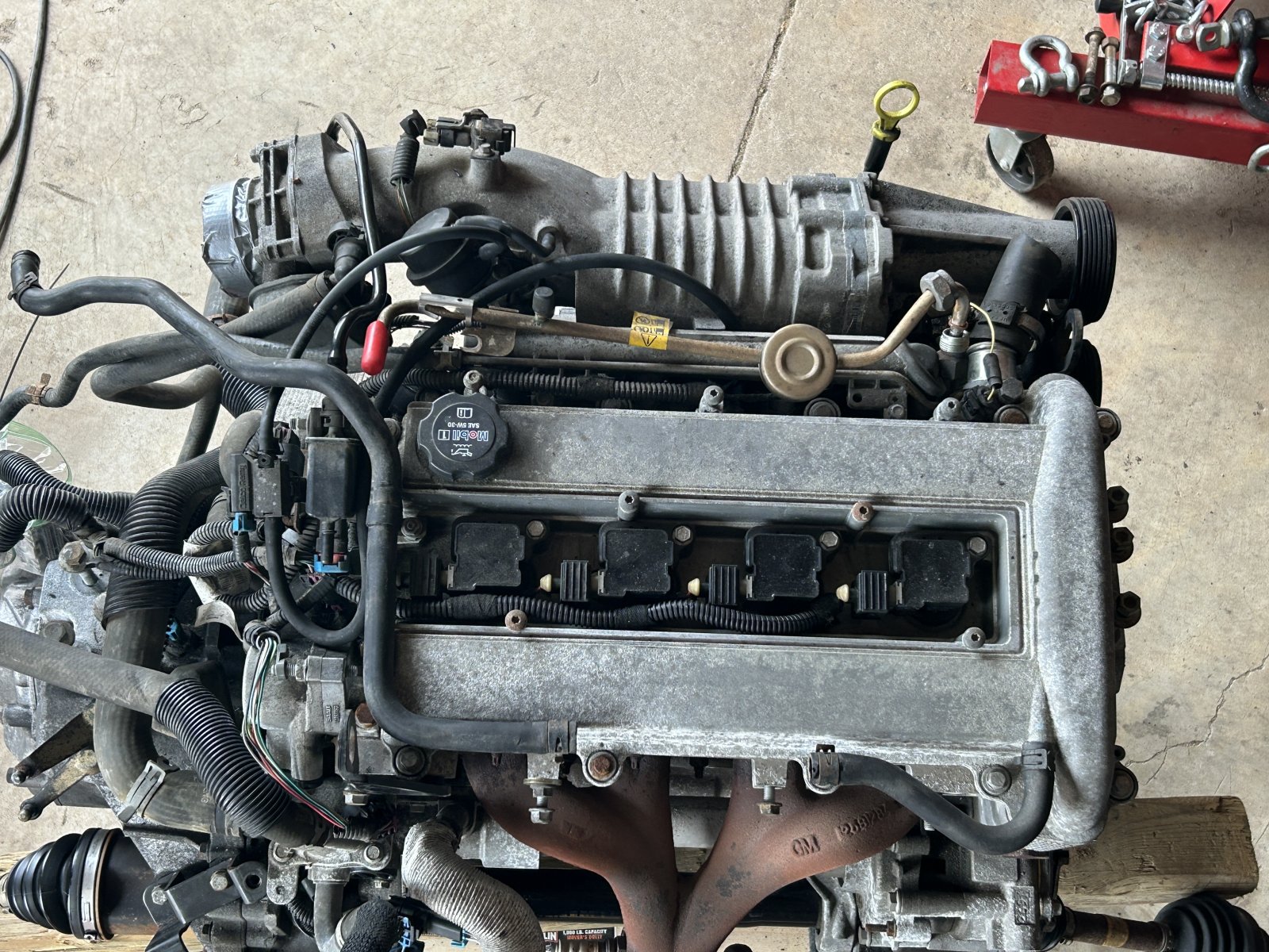

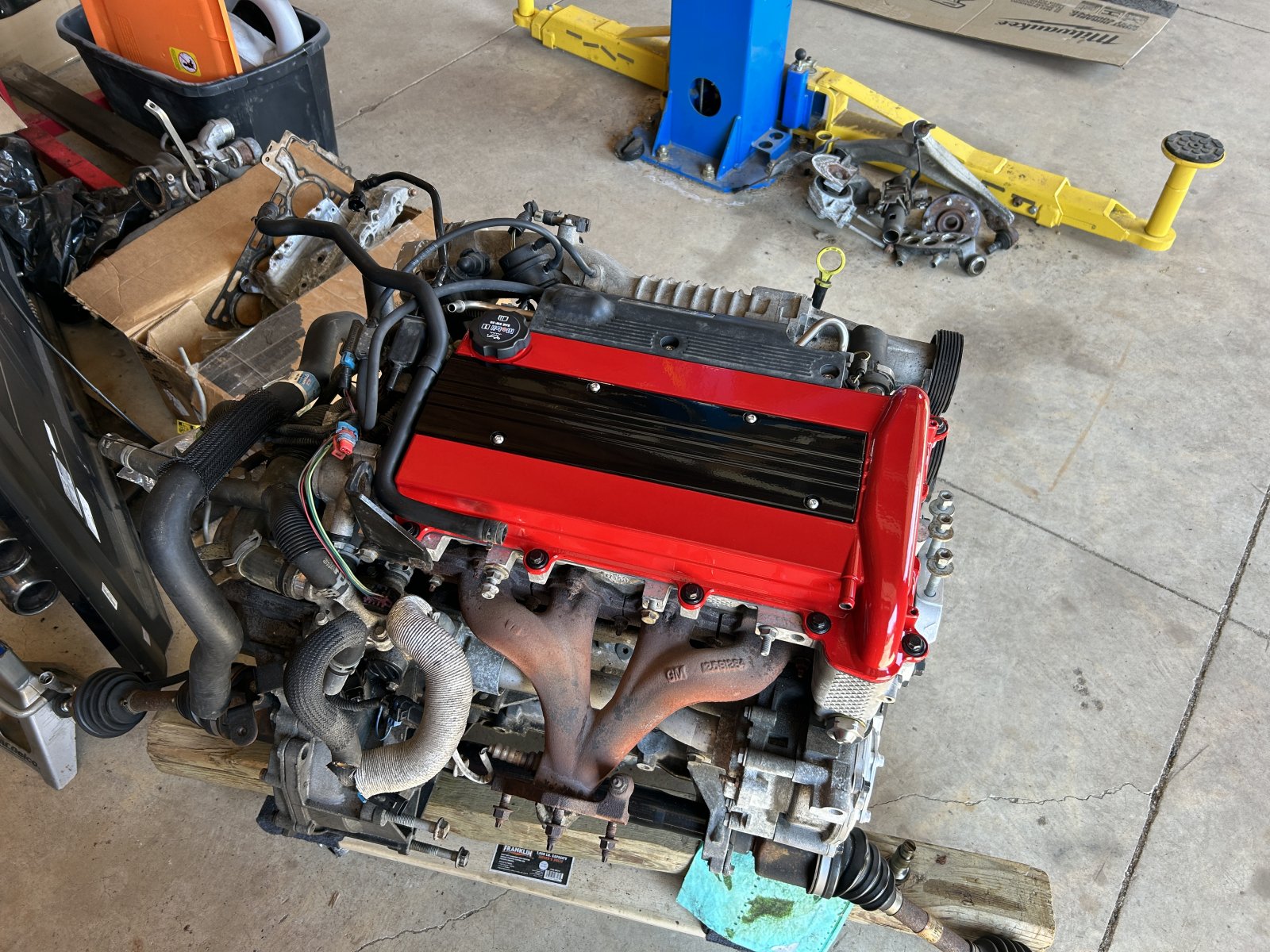

Just a quick update on the build. Got my frame back from powdercoat after about 10 days. I think they did a great job. Frame is gloss black, all accessories (brackets, floor panels, back panels, side panels, etc) are satin black and a few parts (valve cover and toe link bar) are red. They blasted all the parts, primed with a zinc-based primer and then color coat. I also had them blast my rear aluminum knuckles and the DF exhaust. The whole kit and caboodle was $700. The rear knuckles I will rattle can and the exhaust is getting rattle can exhaust paint.
Here's the before and after on the engine parts:

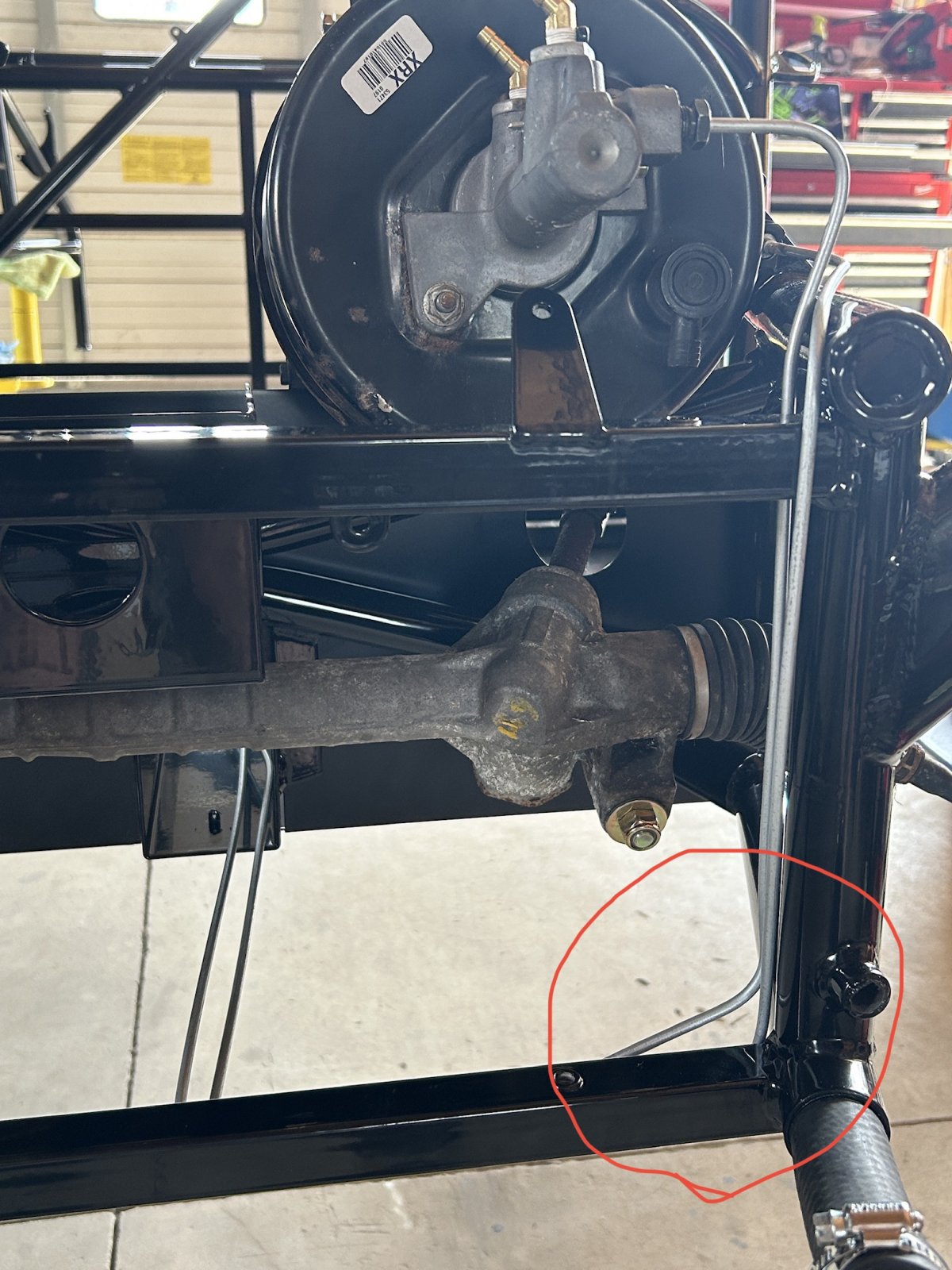

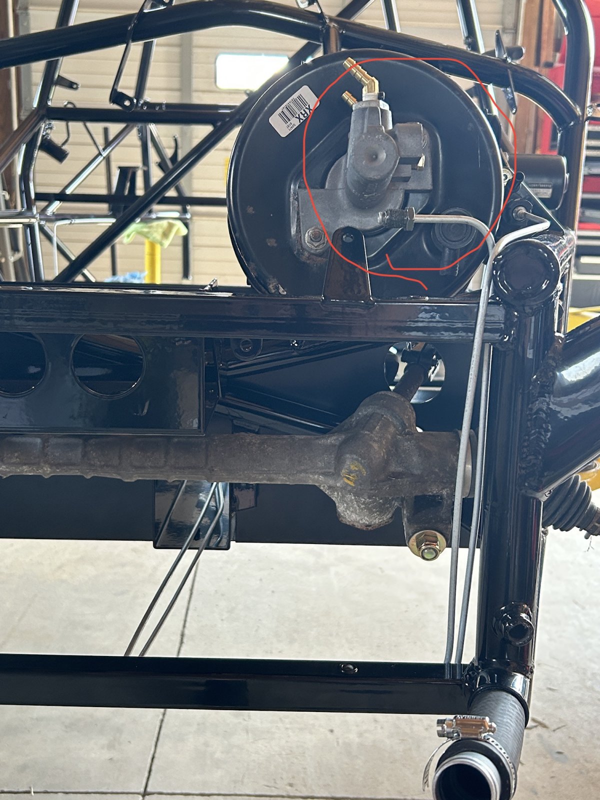

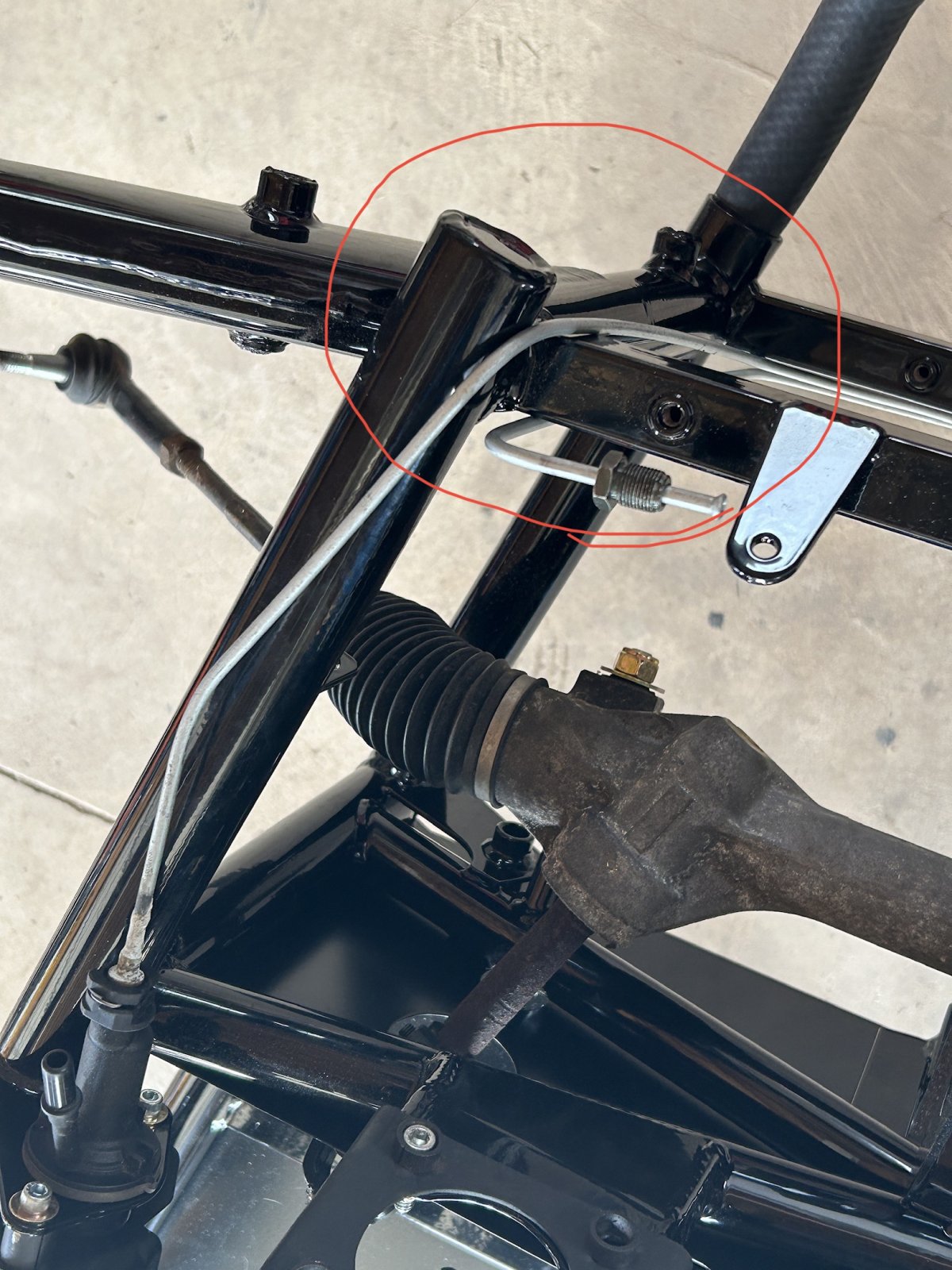

Day 2 was a different story. Whoever DF has bending brake lines is apparently high on something because they are all way off. The T at the back of the tunnel was about 1.5 inches too long. Had to put several bends in the line going down the tunnel to shorten it. The other end of the line was a solid 2" below the master cylinder:
39607
So the bottom of that line got bent quite a bit to make it fit:
39608

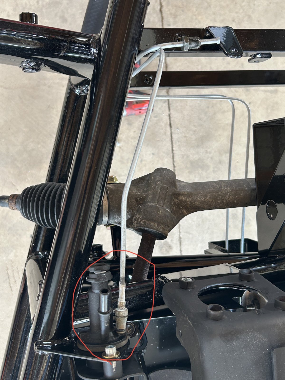

And the clutch line was a solid 3" too long:
39609
So that line got rerouted to the front side of the front crossmember and rebent:
39610
Looks a little goofy, but it should work. Now I'm kinda curious how bad the trans end of the clutch line is going to fit... *fingers crossed*
Sluggonaut
I remember mine being long at just about every connection too, but it's brake line, so it's easy to bend to fit. I think they do that on purpose because imagine the challenge you'd have if they were too short by those same dimensions.

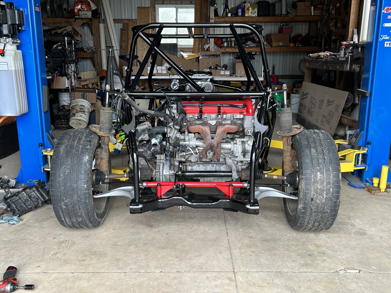

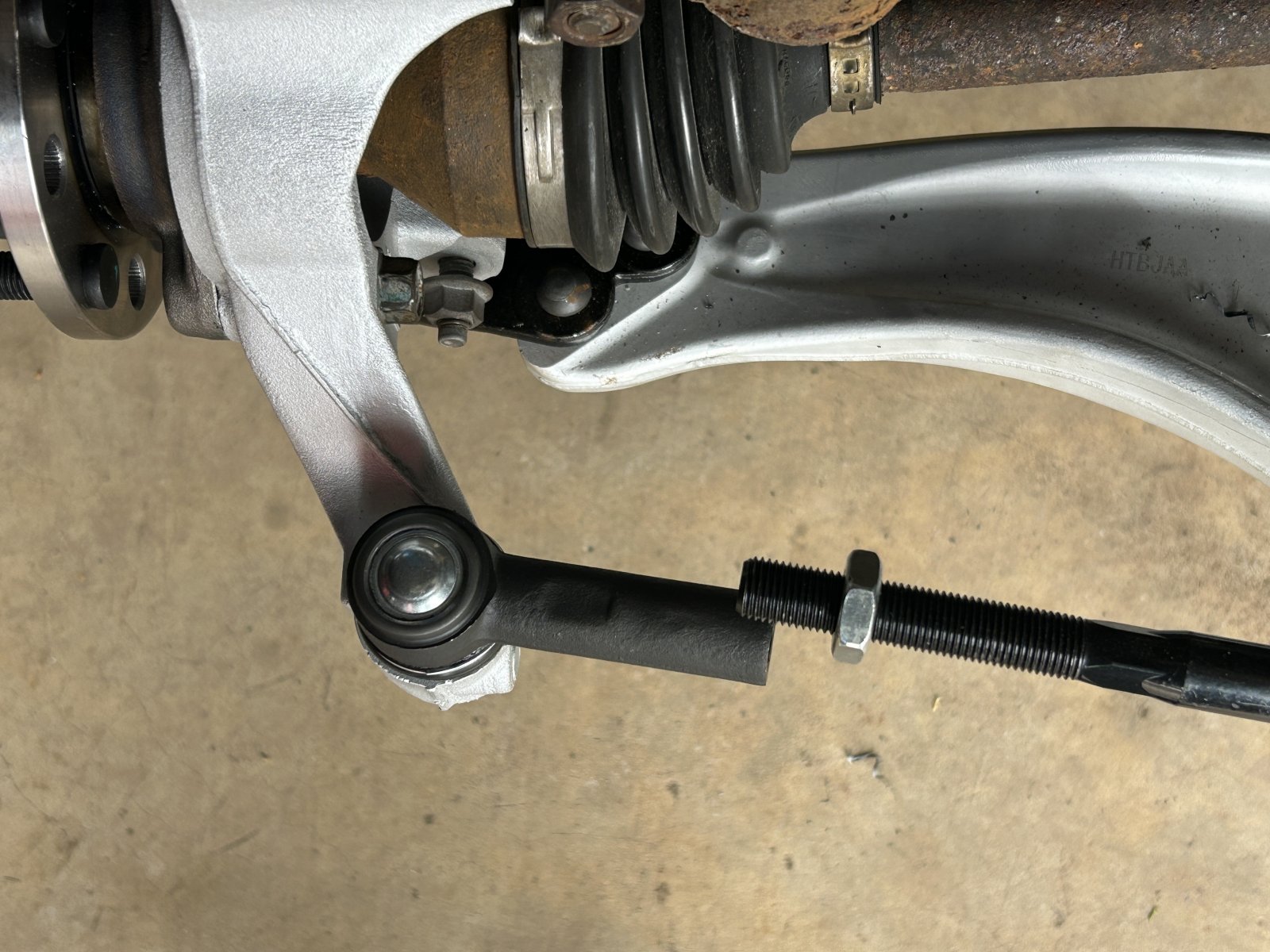

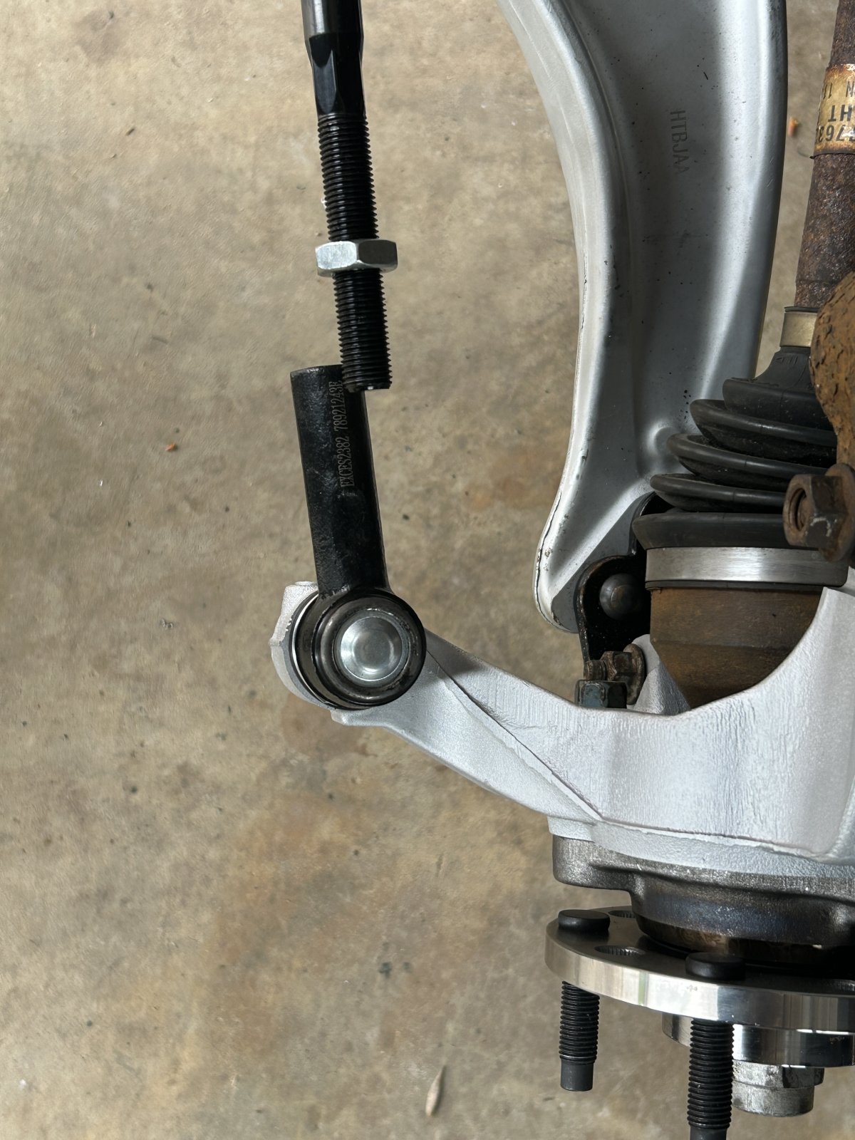

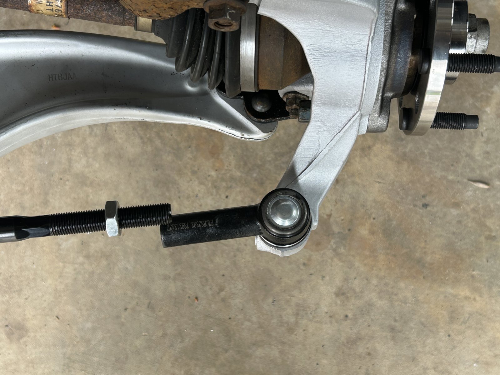

Something just doesn't look right here. Engine is in, subframe is in, steering "rack" bar and rear LCAs are in and all are torqued down. I loosely fit the bearings, struts and knuckles to get a preliminary position for the tie rod ends and they seem to be a long ways out (only about one diameter (1/2") of thread engagement):
39784
39786
39787
What did I do wrong?
