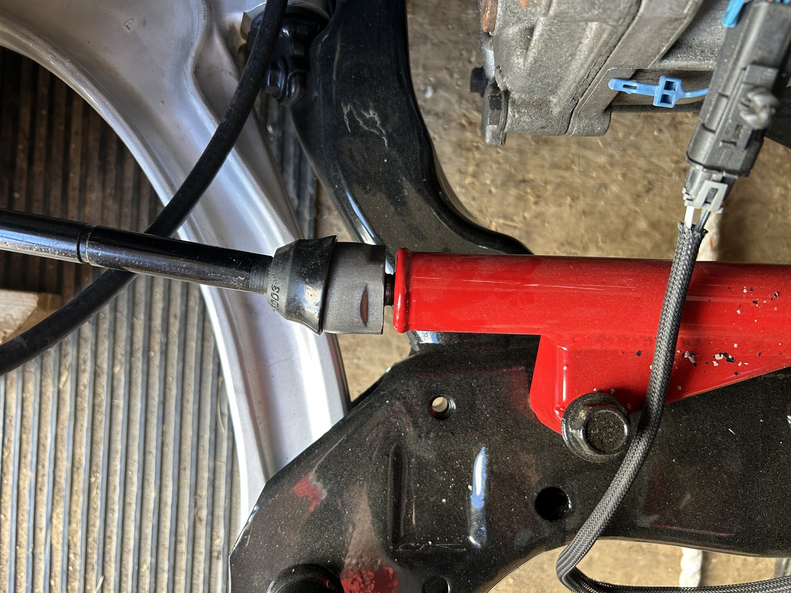

When I got home I found that the LH rear inner tie rod was backed out almost 1/4 inch. I don't know if it was like that all day, or progressively got worse. When I get it off the trailer I'll recheck the alignment and see if it moved or if its been like that all along.

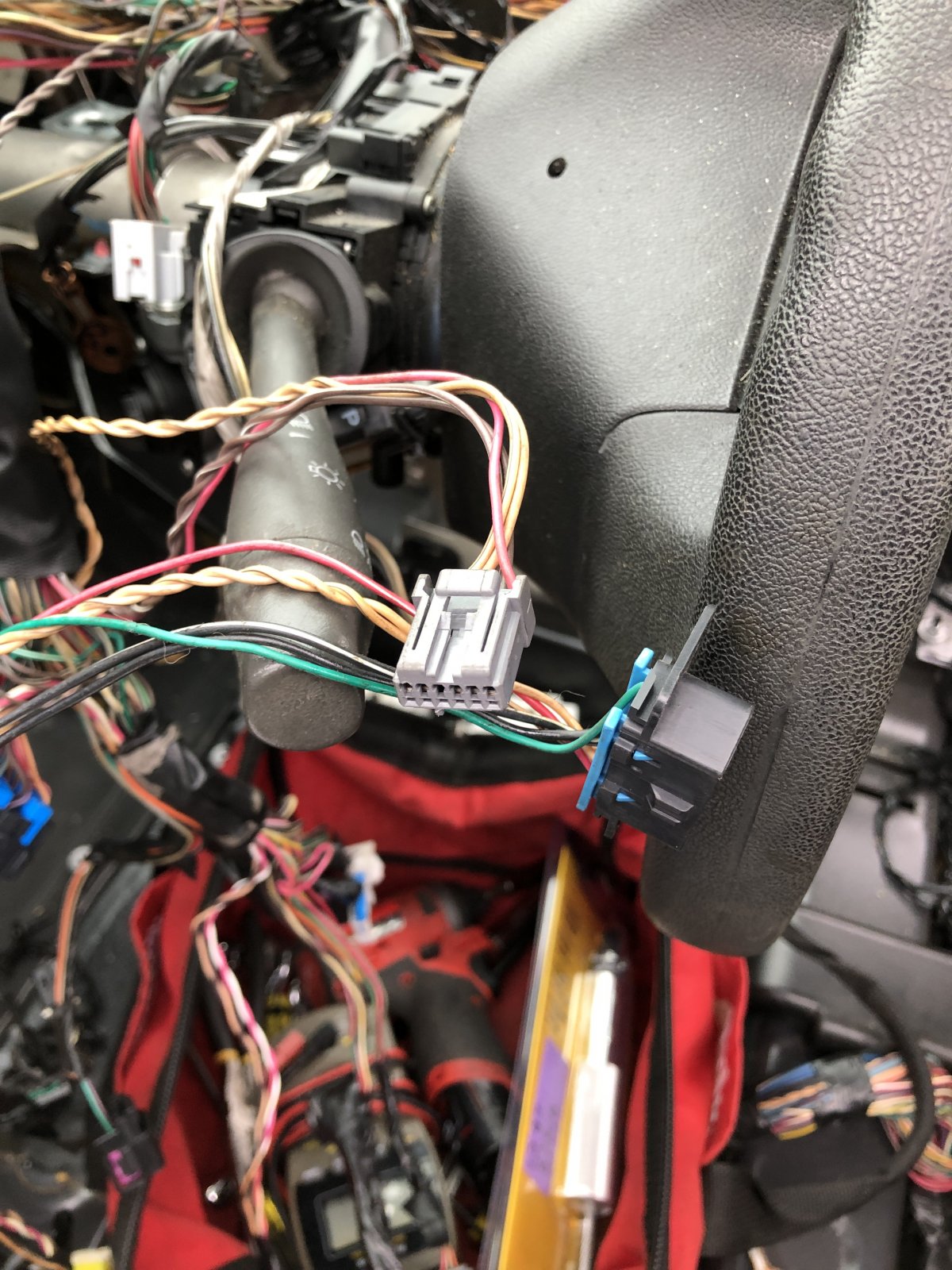

Not sure how or why, but during the wire harness videos I had some sort of listening malfunction and cut every wire in my steering connector:

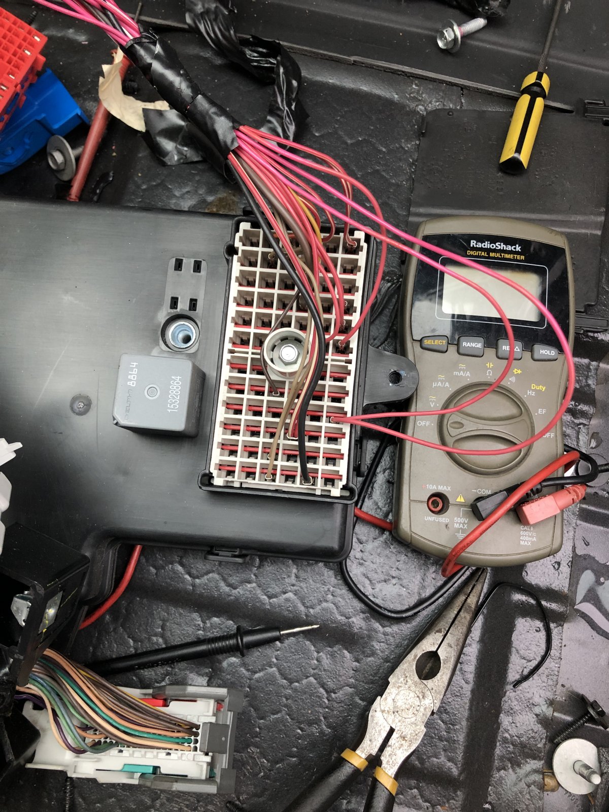

I don't have the wiring diagrams for my car, so I went to my local pick-a-part to see an original uncut harness to find out where these wires go. The dark brown twisted pair goes to a snap-in BCM connector:
40919
The pink wire shares a spot on the back of the BCM with another pink wire

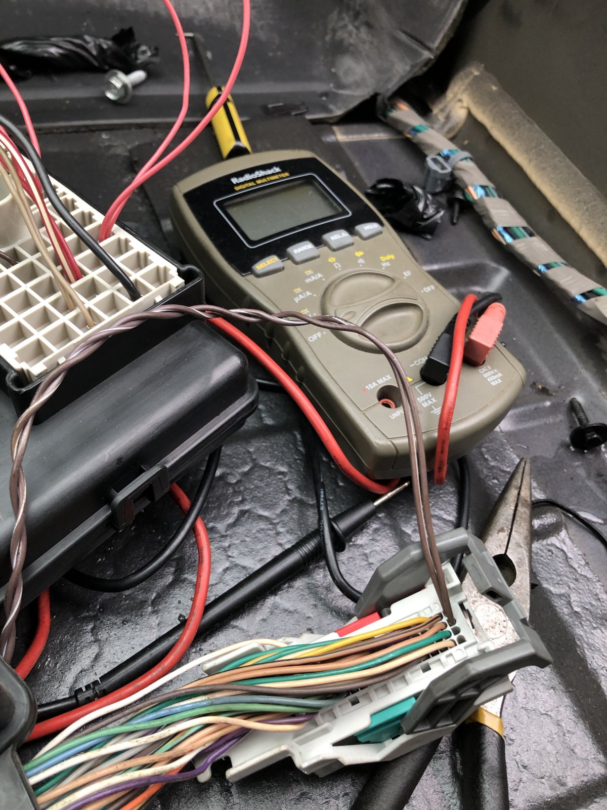

And the tan twisted pair goes to the OBDII connector
40921

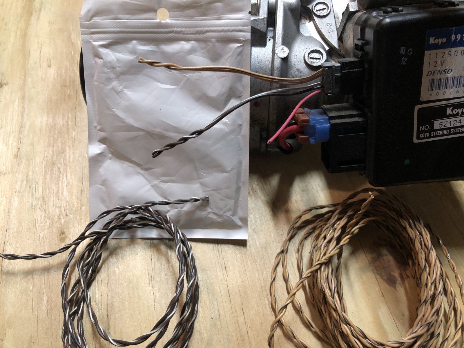

So I reconnected the two twisted pairs, but I had cut the pink too close to the connector, so I figured I would just splice it into the other pink wire during the build.
So I got the car done and my EPS pink wire is still not connected to anything. The car runs and drives great. The OBDII connector works and my scanner connects without errors. The car is easy to steer, but I don't think the power steering is working. So I decided to connect the EPS pink wire to the other pink wire it shared in the BCM. No change in the steering (still not working, I assume).

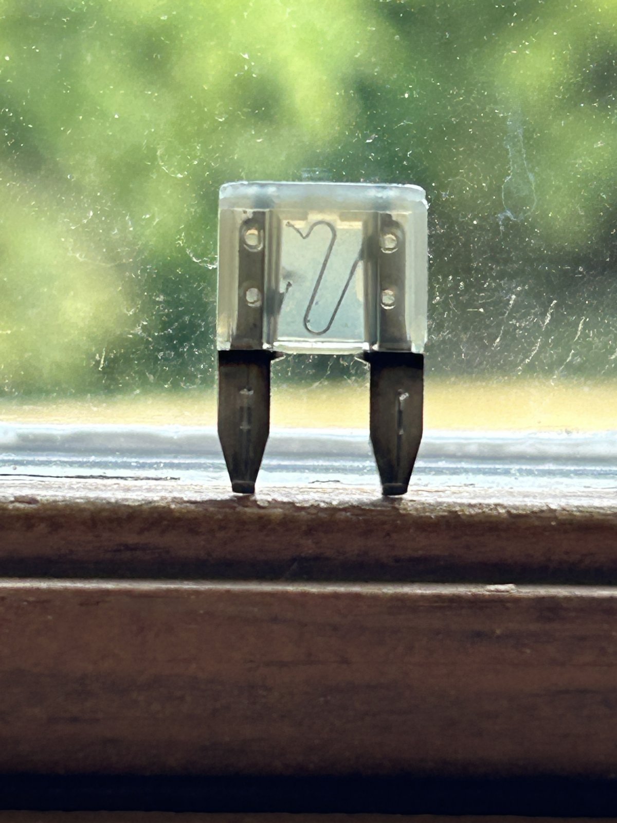

Sure enough, the little 2A fuse to control the EPS module was blown.
41038
Amazing how just a little 2A fuse could cause such a big problem. I replaced the fuse, reconnected the EPS pink wire, fired it up and voila! Power Steering works. And the fuse didn't blow immediately, so that's a good thing. Now I'm wondering what made it blow in the first place... Thoughts?
