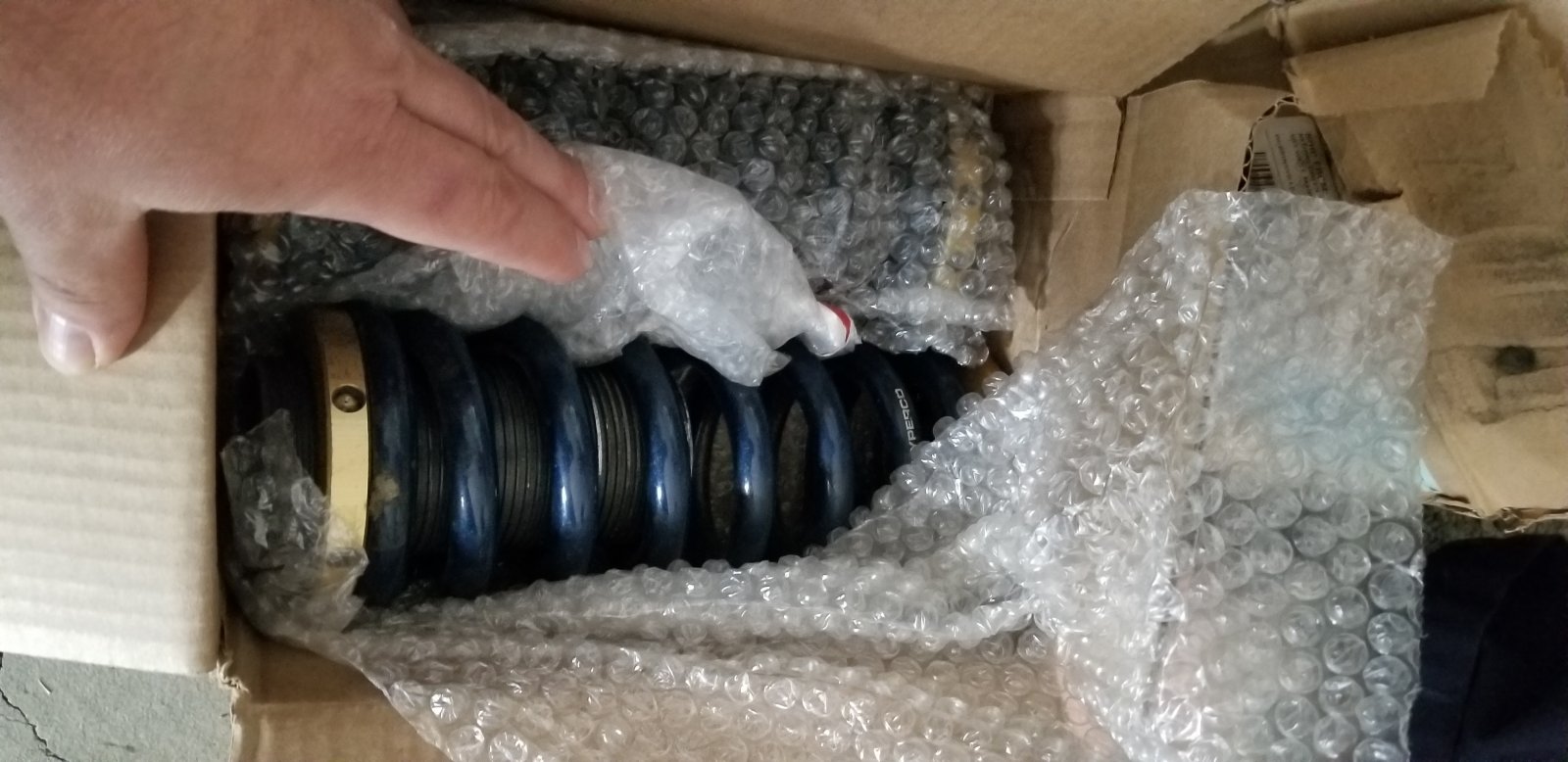

Deal not completely done, but some of the pieces trickling in.

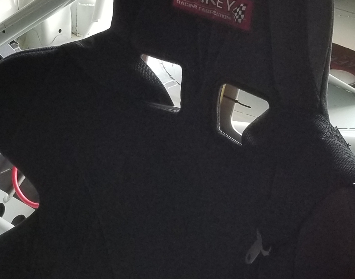

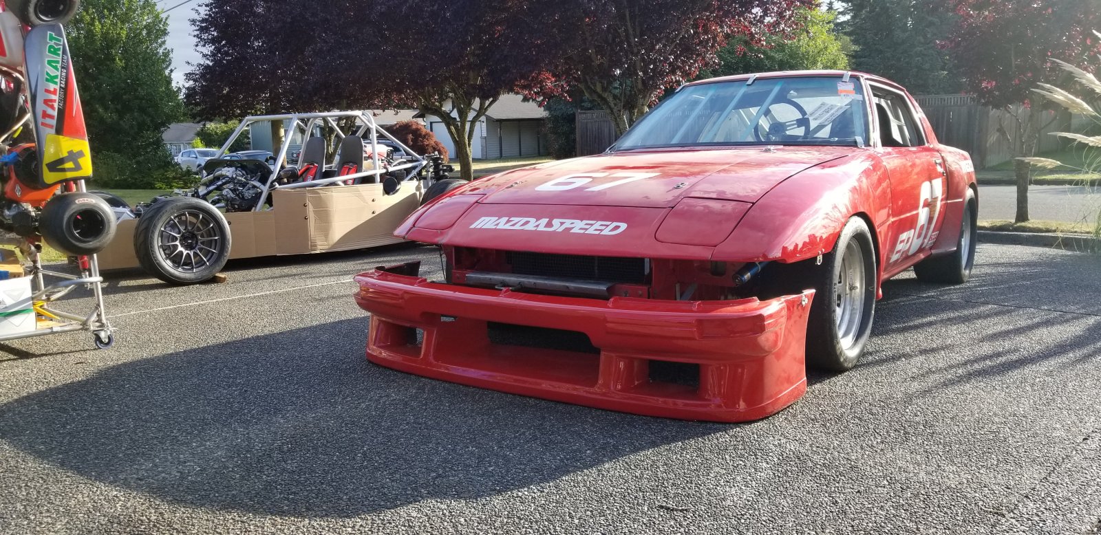

GT sedan club racer? I think I see a rear door in the pic along with a roll cage close to the right side of the Kirkey.

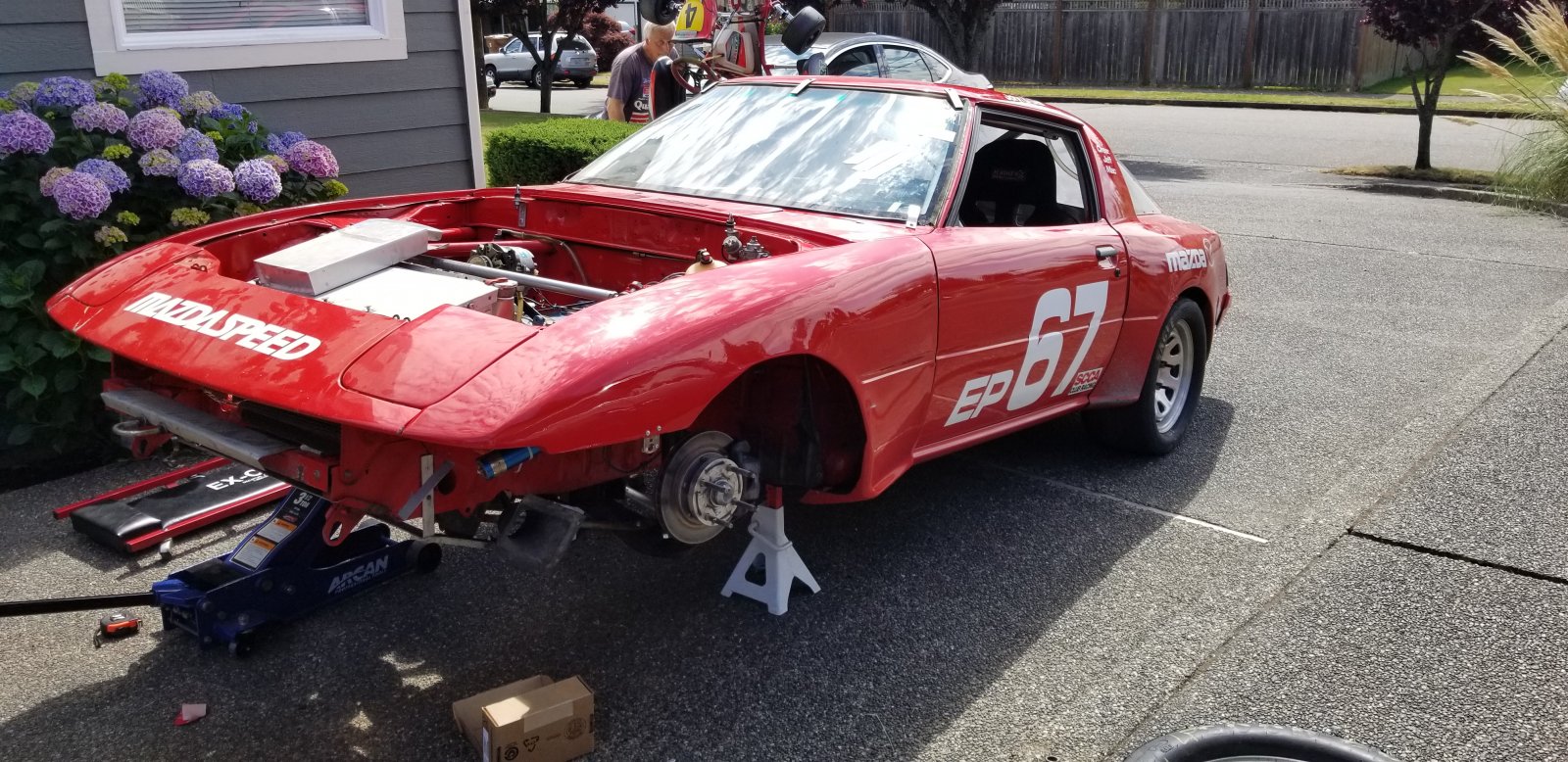

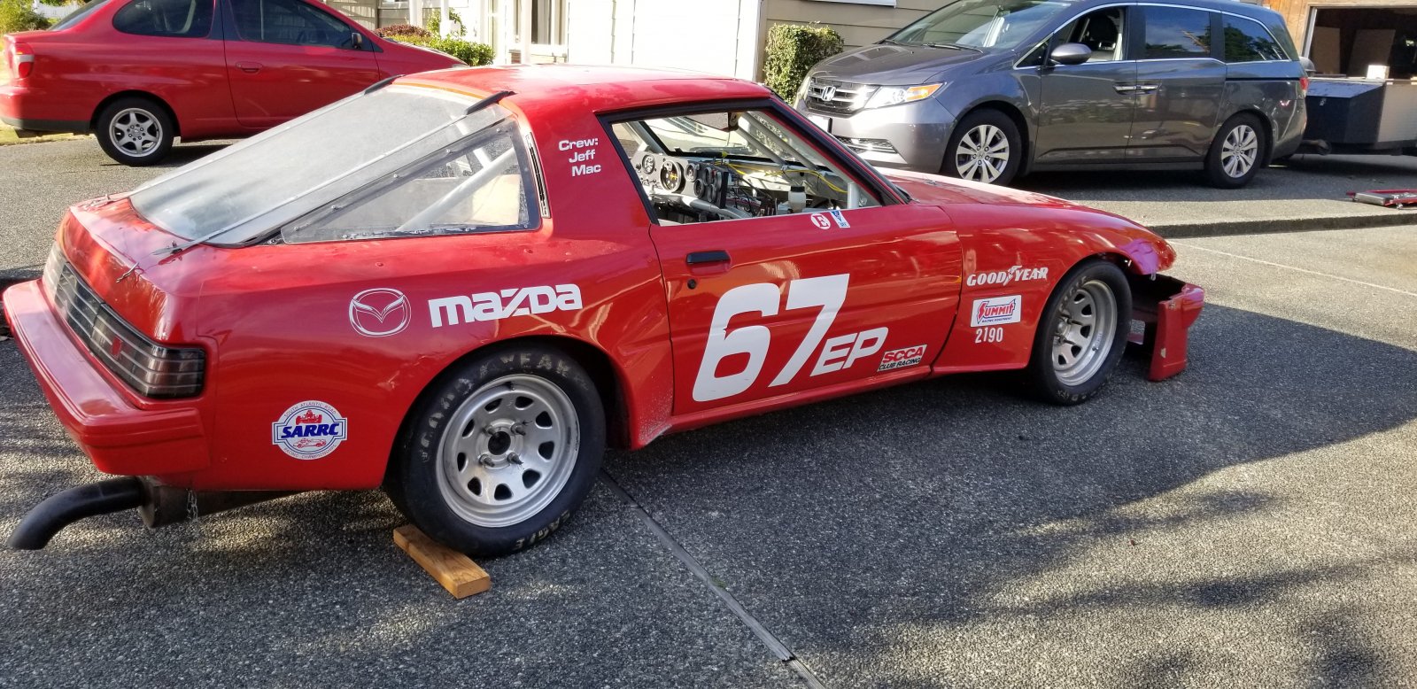

Deal done and car at it's new home today!
When I say deal, it was an offer I couldn't refuse.

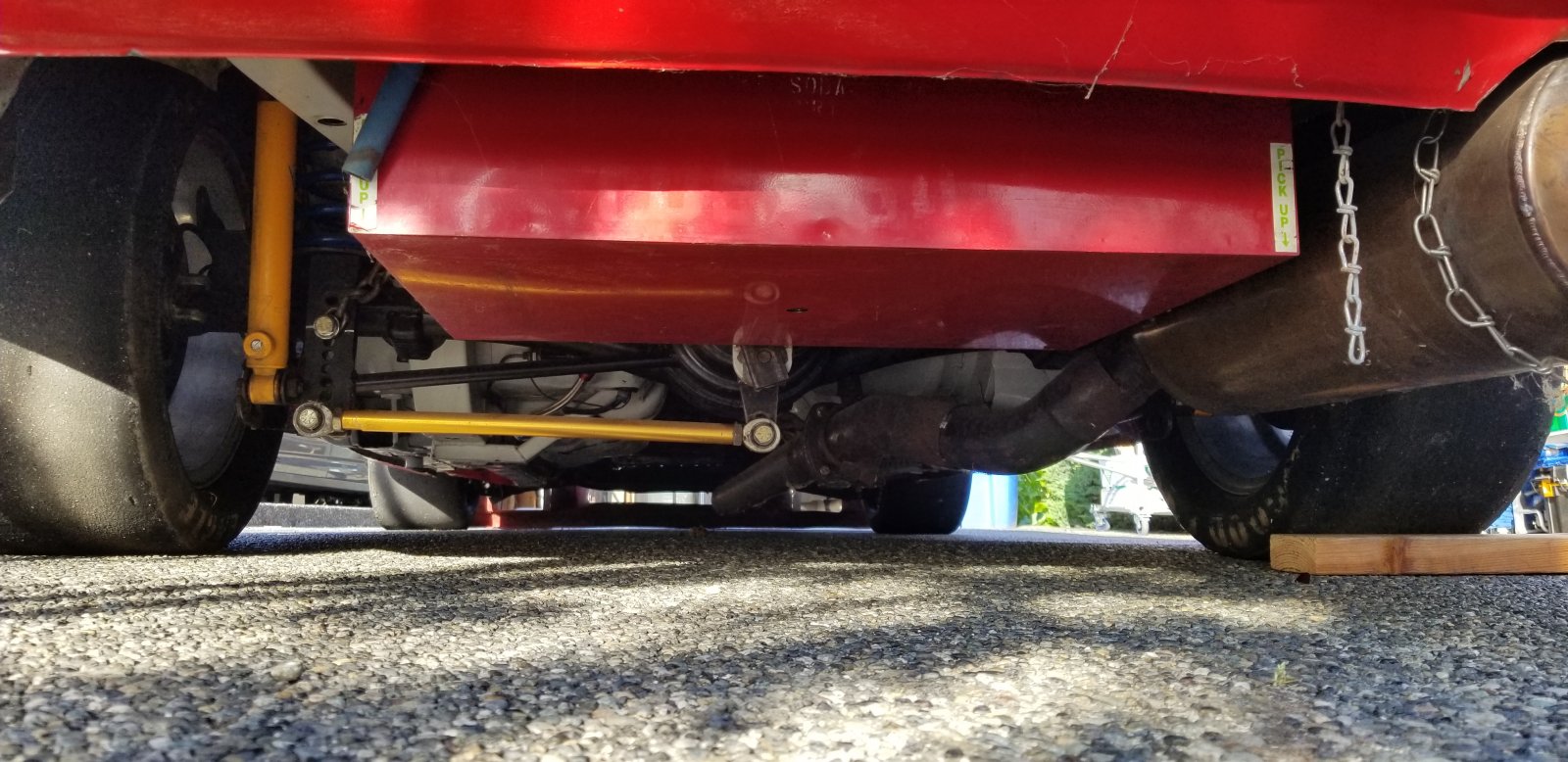

1983 RX7, 13B, 9500rpm screamer. Fully caged, watts linkage rear end, fuel cell, list goes on.

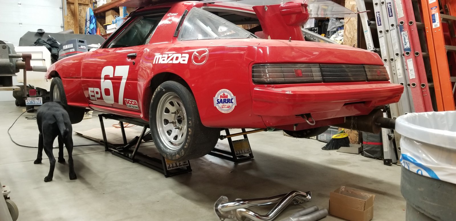

Part of the deal is the previous owner kept certain parts for his street car. Carb, header, distributor, coils, belt driven oil pump system, steering wheel, oil pan.

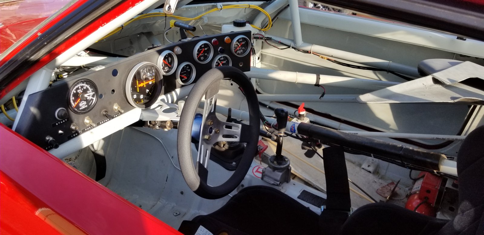

Already getting into it reassembling and adjusting the steering linkage
Repurposed the Goblin steering wheel for now.

I've always loved the look of the FD's.
We can't wait to see how this drives once we source all the replacement parts. This car I guess is still legal and competitive in E Production class instead of a vintage class.
A few parts and elbow grease should get it under it's own power again.

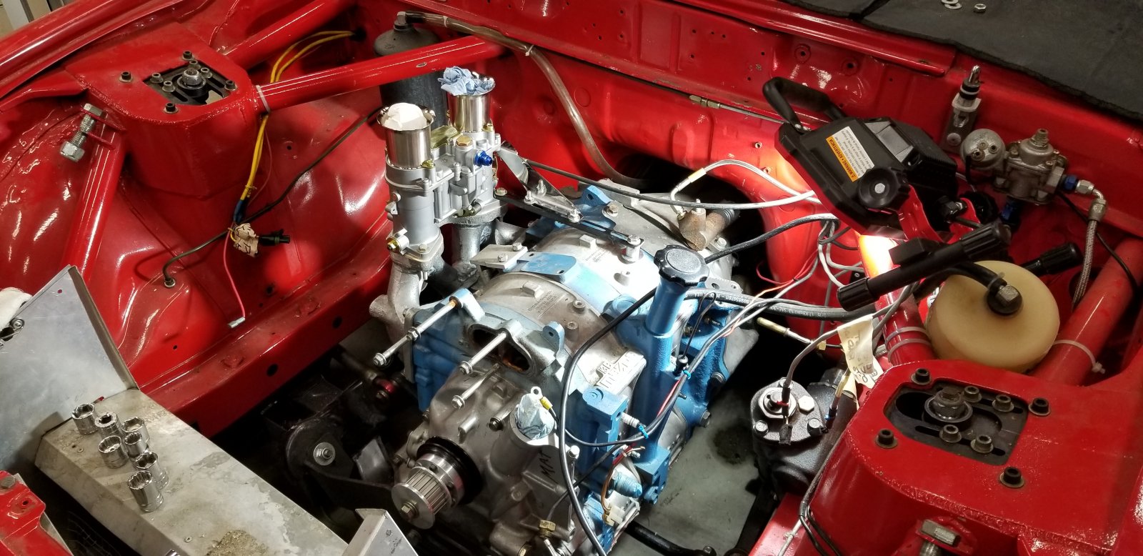

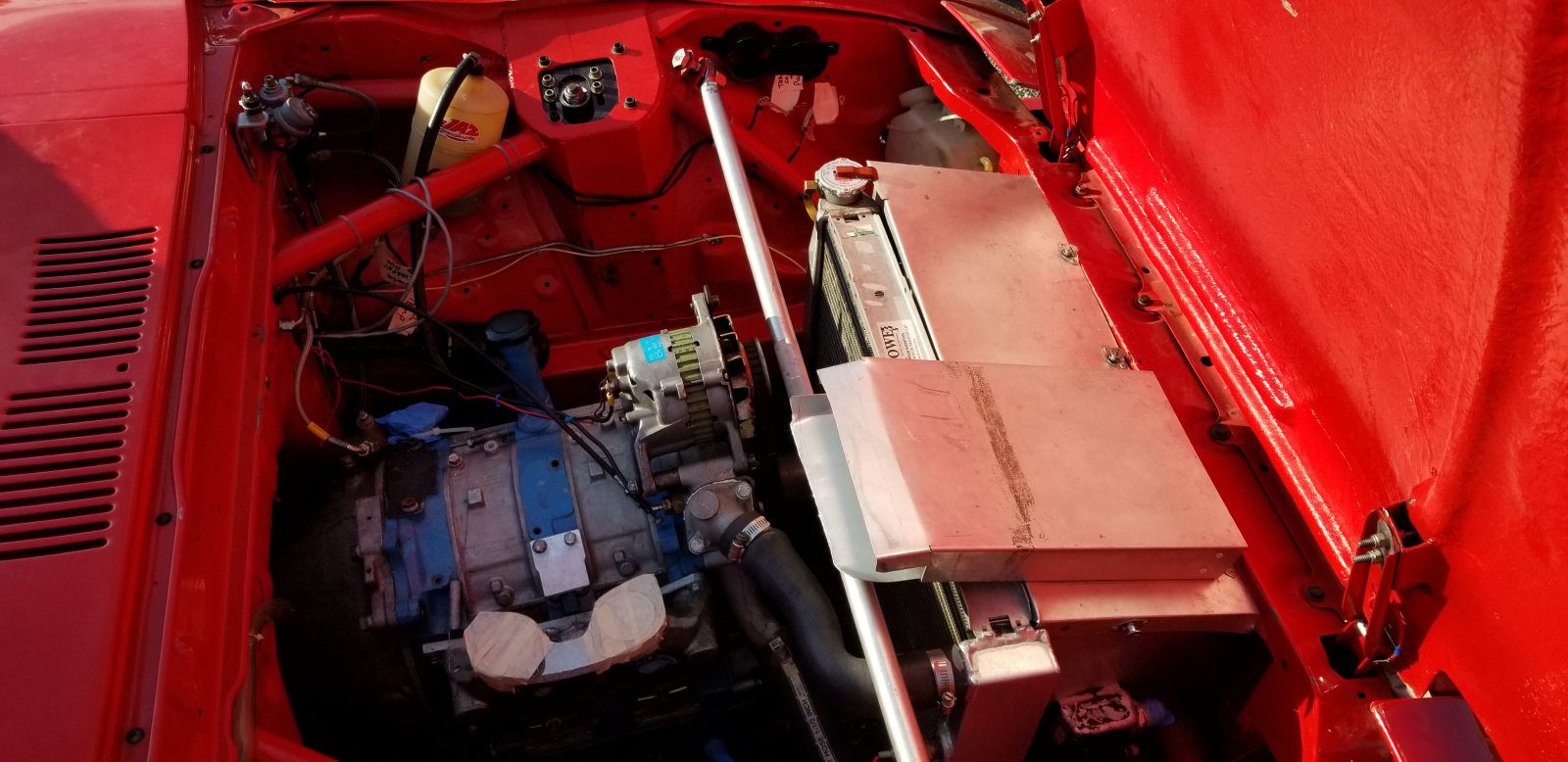

We made some progress on the RX7 this weekend.
Had to remove the front cover and verify the front thrust bearing had dropped out of position and reassembled.
External wet sump drive pulley installed.
Header and intake bolted on and torqued.
Carb, throttle arm, stop and throttle cable mount built/modified and installed.
Can't wait for our first start on this and hear that 'ol Braap, Braap, Braap!

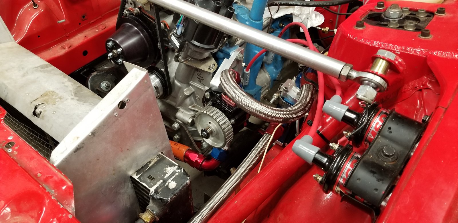

Made some progress on the RX7.
Removed all the MSD wiring that was for the trailing ignition. Re-wired the MSD 6AL for the leading ignition and configured for direct fire. That cleaned up a bunch of wiring.
New braided ptfe fuel line from the regulator to the carb. (Still need to replace it from the regulator back the cell)

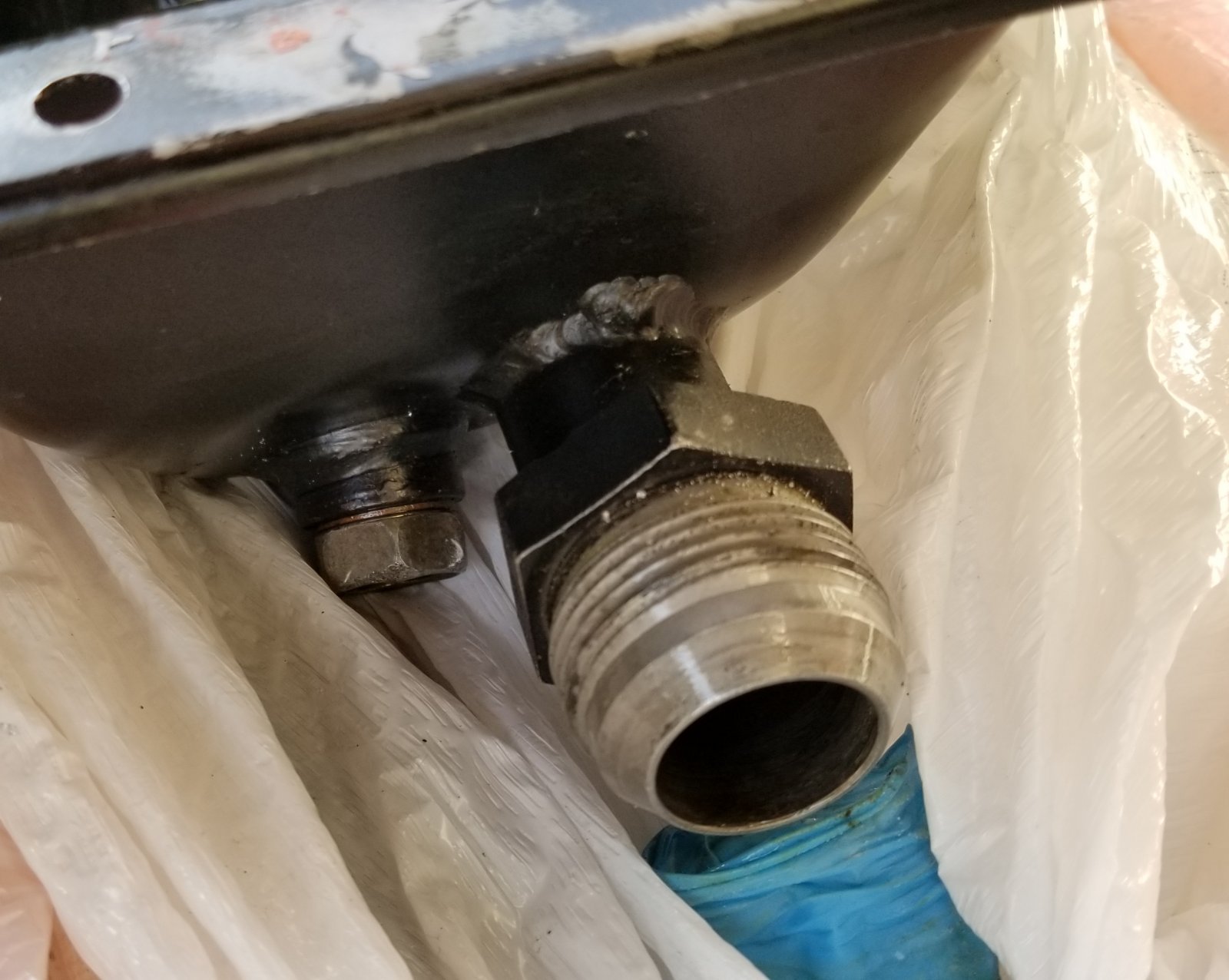

Got the oil baffle plate and oil pan reinstalled. Mounted the external oil pump back up for the external wet sump system. Need to pull the crossmember and cut and weld a notch in it to clear big friggin' AN fitting that connects to the pan.
Doesn't look like much was done but the devil's in the details.
