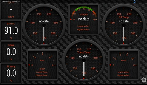

I used a bluetooth OBD2 adapter and a Samsung tablet with the Torque Pro app in my other car for track days. You can customize the screen to display whatever gauges you want, size, color, and just about anything else you can think of. It was pretty cheap to do and worked well on track so I've considered doing something like this in the Goblin as well.
Classy

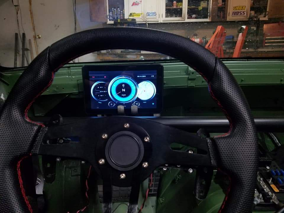

I really like the idea, with an antiglare screen protector and a water resistant case, I would even build a cover for it to block the sun from being directly on it. Would only cost a few hundred with the cost of the tablet worked in.
Fozda
It's definitely the cheapest and easiest way to get a bunch of gauges displayed. I just haven't looked into figuring out how to mount it yet.
Classy
My son has a tab A that he hasn't touched since he got a phone, this is getting cheaper by the second!
So, the Torque Pro app, you can customize it to whatever you need and change the colors, display and style?
Fozda
You can change just about everything you can think of! You have have round, square, full sweep, half sweep, digital, set min/max parameters, size, color, background, you name it.

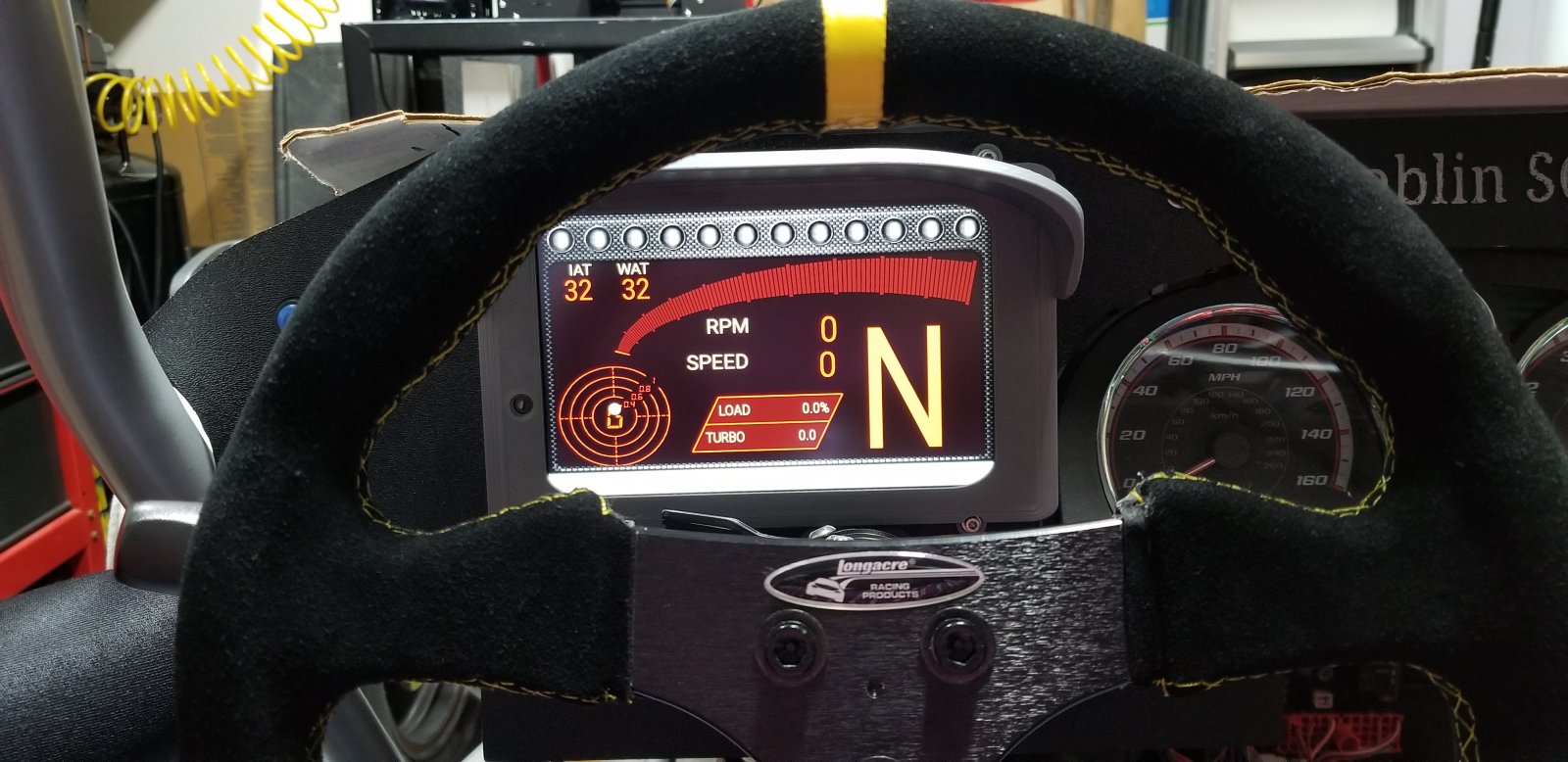

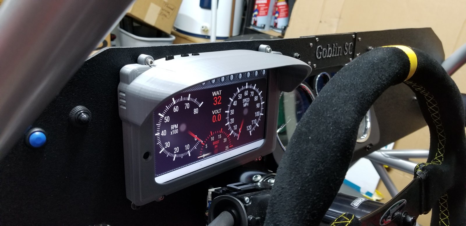

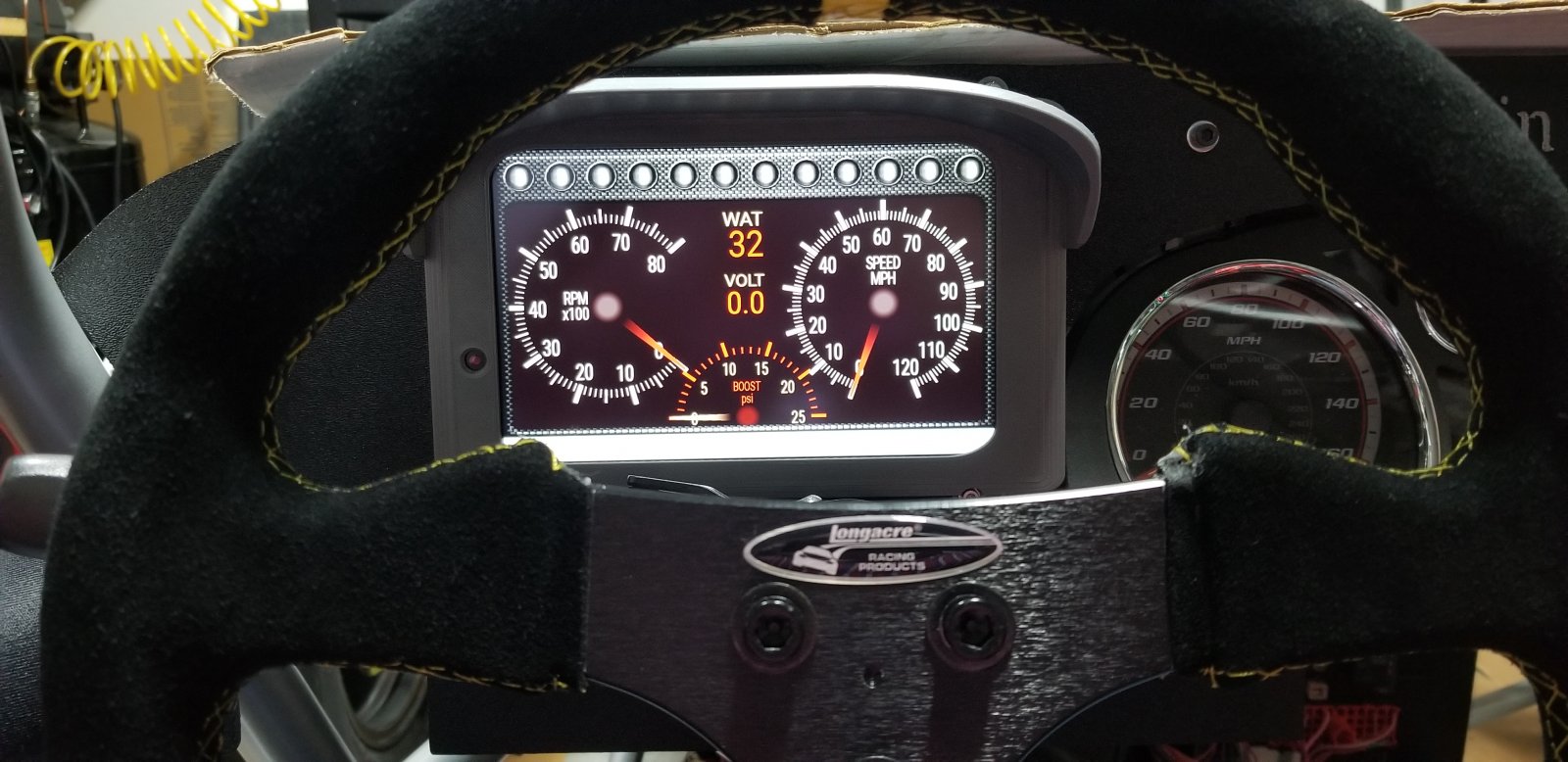

I love the mount! The only problem is that I don't have those big black panels on there like you have. Are you able to print a backplatefor it that has some mounts built in?
Waterdriver
I don't have a printed backplate for it. In thinking about it, the same 1/4in ABS I used for my dash panels, could be cut out/trimmed as backplate. Then mount that backplate to something.
What would you mount it to?
Have something in mind?
