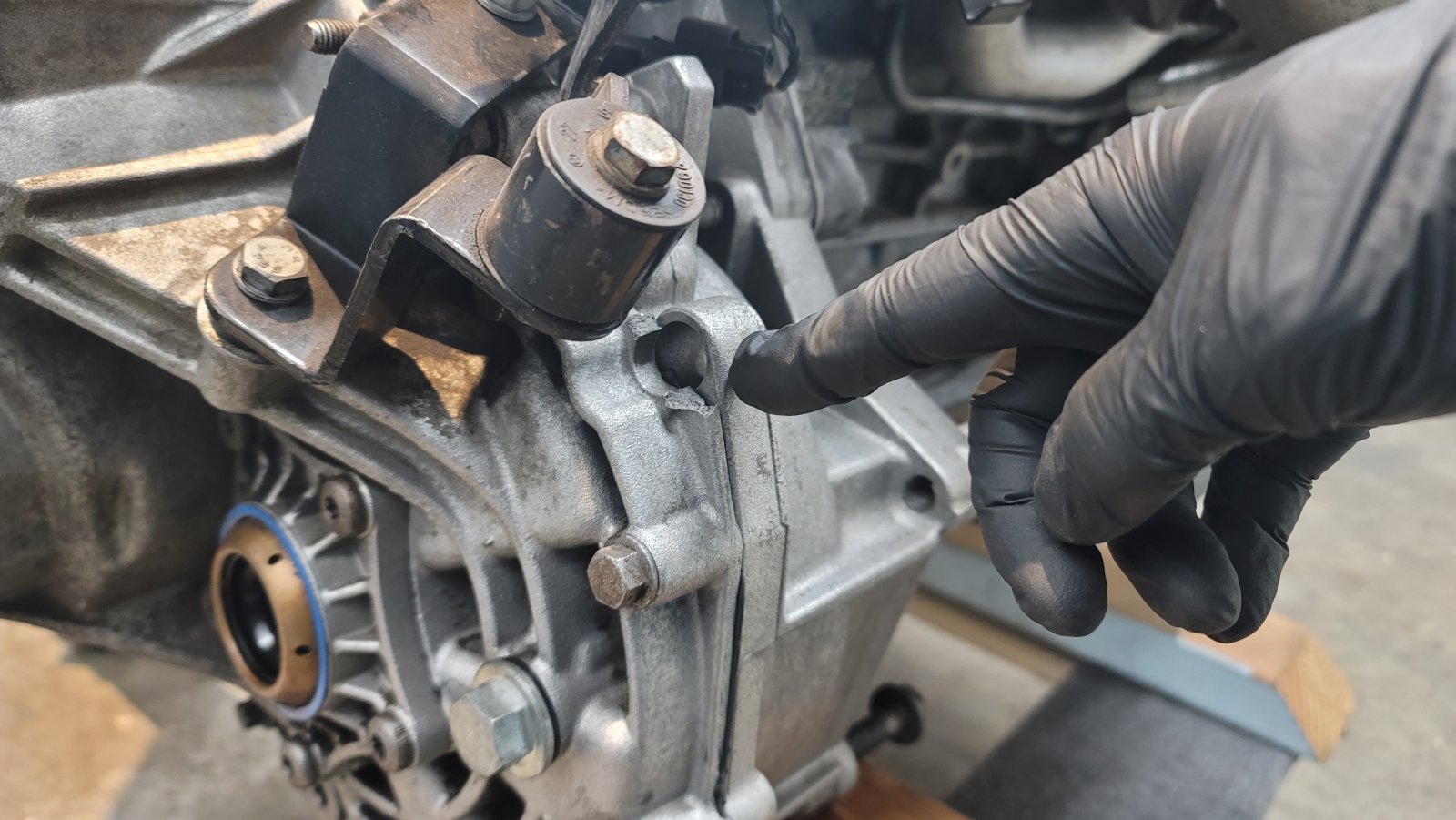

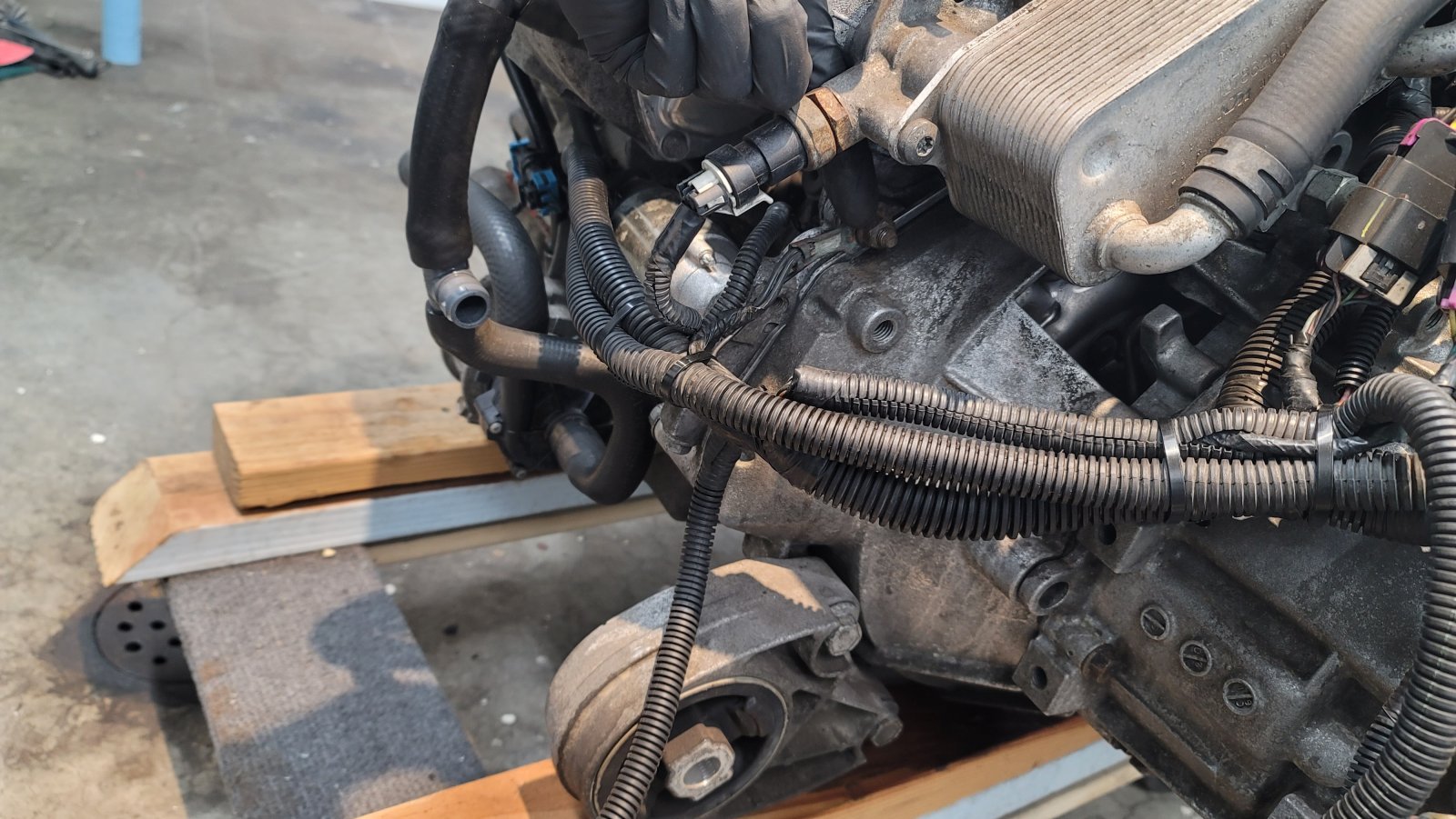

1. How screwed am I with this broken transmission casing? Can it be fixed? Will it be fine? etc..
44073

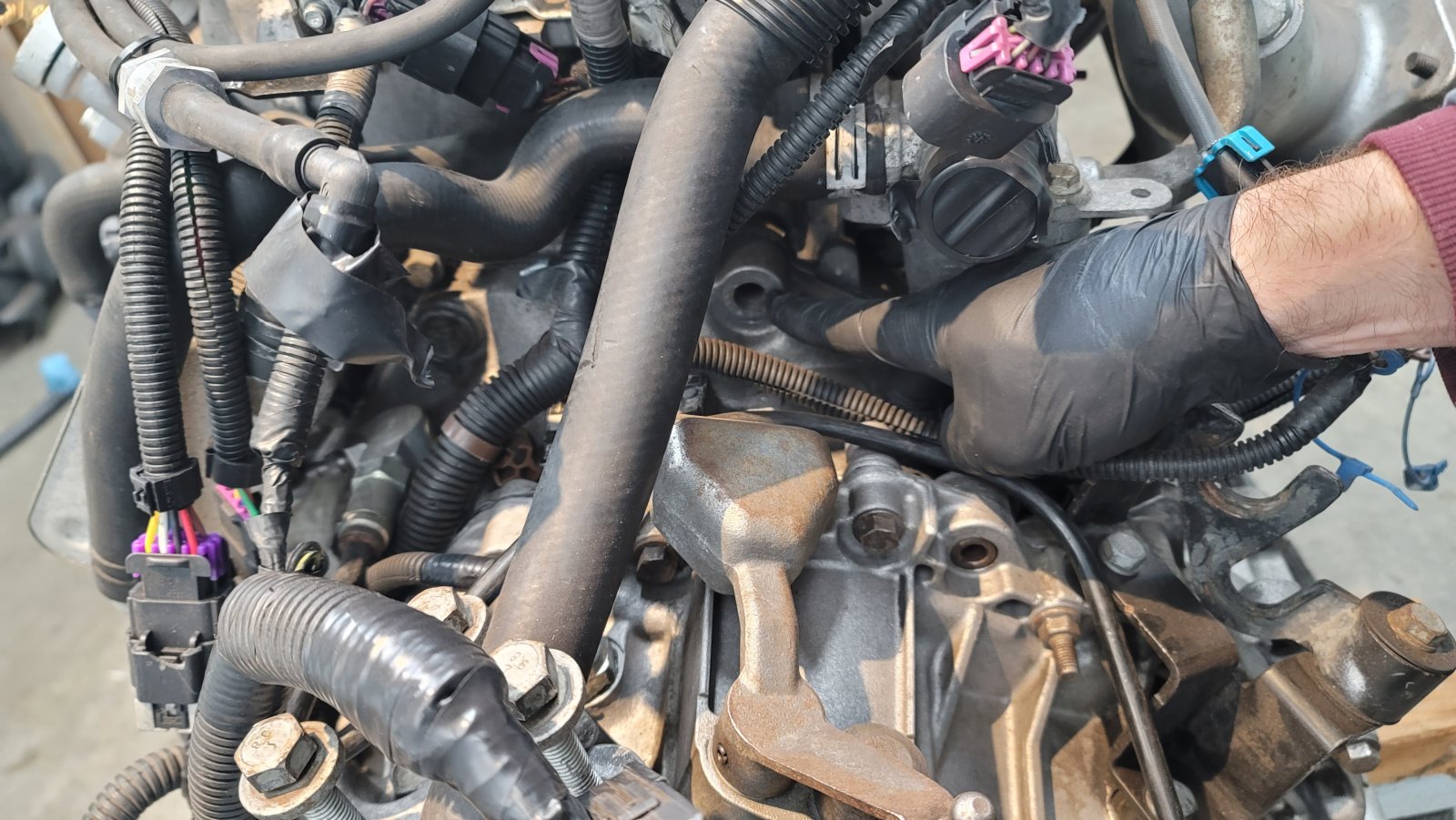

2. Am I missing a bolt here?
44074

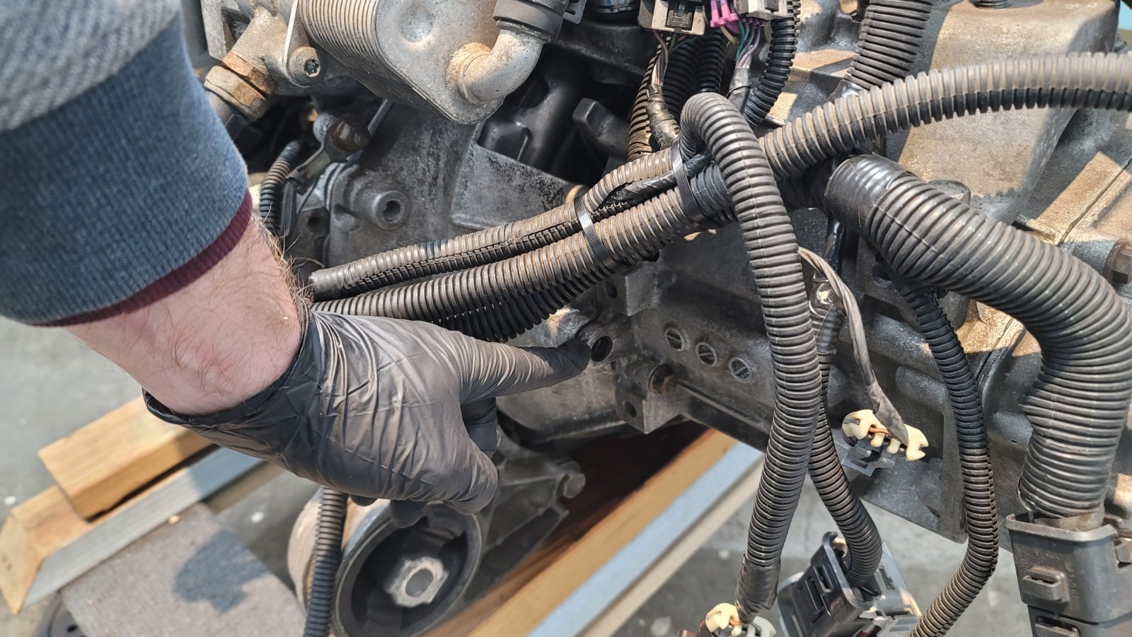

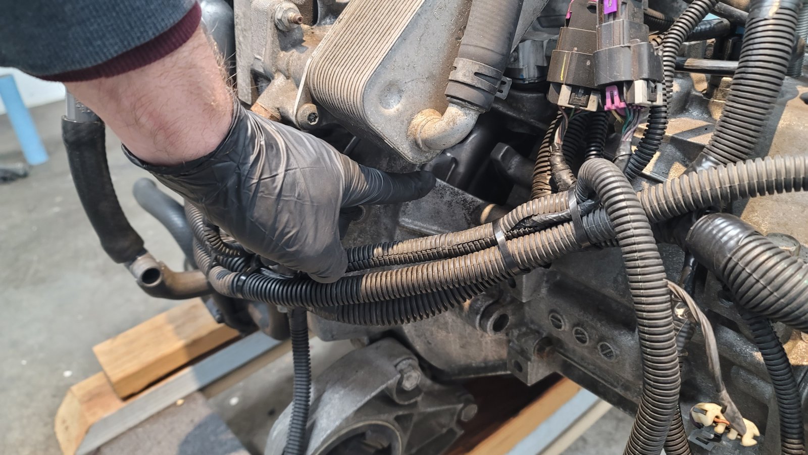

3. Should there be some kind of plug here? It goes straight into the transmission
44075

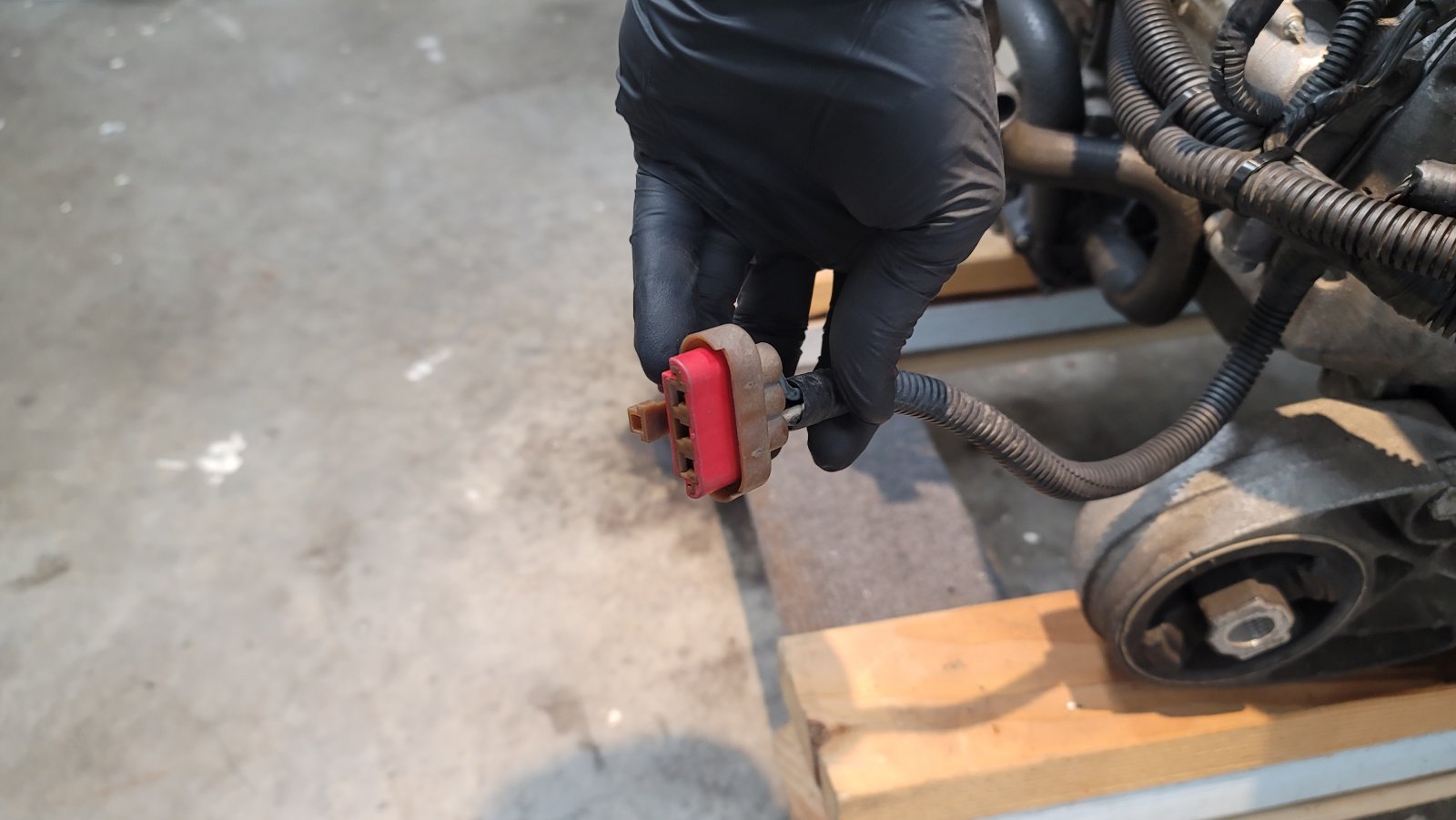

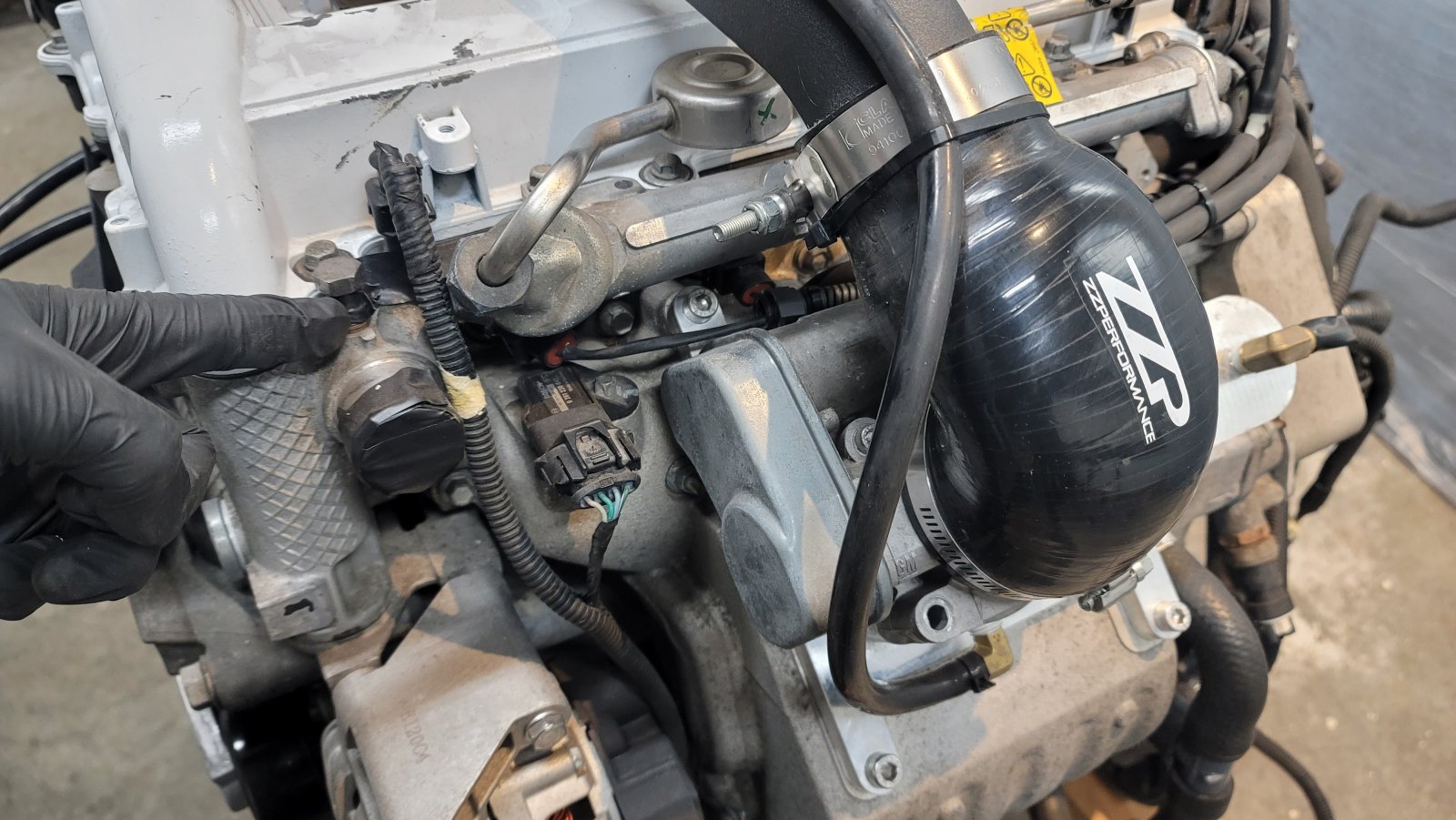

4. This is a second fan plug for the radiator. Can I delete it?
44076

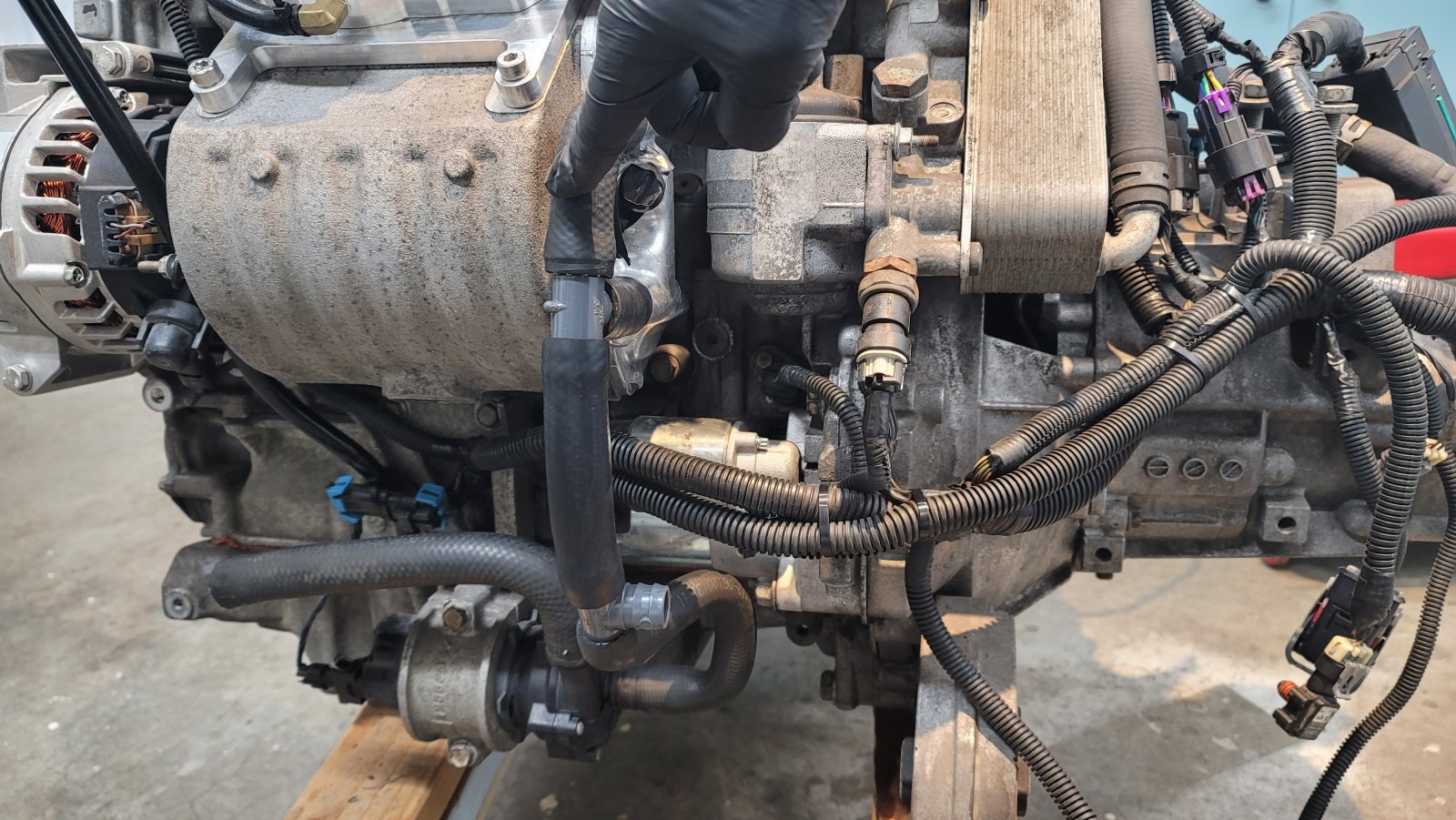

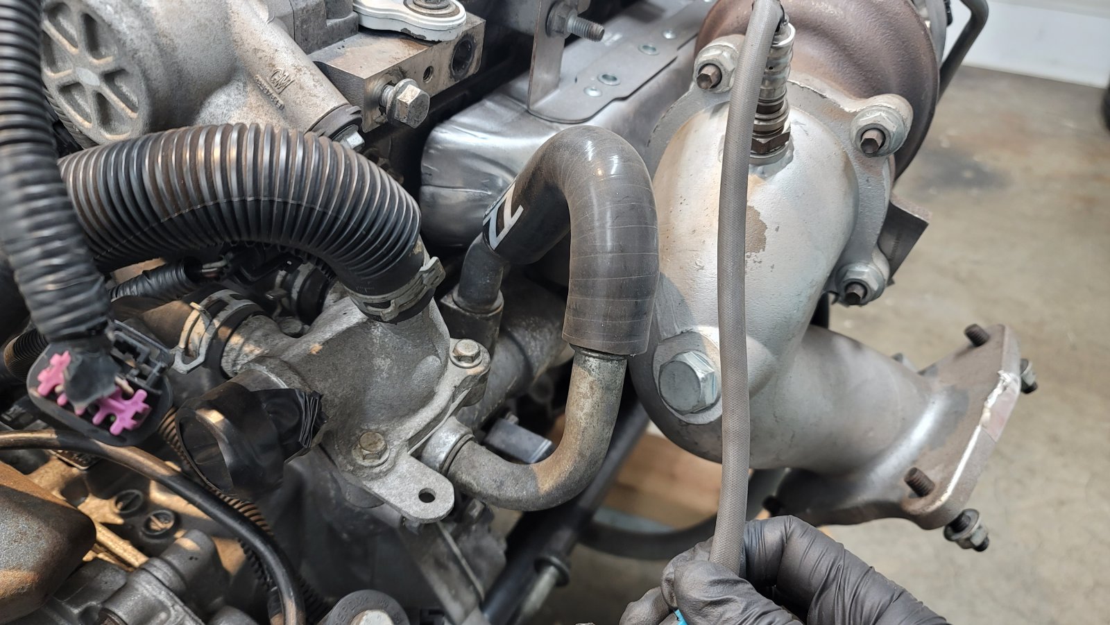

5. I've re-routed the coolant to make it more efficient. I'm going to add clamps, but is there
any problem with the way I've shortened it?
44077

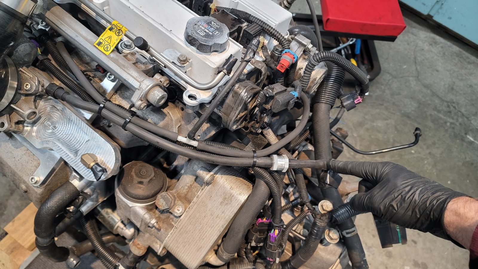

7. Does the EVAP system get deleted? should I remove this line and cap it off?
44080

1. Probably not but you could JB weld it into place and then use different (but close to size) bolt/nut combo to sandwich it. Or, pull the trans, have something welded and drill/tap it. In one of the Goonzquad Goblin videos they did something similar.
2. Yes, that’s the reverse plug switch( I believe).
3. I have an open spot on my trans at the same place
4. Cut it out!
5. I would have the exit port of the pump point straight toward the HX unit for ease of routing.

7. I want to say yes but will let another LSJ-T answer. My LSJ Evap. system is completely removed and plugged.

I believe #2 is a missing bellhousing bolt. I have those and will mail one if ya need it.

Pic #3 It appears to go into the bellhousing. No liquid in the bellhousing area. Sorry, I am not well studies on the F35, but I believe the broken area you show in pic #1 and the area in Pic #3 are dowel alignment holes(due to their size.). These holes had a dowel tube/pin in on one side, it and it aligned the case halves during assembly. They don't always contain a threaded fastener as assembly guide tools are in that position as the halves are bolted together. Please see assembly diagrams to verify this.
