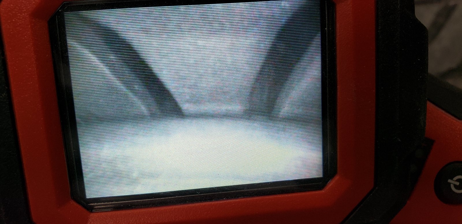

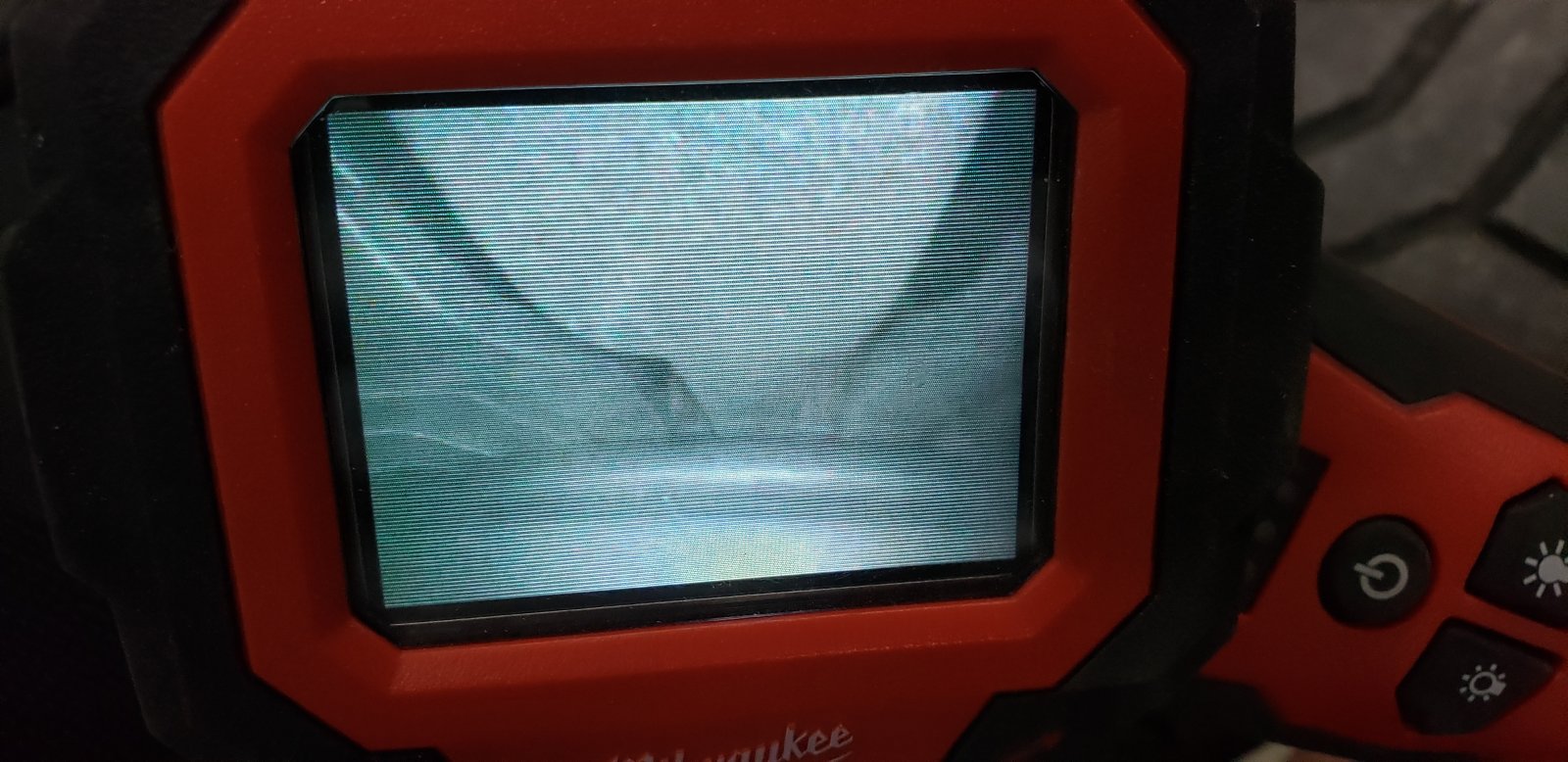

I know this is not a scientific way to measure but it doesnt look like there is a 1/4"+ gap in there.
