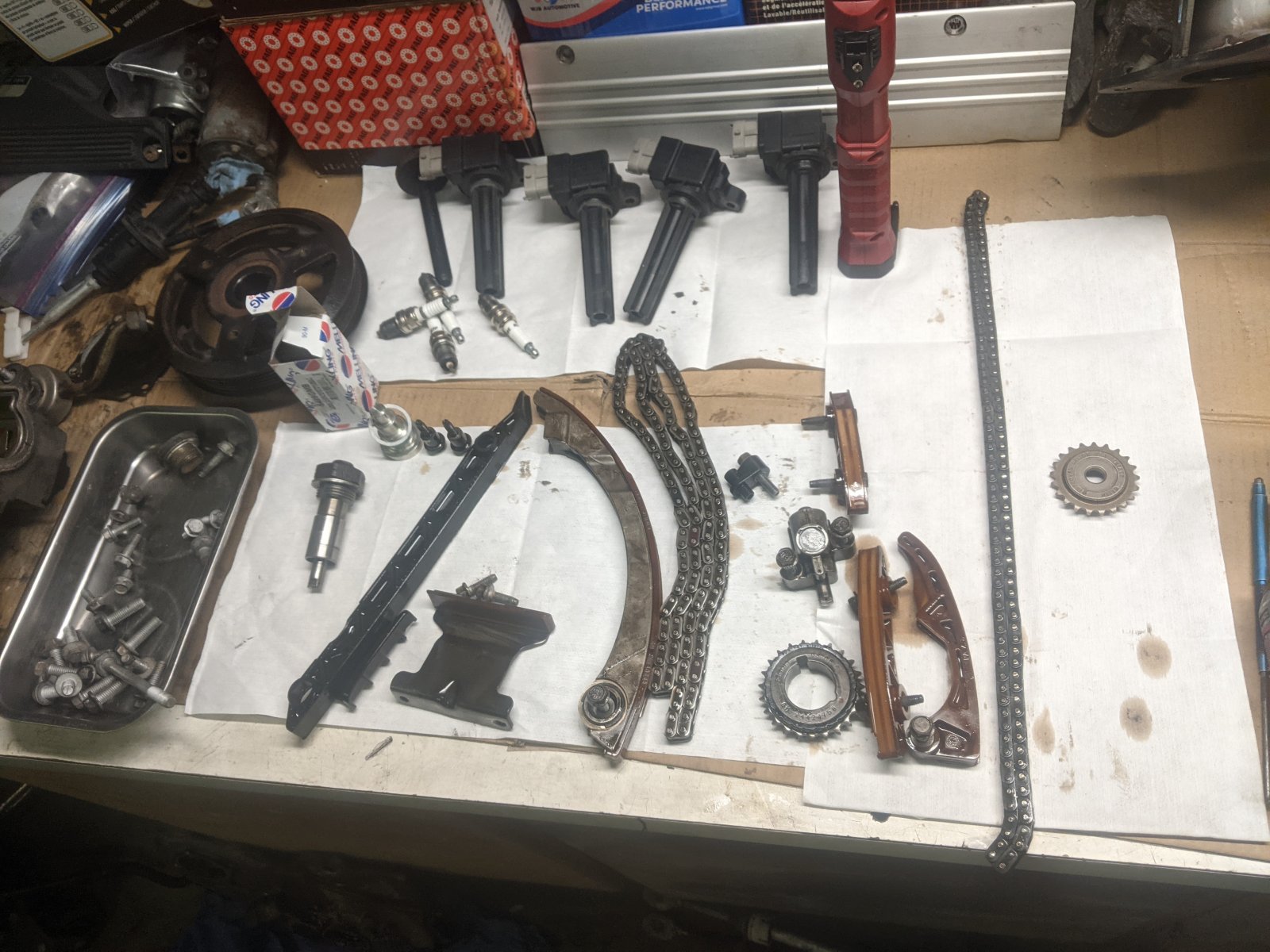

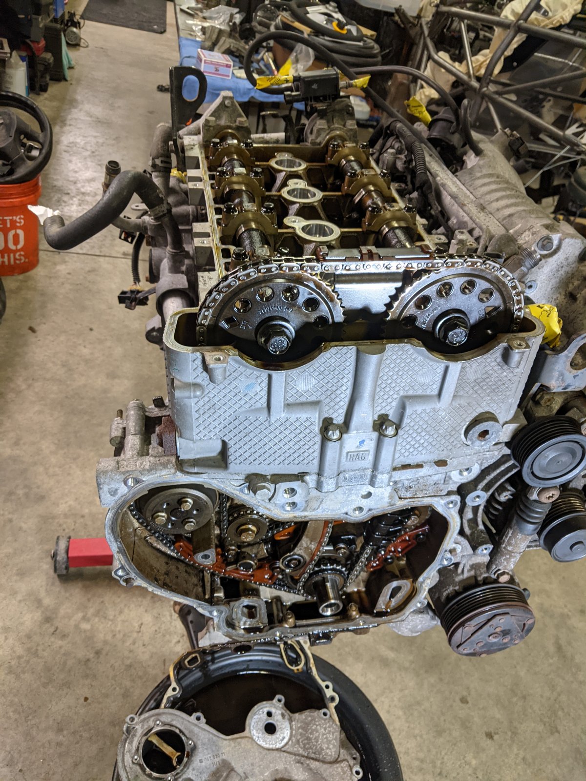

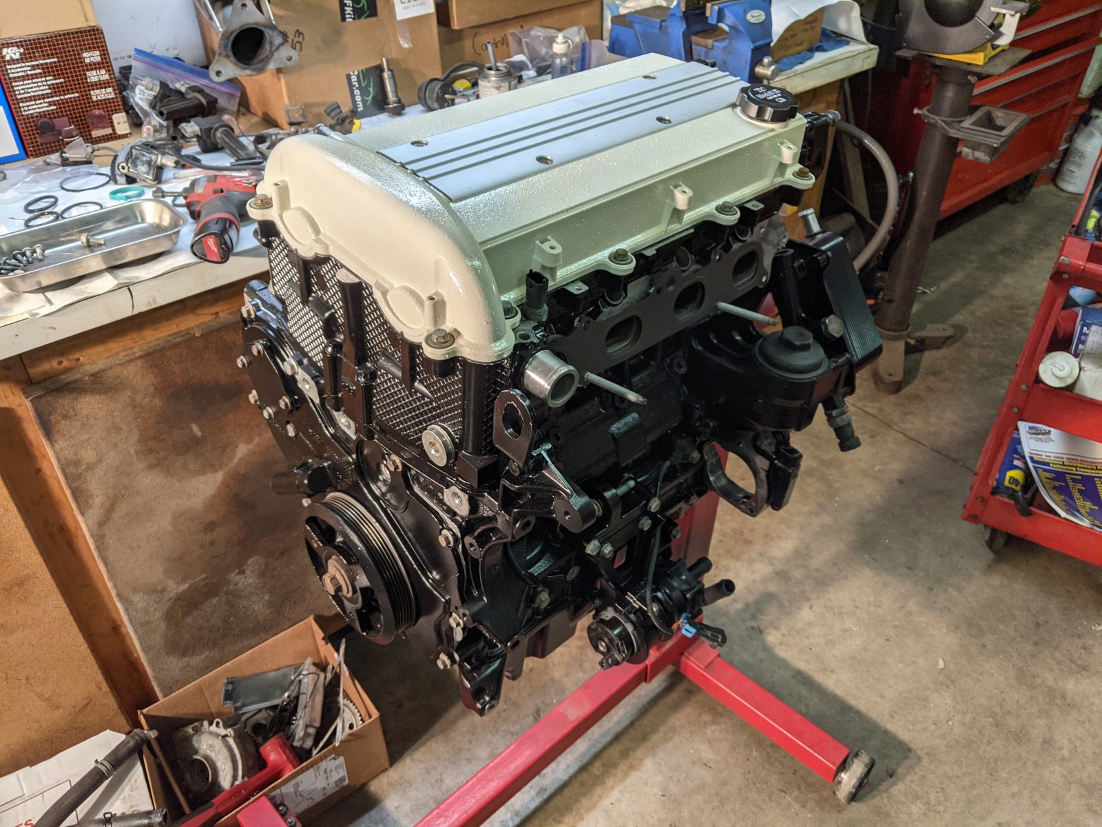

1) Engine torn down for cleaning, painting, and timing chain replacement (turns out, it needed to be done). Had to order the one sprocket my kit didn't come with for the chain. Should be here soon. Also broke off the dipstick tube in the oil pan and can't seem to find a new one anywhere. Has anyone replaced theirs or got a new one? Lokar seems to have aftermarket ones, but not sure on that route yet.

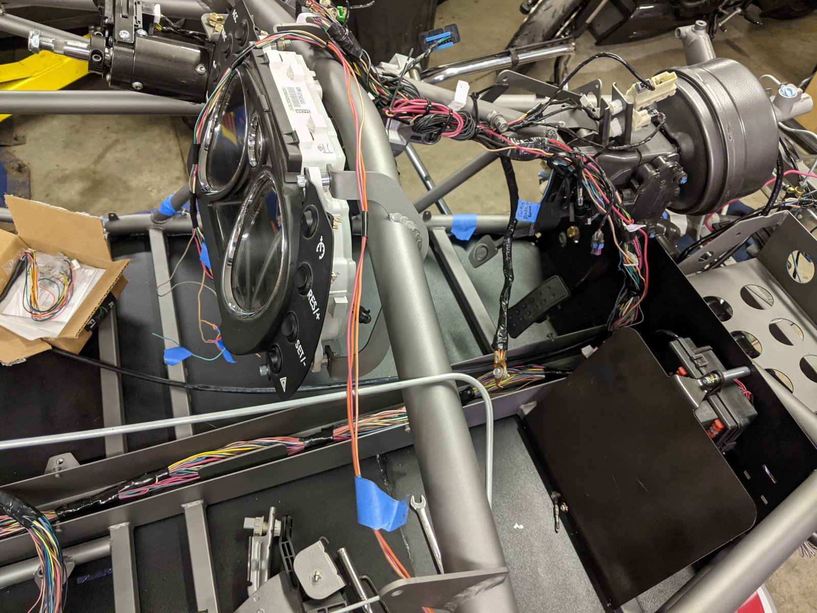

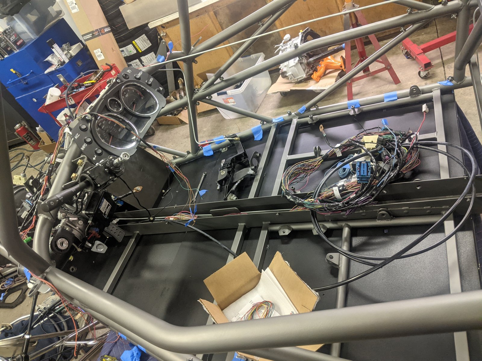

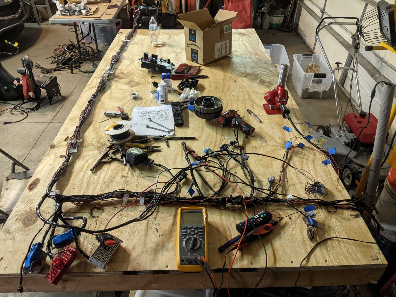

2) Wiring harness up to the the point of doing the dash harness is complete. Maybe finish that this coming weekend. Everything seems a bit tight to shape, so fingers crossed it all fits!

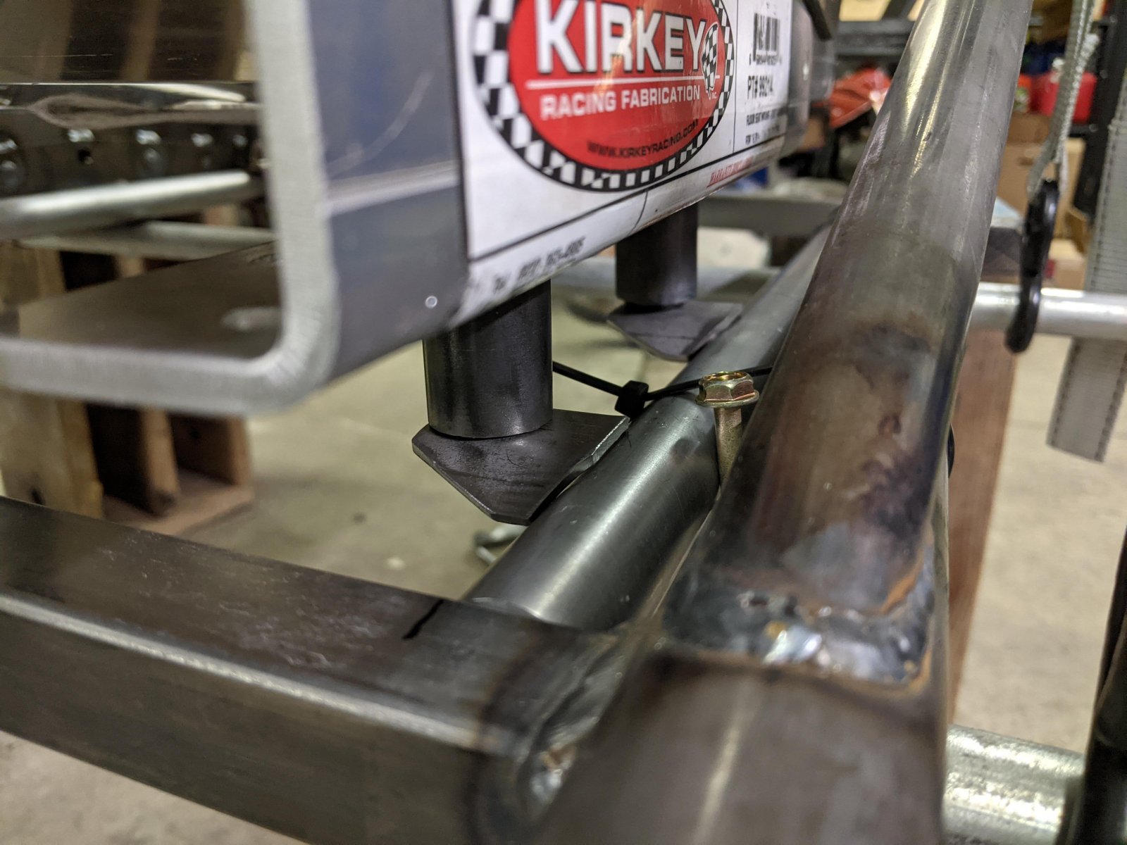

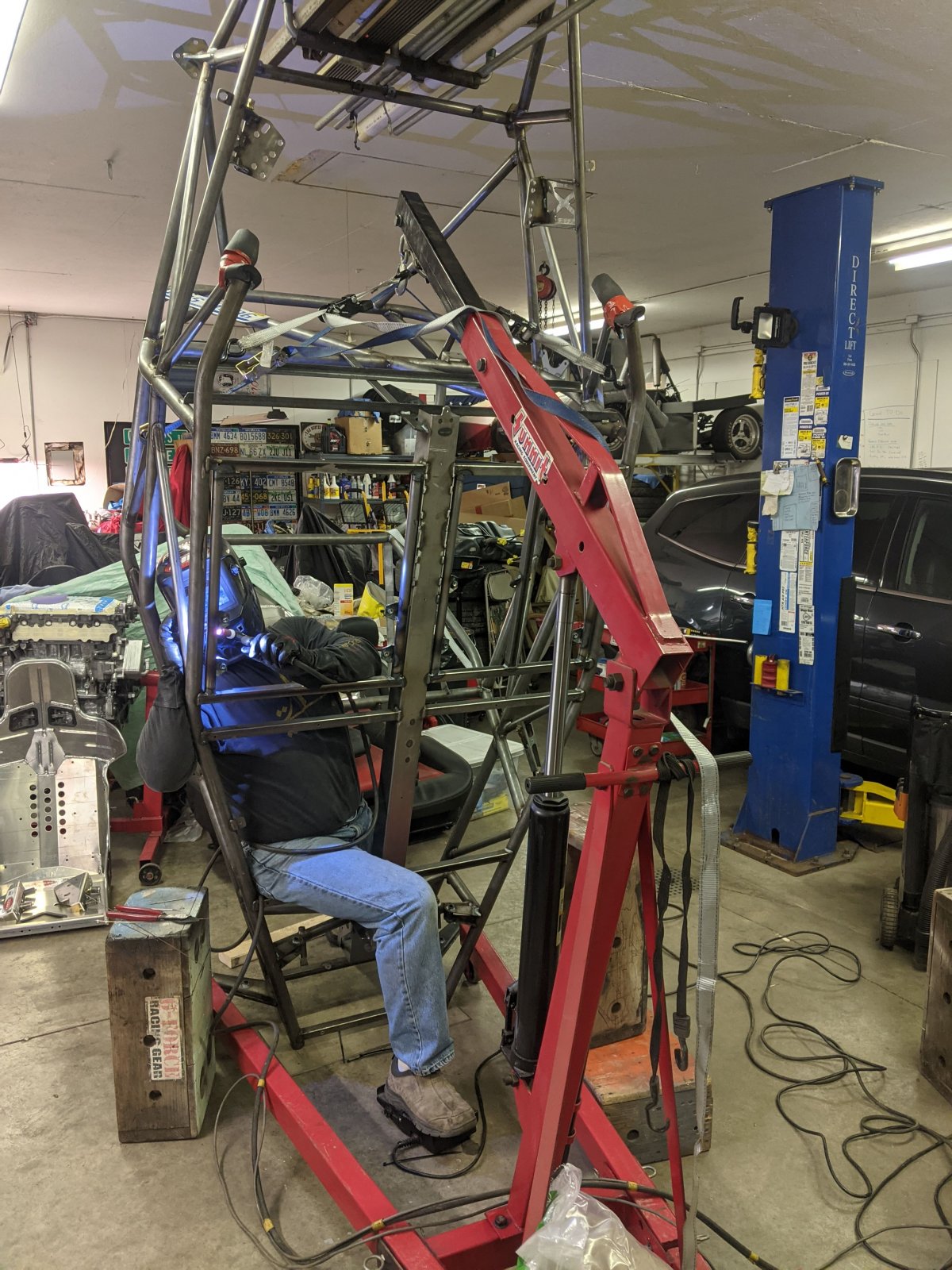

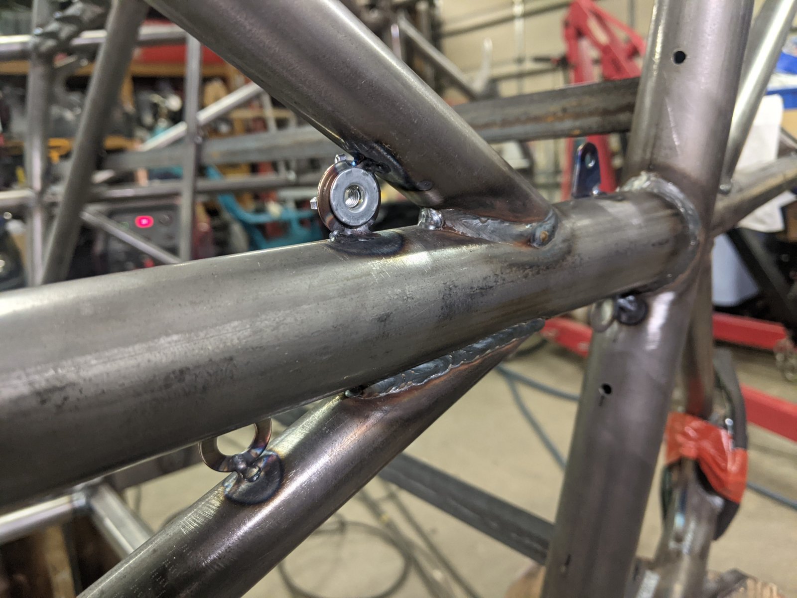

3) Seat mounting strategy more thought out. Have my fasteners and tabs all in hand. Now to strike the arc with the tig. Has anyone had issues with tech inspections and their seat mounting?

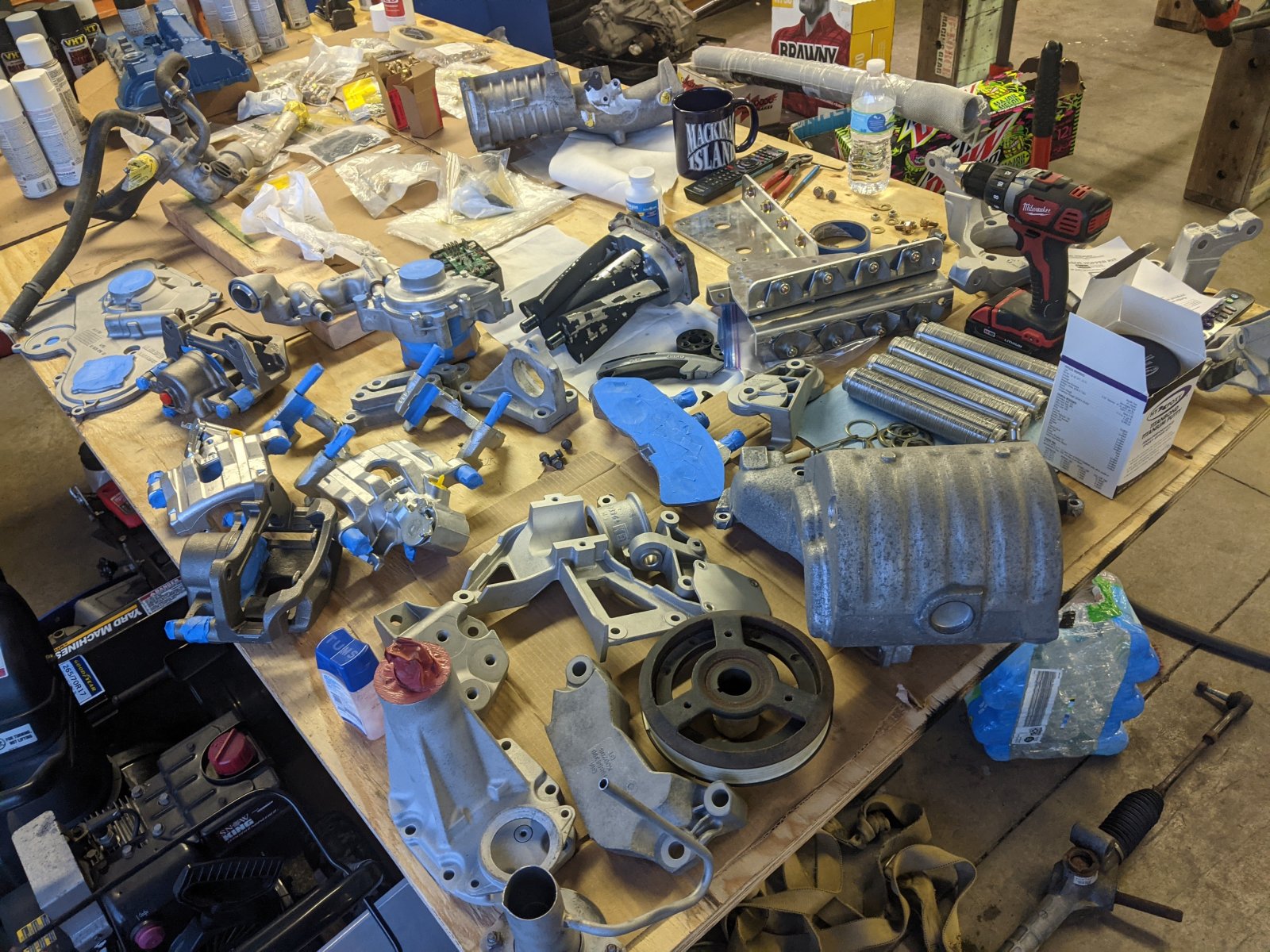

5) Got some media for blasting the small parts for painting. Will be a fun project when the weather warms up. Getting antsy to use this case of Steel-it.

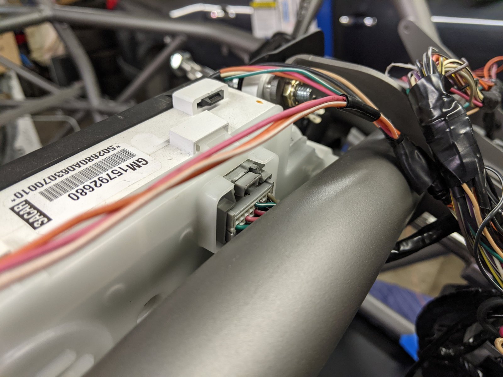

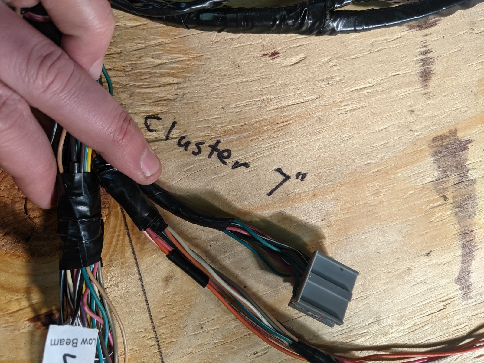

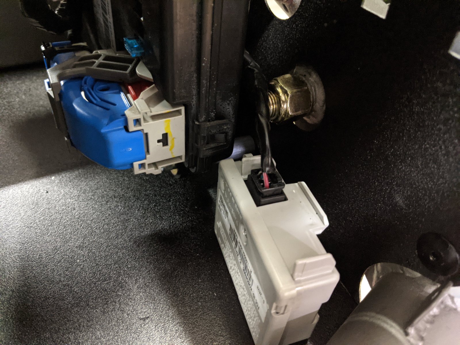

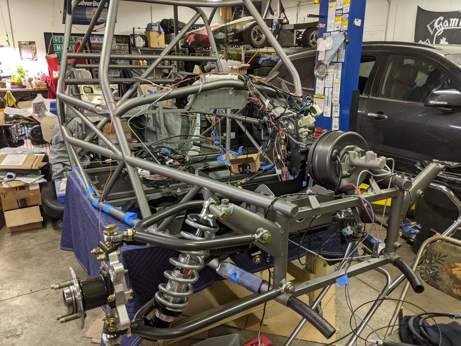

I completed the wiring portion of my harness, but had just one connector that refused to be the 7 inch length called out in the videos (dash cluster connector). I was restricted by the wires running to the BCM, so made it as long as I could (~4 inches). Does anyone have an issue with this connector being too short? I left large sections un-taped just to go back in if something isn't working appropriately. Figure better be safe than sorry!

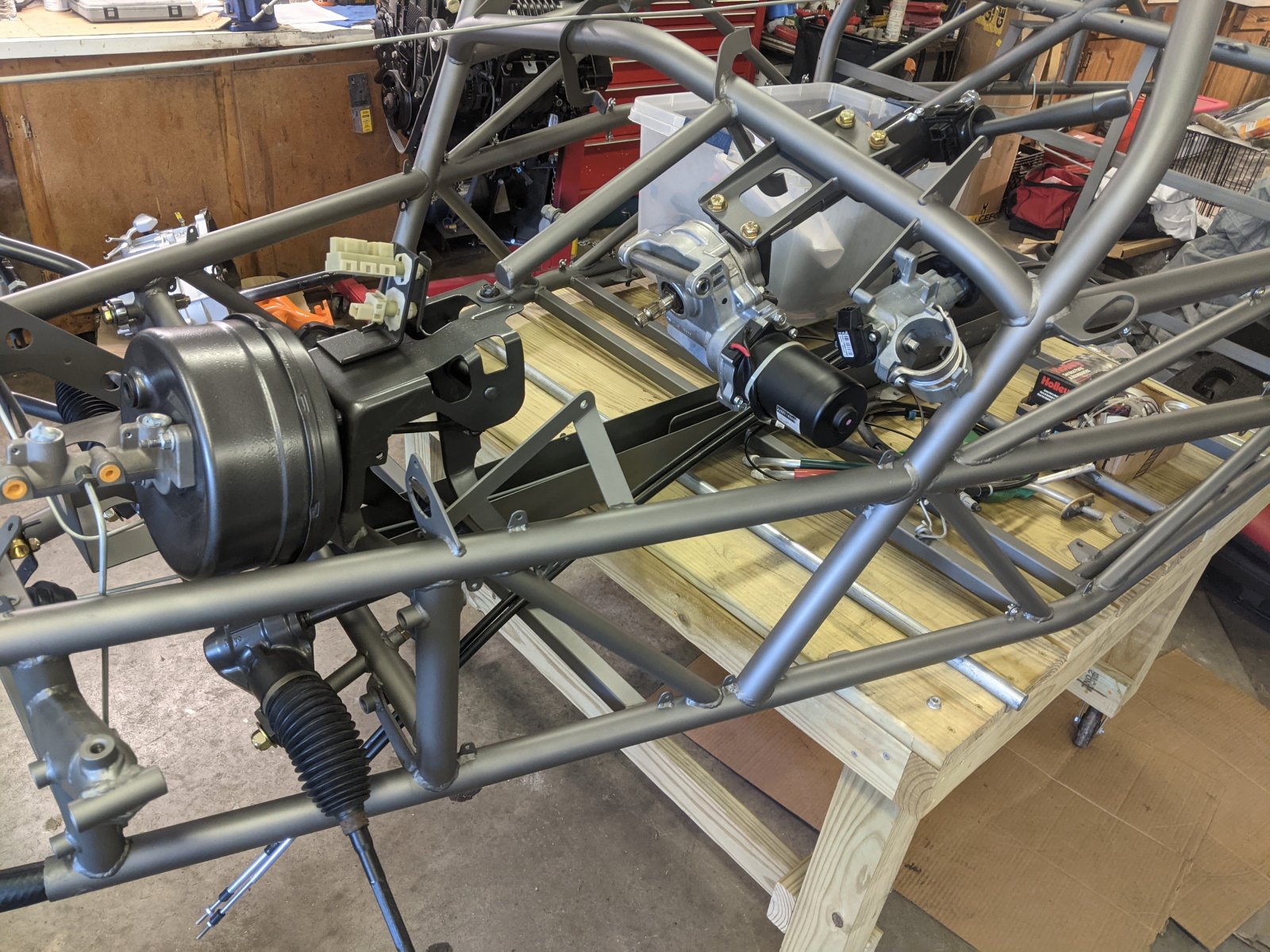

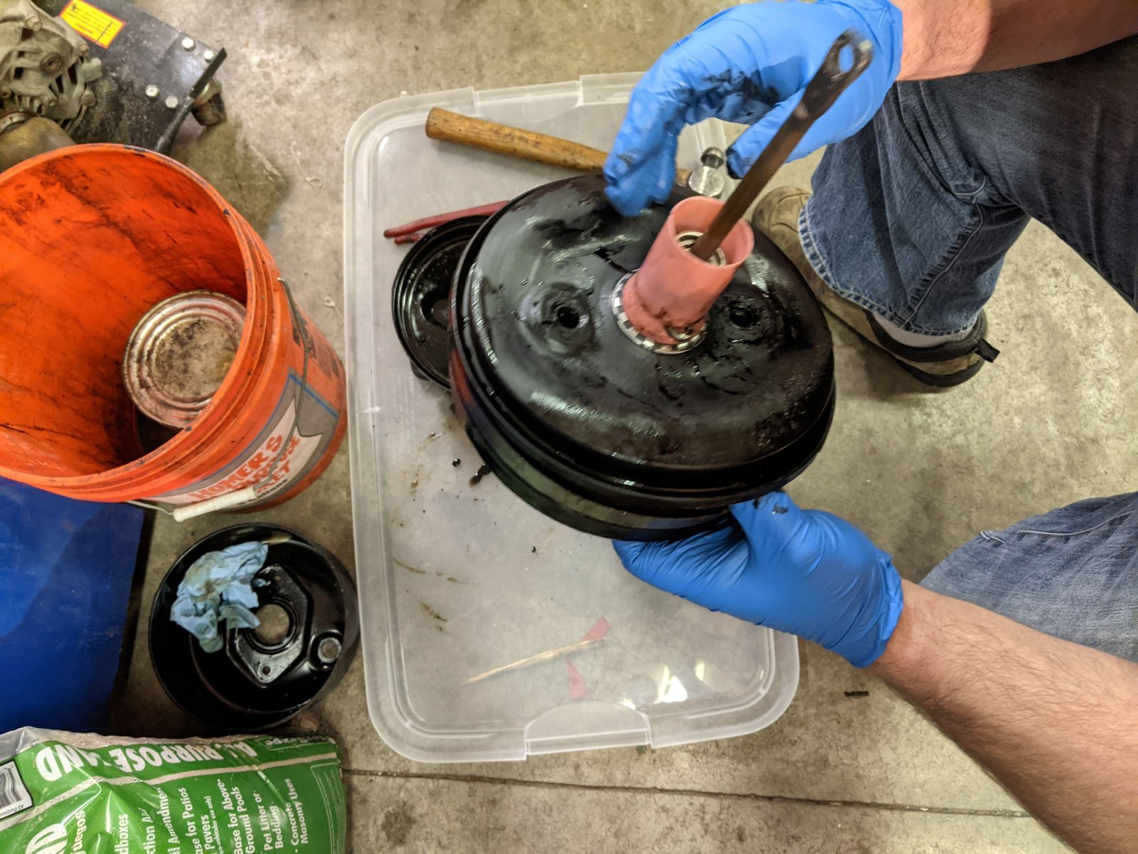

Friend and I took apart the brake booster. The master cylinder was leaking brake fluid into it (bad seal). Nothing appears to be severely damaged, so going to piece back together and try it out. Also, the master cylinder piston was purple... an odd place to find something with that neat detail. I didn't grab a pic, but I will next time I'm out.

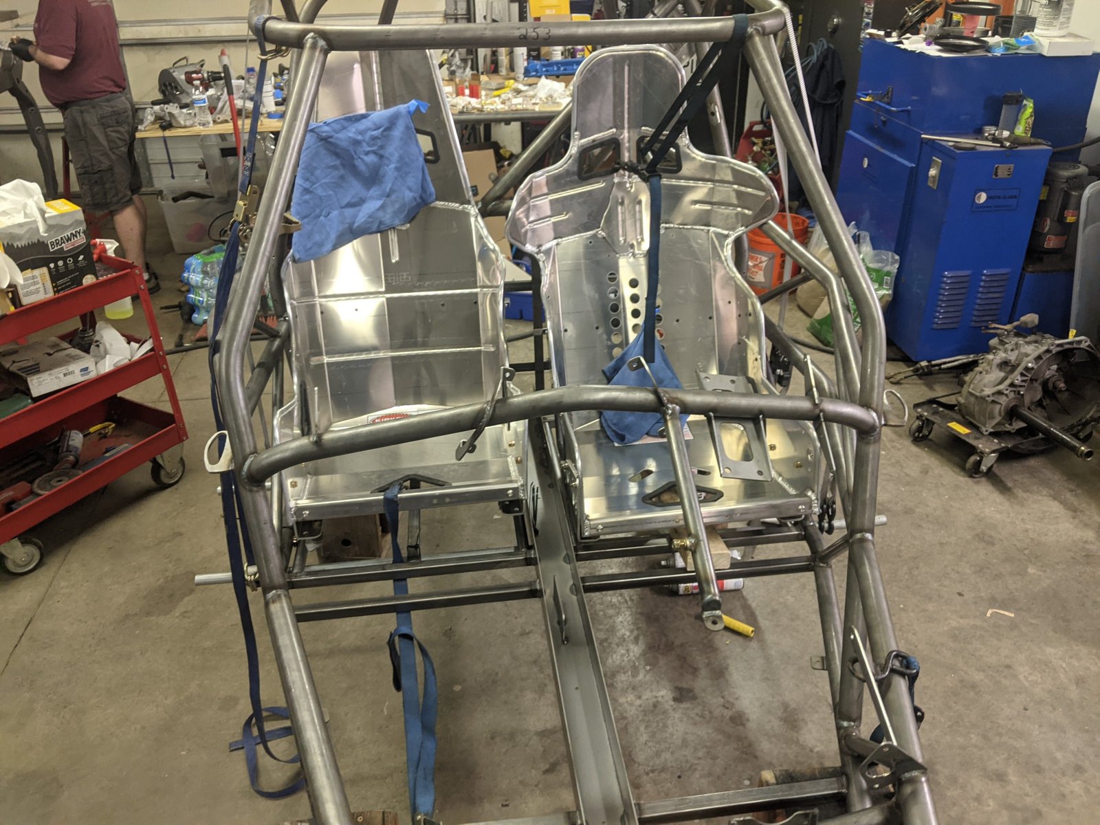

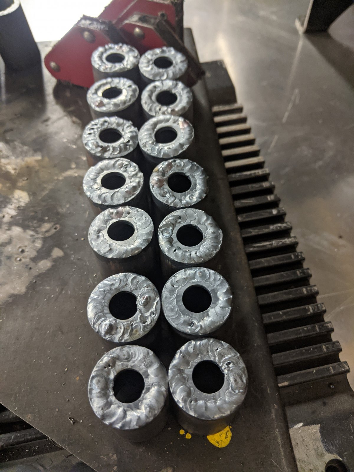

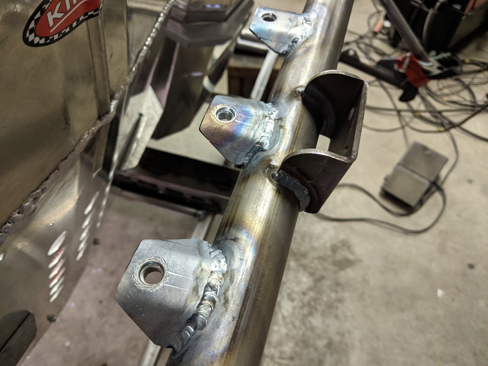

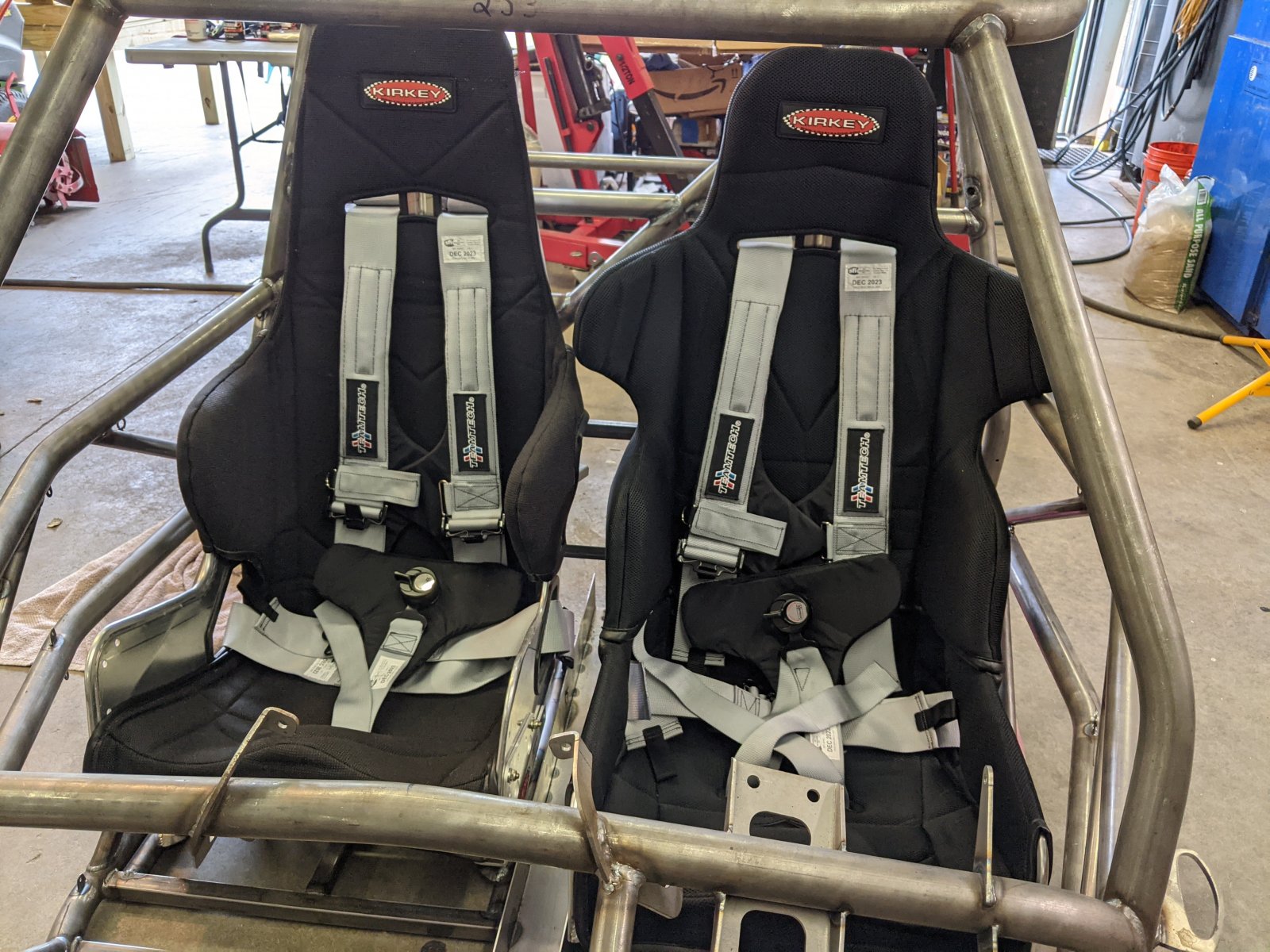

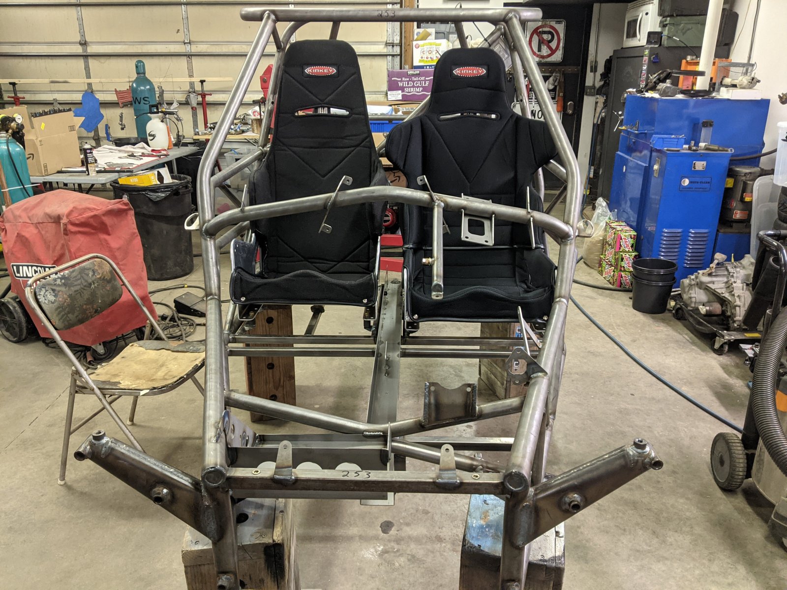

Welded up some more seat mounting parts for my Kirkey seats. Still getting the hang of the TIG, but I think it's coming along alright. It's good practice for when I start on the frame for the seat rails and body mounting tabs I have planned.

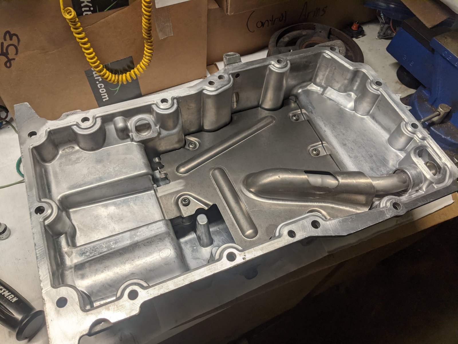

Finally, more parts off engine to continue cleaning. Oil pan came off to get the broken tube out of it. Going to use the current tube rather than an aftermarket one for now. Supercharger came off to inspect the rotors and clean the intake. Some of the factory coating came off the rotors and was in caught in the laminova coolers, so had to clean those out. Recoating the supercharger is a rather pricy endeavor, and may not be worth the cost/benefit to me for the moment. I still have hopes of a turbo in the next year or so. Had the final timing gear show up, so this thing can start getting bolted back together!

There’s a lot of parts that are oddly painted on a vehicle, this is so you know it’s a factory part vs a replacement. When you work at a dealer, this is key when replacing parts under warranty and something doesn’t seem right.
My master cylinder piston was purple as well, I suspect it's similar to the information linked below. Basically, the part has to be anodized, so why not anodize it in a color, particularly when the color indicates that the part has been anodized versus a non-colored application where it's not visually apparent whether or not the part has been anodized.

That's so odd, but so cool. Neat I'm not the only one who noticed too ha! I can see it being a service indication and/or a manufacturing one. I am just continually surprised at some of the things I come across in tearing this car apart.

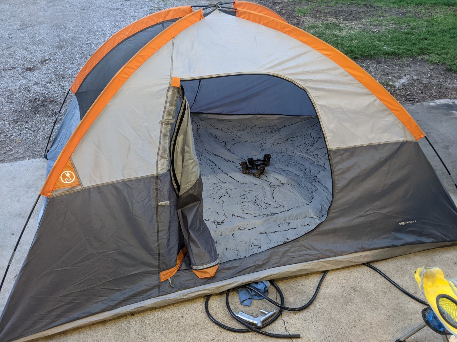

Sandblasted a lot of components to clean up for painting. Amazon basics tent was a real trooper keeping everything contained. Anything that didn't need blasting was cleaned and masked off well for spraying. Did spray the cradle as one of the few blasted steel components. I love the steel-it look on it. Makes the part look brand new! Weather didn't cooperate for all of the painting itself, but it will be in due time.

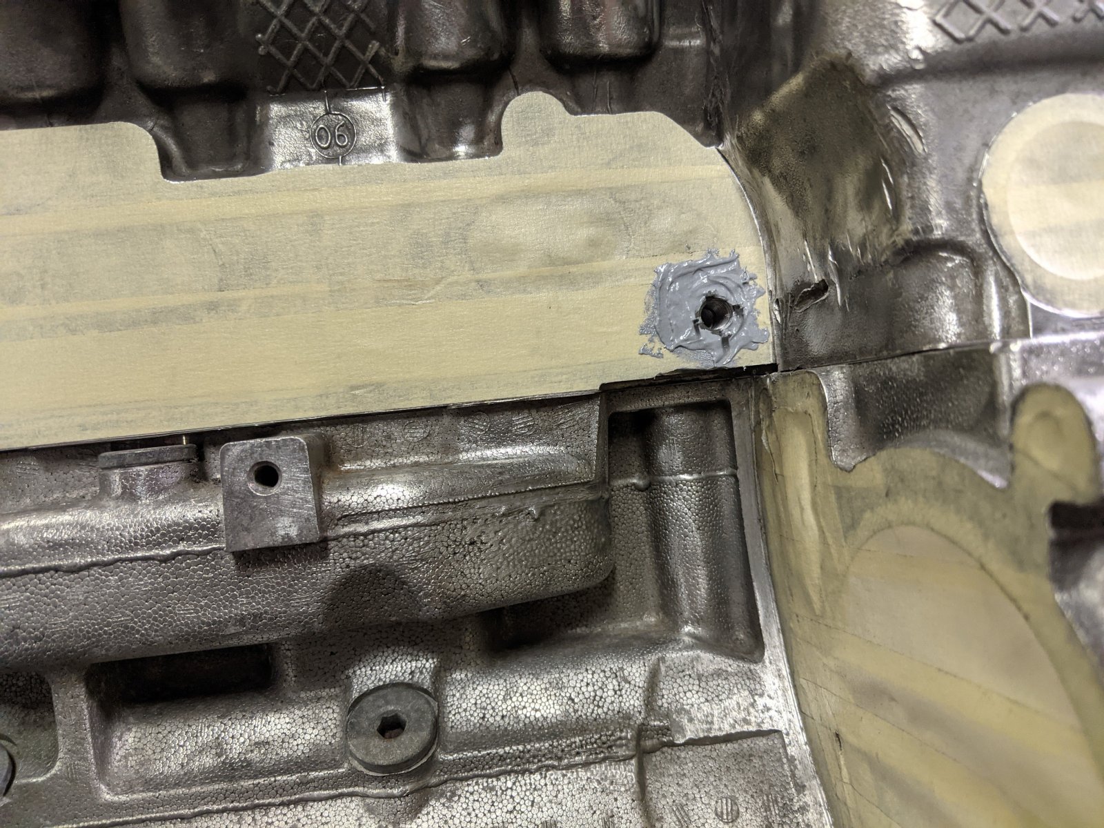

The engine is still pretty open right now in order to fix a bolt on the back side of the exhaust manifold. Essentially going to take a threaded insert and make it fit. It's in a really tough spot near the water pump housing, so hopefully it goes smoothly. Once it's in, then its time to bolt everything (hopefully painted) up again.

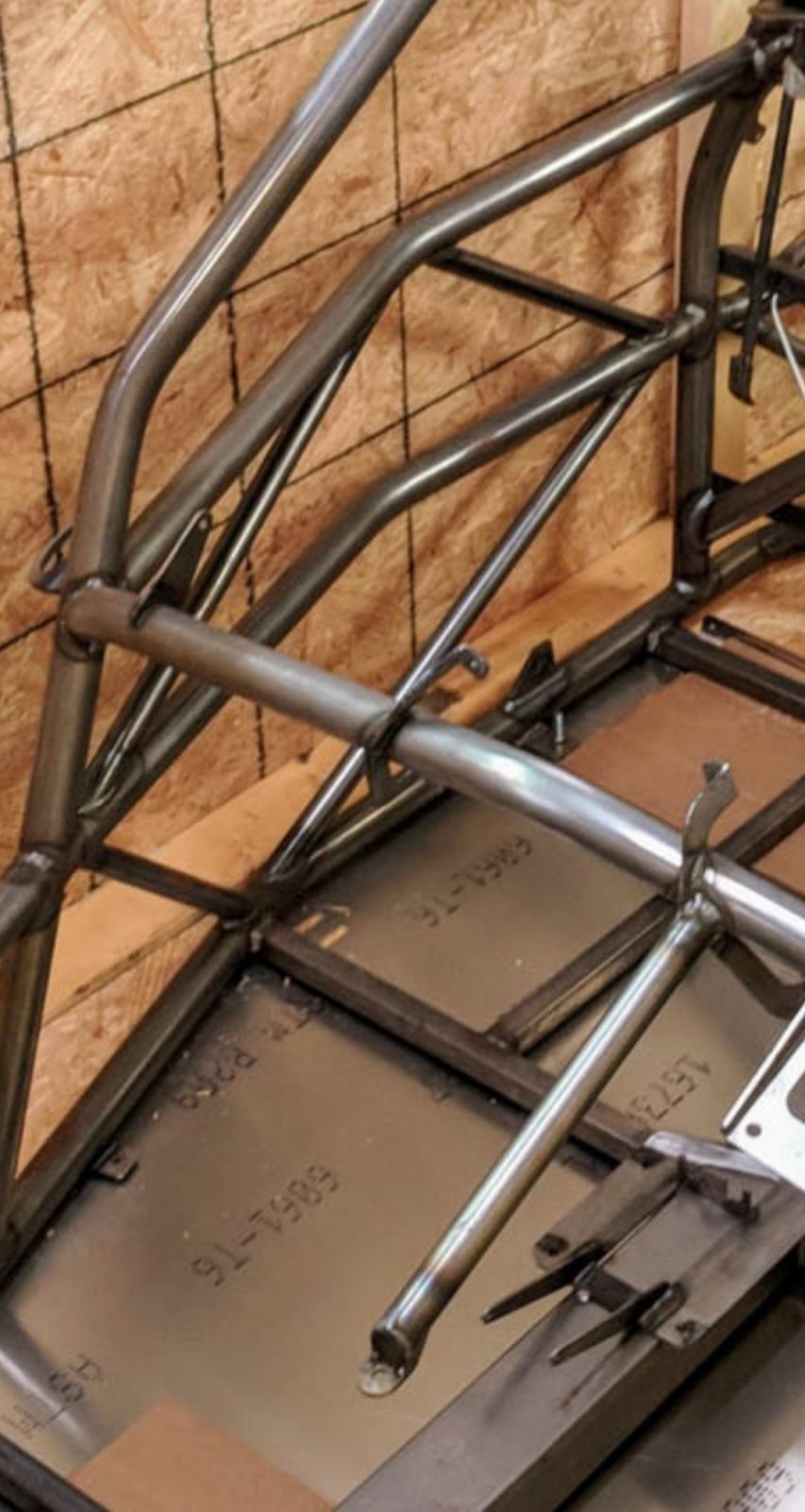

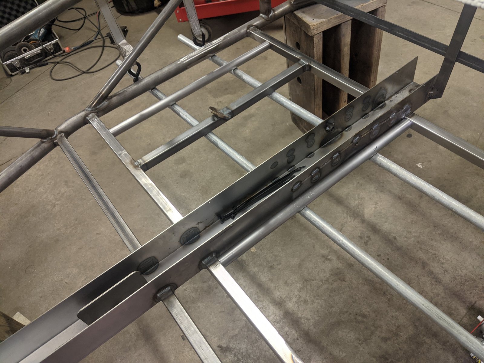

Cut and mocked up new seat mounting tubes. Had to get rid of a few tabs on the body itself as well. Hoping to get them welded up in the next few weeks along with all my body panel tabs. Should be a fun few days of work. After that's done, and with the weather being much more consistent, the frame will be ready to paint. After seeing the cradle, I can't wait to see the whole thing in steel-it.

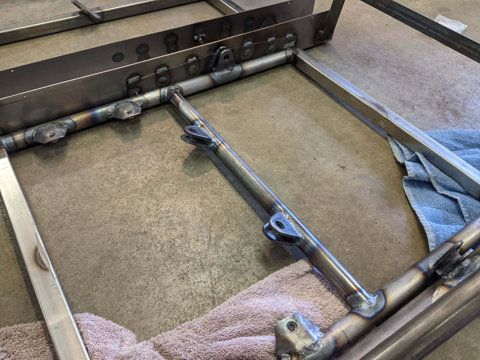

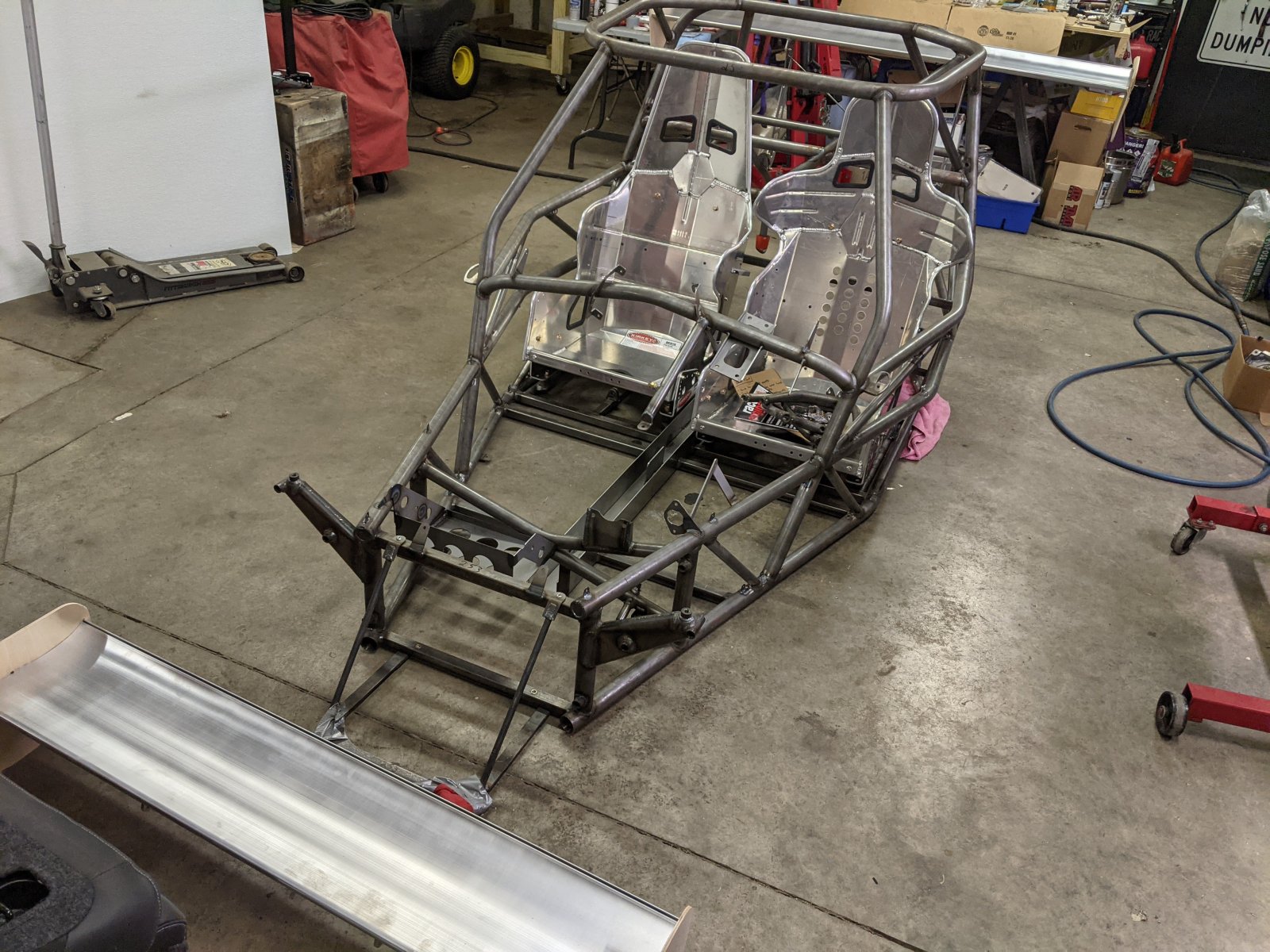

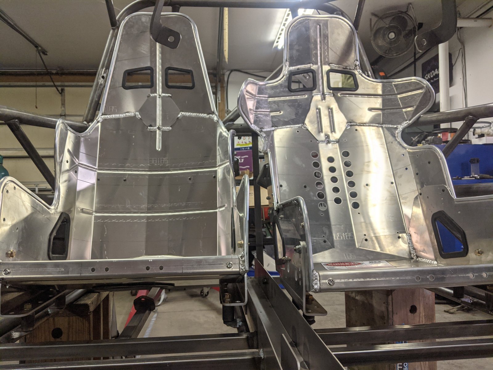

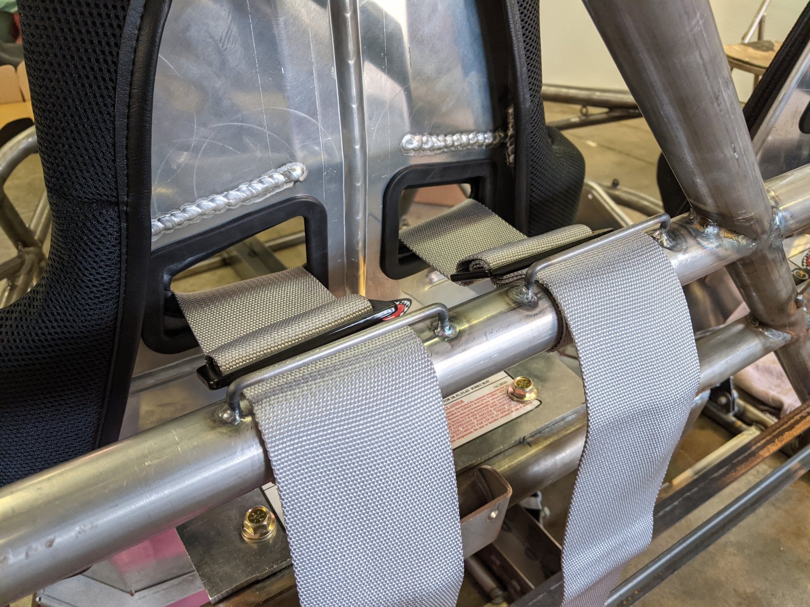

Welded in seat brackets for the driver/passenger seats. Had it all fit up to where I am comfortable, so it should be a pretty good setup. The base is quite stable and easily removeable for any future modification/maintenance. Now with the seat bottom in place, the back rest portion needs to be welded and fixed into the appropriate spot. These seats will be very well attached. I do need to get myself some harnesses and the appropriate tabs/eyelets for the next placement/fitment. Once those are in, the majority of the welding will be taken care of.

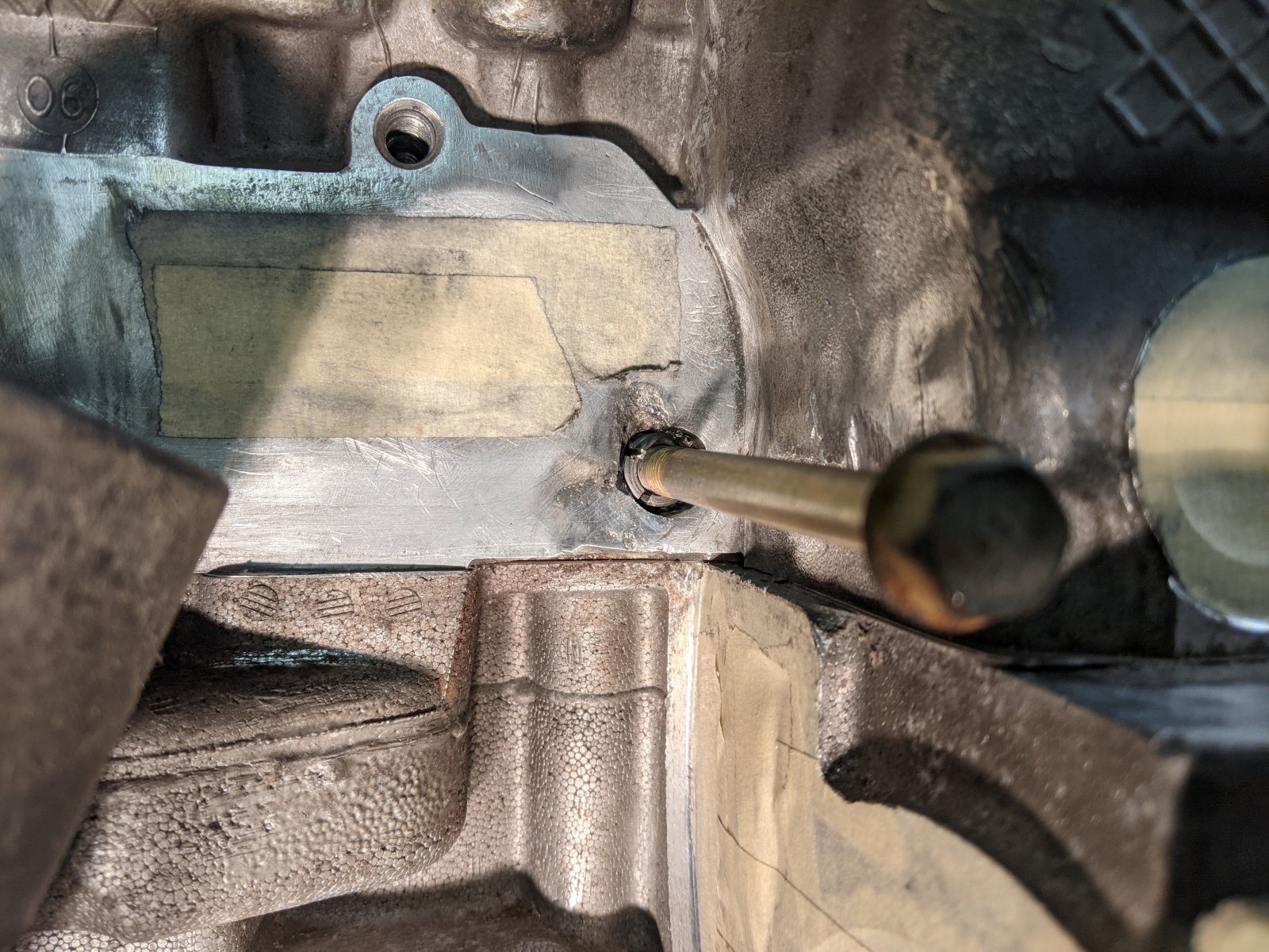

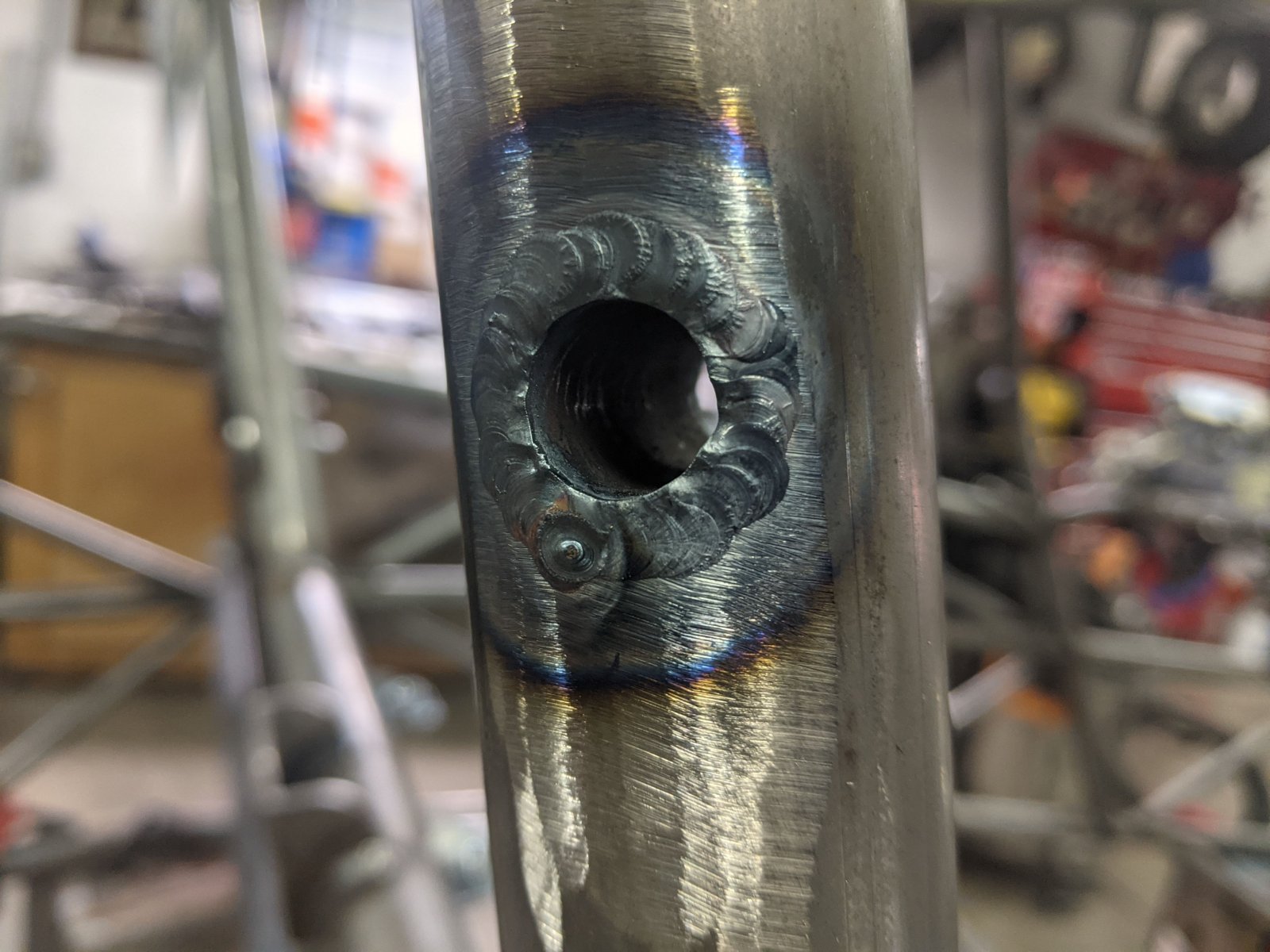

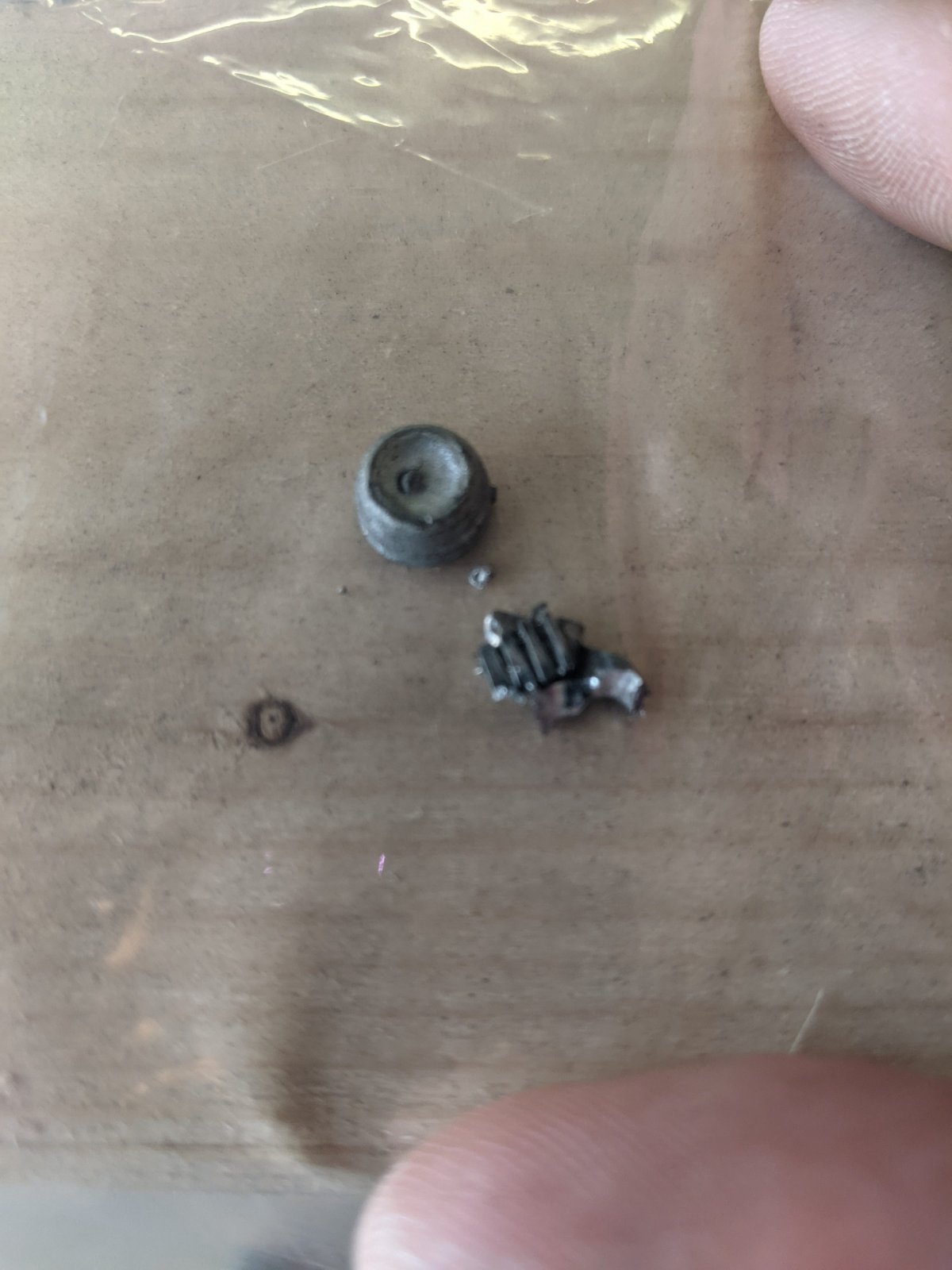

The exhaust stud hole that was a major issue in the head. The end of the hole actually still had a broken off tap and the end of the original exhaust stud stuck in the aluminum. I'm just happy they came out in mostly one piece! I'm sure there are some stories here, but hopefully I can bring an end to it. Ended up using a metal type epoxy similar to Devcon in order to "glue" in a threaded insert. Since some original hole threads were still in the head, I was able to bolt everything in line to hold true in the original location for the epoxy to cure. Now, just a bit of material cleanup and it will be good as new.

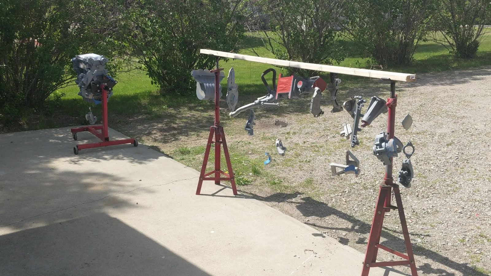

Weather hasn't cooperated enough for paint yet, so that will be the next big step. Got all the parts prepped and hanging, ready for spray. Hoping to have all the bolt on components painted first and then the frame once welding is complete. This car should go together quite quickly after that point.

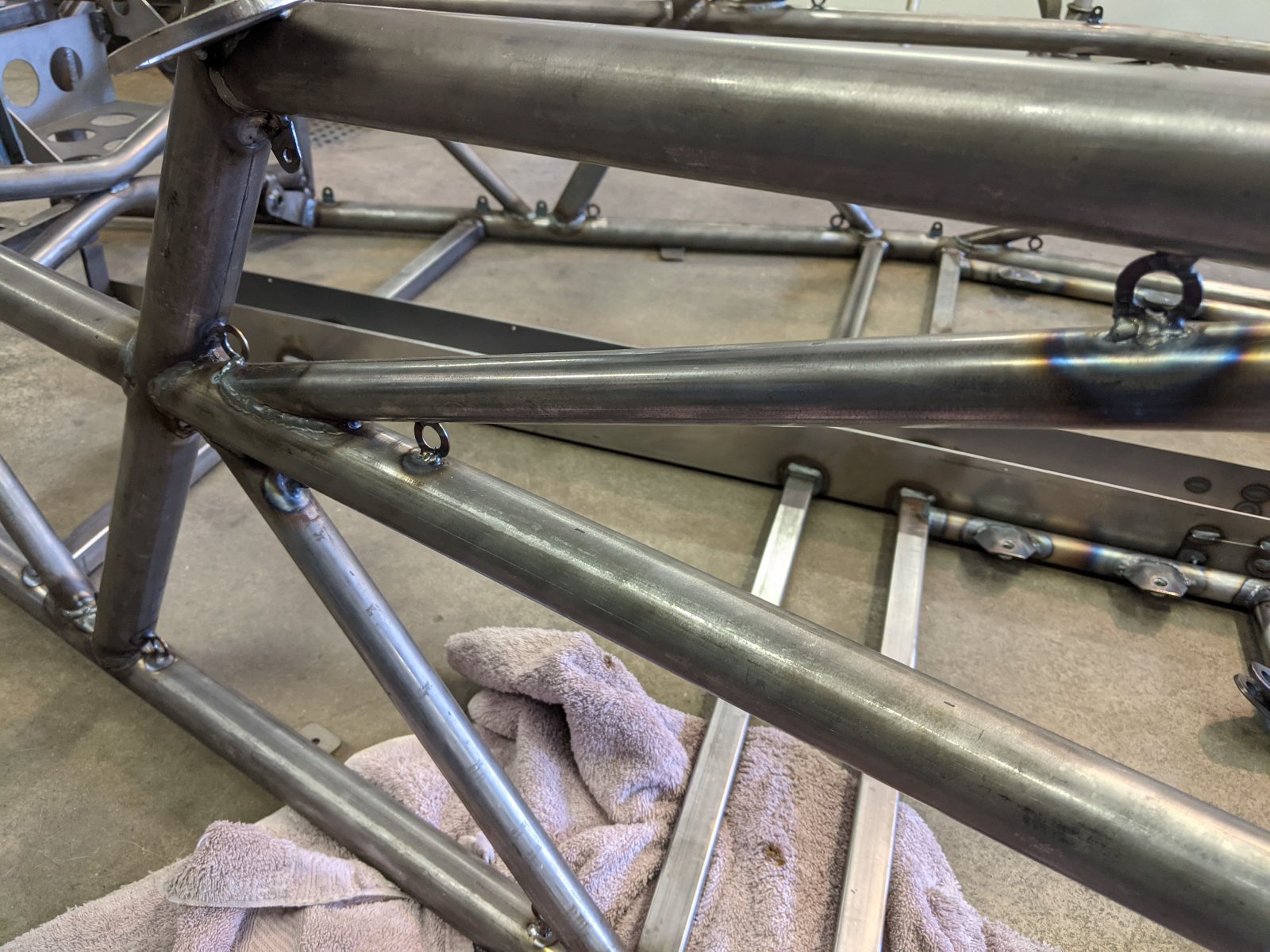

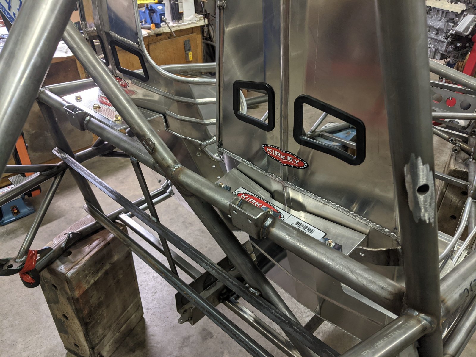

Completed welding in my seats, which are basically now a part of the chassis. After getting to sit in both passenger and drivers sides, the connections feel solid as a rock. I can't wait to see how they feel in an autocross event. Since I'm not using the stock d-ring seat attachment in the roll hoop, the welded in tubes were cut down and welded flush to the roll cage. I think they may still make for a good go-pro mount of some sort.

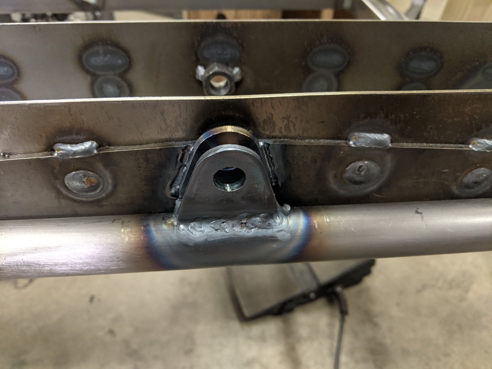

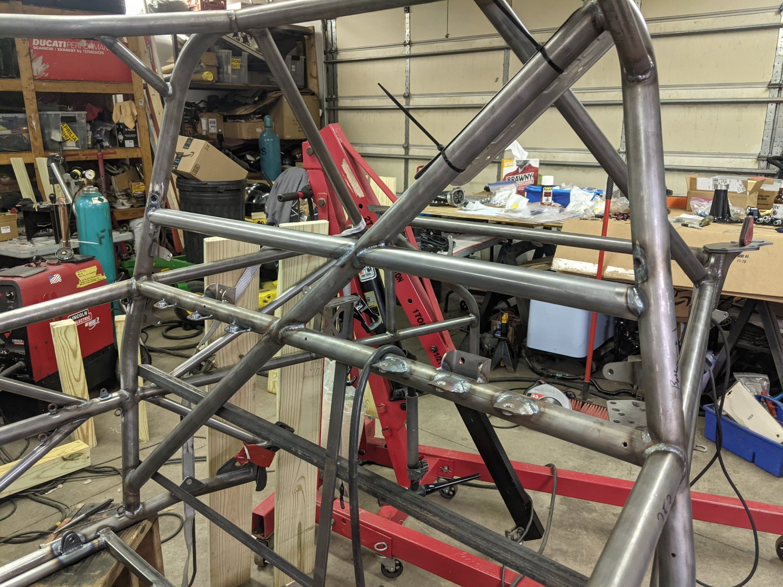

I also started welding in mounting tabs for my body panels. I thought my plan was pretty original, but then saw DCMoney and I think on a similar wavelength... ha! I'm excited to see the finished product, but for now, I'm loving how the tabs are welding in and fastener pieces are fitting together.

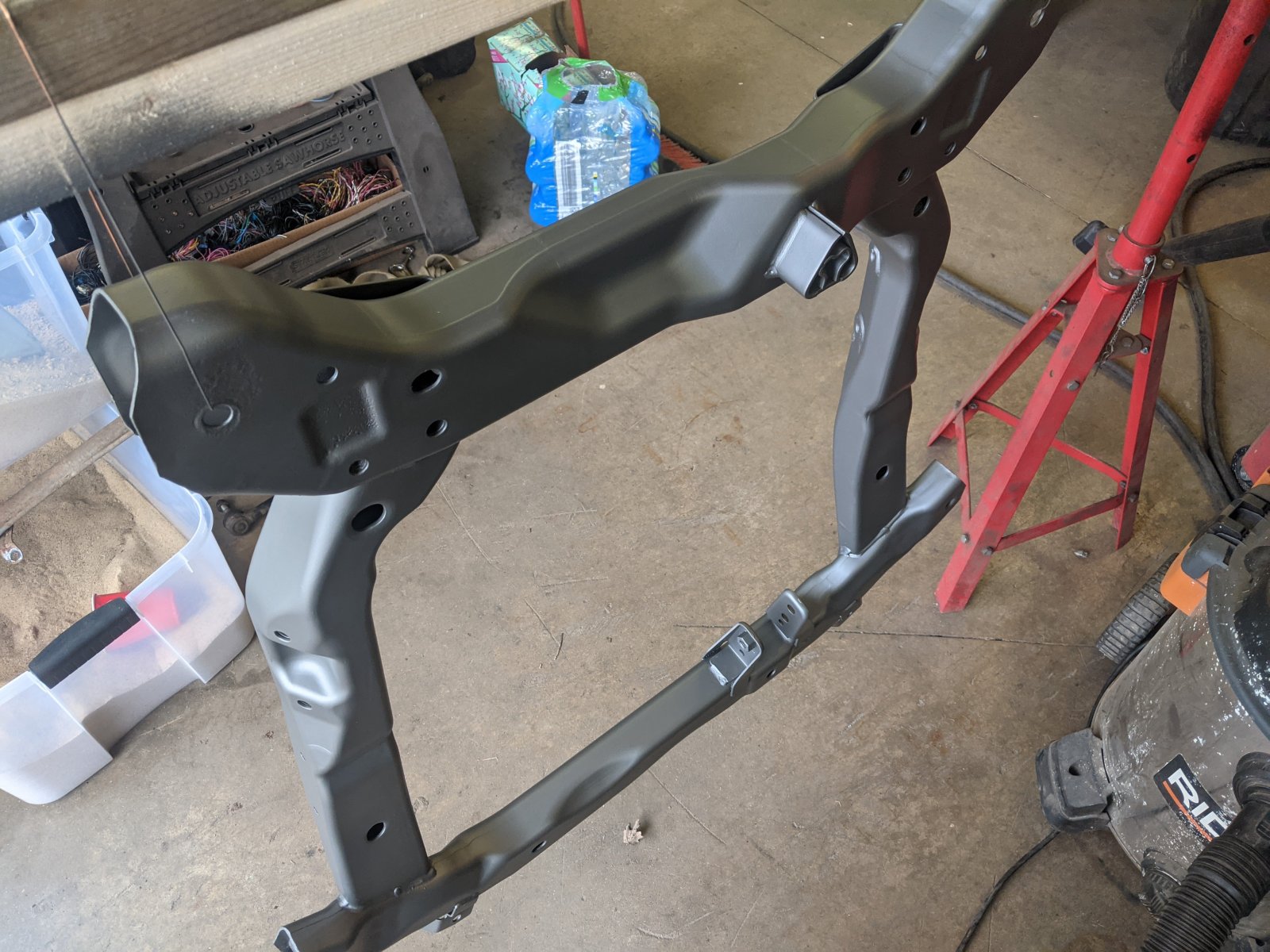

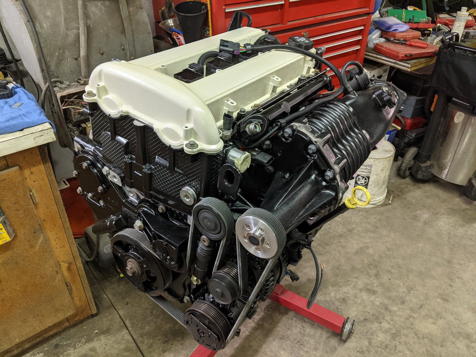

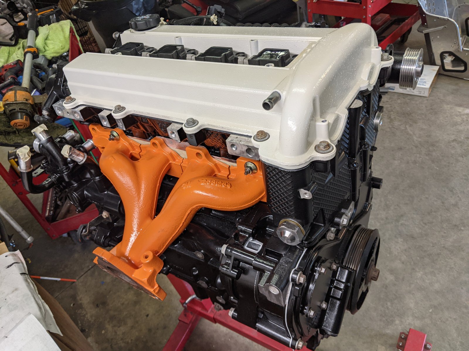

Engine is mostly together again after being cleaned, timing set installed... and painted! I think this will fit in the future color scheme(s) quite well. I can't wait to see it in with all the other parts.

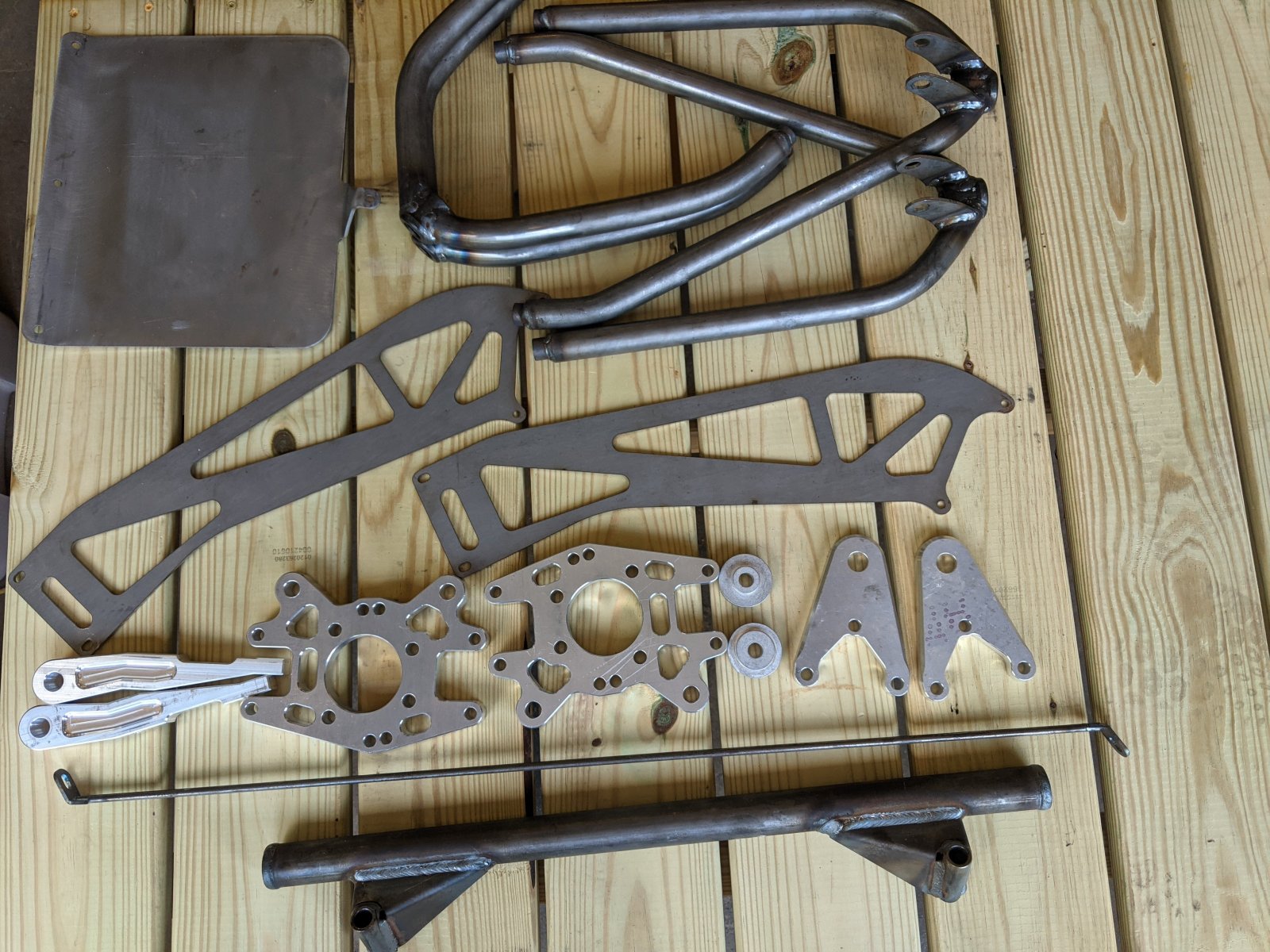

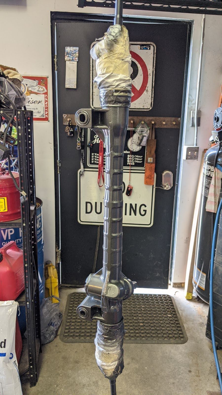

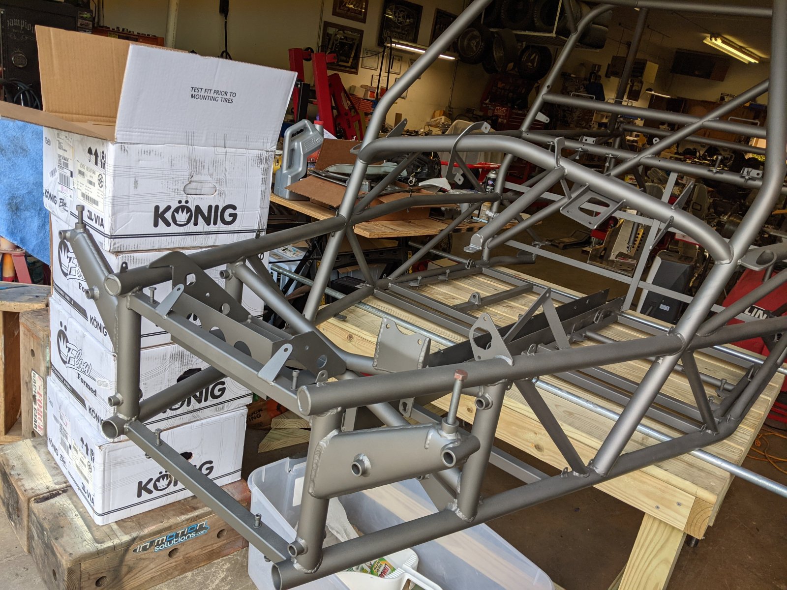

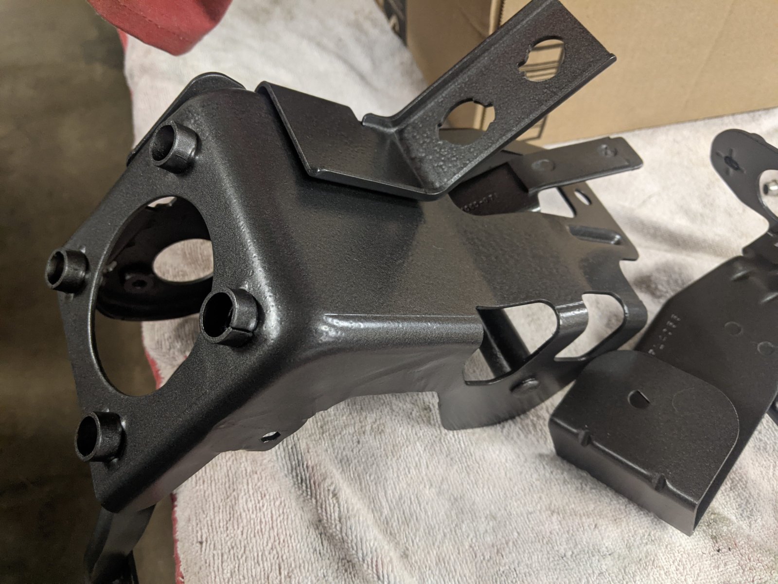

Most things have either been painted black or a hammertone color that comes out gunmetal grey. Darker than the steel-it, but lighter than the black. The picture below of the steering rack really shows the color well. I showed it on my pedal box in an earlier post as well.

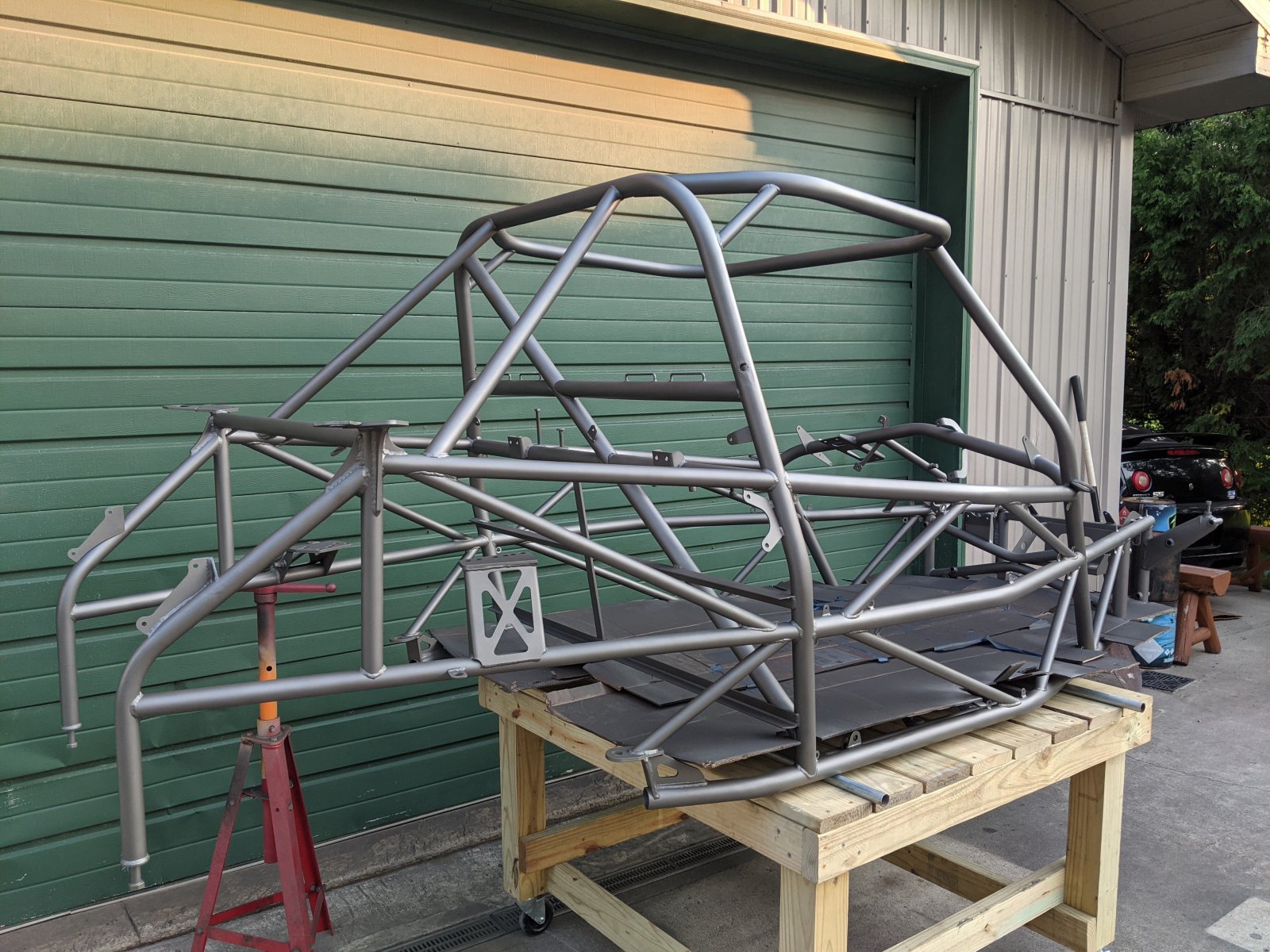

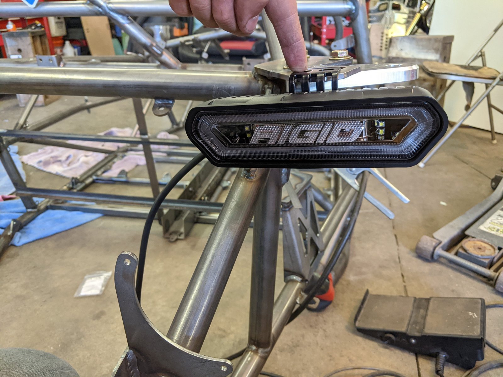

All welding is DONE. At least, any of it that I can plan for prior to paint. All harness mounting hardware is in place, body panel tabs are fitted, and tail light provisions are accounted for. I was sure to mount in the seats and harness to make sure everything fit to how I intended. I wonder what you all think of the mounting. Might be a bit overkill, but things are sturdy and as close to SFI spec as I could make it with the constraints that were there.
The list before paint is essentially cleaning up some of the tabs that are no longer needed on the body. Lots of grinding, then lots of sanding, then get this thing coated!

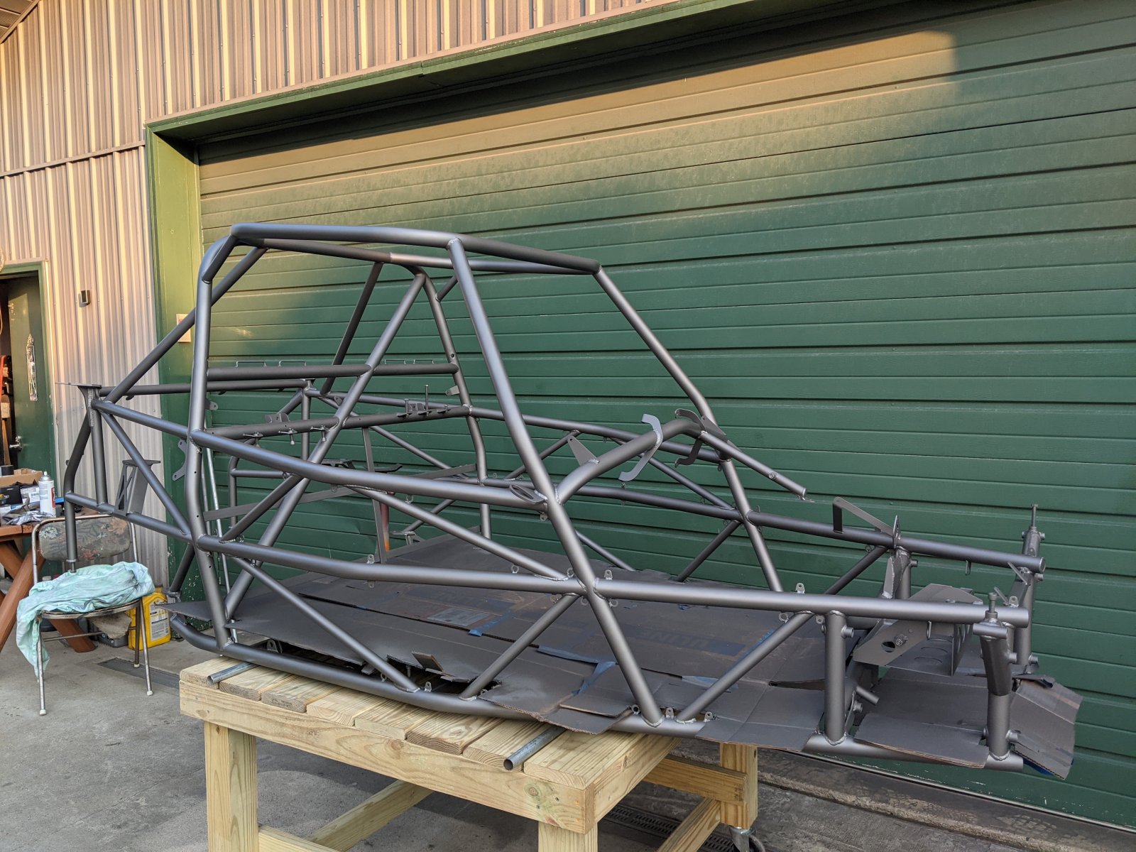

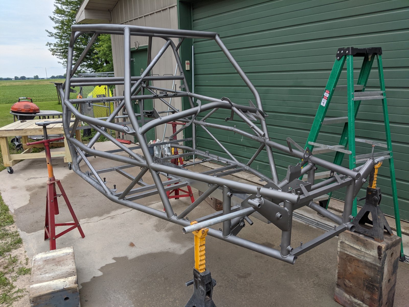

Ladies and Gentlemen... WE HAVE PAINT!
(and a few other goodies as well)
PXL_20210619_235931975.jpgPXL_20210620_213221166.jpgPXL_20210621_205801023.jpgPXL_20210621_210217504.jpgPXL_20210621_210233563.jpgPXL_20210612_043629301.jpgPXL_20210621_215714792.jpg
On a side note, weather impacted painting a bit, so there is a need for another coat next week. However, it's looking really good! R888R's are in the mail too!

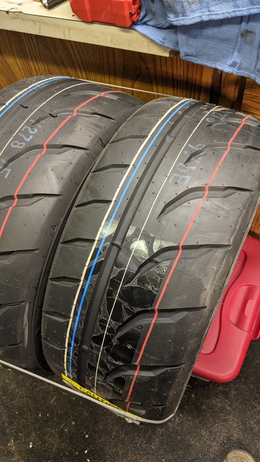

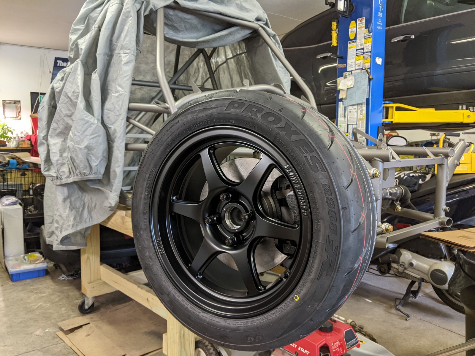

Two of the four tires showed up today! These things are incredibly sticky. Can't wait to get them mounted and rolling.
Following up to the other day's post, it was a long weekend of prep work and paint. Hand sanded everything and then followed up with sand blasting around all the welds. The steel-it got a good first coat on and looks great! Unfortunately, unpredictable bad weather rolled in a day earlier than forecast said. So, I'll be waiting until the next apply window for the second coat. Had to order some more paint too, so that will need a few days to ship. Went through about 6 cans so far and I'm really impressed with the look.

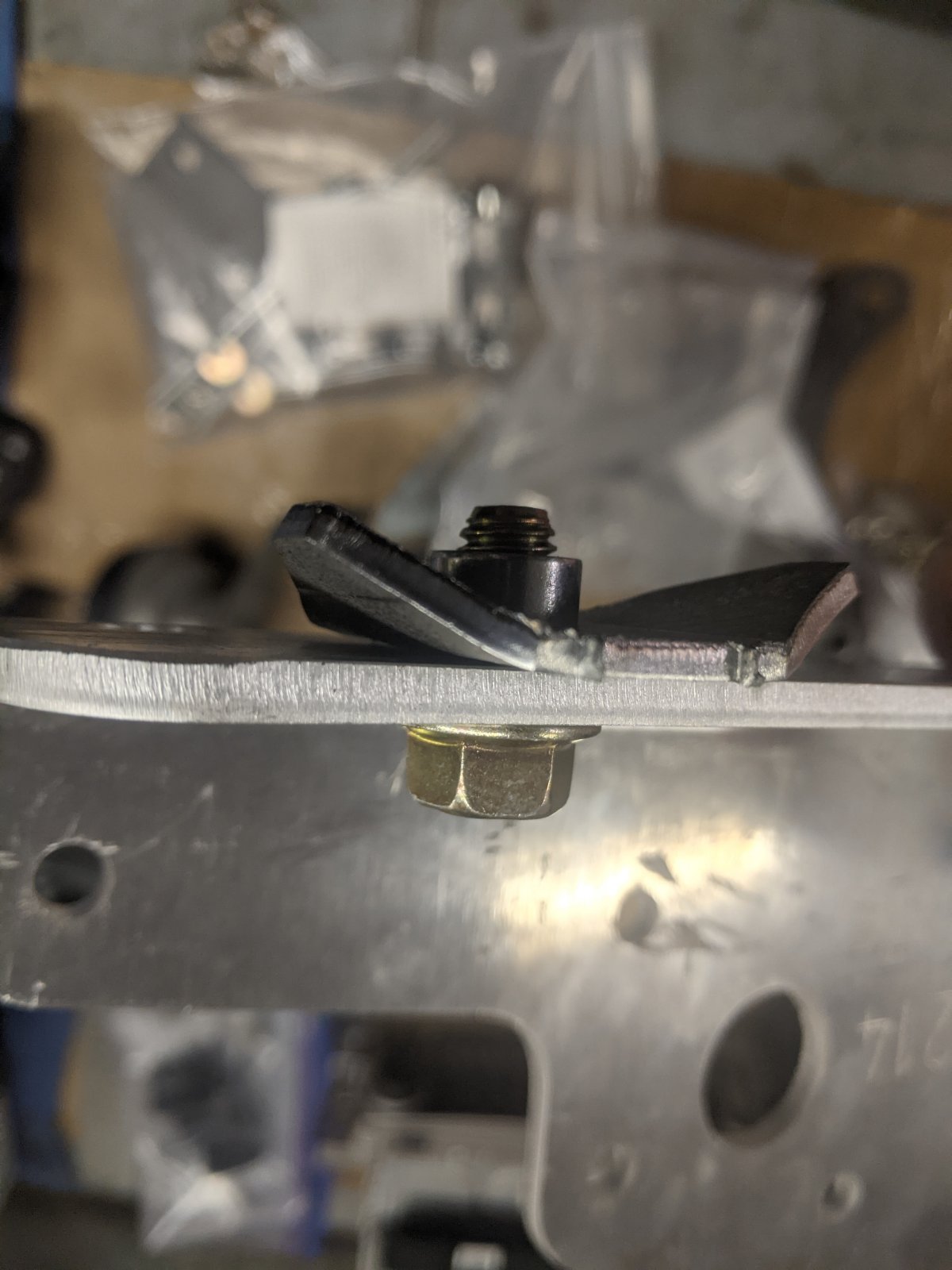

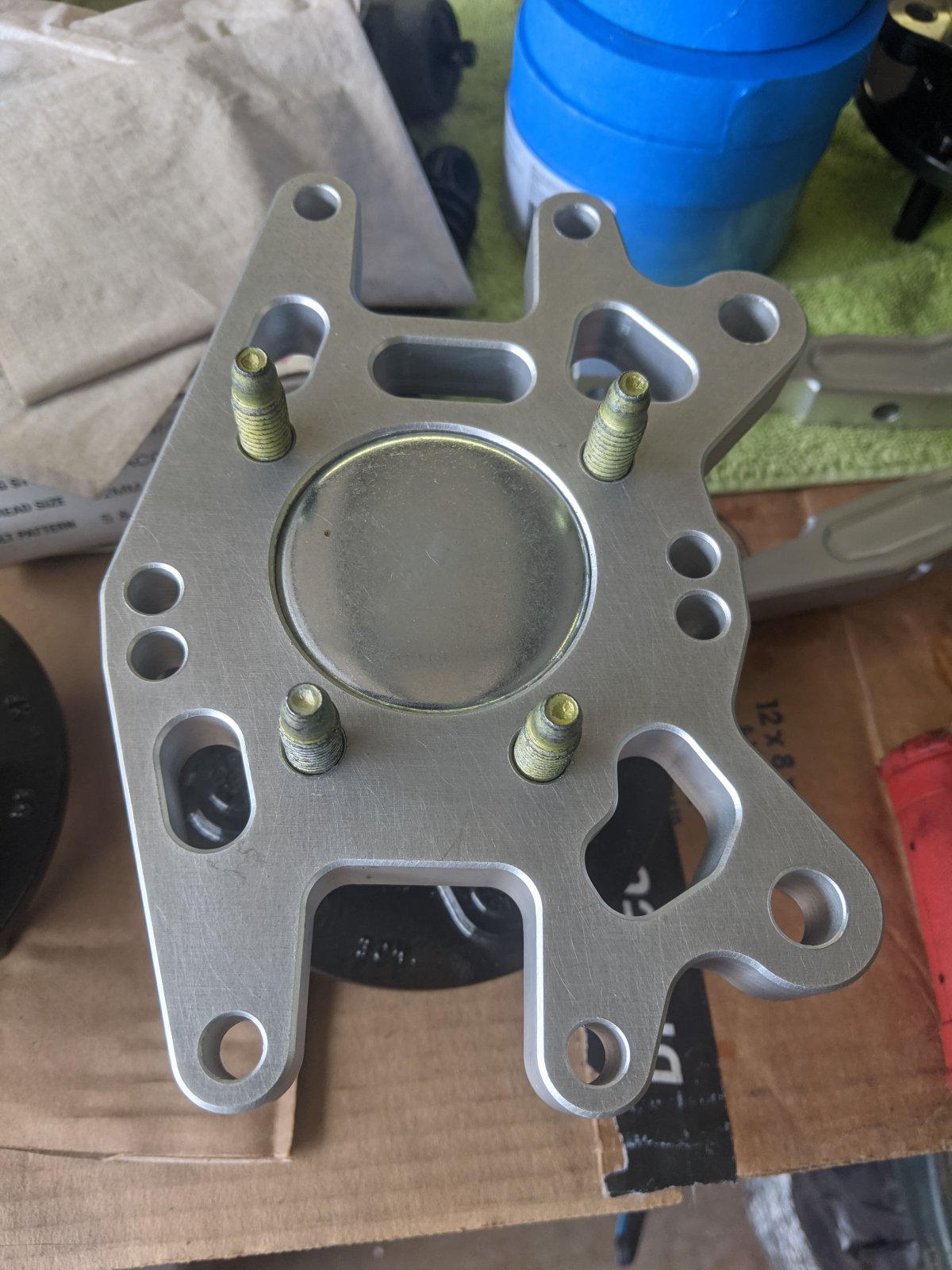

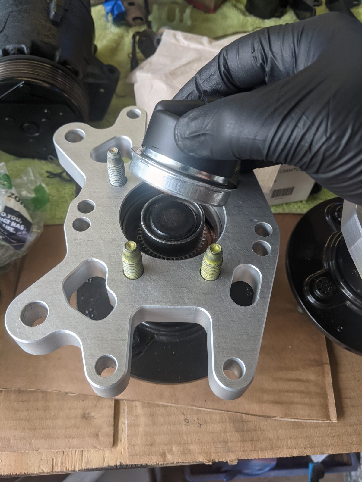

Did the modifications to remove the abs sensors from the front and rear bearings. Found out that a slightly sanded down cam/freeze plug fits nicely as a close out for the back side of the front hub. I'm going to silicone the back side to completely seal the bearing, but it should work great. Also had to sand the rotor spacers and steering components to fit in their respective assemblies. Took forever, but has a pretty perfect fit now.

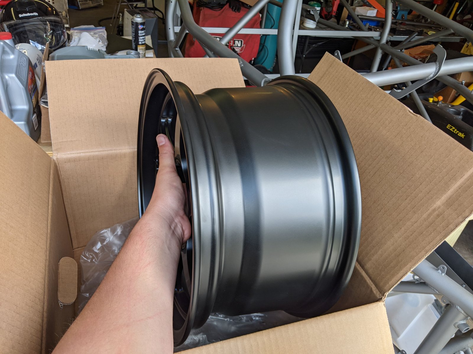

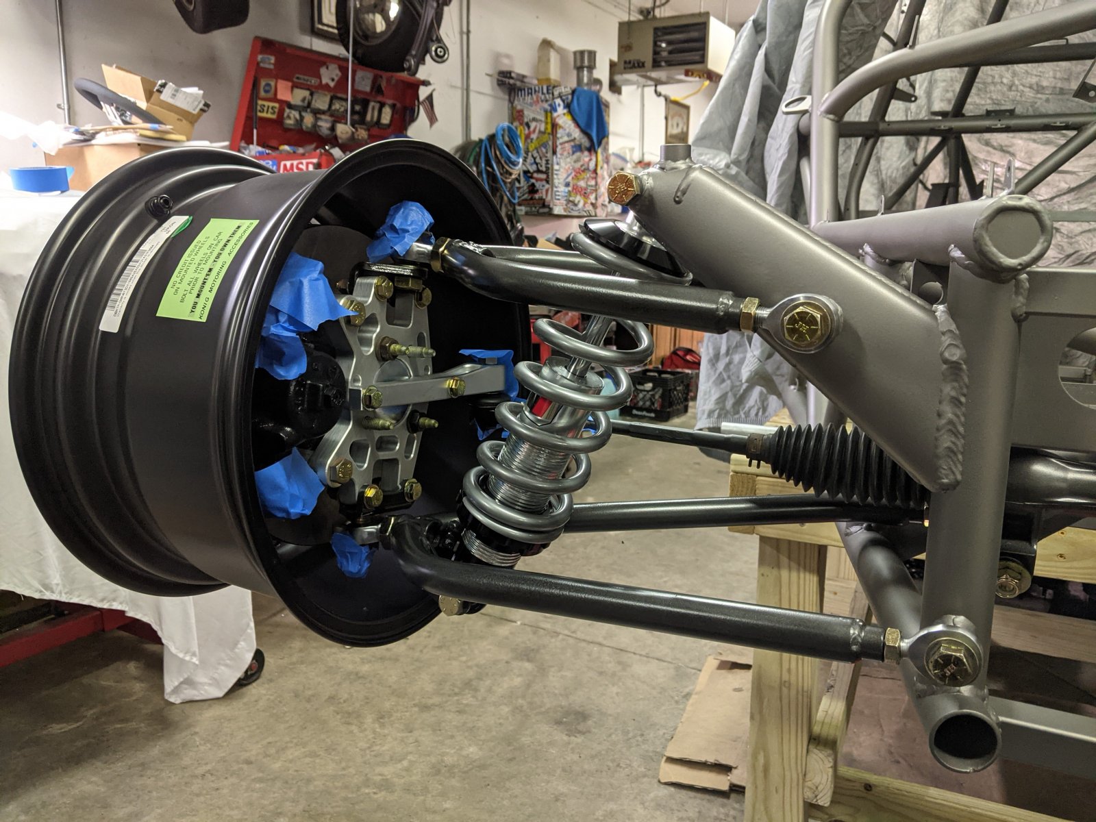

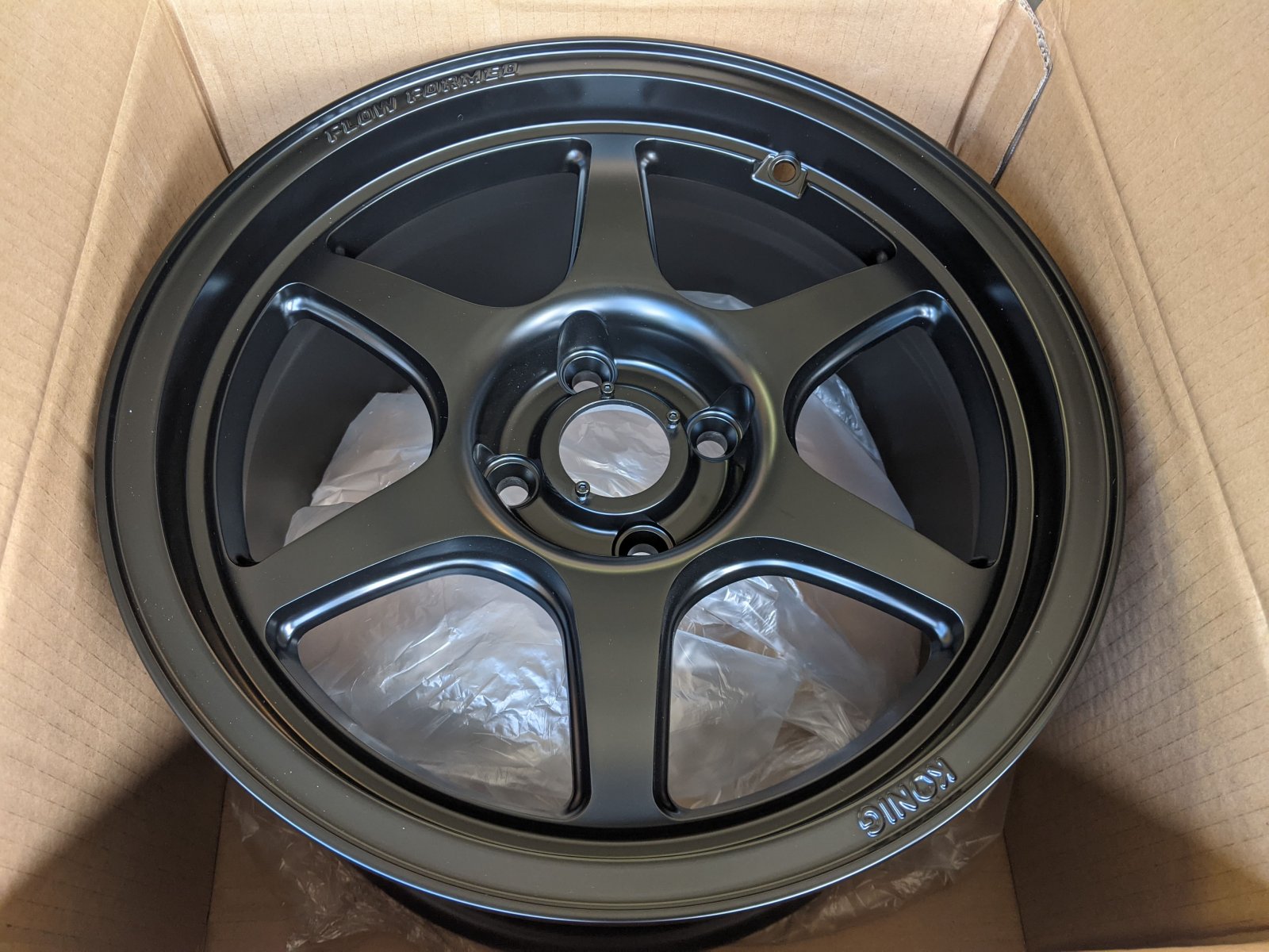

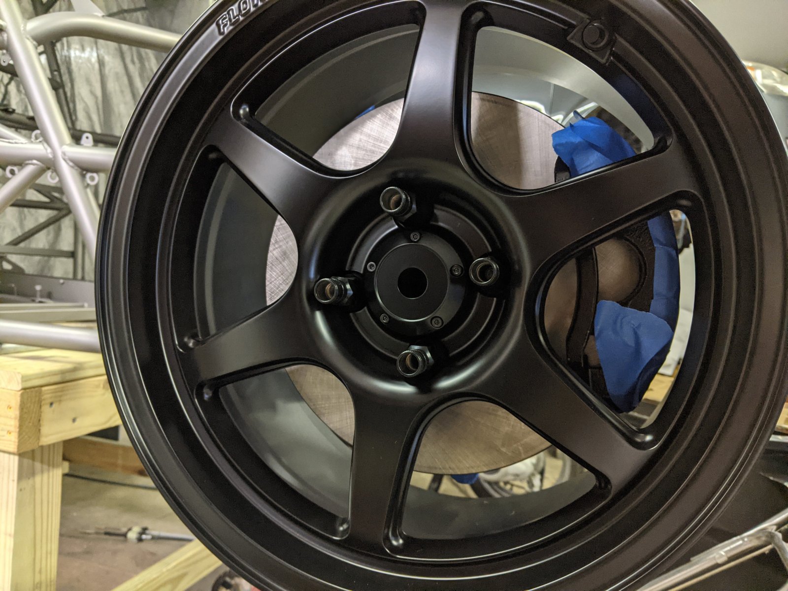

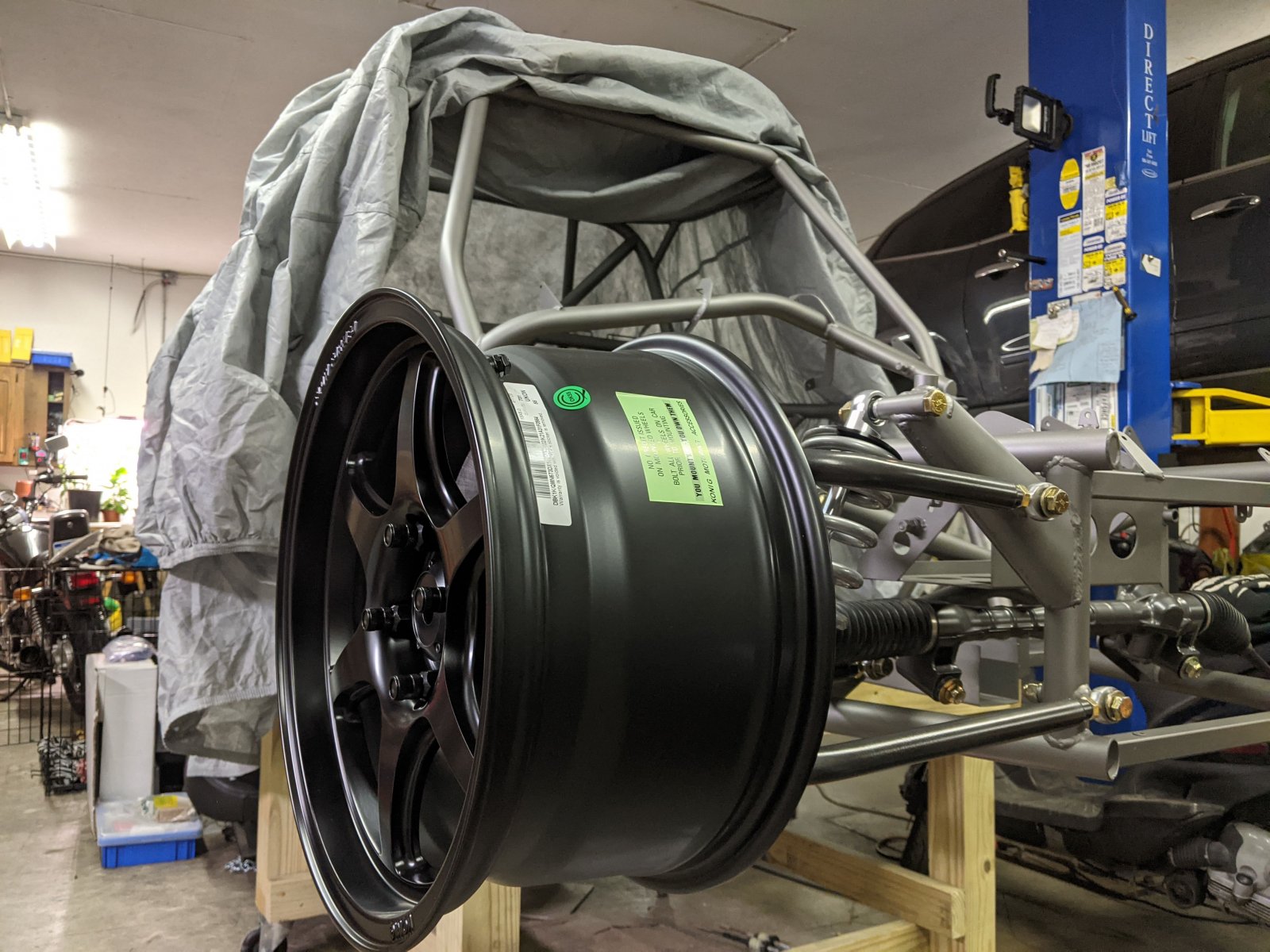

Installed a front corner to check my new wheel clearance. The wheels are Konig Hexaform in 15x8 with +25mm offset and 4x100 bolt pattern. They fit beautifully. I did find that when steering, the stop is between the lower rod end lock nut and the L-bracket mount to the upright. Is there any other steering stop that gets installed? Once the fit was checked, the Toyo R888R's were mounted up (225/45 r15). I'm getting excited to see them on all 4 corners.

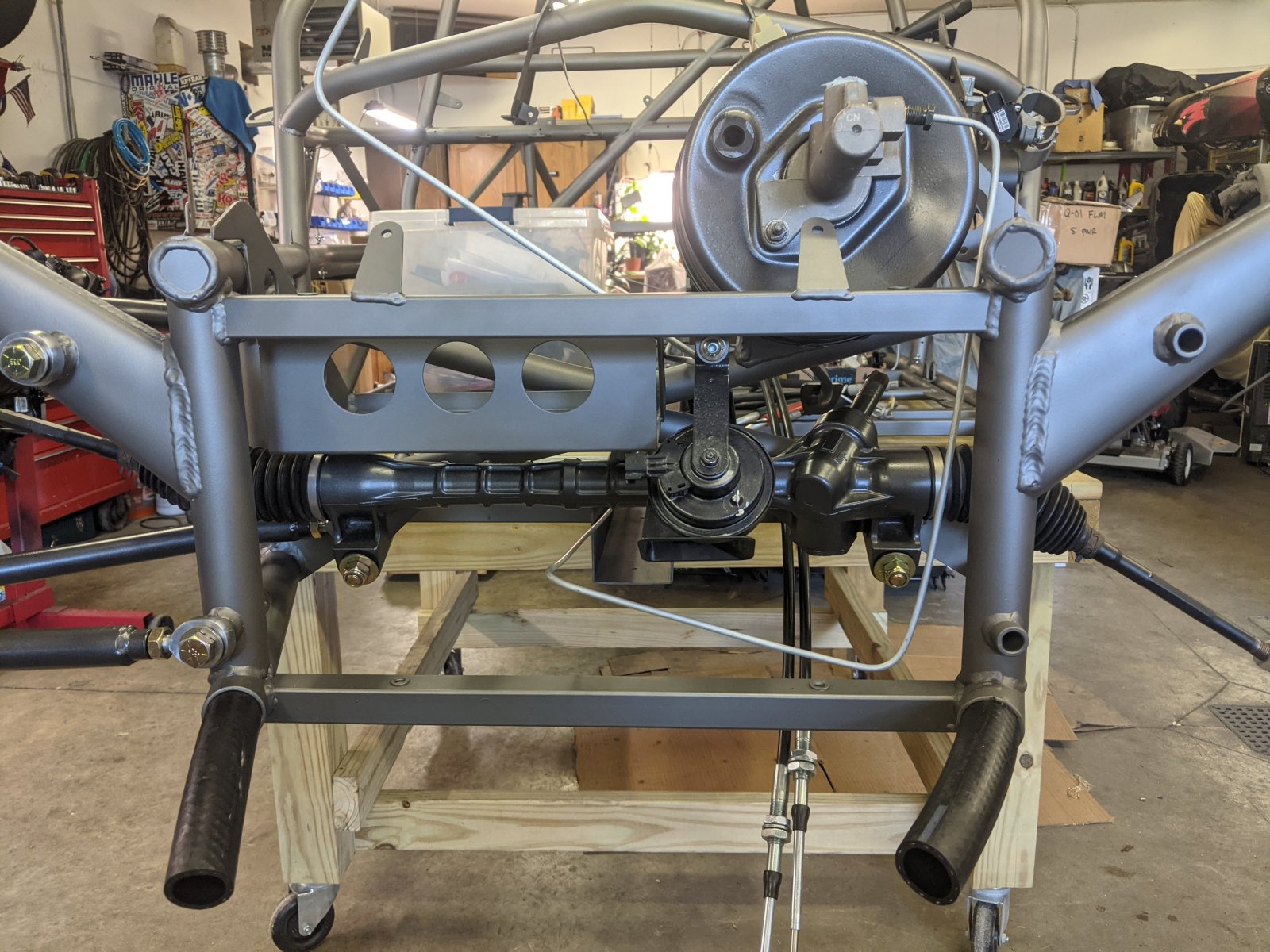

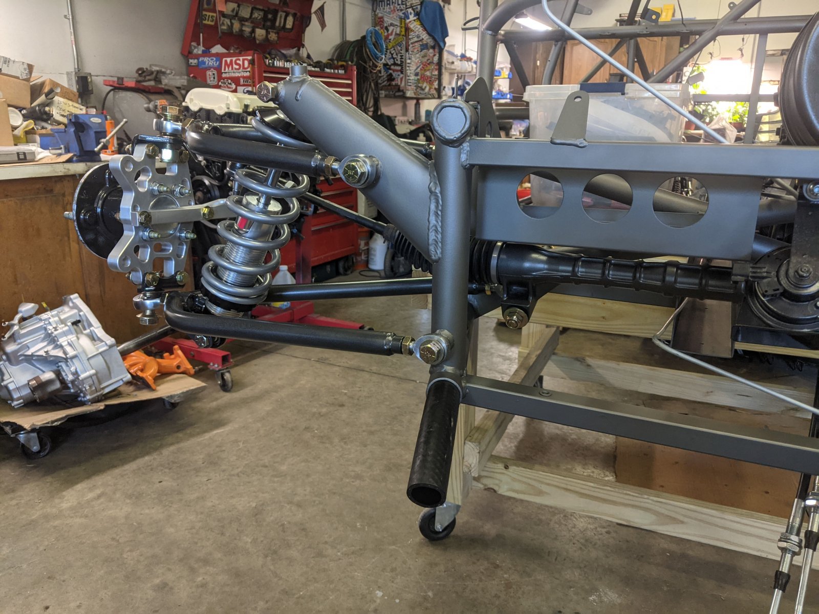

Belly pans and coolant hoses have been installed/pulled. 2 people were handy for doing the work on the hoses. One spraying to keep things lubricated, one pulling with a come-along. Belly pan install with 2 people was nice too, just to quickly pop rivets before the silicone set up. The floor pan strap hardware seemed quite short for the application. I got a thread into the nylock nut, but it still seemed like little engagement. I'll keep an eye on those in case anything backs out.
Started bolting up many of the subsystems in the front end. I believe according to the videos I'm officially through #18, but I do have a bit of cleaning up to do. Clutch pedal doesn't quite fit with the steering shaft, so some trimming is in order. I also did trim out the front bulkhead to fit the steering joint for free rotation. Installing the BCM also had an issue when figuring out where the spacers went. I believe my stack-up is correct shown below. Everything seems to fit for now!

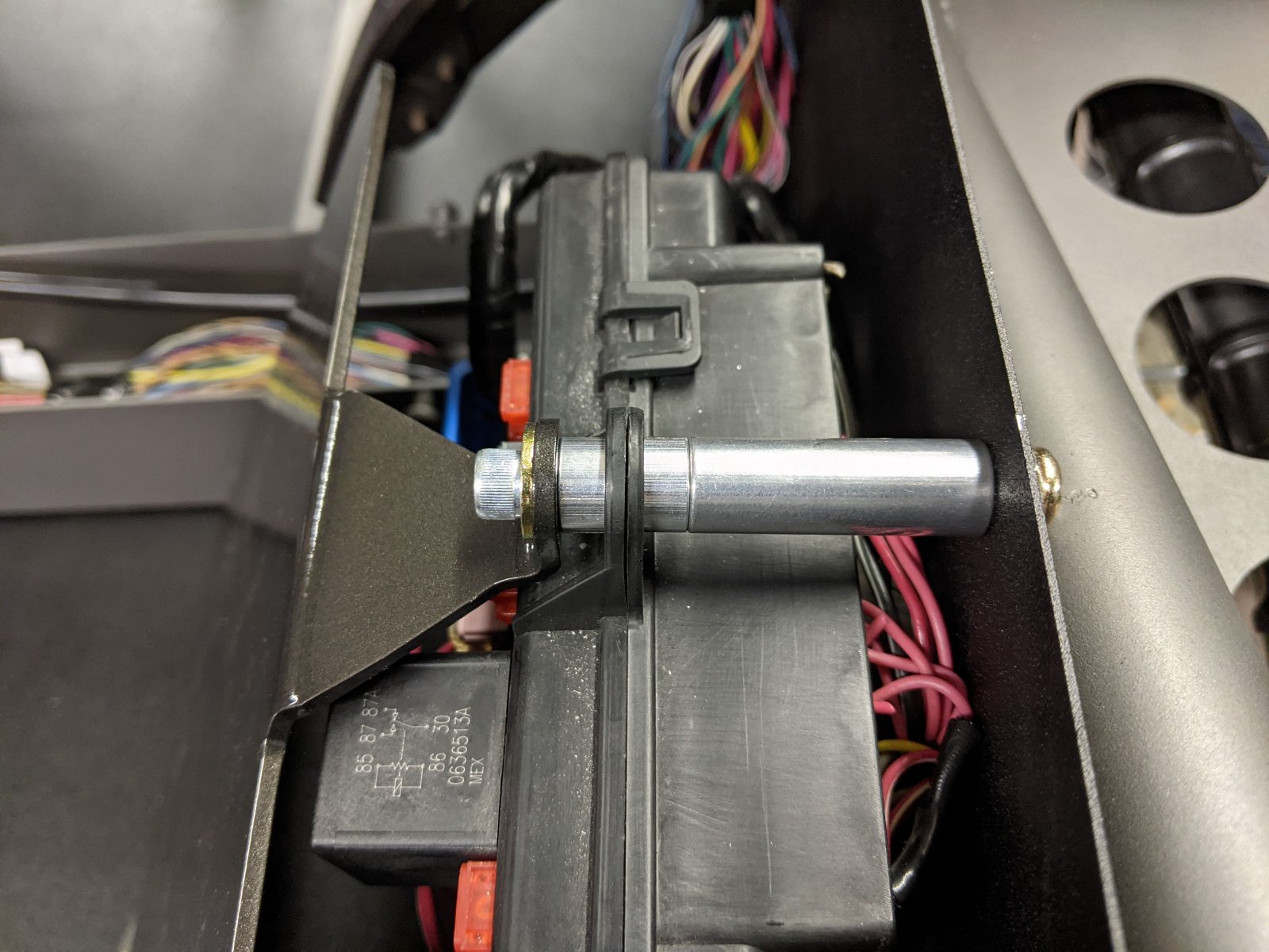

A few wires are pulled tighter in their assembled position than I anticipated. The gauge cluster wires may need to be extended slightly as I wasn't able to make the full length during the harness build (wire length constraint). The wire on this white box (vats?) is also a bit short, but creative routing should make up for that. Everything else seems to fit well.
