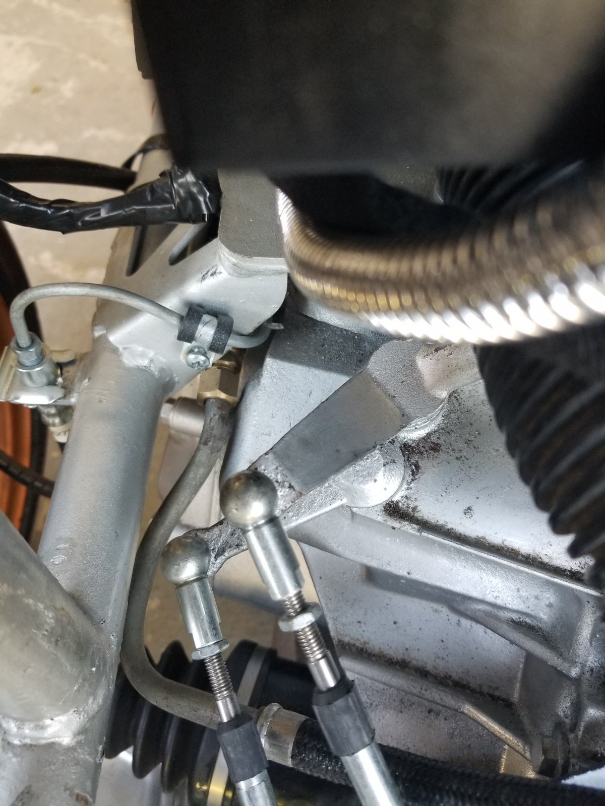

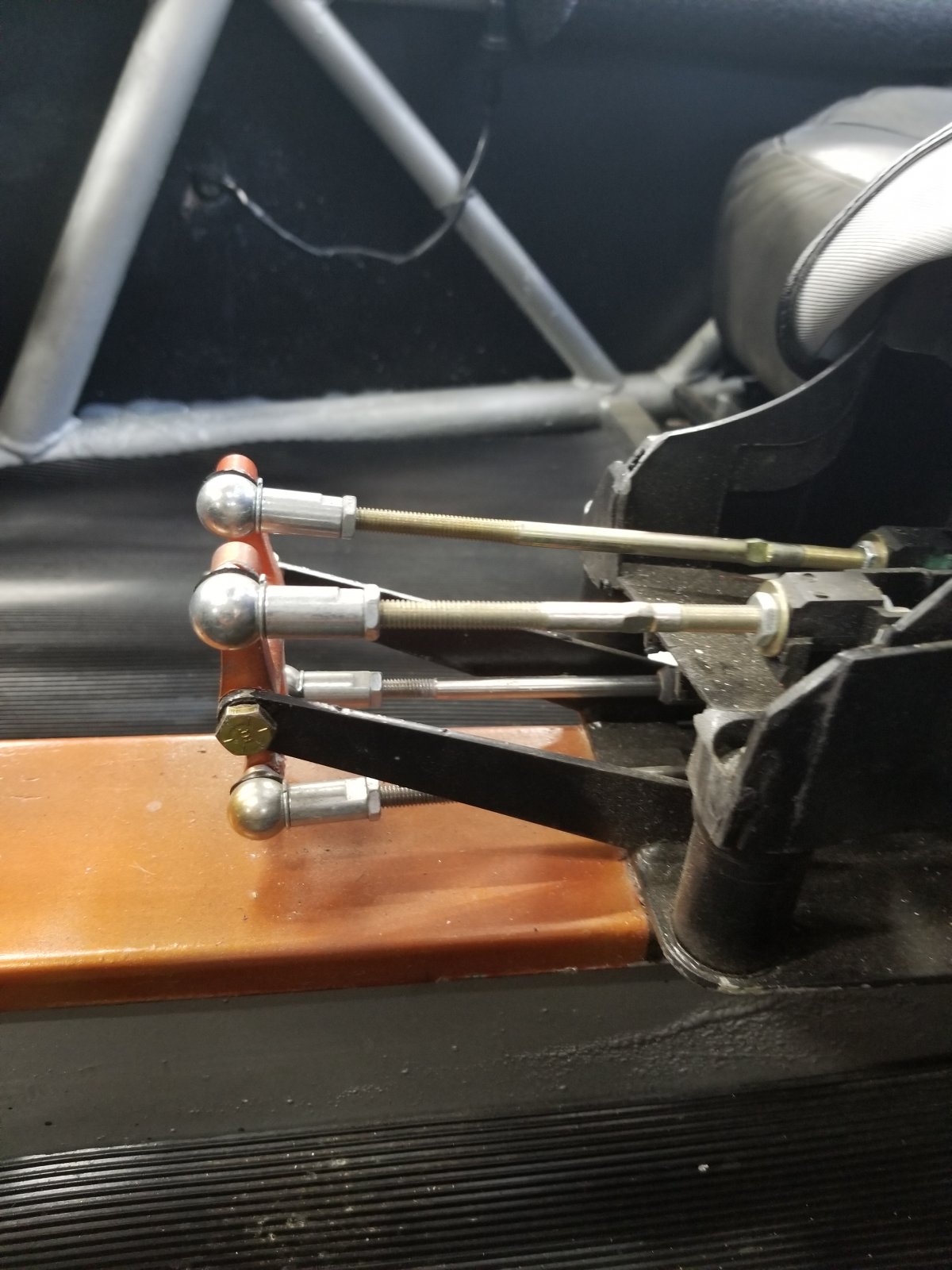

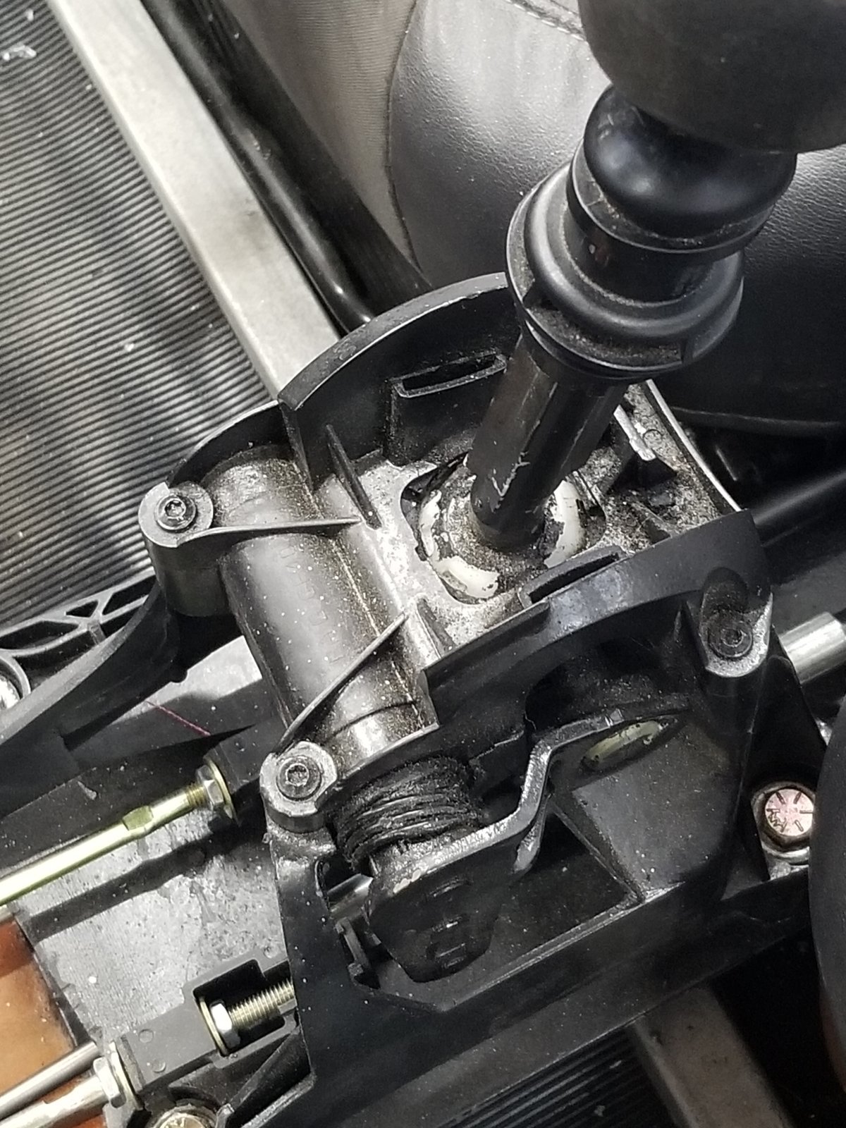

Hi. O5 SS/SJ F35 Manual. I cant get all the gears. If I adjust in the rear for 1st, I cant get enough movement to go to 2nd. If I adj 2nd, the opposite happens. Can't get first. I'm not getting enough throw. I tried shortening the front( in front of the shifter) top rod, thinking I was running out of movement ac t the shifter. It changed the rear adj. but didn't help. ANY SUGGESTIONS?

How much "slop" in your shifter? I have seen the shifter handle's center plastic ball sanded down by years of dirt and abuse. Also had the nuts and ball studs loosen up on my shifter. The more slop you take out, the more range you get out of the cables.

Wow. I wish I had these directions 3 or 4 months ago when I assembled it! I couldn't find any. I think my cable (big nuts) adjustment under the shifter is wrong, causing the cable(s) to bottom out, limiting overall travel.
I dont think that's the problem. I drove the doner home 50 miles and it shifted good. I know sometimes when you dissemble old stuff, problems arise that wernt there before though.

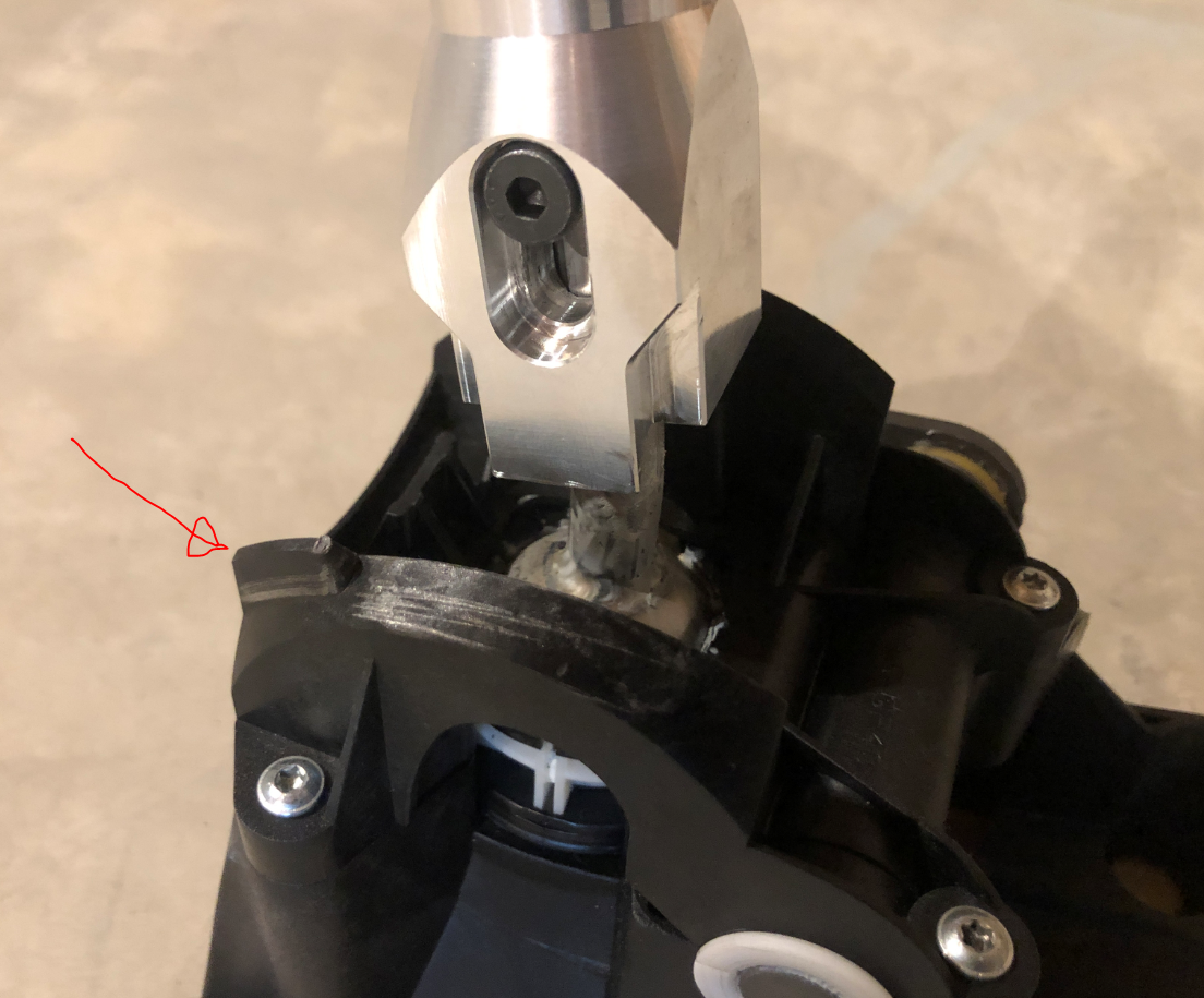

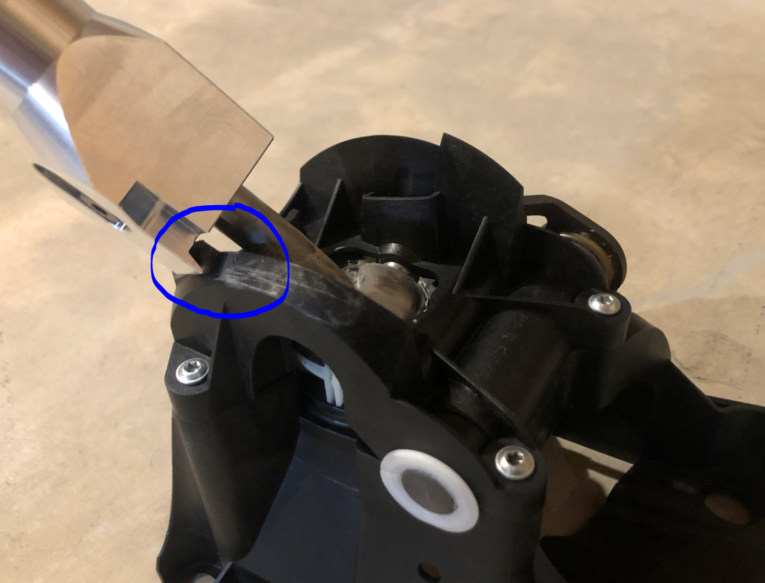

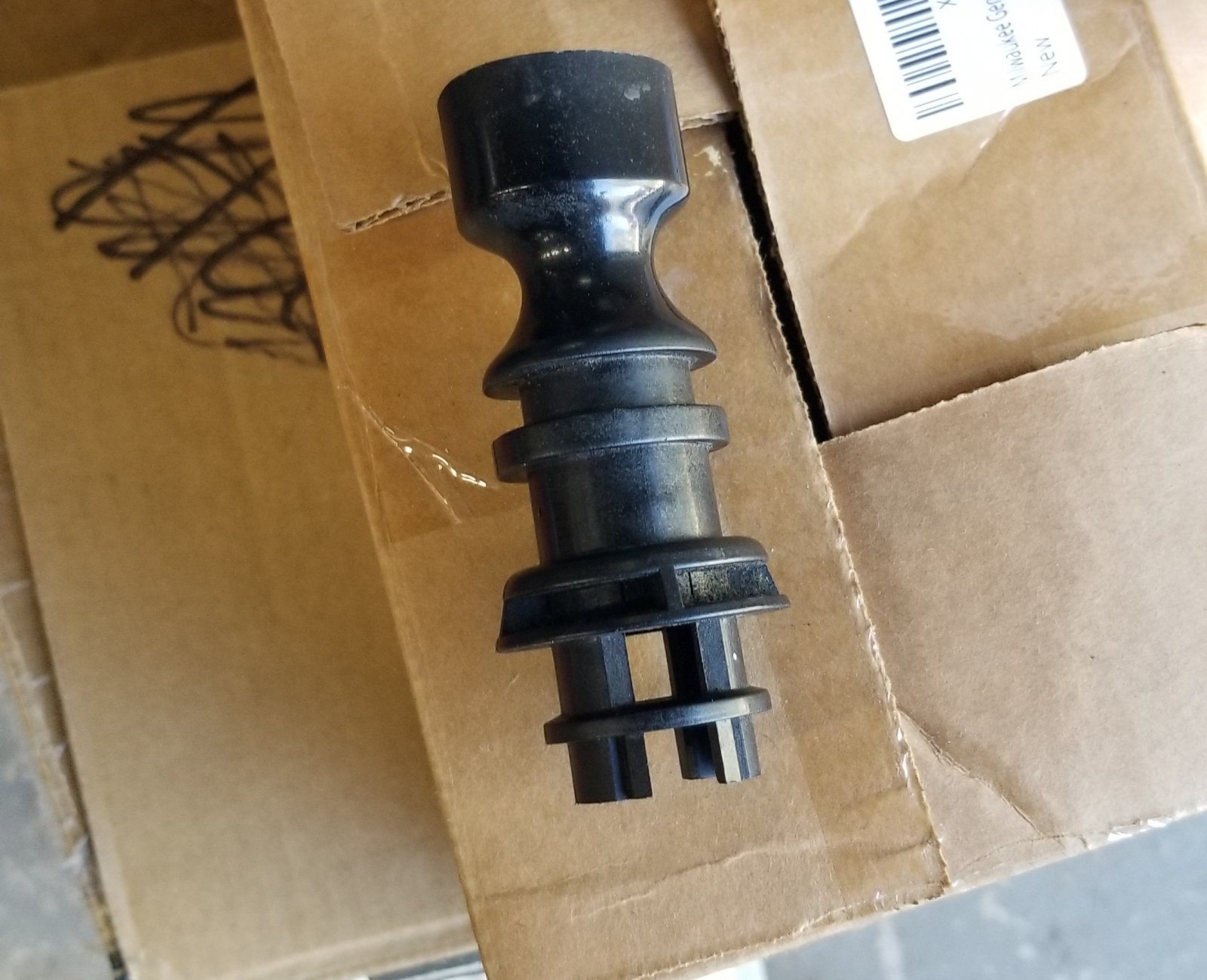

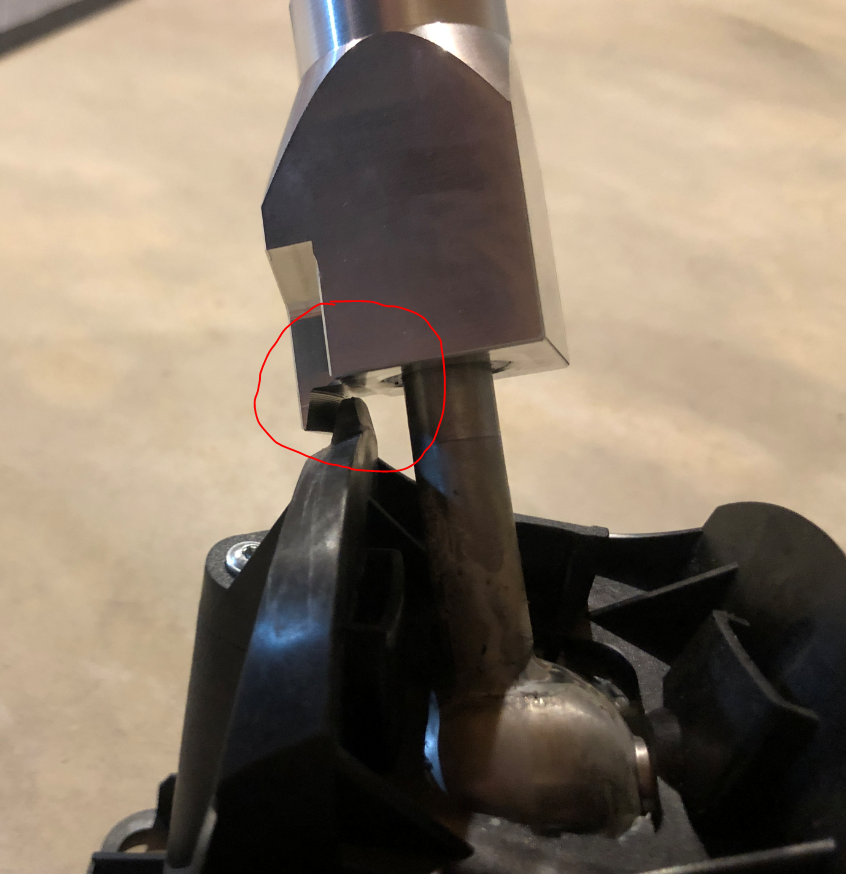

It lifted up to allow the local shifter to travel further right, where reverse is.
When I changed to the aftermarket shifter, the Cobalt shifter lockout was gone, so it is local to the shifter in the image.
Well it is not the cables or the transmission. It is a function of the shifter. Check to see what that lever use to lift, it has to be 8" below the shift knob.
Oldchevyguy
I really appreciate your help. I know the problem is the shifter. I guess my question is how does the lockout work? What mechanical engagement does that black piece have with the shifter?
I don't have a Cobalt shifter to look at anymore, so I'm not much help.

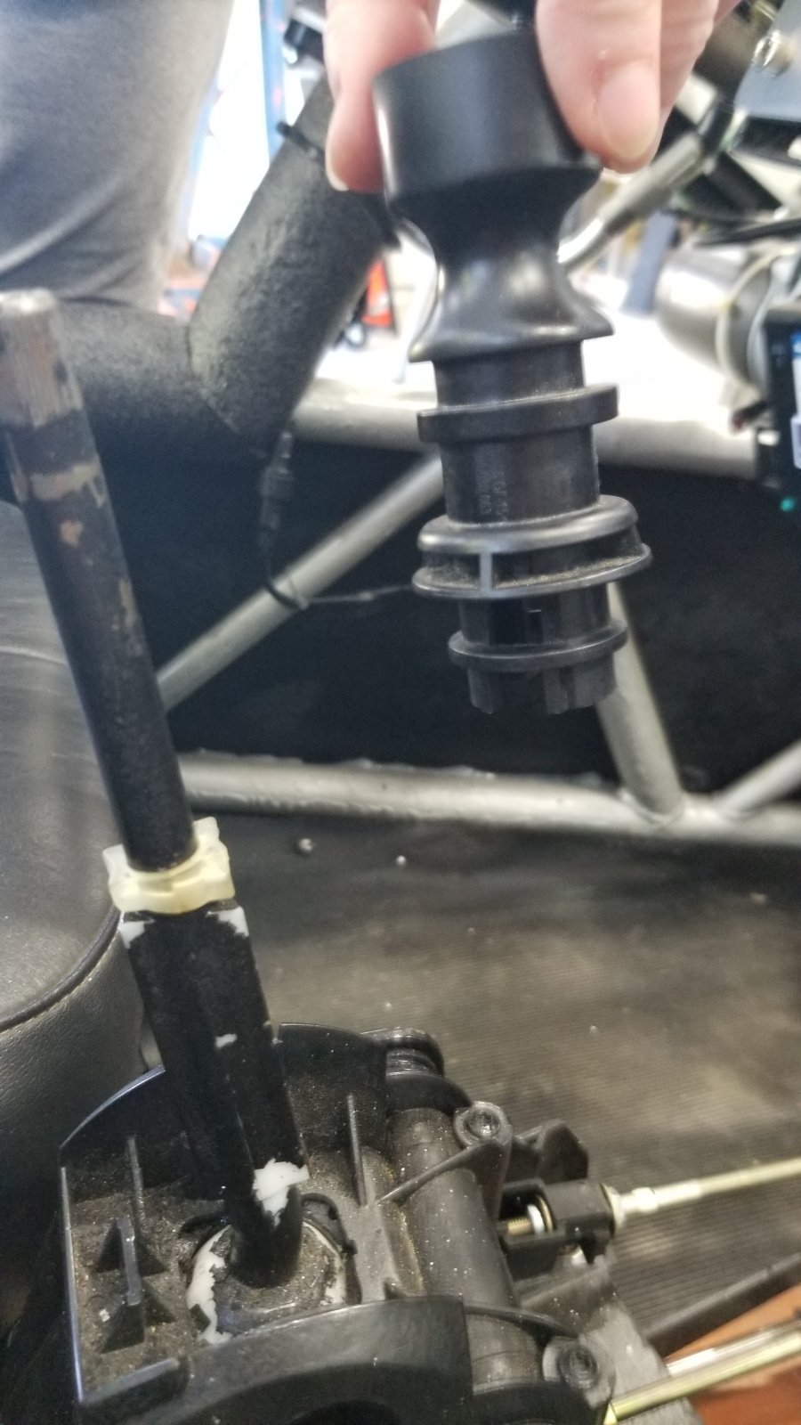

Your picture shows the base of the shifter shaft broken and at a weird angle... bad picture or bad shifter shaft?

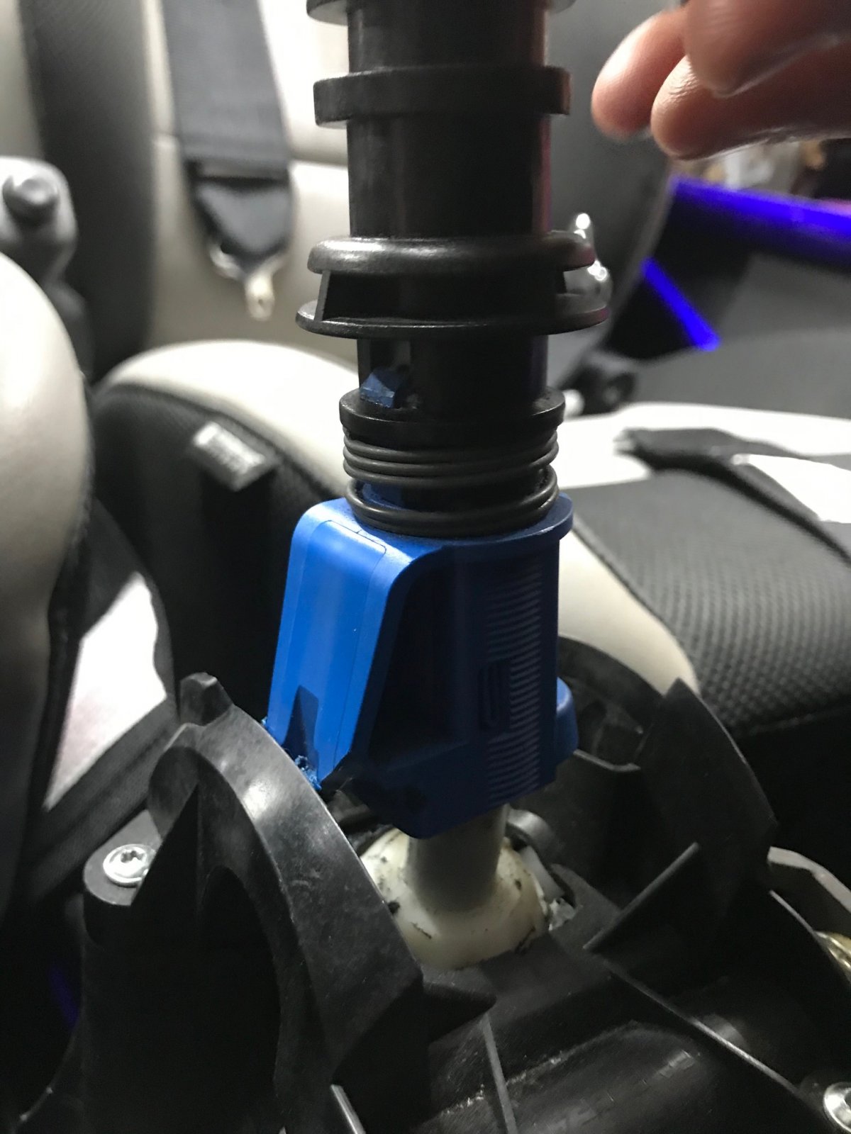

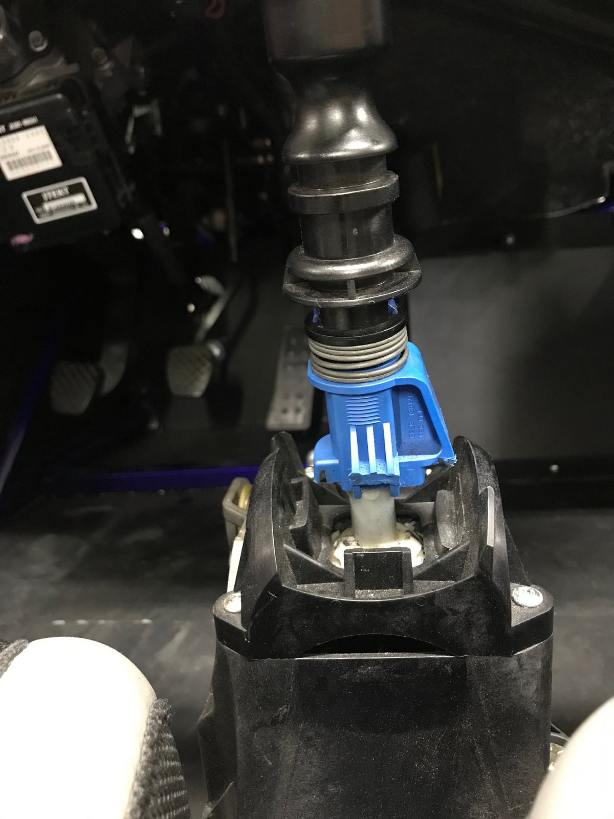

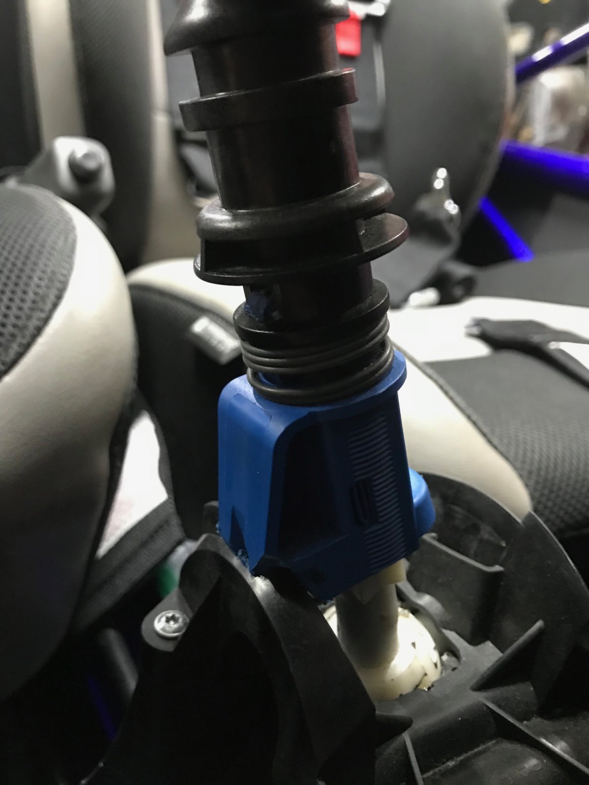

Neutral:
14183
Pull up on shifter handle and move to reverse. The lock out happens when the handle passes the plastic allowing the shifter to obtain the reverse location.
14184
14185
Hopefully this helps if this is what you were looking for.
Oldchevyguy
Nothing is broken. The white spot is just the black paint falling off. There seems to be something missing.
