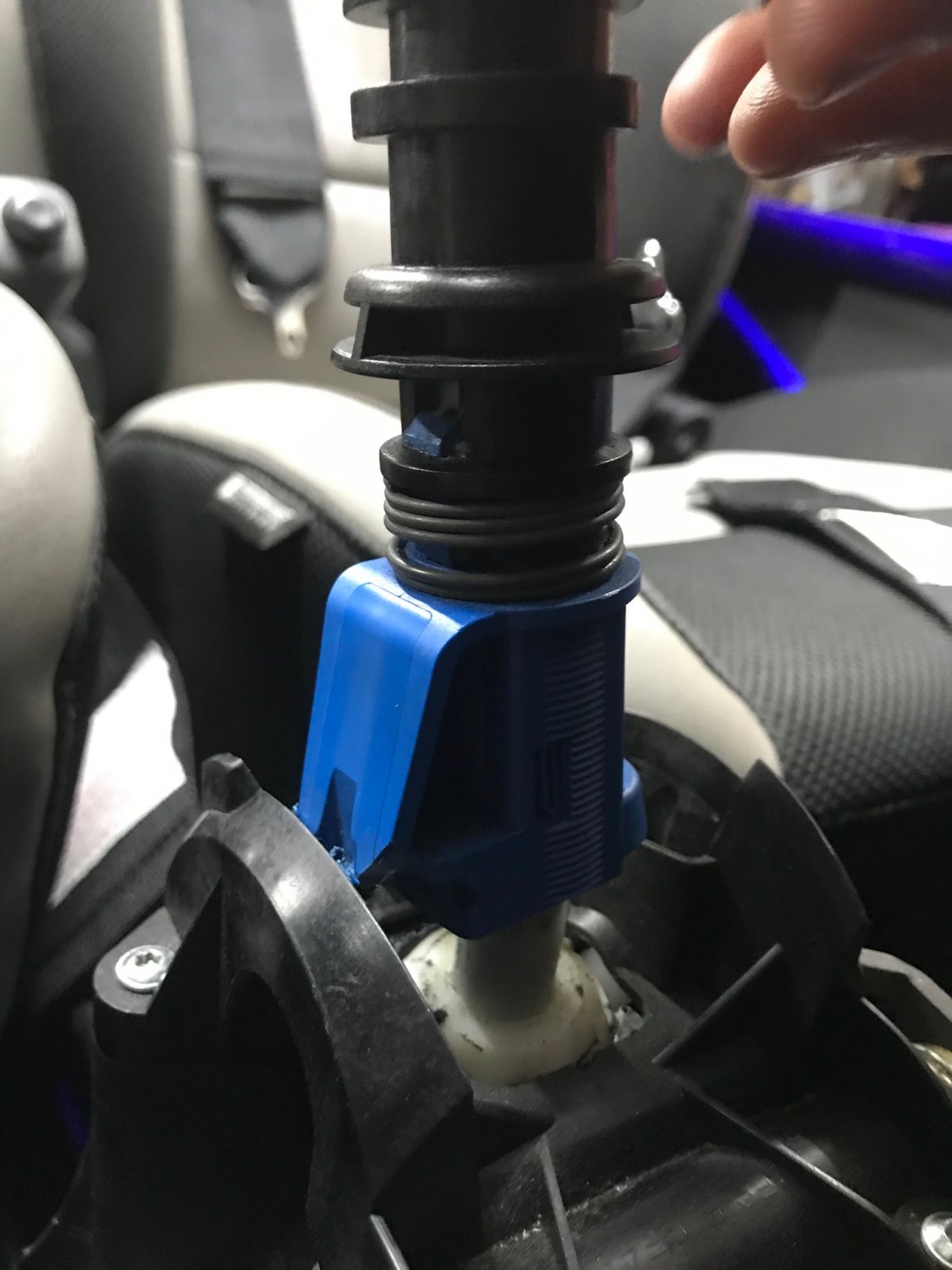

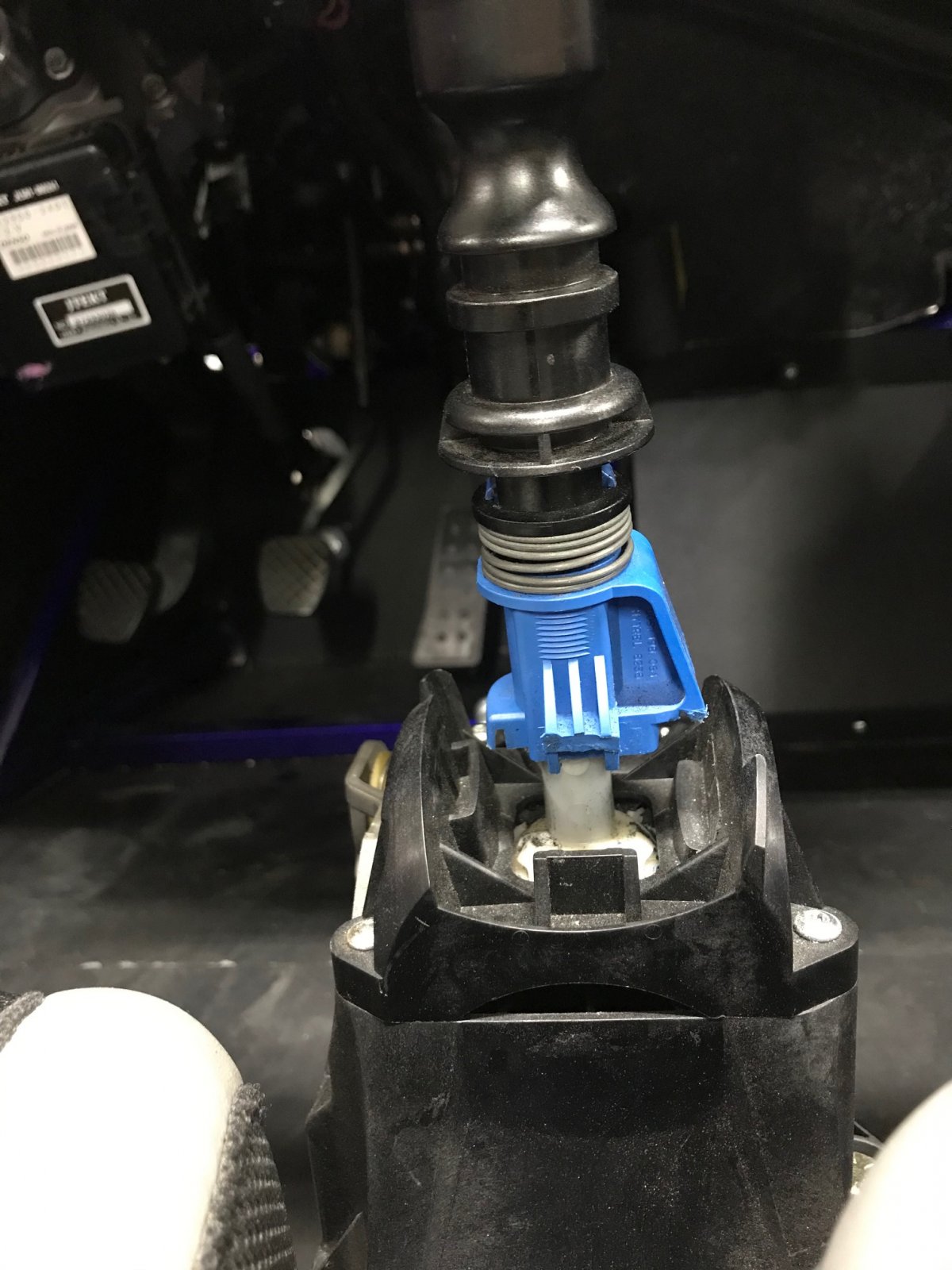

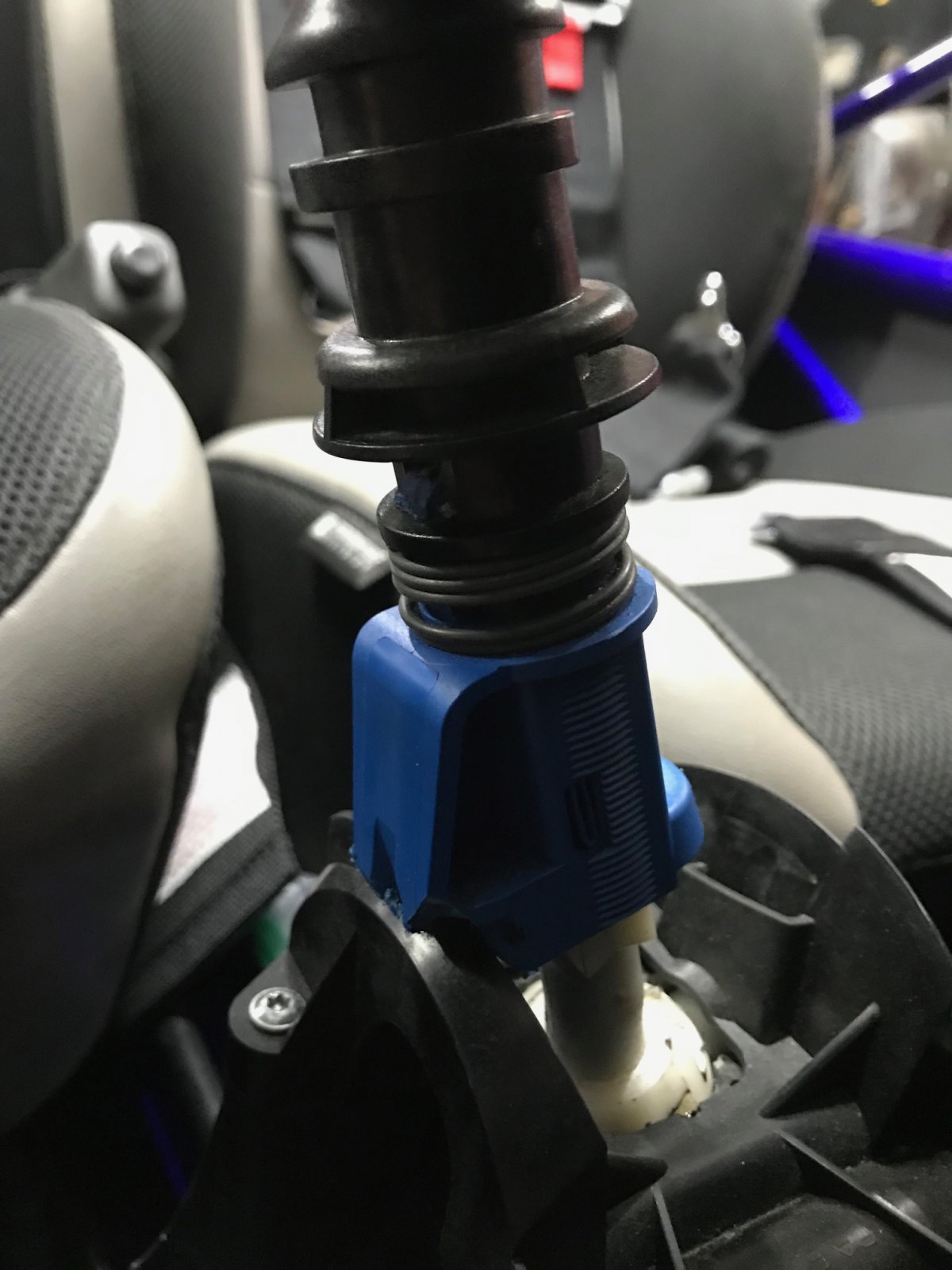

I dont have that blue thing! And it looks like a spring above it. Where can I get these parts? I called the dealer and they only sell the whole assembly.

Note I am missing
parts for the reverse lockout. I thought at first this was why I couldn't get reverse. Now I realize that without these parts I just do not have lock out. It can still shift into all gears. I will just have to be careful not to shift into reverse when shifting. After all, older cars didn't have reverse lockout. We survived! This car is all about bare bones necessity. Mine will start without pushing in the clutch. I wanted it that way! No air bags, no ABS, no radio. Just RAW FUN!
