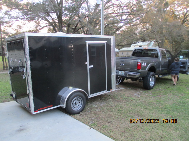

Brian and Nicole just left with their kit. They had a wheel bearing go bad on the way up here. I had to go to I-75 and Hwy 27 to cut off the old wheel bearing race. We put on a new hub and they should be good all the way back home. Trailer is only 1 year old. Only second time they used it. Hopefully under warranty for them. Very nice couple.

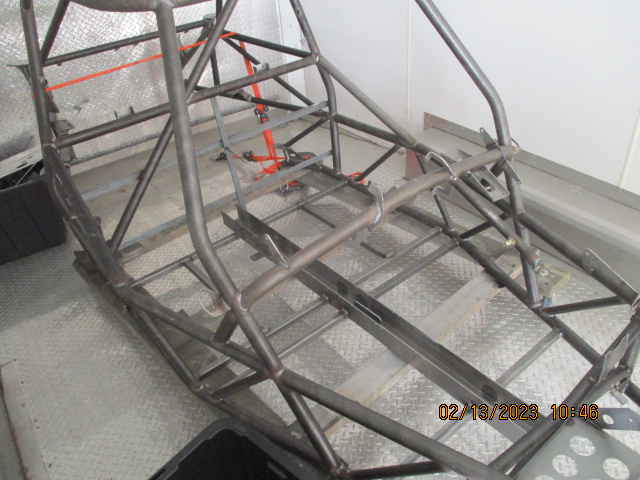

Sent out the bare frame and 36 other steel parts for media blasting and Satin Black powder coating. I am only powder coating the aluminum panel that the steering column goes thru. All the rest of the aluminum panels will get Lizard Skin sound deadener and ceramic heat coating. Side panels only on the inside. rest on the outside. I will install X-Mat from Eastwood on the inside of most of the aluminum interior panels. This has worked great on 16+ builds for me in the past. Hope to complete wiring harness this week.

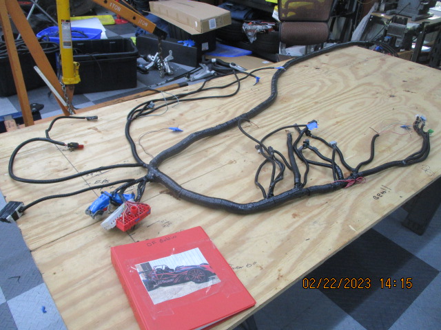

wallace58

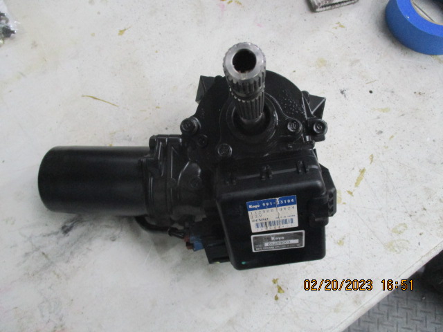

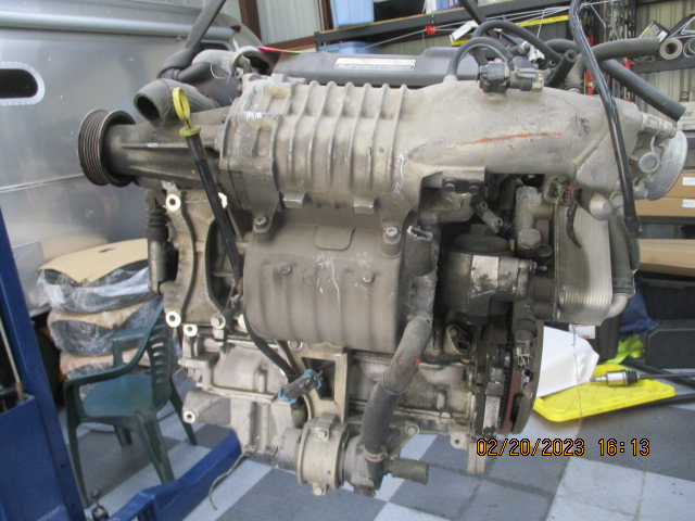

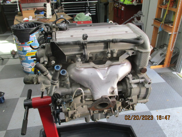

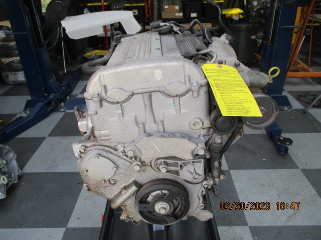

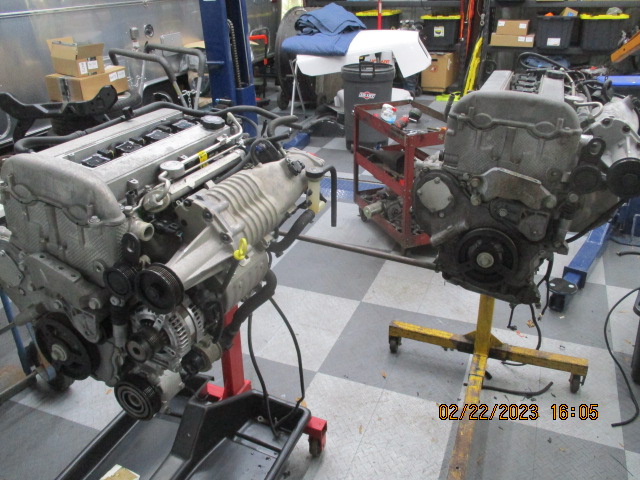

A little bit of everything day today. I did up to testing the grounds part of part 11 of combining the harness. I also cleaned and painted the EPS unit. Finally went to Ocala and pickup the 2007 2.0 SC engine at SE freight. It has 62K miles on it and looks to be in good shape. Compression is great and engine shows that oil was changed regular like. Even the clutch showed no signs of abuse. I am pleased so far. Typical of any salvage yard they cut all the wires at the connectors instead of just unplugging them at the fuse box. Lucky for me I have the donor engine that did run fairly well. So I will just use that harness. I will fix anything that needs fixing. Clean it up tomorrow. 62 K is better than 171 K any day, IMO. LOL. ;)

Been busy on the wiring harness. I am getting close to done. I will use split wire loom instead of tape to finish it up. Also I machined the knuckles .030" so that the TC front hubs fit and my Grand Am axles fit the F23 and my suspension parts. It was very easy and not the big issue some thought it may be. I guess 40+ years of building cars, race cars , engines, transmissions and all sort of car stuff comes in handy for me, LOL. I am really enjoying the build and very appreciative of all the help this forum supplies. Thanks to all. ;)
