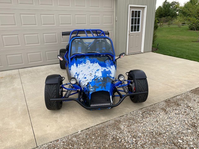

No one is selling ready to go windshield kits. If you aren’t a somewhat skilled fabricator, you might need to find a shop to do it. Or look into doing a Montana registration.

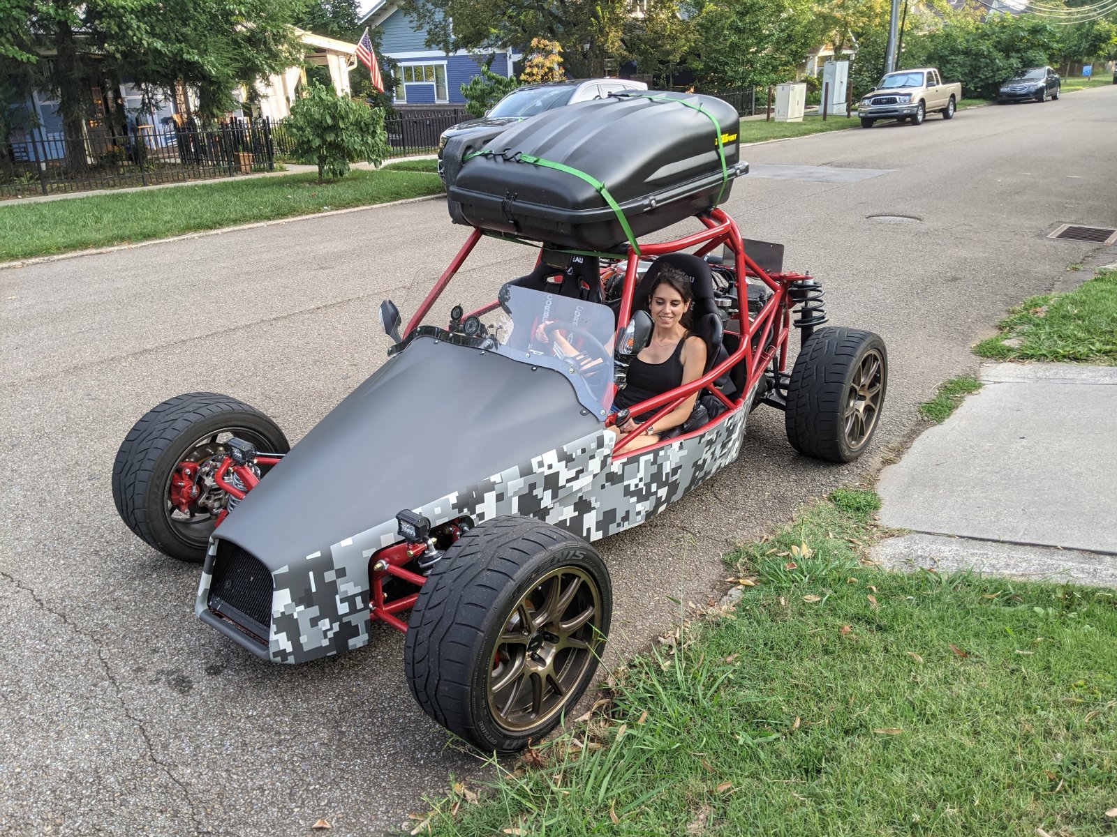

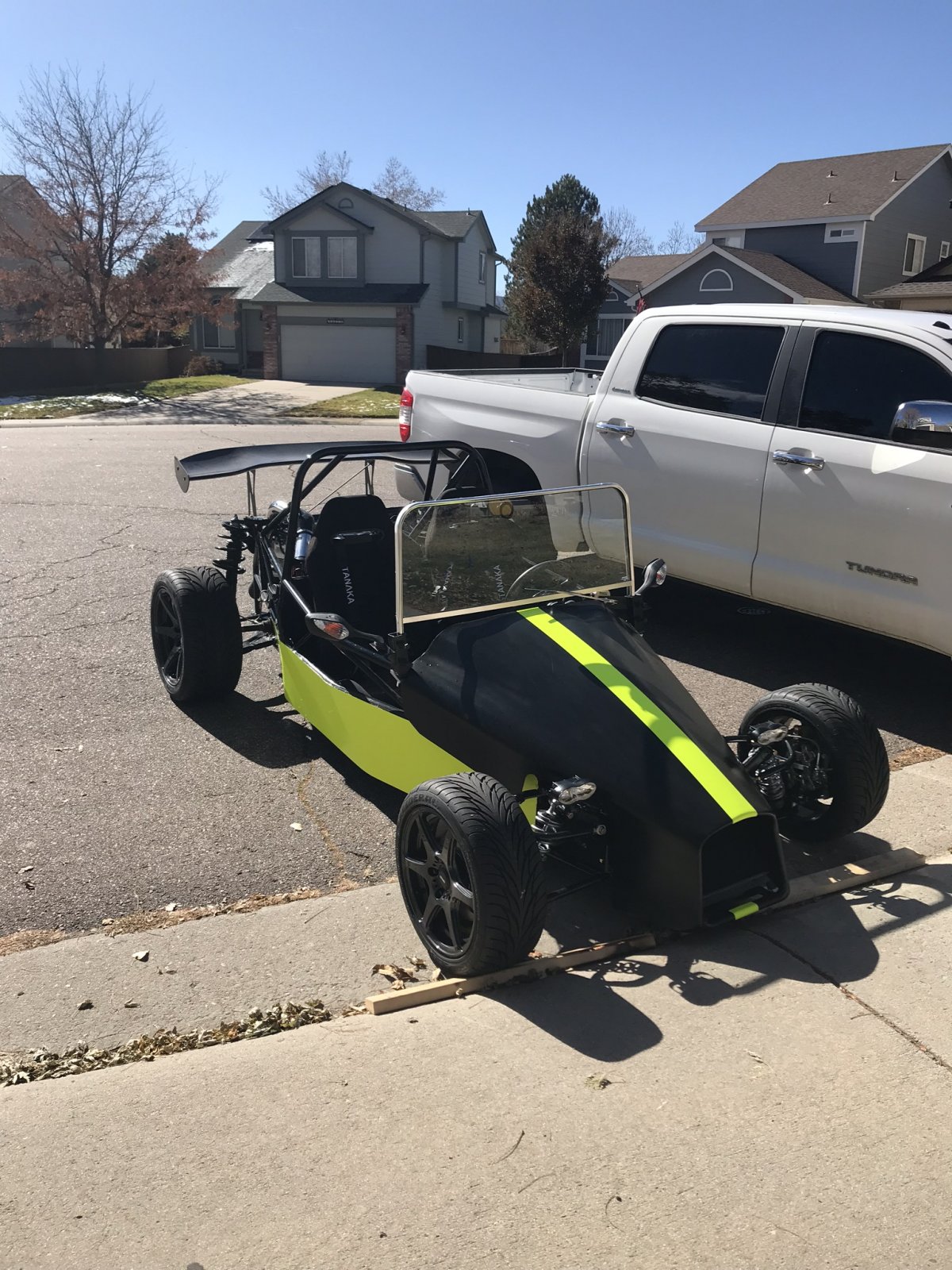

Well there are pictures of my car with a prototype windshield here.

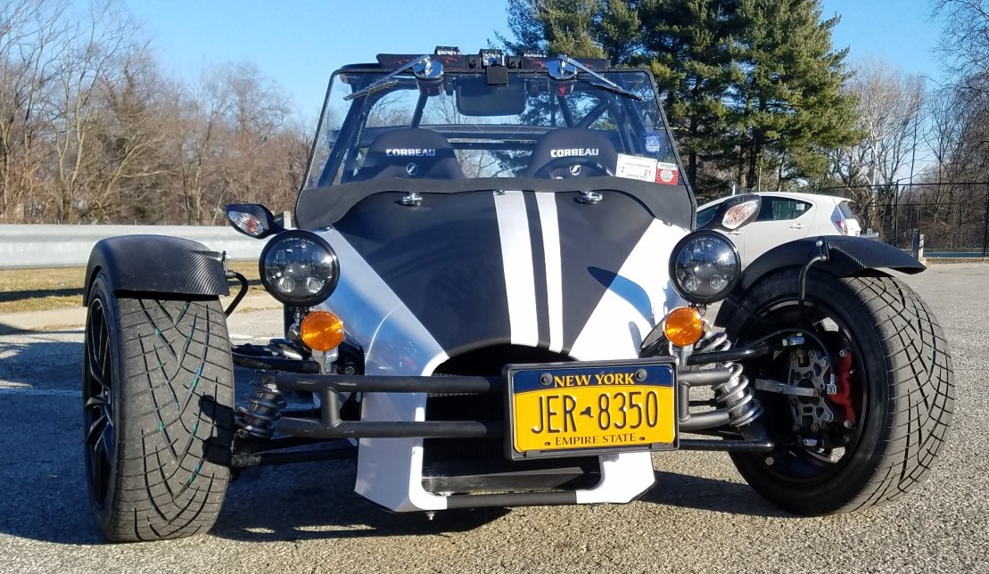

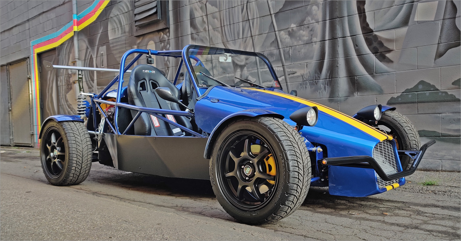

Nicholas Tiratsuyan has wipers, glass? windshield and a track frame:
27799
Most people just use the DF windshields on the track frame.

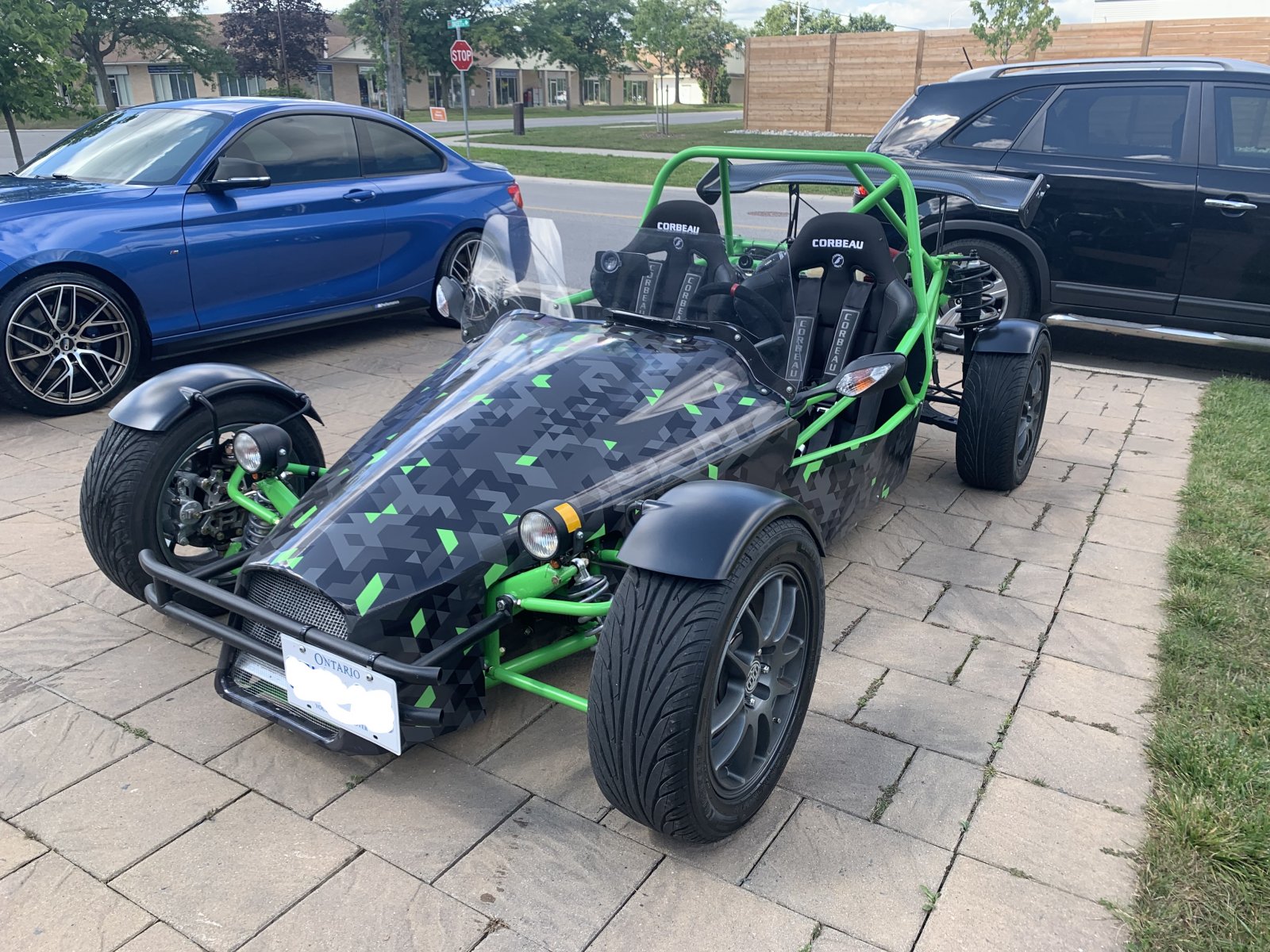

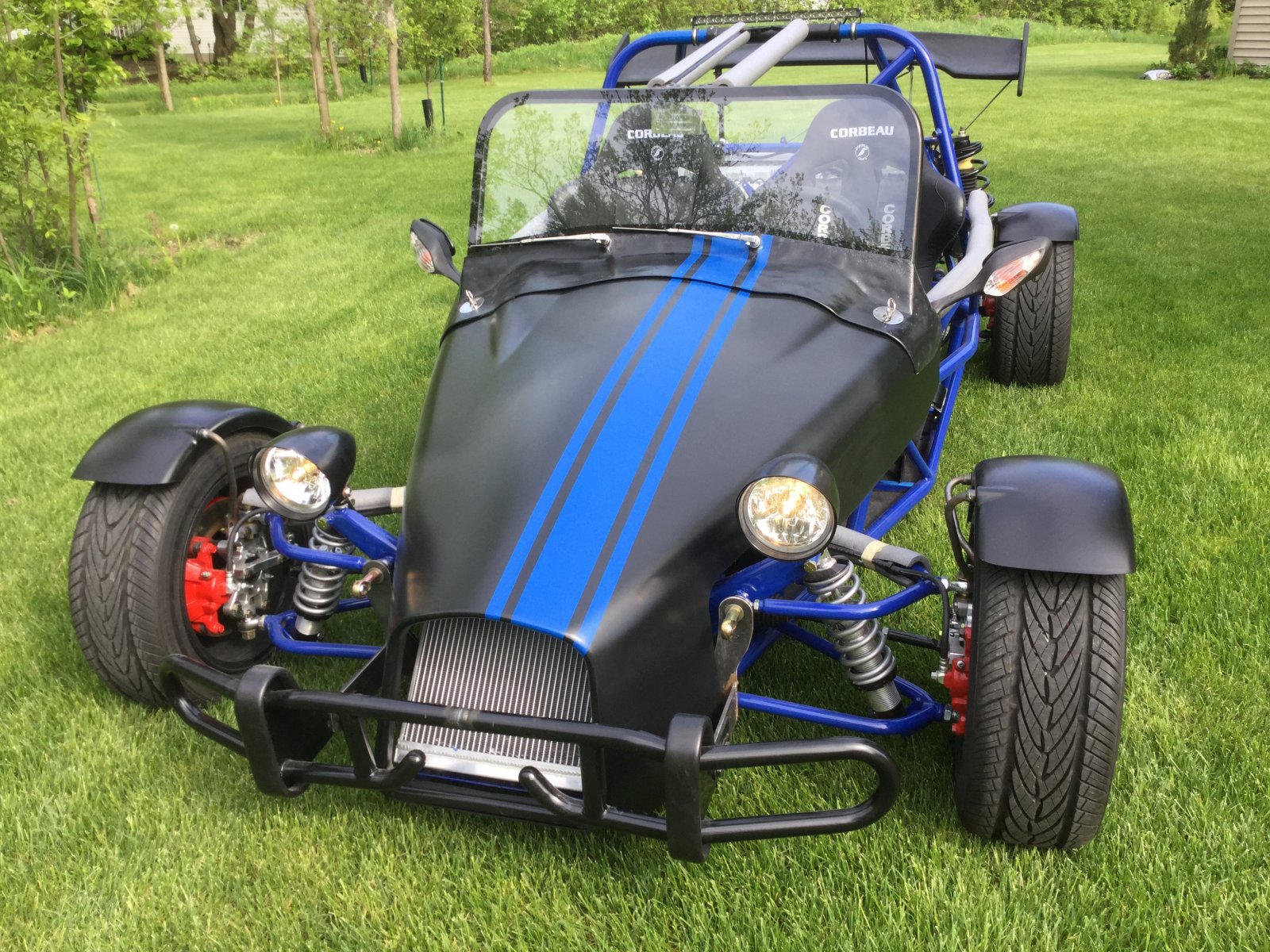

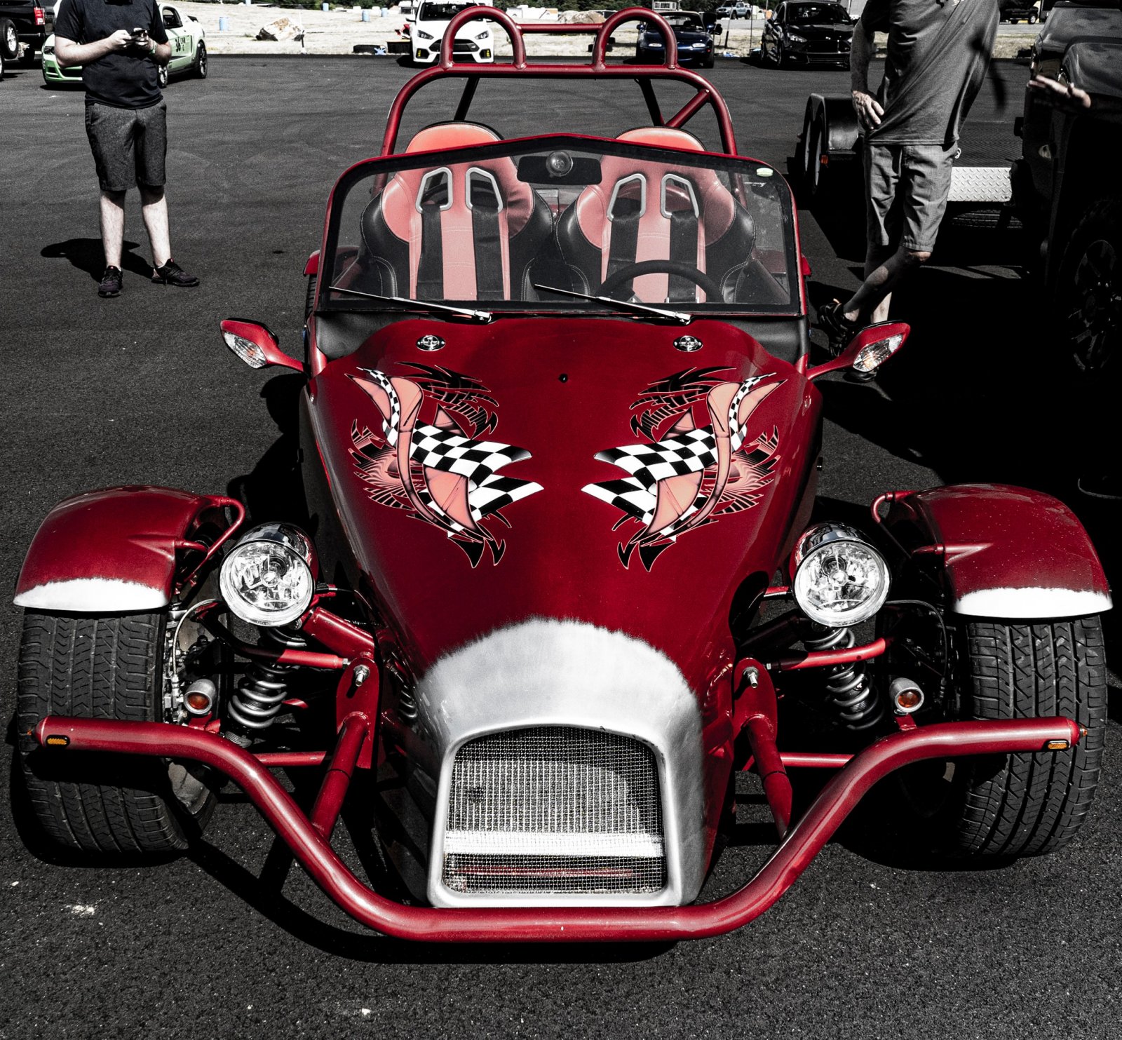

The pictures above are all the cars with wipers that I know of.

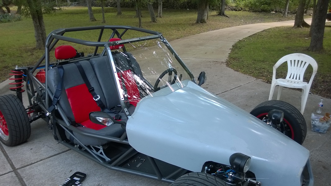

Dan Perry just used the A pillars to lay polycarbonate on.

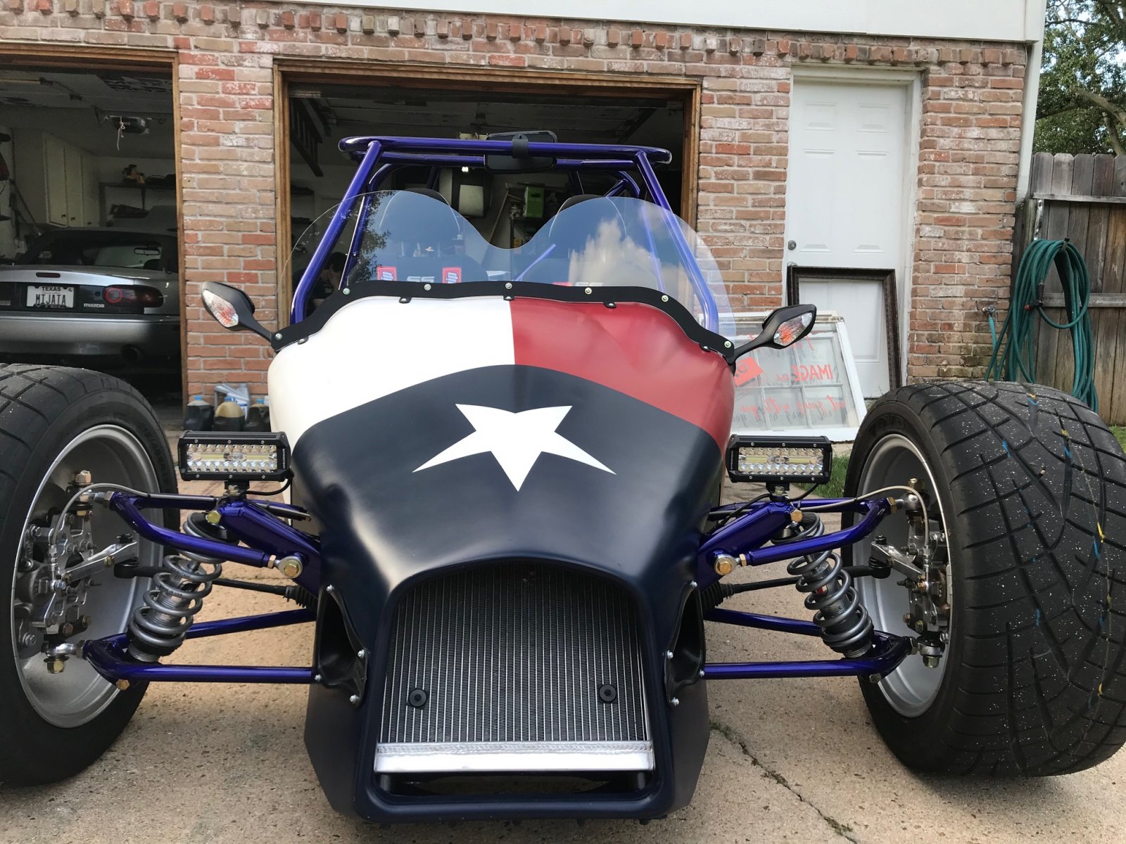

JBINTX modified his windwhield to get more air into the cabin
