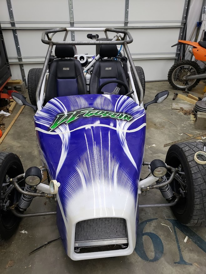

It's not deep ... it's also not a straight line, it's more of a "scuff patch" than an actual scratch, I guess. My hood (with windshield attached) is propped against the wall of my garage, where she typically has no business going (I don't mean that to sound rude, just saying, there's nothing there for her on that side of the garage and thus she never goes over there), and it's covered in multiple blankets, including over the windshield which is about 1" off the garage floor. I tucked half of the blanket under the windshield, and wrapped the other half over the top of it.
Well, she took our deck furniture inside due to an impending snow storm, and decided to use the free spot in the garage to store it. Not only did she plop the leg of one of the chairs down on top of the windshield, she even removed the blanket first to use it to cover the chairs, thinking it was an extra. I do not know how she didn't notice the shiny windshield reflecting light back at her or whatever, but it is what it is.
I was mad as a hornet at first, but at the end of the day, I only blame myself for putting the windshield in a situation where it could be scratched.

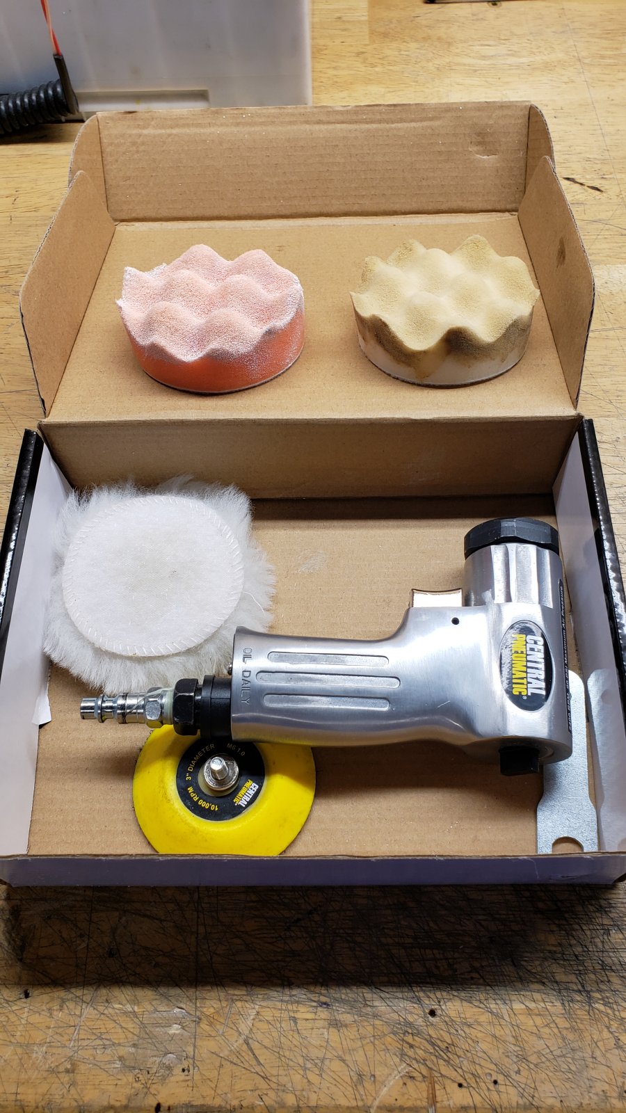

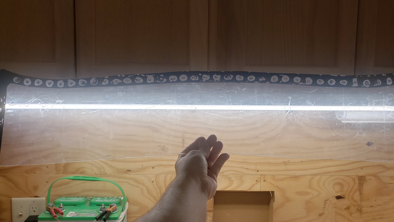

Update guys. I received an old scratched up piece of polycarbonate from Dale E. The idea was to do some testing to see what worked best to clear these windshields up. My first try was to use a heat gun like a few videos I had seen online. Big mistake!! It didn't clear up anything, but it warped the poly and caused micro bubbles inside. Dont try it. I then bought a bottle of Novus 3 and a 3" pneumatic buffer from harbor freight. Right on the back of the Novus 3 bottle it says do not use on polycarbonate. I had really good results! Novus 3 did a good job of removing the heavier scratches. It did leave the windshield "hazy". Then I hit it with the Novus 2. This removed the "hazy" micro scratches. Then I followed up with Novus 1 with a microfiber towel. So recap... I went over both sides of the windshield twice with Novus 3 and the buffer, then twice with the Novus 2 and the buffer, followed by Novus 1 with the microfiber towel. Here is an example of a 3" area I tried on Dale E's old windshield.
Give it a try.

Great job fixing that windshield. 3” pneumatic buffers are awesome! What kind of pad did you use on the buffer?
Grab a 3” DA sander and you can do miracles with old headlights and scratches in paint too.
Tim Moland
I used the foam pads that came with the buffer. The orange pad for the Novus 3 and the white pad for the 2. I applied the Novus to the pad with a couple drops. Then dotted the area I was going to buff with the pad. I buffed till the polish was "dry", then polished the dry off with a microfiber towel by hand. I worked in small 12" areas.

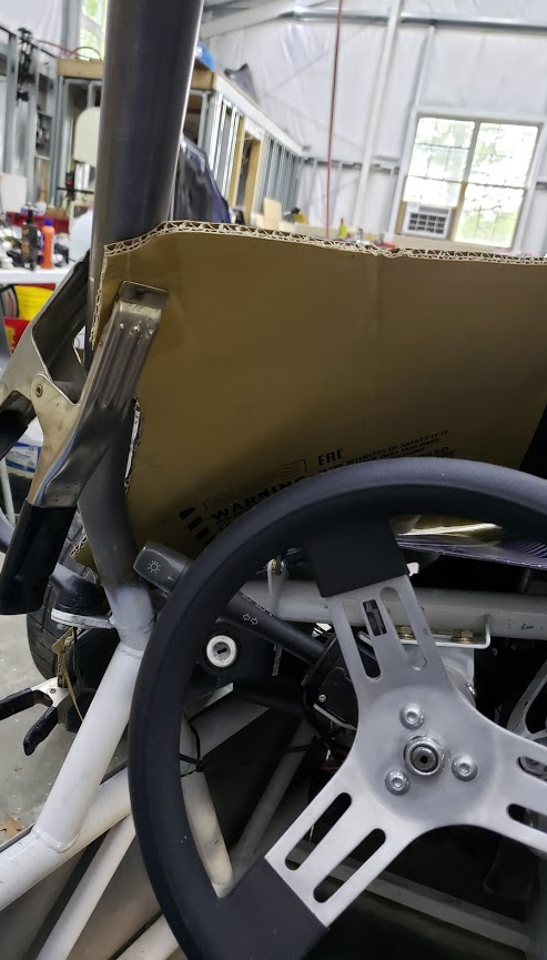

The top corners will be secured with a P clamp and a bolt.
The closest to the steering wheel is 4" away, so no issues knocking knuckles.

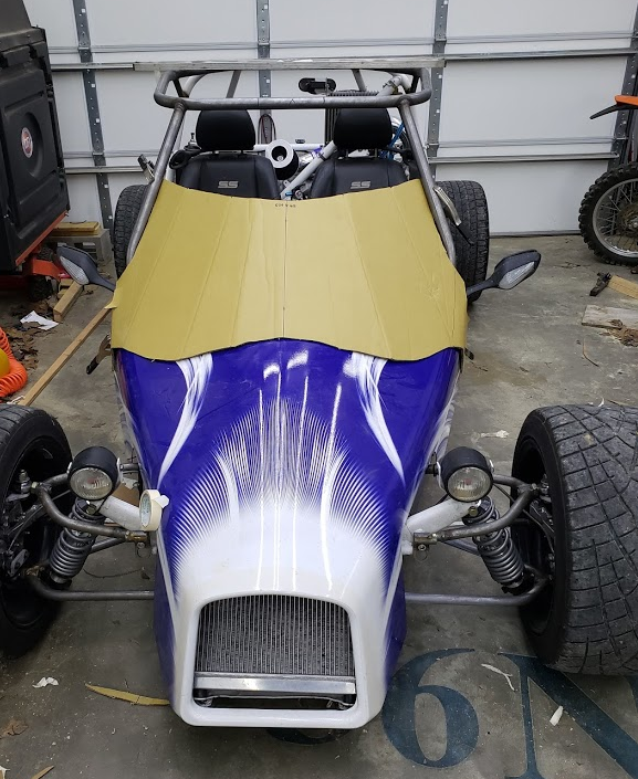

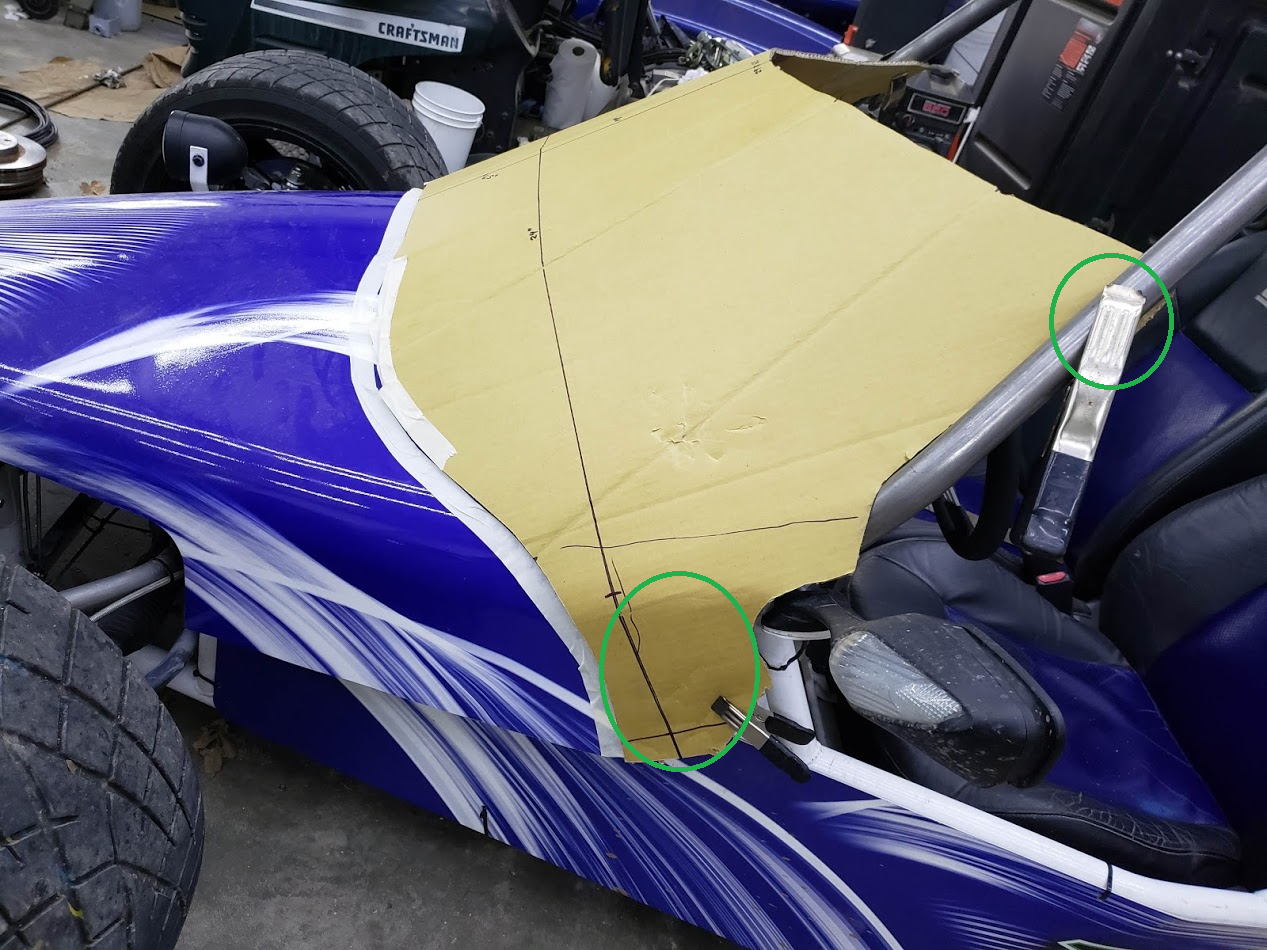

The curvy tape line shows how far down the hood that the clear polycarbonate would reach.
The top 1/3 of the hood is visible thru the windscreen.

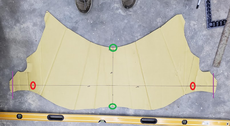

If you want to try a cardboard template for your car, here is a starting layout.
Scale it so the dots inside the green circles are 18" apart,
and the dots in the red circles are 48" apart.
I am thinking about trimming at the purple lines so that it fits on a 60" piece of polycarbonate.
23364
For the bottom section of the windshield, I was planning on using this clear edge trim where it contacts the hood.
So this template is 29" high, and 60" wide.
This sheet would be big enough to make 3 windshields.

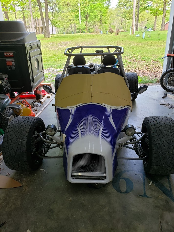

I took the cardboard for a test drive today, and made a few modifications.
The air was hitting me on the forehead, so I will be tipping it up a little bit to get the air over my head.
I also rounded off the top corners a bit, to make it fit inside a 24" x 60" rectangle.

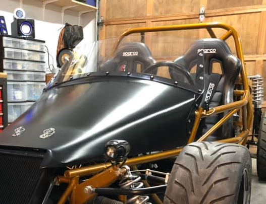

If you have the city frame, just add some small A pillars like in Lonny's design. Or attach it to the top of the hood.
23421
Alex Eddington added some small A pillars too.
23422
