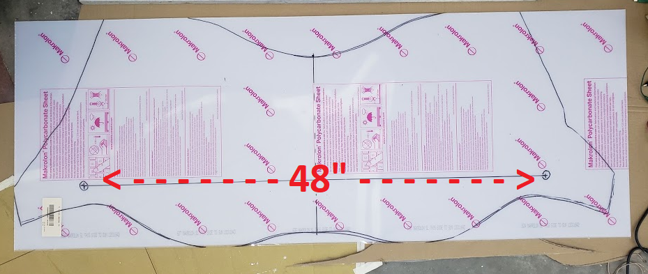

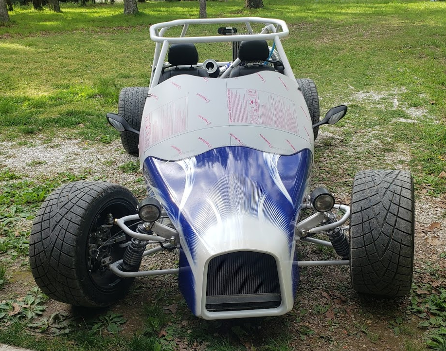

The new layout fit on a 23.5" high piece of polycarbonate. It is about 64" wide.

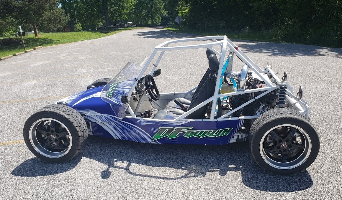

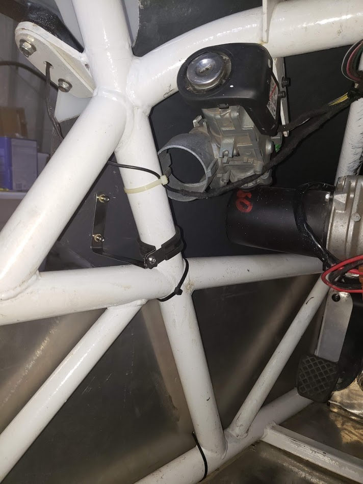

Used a P strap in the top corners.
23571

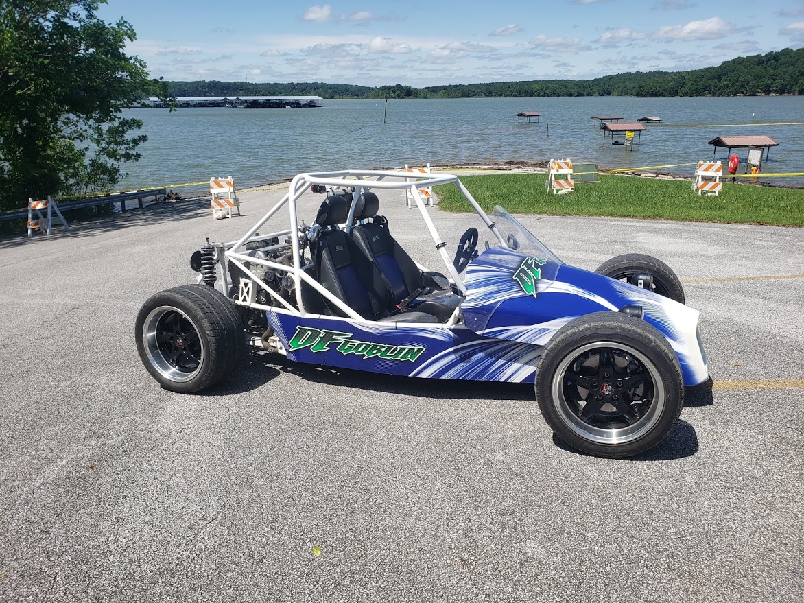

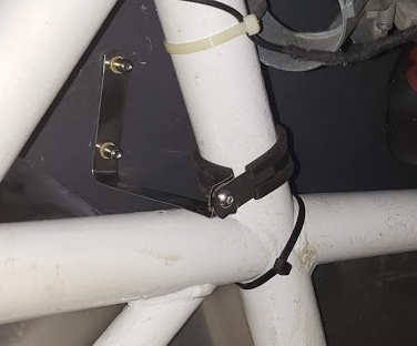

I used 2 P straps to hold the bottom corner of the windshield and body panel. One P strap was bent into a U shape, and had 2 rivnuts put in.
No more flapping in the wind.
23573
So far the 90 thou polycarbonate withstood 100 mph "Mexico winds" without needing additional bracing.
Like a Hoover dam, the curved shape allows the wind pressure to press against the A pillars, and keeps the windscreen in place.

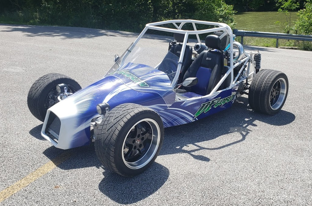

Curved window prototype:
24151
24148
24149
24150
The .090" polycarbonate works, but I will try a little thicker for the next prototype, just to make it a bit more sturdy.

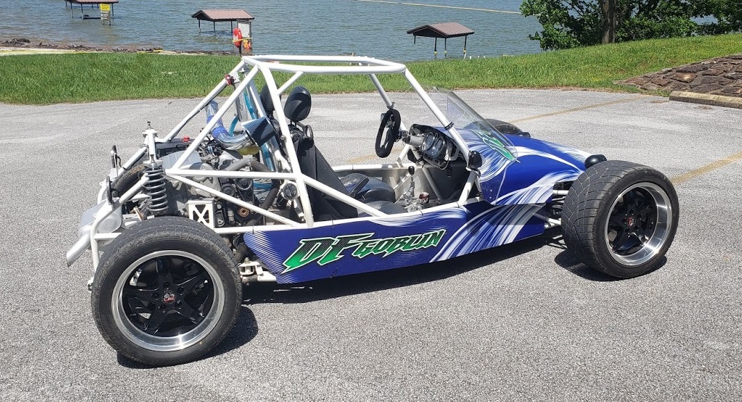

24152
You have been driving your Goblin for so long without a hood or a windshield. You liking the drastic change of air flow with them now?
I should have put a body on it earlier. The dust from my driveway, and the rain that I got caught in a few times, have both made my BCM, instrument cluster, AEM air fuel gauge, and power steering become intermittent. Luckily I have a second donor that I bought for the engine. It is now also going to donate some electrical parts.
The wind reduction in the cabin is nice for talking to your passenger, and highway driving isn't a beating, so that is nice. On the autocross course, I think it gives me some downforce on the front too.

After making my prototype windshield, I need to modify the cut pattern, as the polycarbonate doesn't bend the same as the cardboard.
That is why I made a prototype! Learn, improve, modify.
